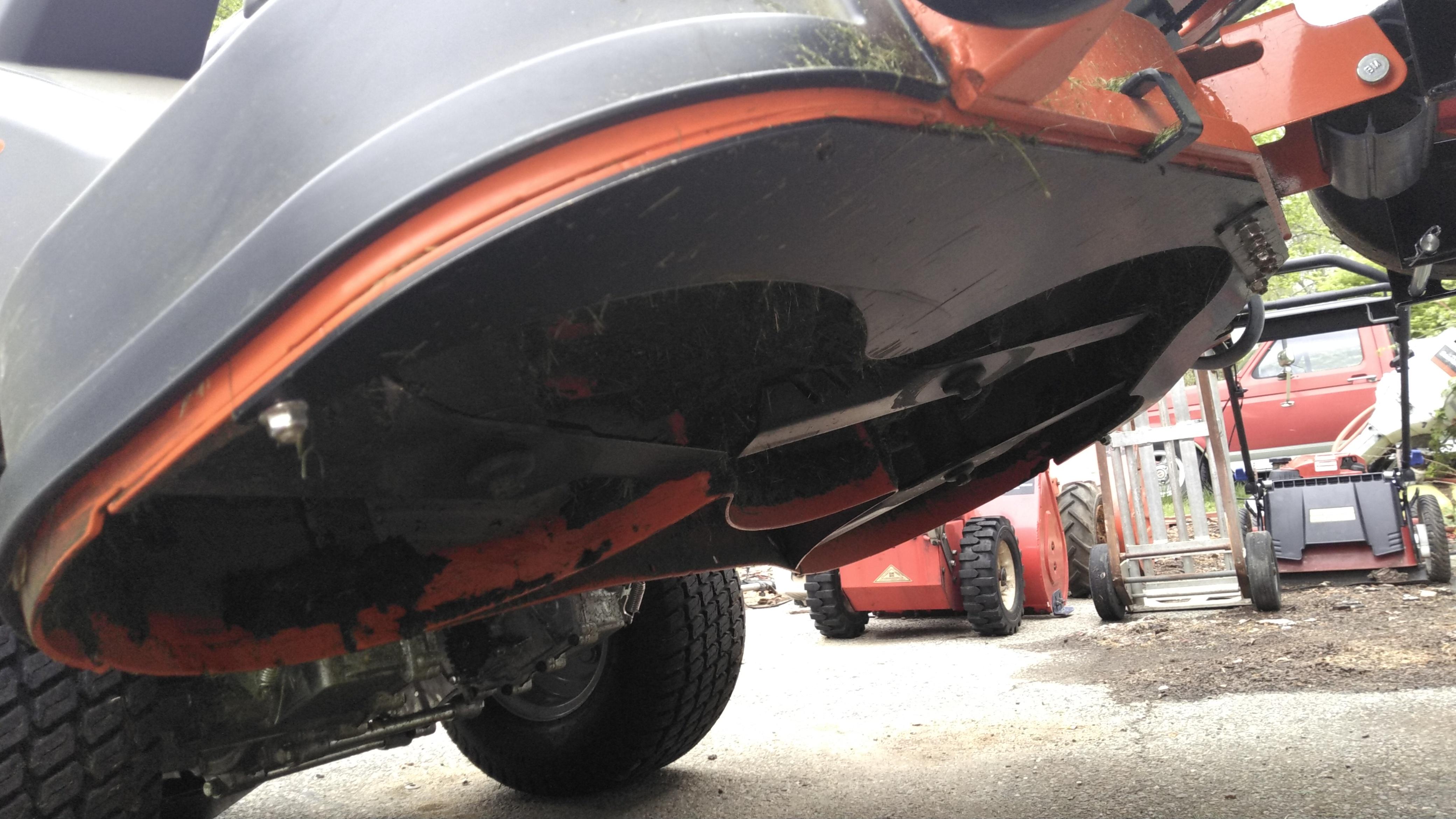

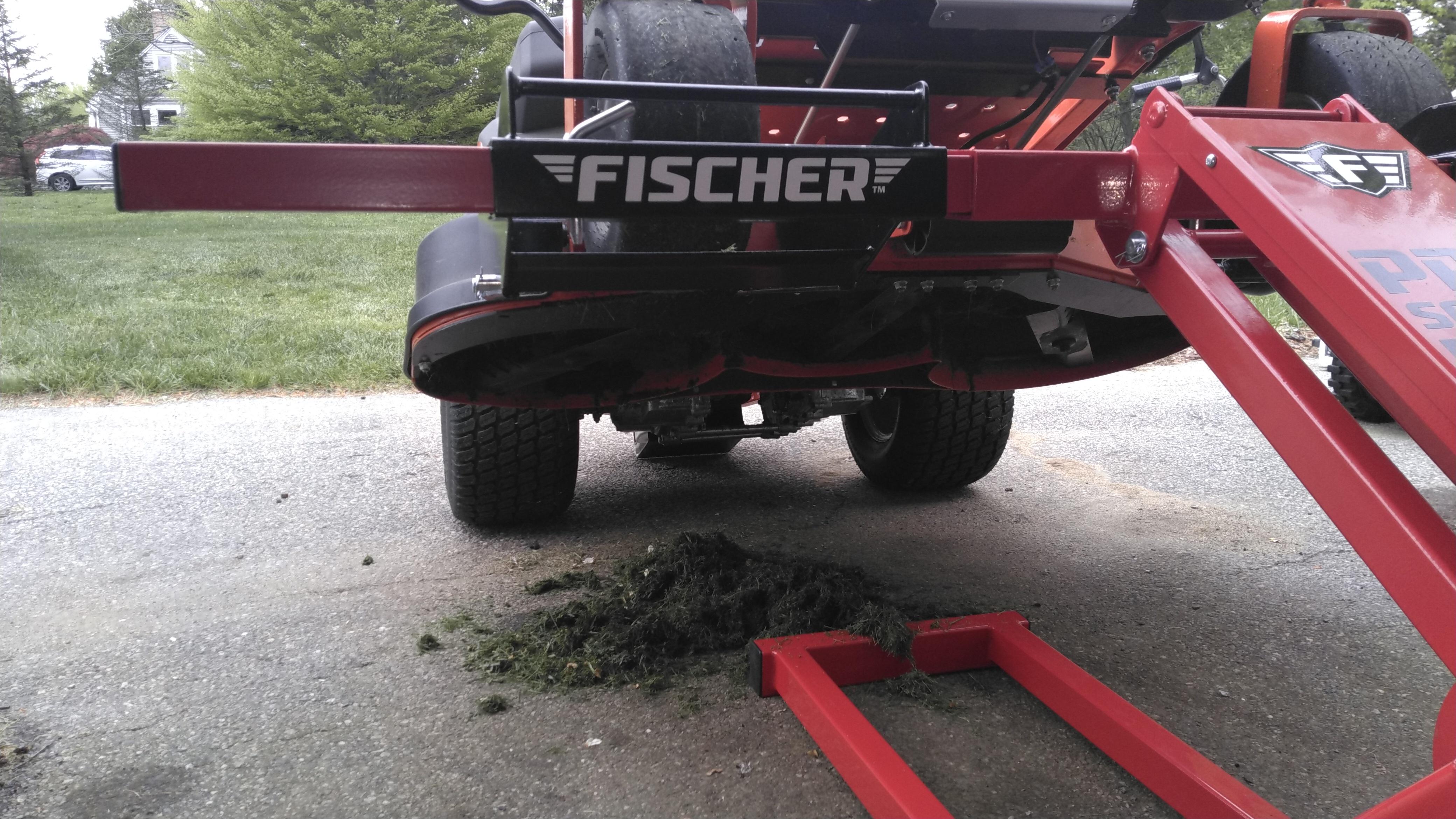

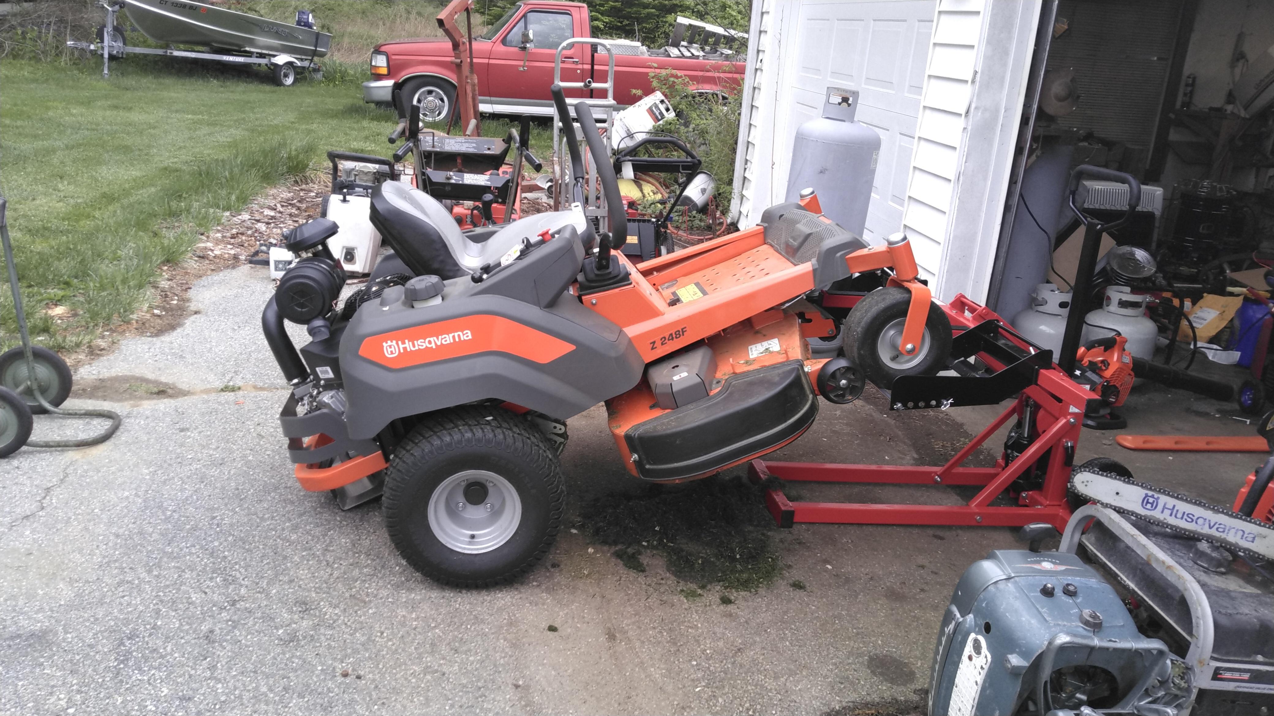

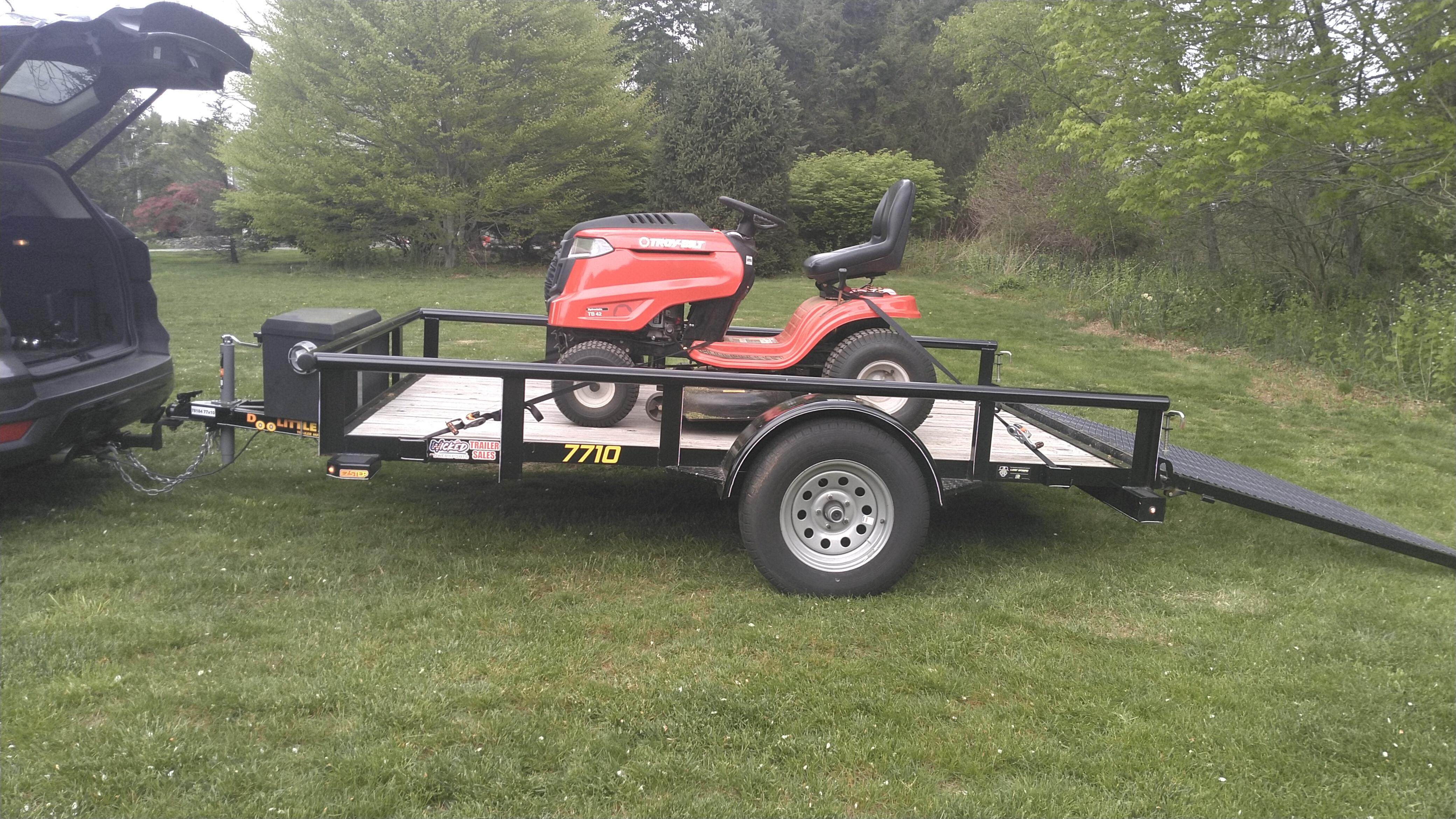

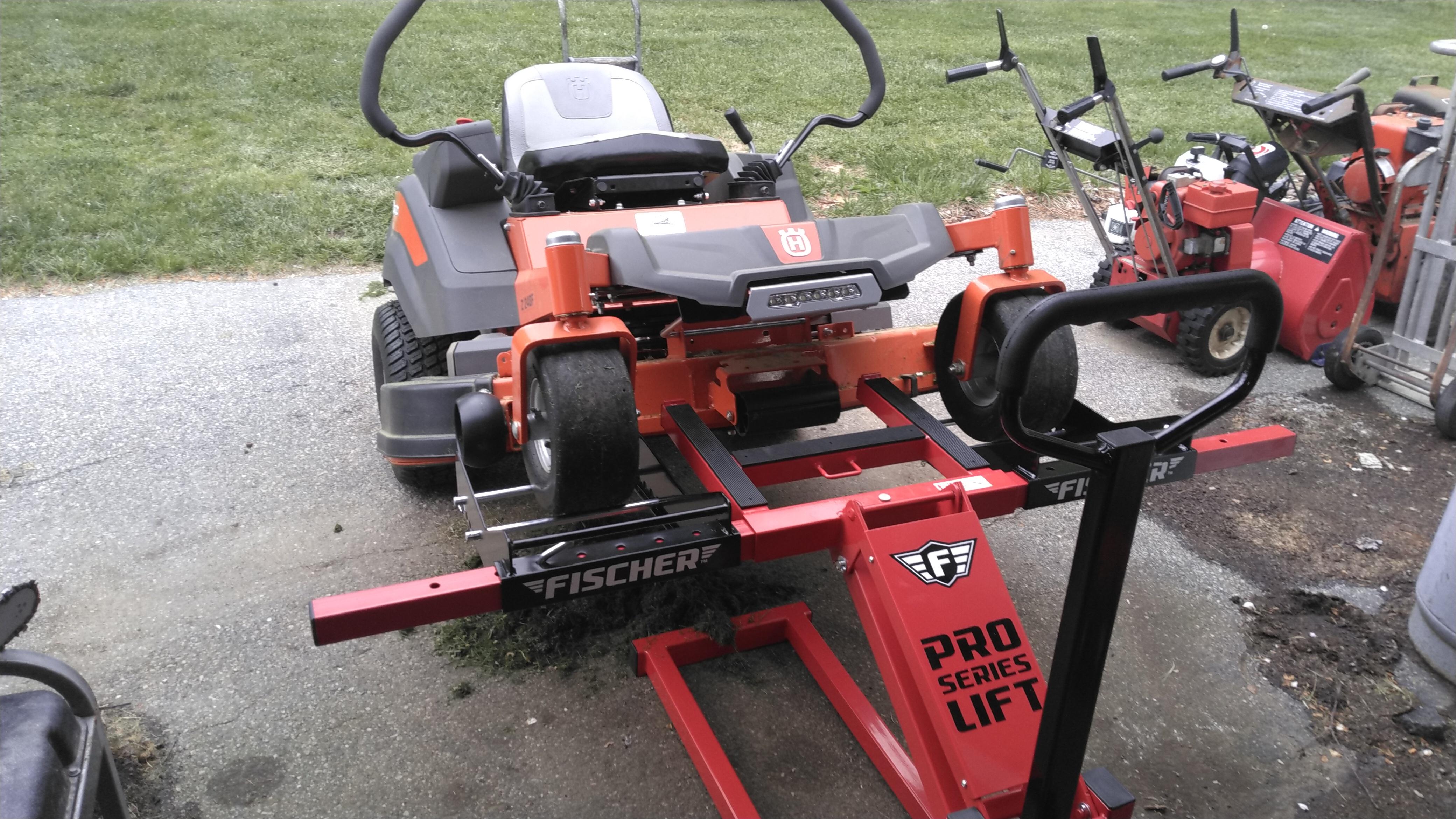

Played with my new lift. Much better than using a floor jack.
Delivered the Troy Bilt 42 rider.

Much safer, I would put the front wheels in a tractor bucket and lift the front end up.

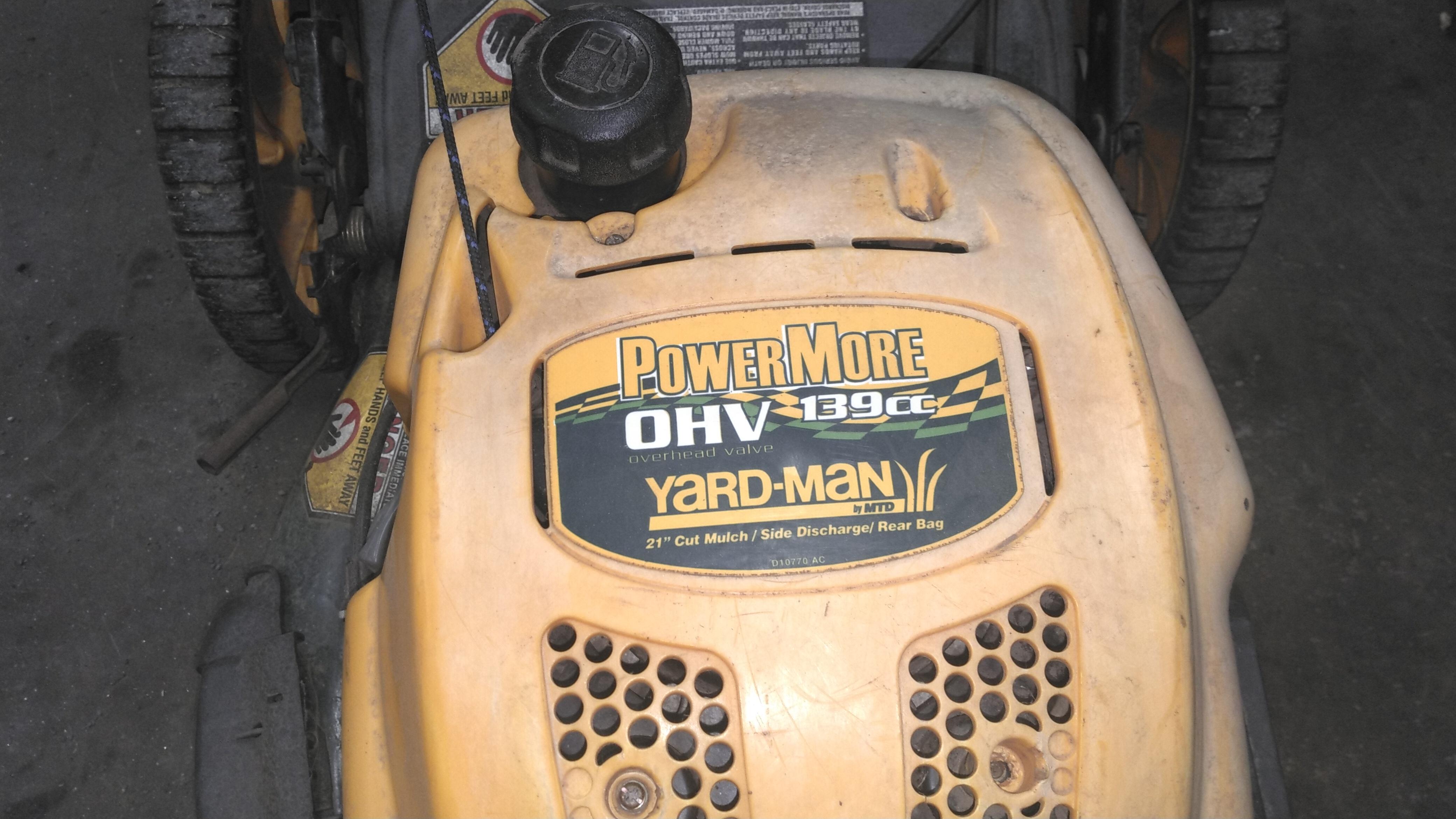

Crappy Yard Man 21" push mower. Replaced the recoil rope to see if it would run. It does but only on choke. Carb is swimming in the ultrasonic. If that doesn't work I'll have the new one Thursday along with a new air filter and pre cleaner. Once it's running good it's getting the usual oil change, new plug, and sharpen.

Crappy Yard Man 21 push mower runs great now. When I get home from work I'll sharpen the blade and change the oil. The new air filter/pre cleaner will be here tomorrow.
