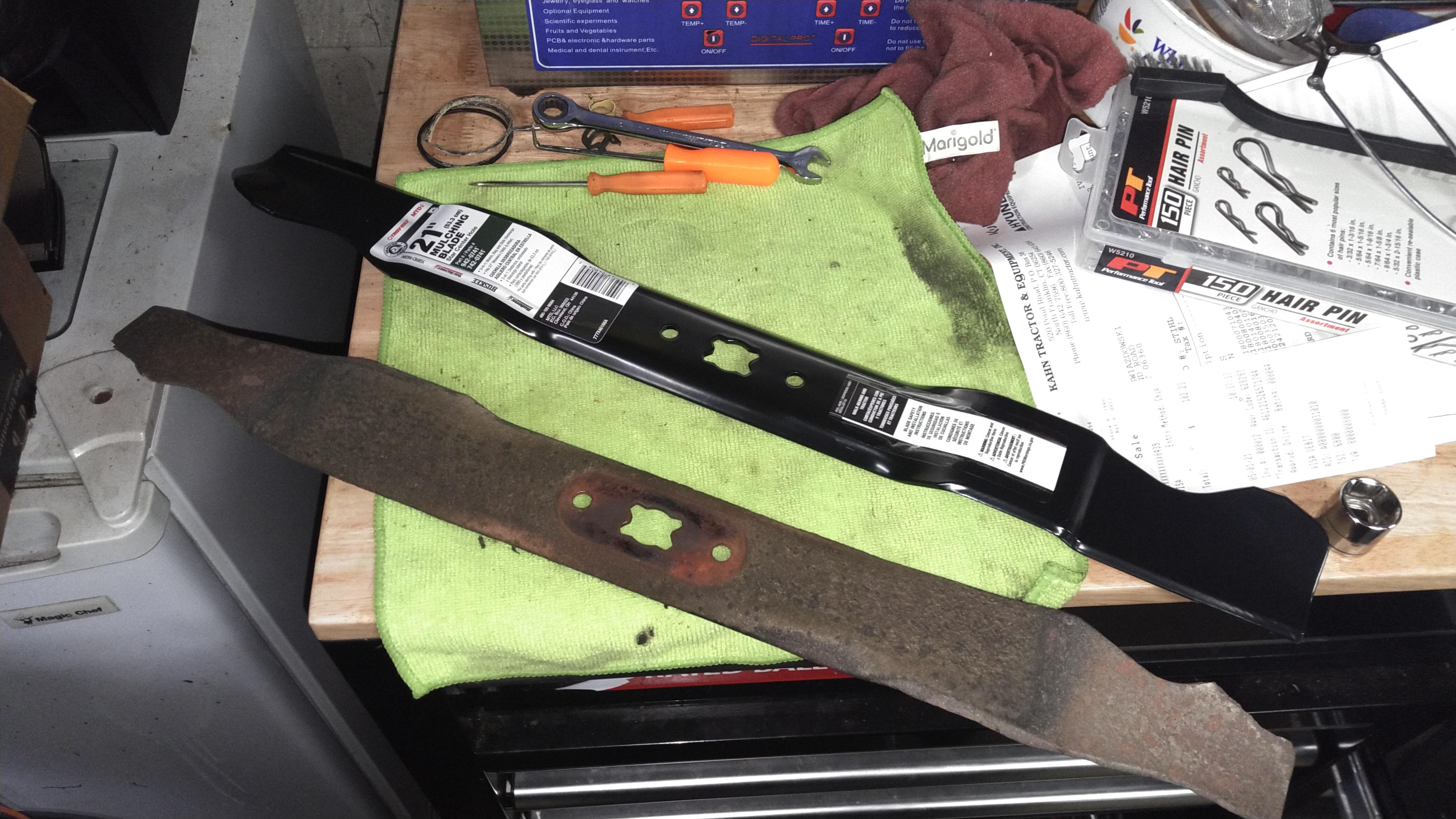

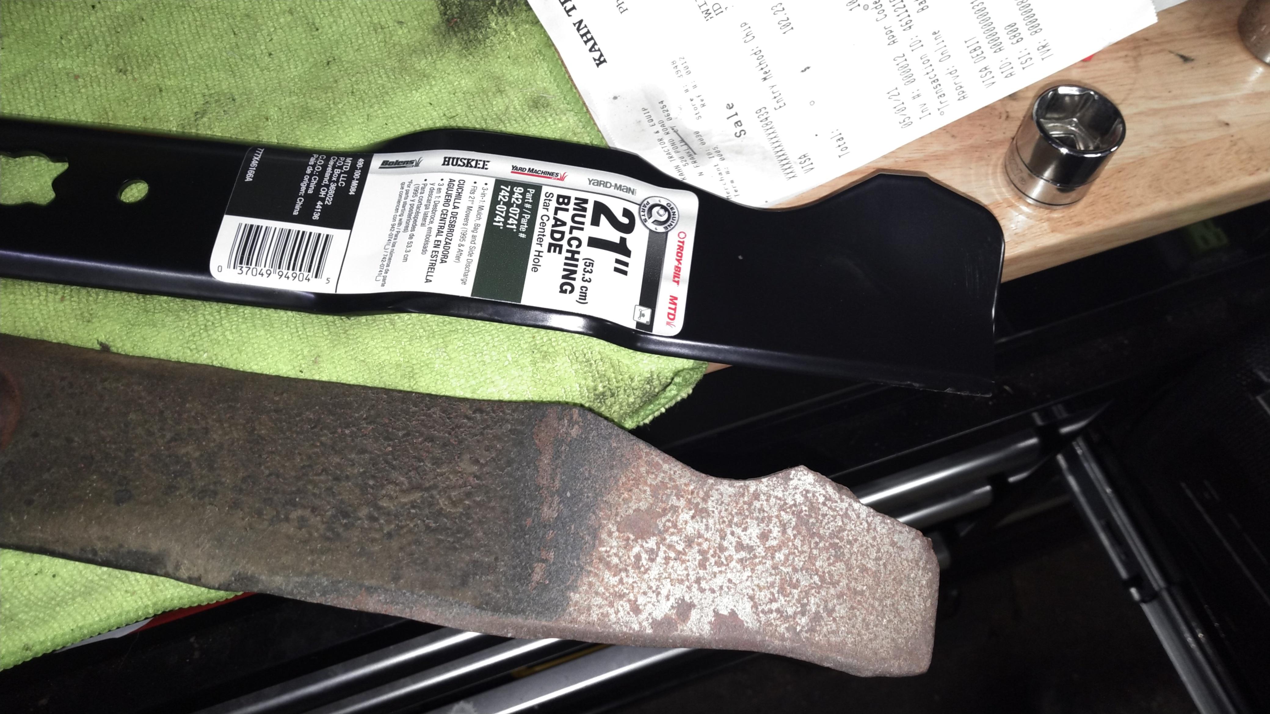

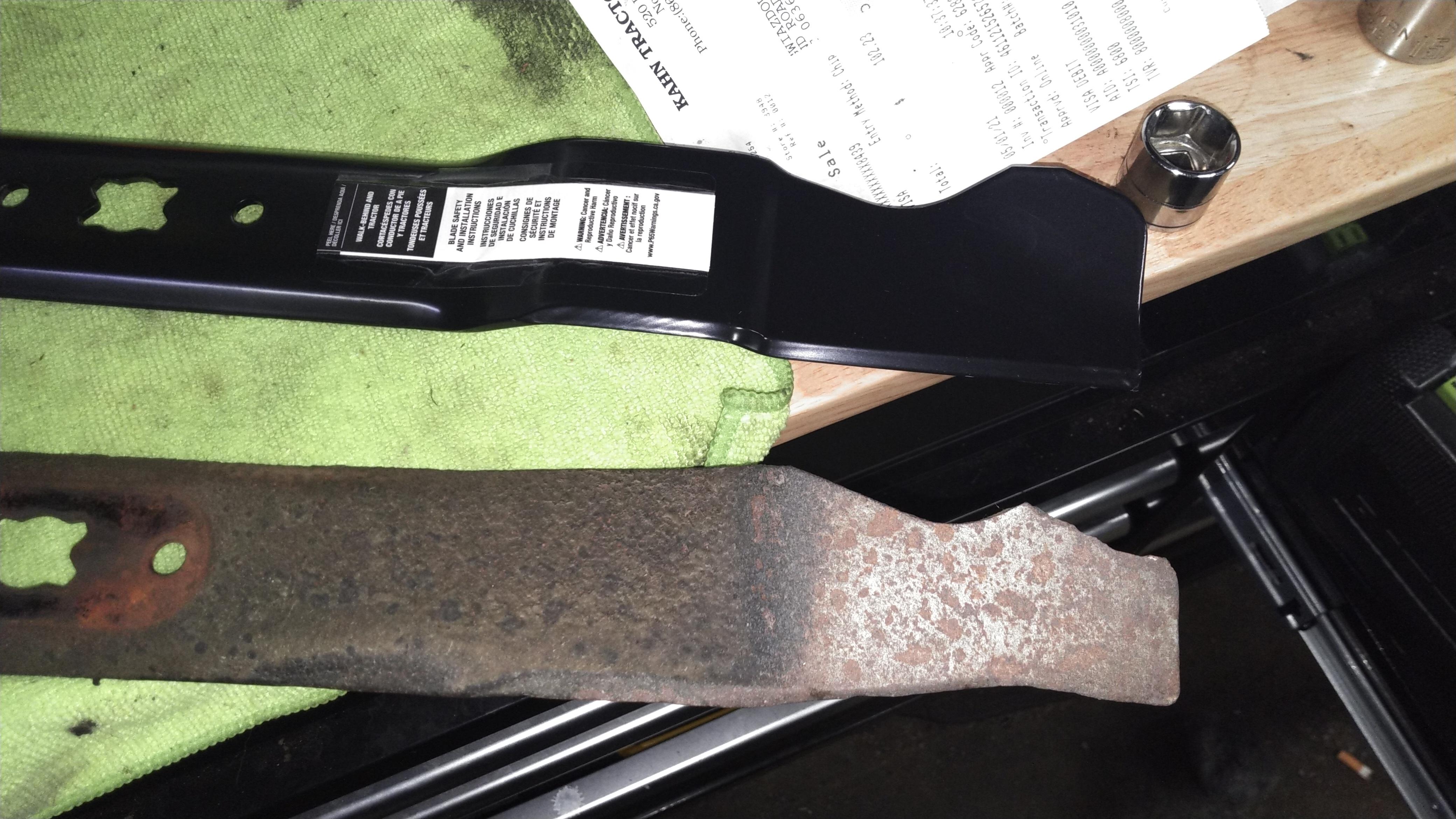

Pulled the blade off the Yard Man to sharpen it and decided it was time for a new one. Lift fins were broken off. Scraped the underside of the deck and changed the oil too.

Finished up the Yard Man. New air filter and pre cleaner installed. Cut my back yard with it and it ran great. Adjusted the rpm a little as it was running a little slow. Now it's running at 3200 rpm where it should be. Bagger works too.
