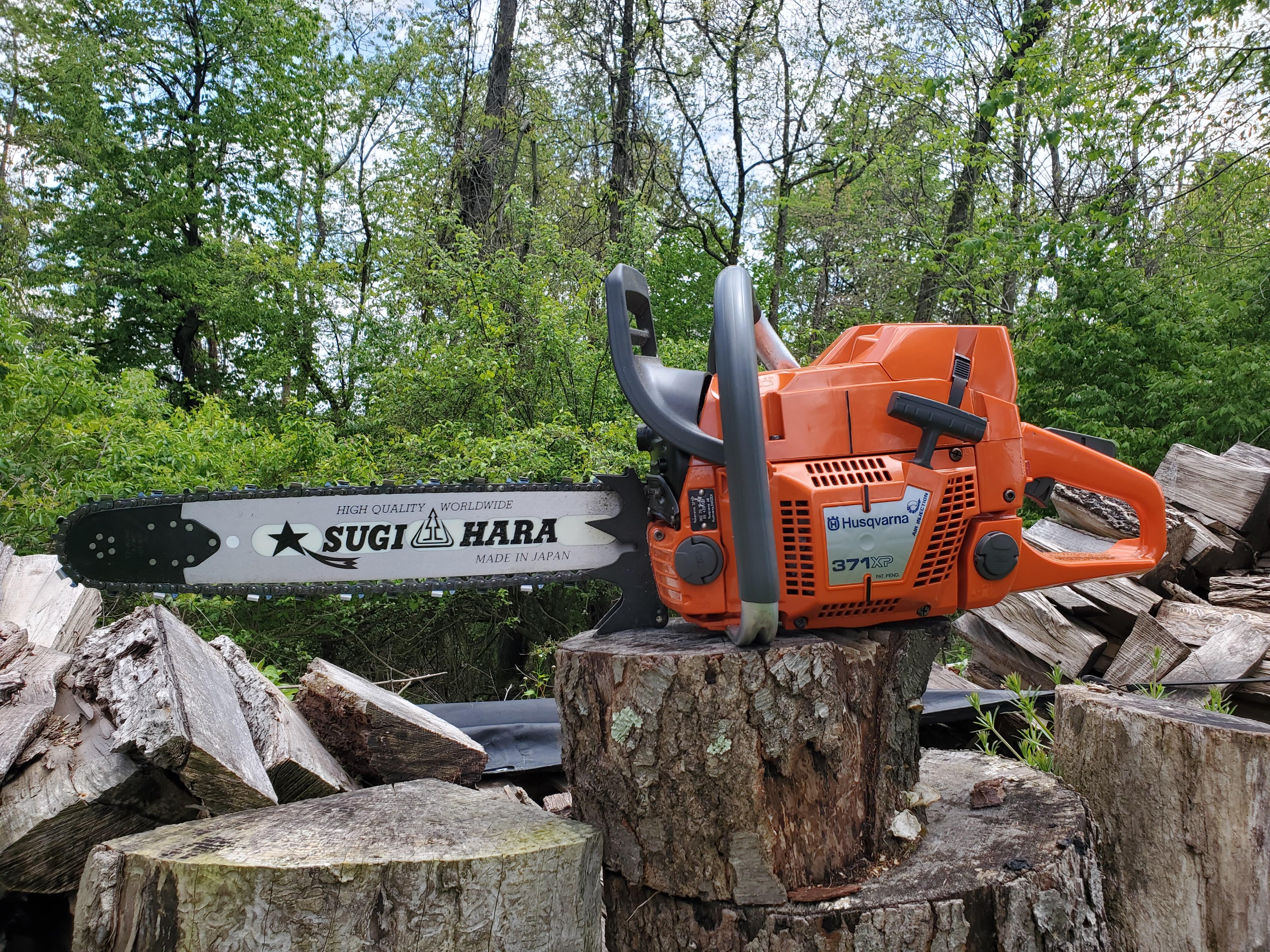

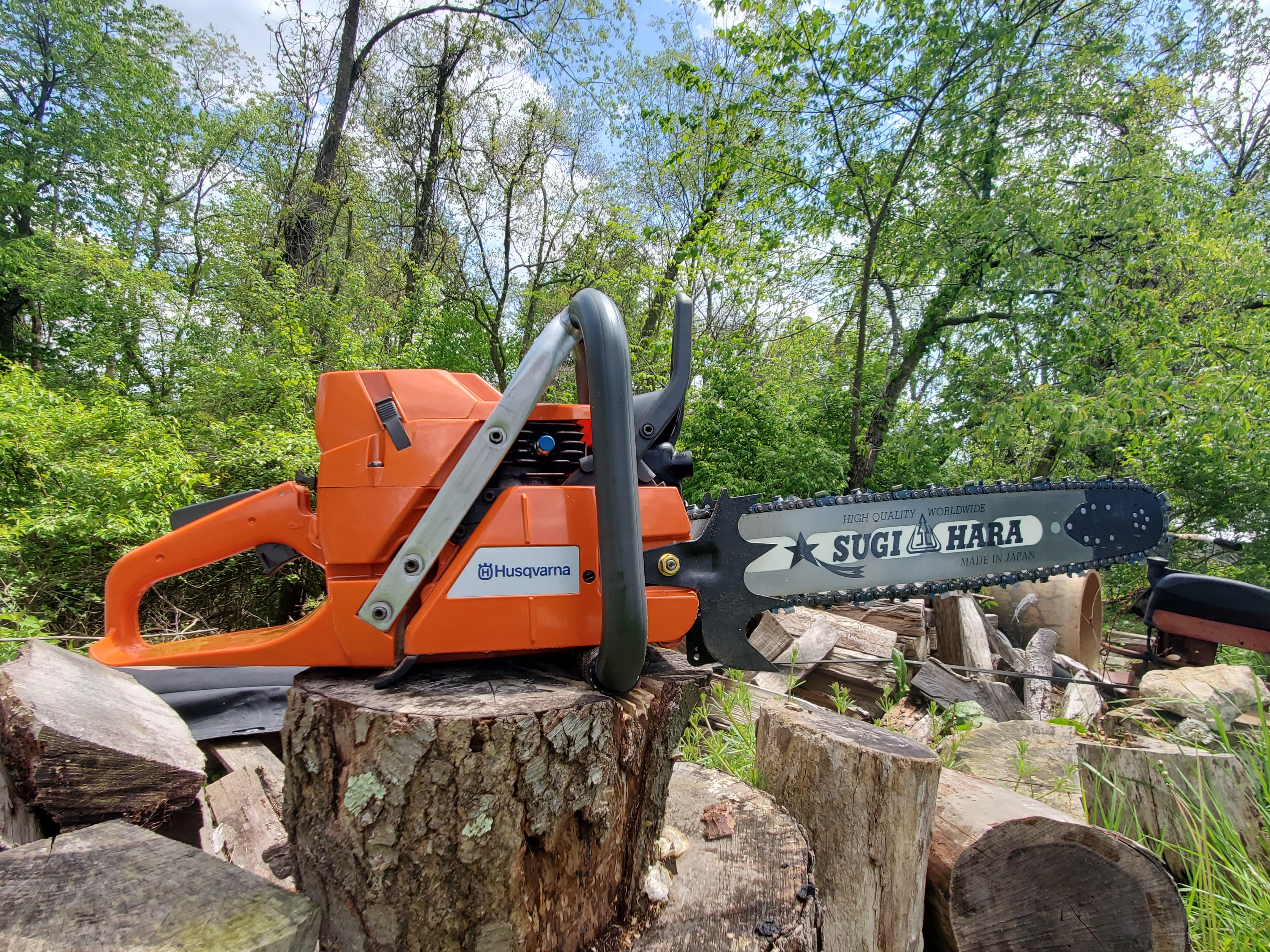

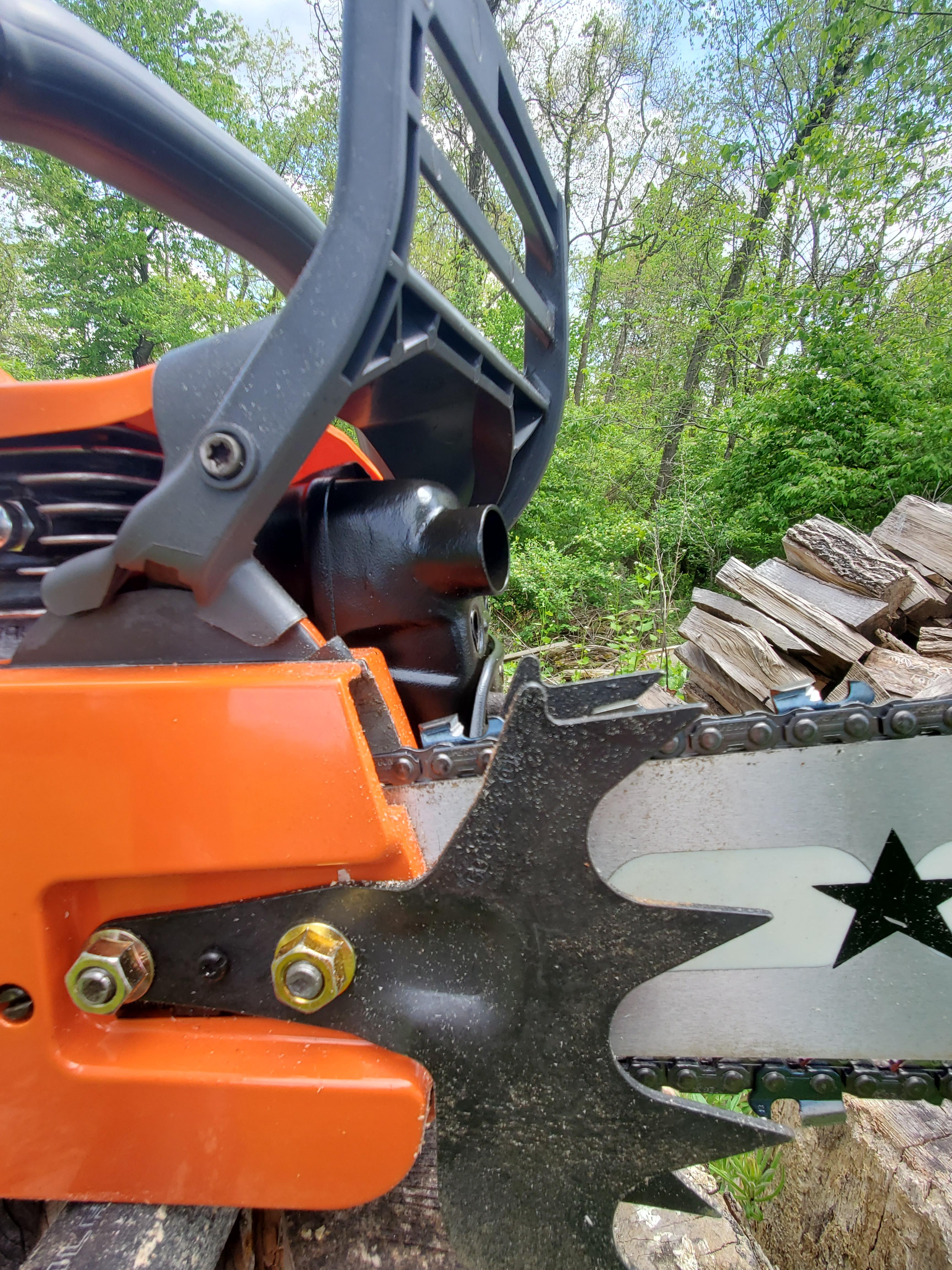

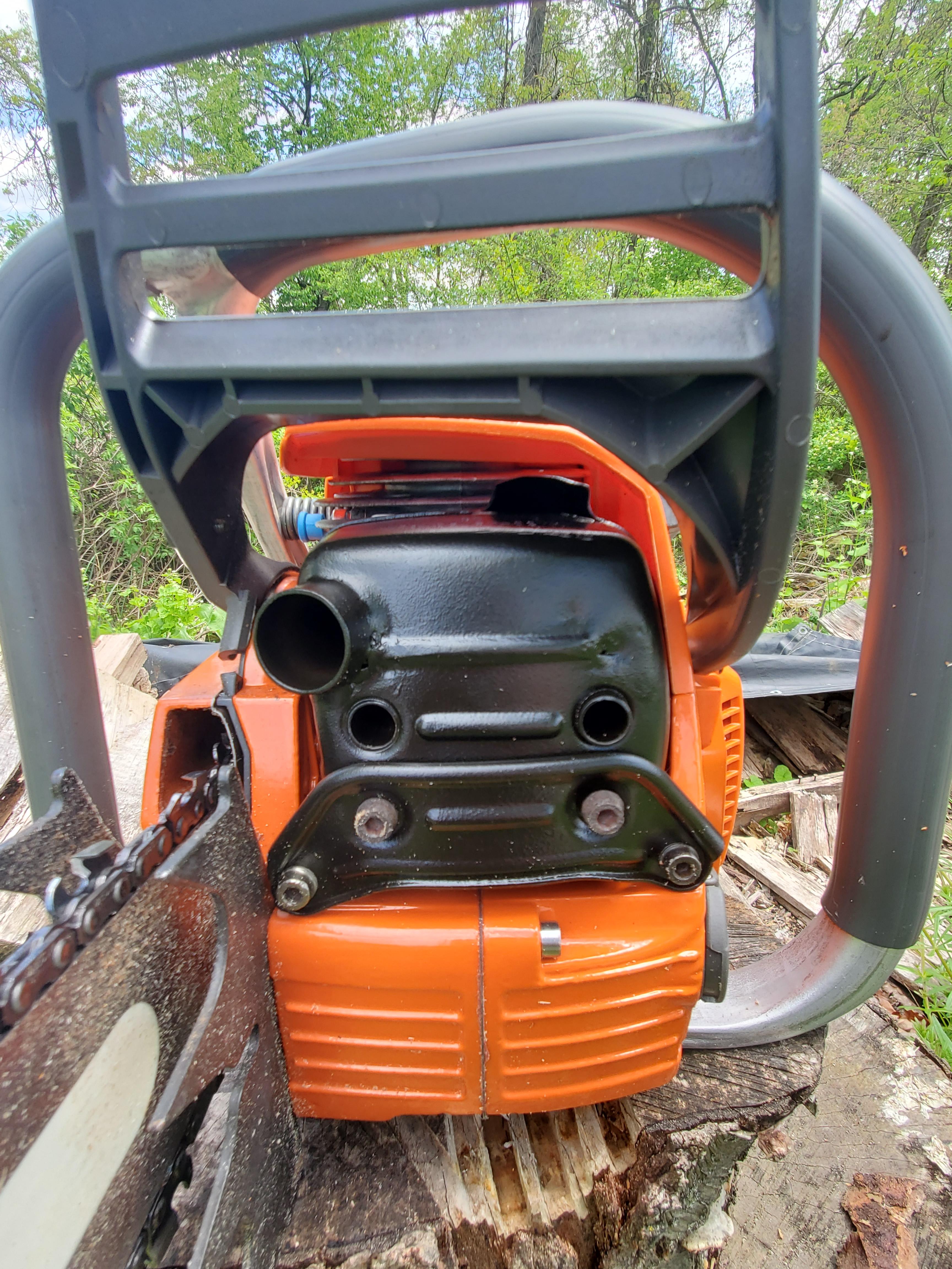

All mine J! Actually just finished it 2 minutes ago!
Yer chain's loose.

Very clean 371.
What are the major differences between 371 and 372?
PA Dan
FYD
12:57 AM
306
7,372
36,705
White Oak PA
Very clean 371.
Not much but there are a few things. The 372 case half added more bracing. The 371 clutch drum had holes in it. The 371 recoil didn't have the bridges between the fins and some didn't have the sight line go through the decal. Mine is a 1999 and had the sight line into the decal. P/C were the same other than the 371 having 2 rings. I think that's it but I'm no Husky expert.
