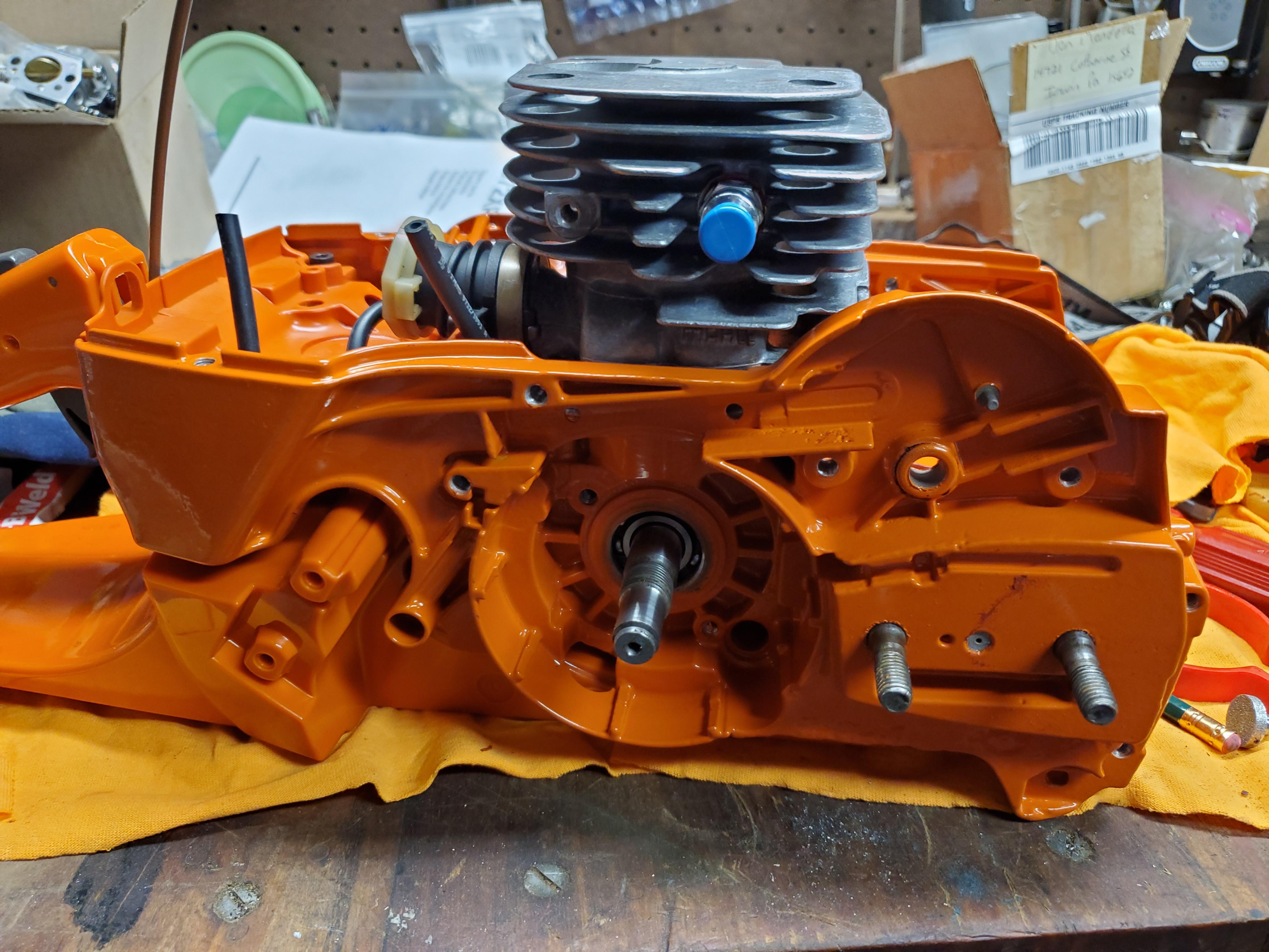

View attachment 293736 View attachment 293737
Dolmar PS 9000 coil, came loose and ran up against the flywheel and grew this booger, running a bead across the laminations Has no spark now but thought I’d clean it to separate the laminations and see if it make a delta.
I’ll but it back on this weekend and see if it sparks.
Cleaned the oem coil booger but still no joy.
Took a Stihl universal knock off and cut it to fit, more than what’s shown. Also had to bend the kill tab 180 degrees and extend the kill wire.
Sparks now.
