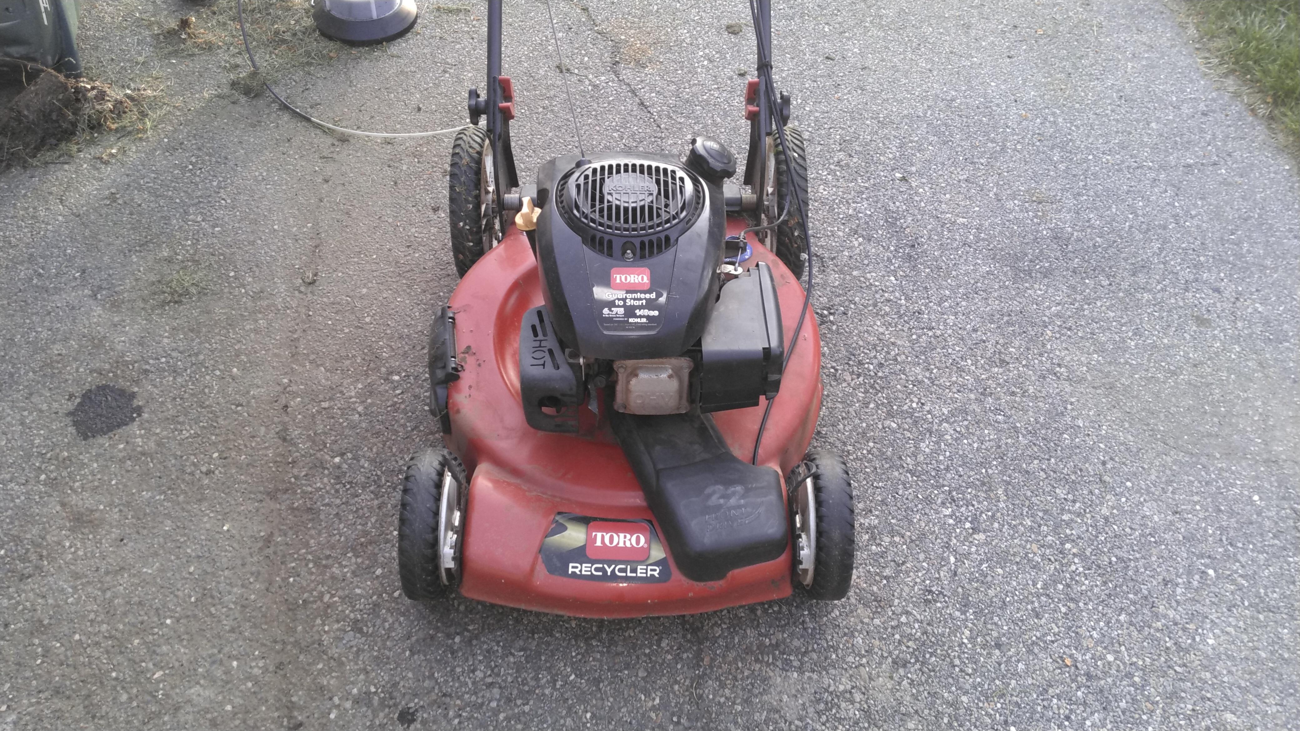

Had this dropped off for a get running/service/sharpen/drive cable replacement. I got it running for him in the fall but he let it sit with fuel in it. Job security I guess. He's also bringing me his Exmark 61 Monday for a service.

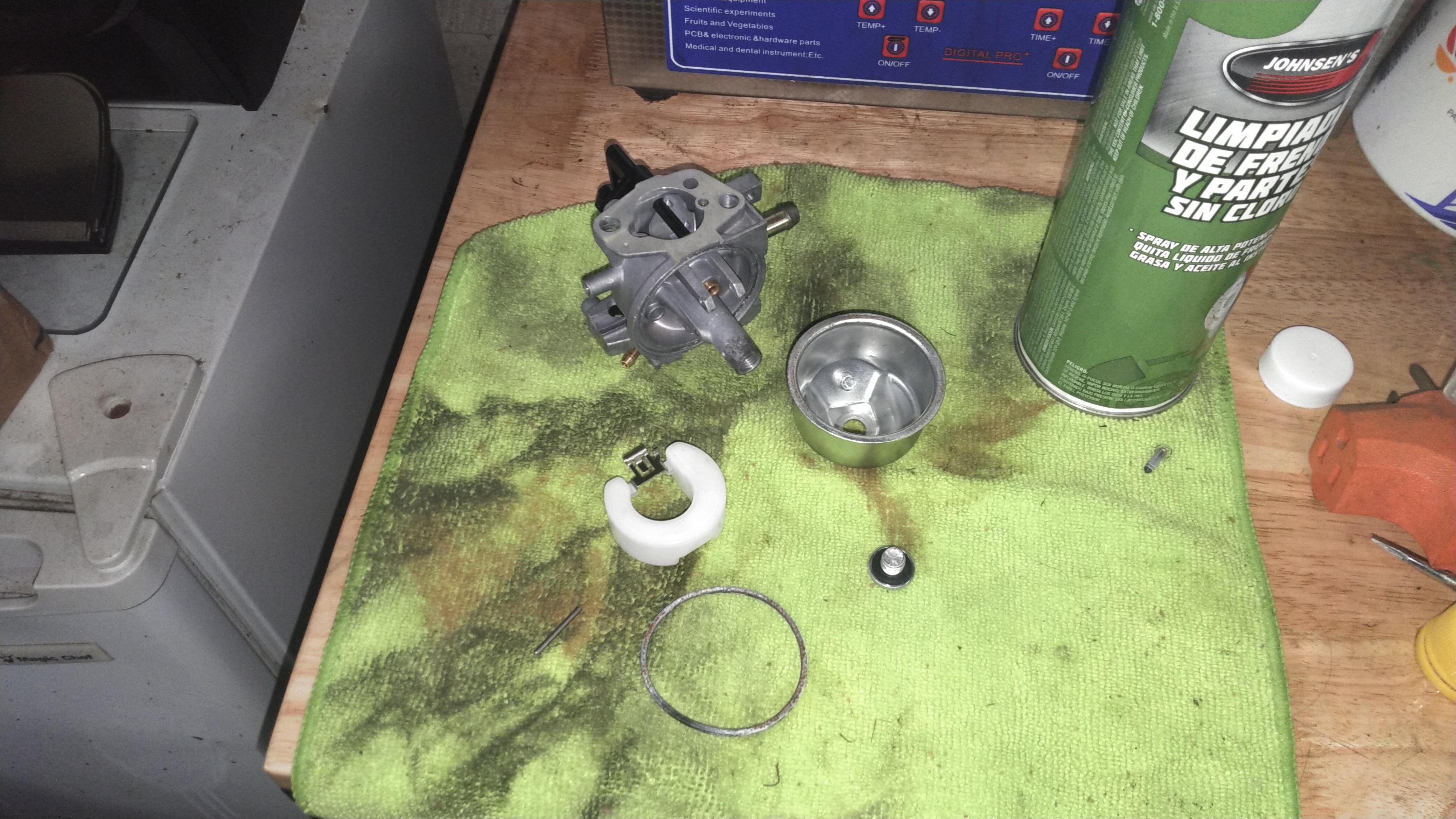

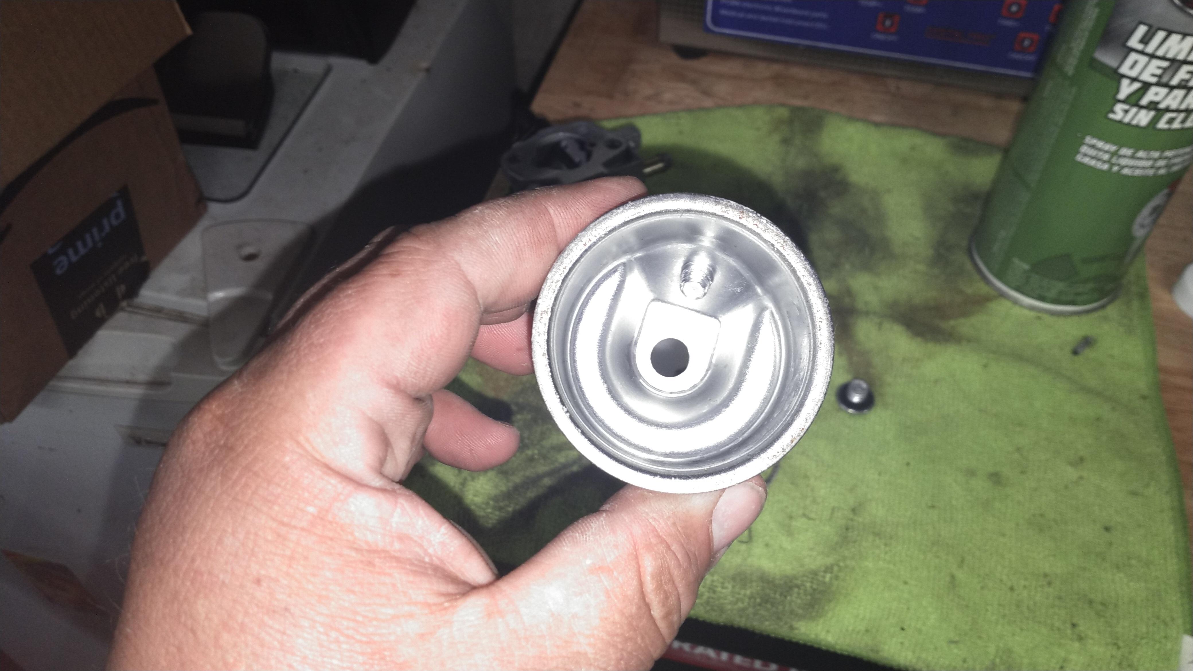

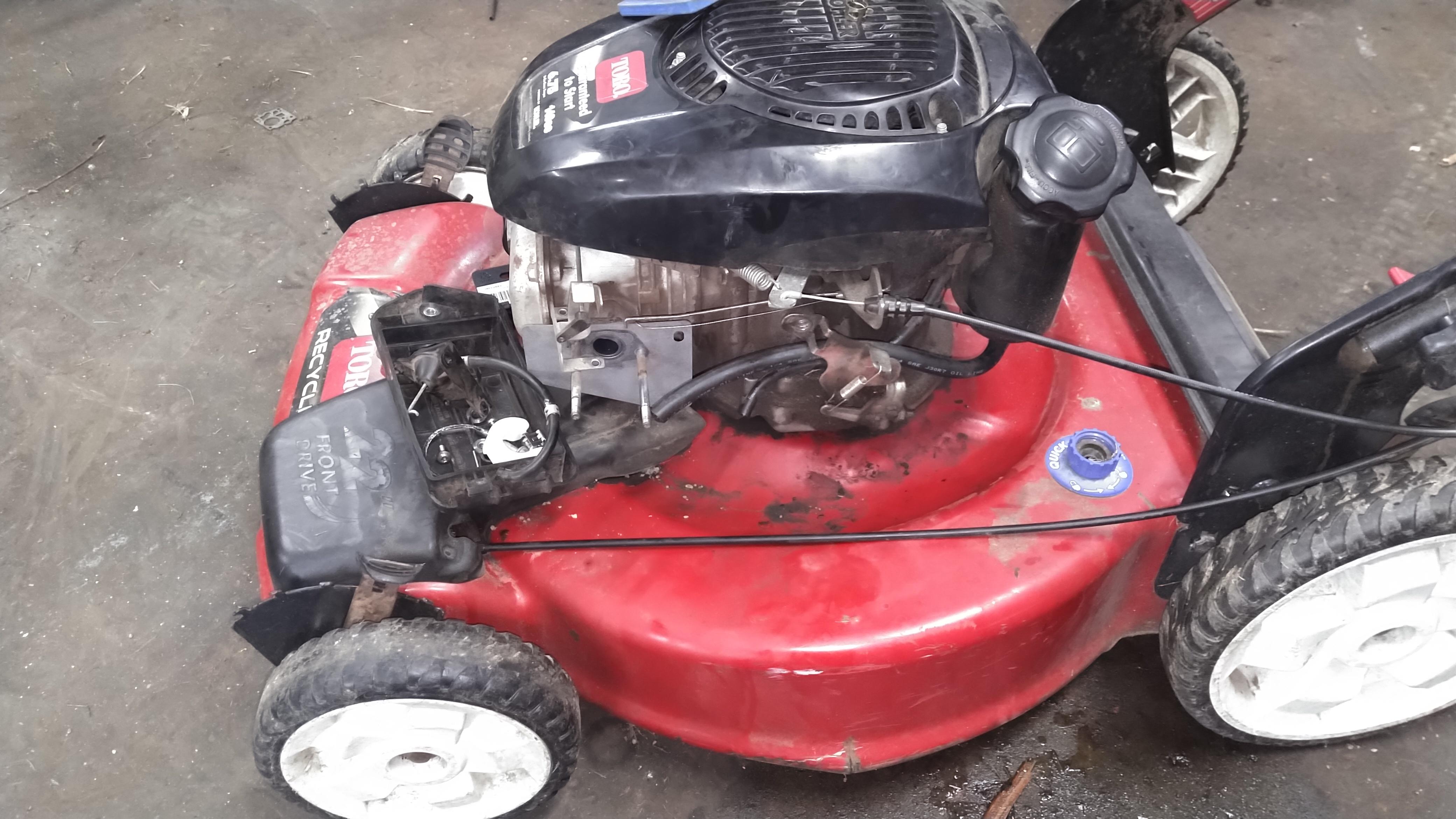

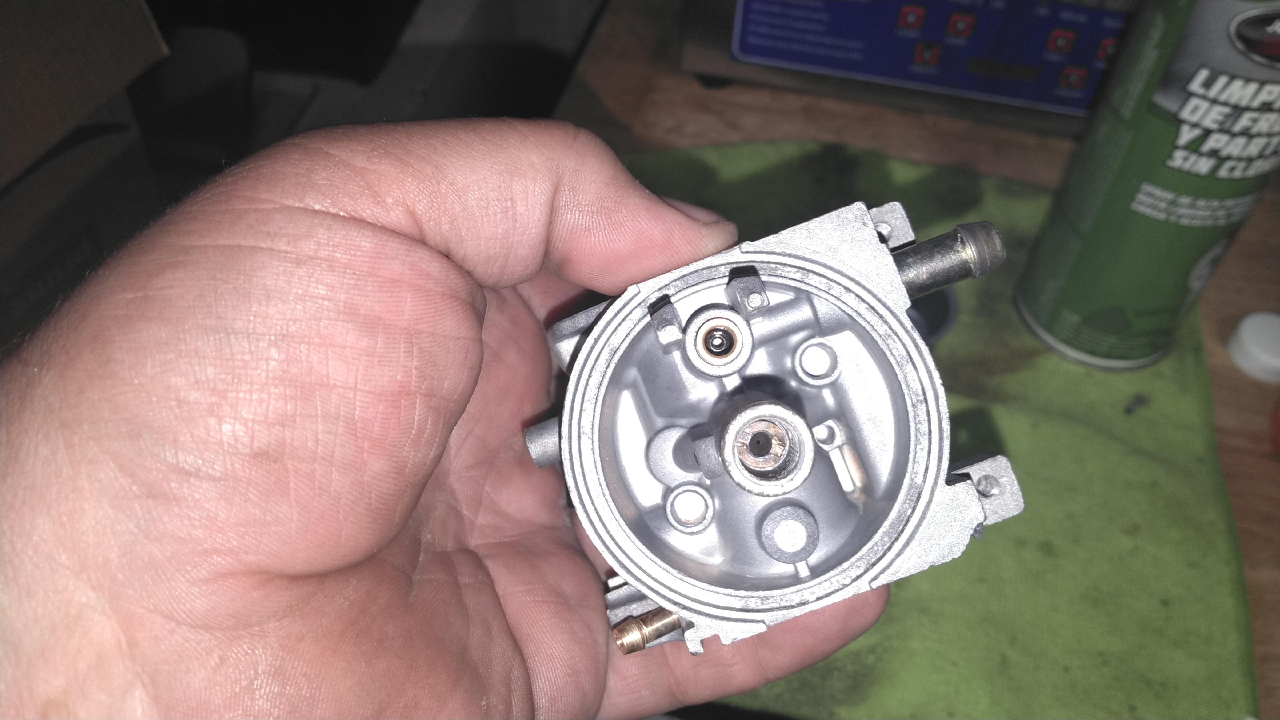

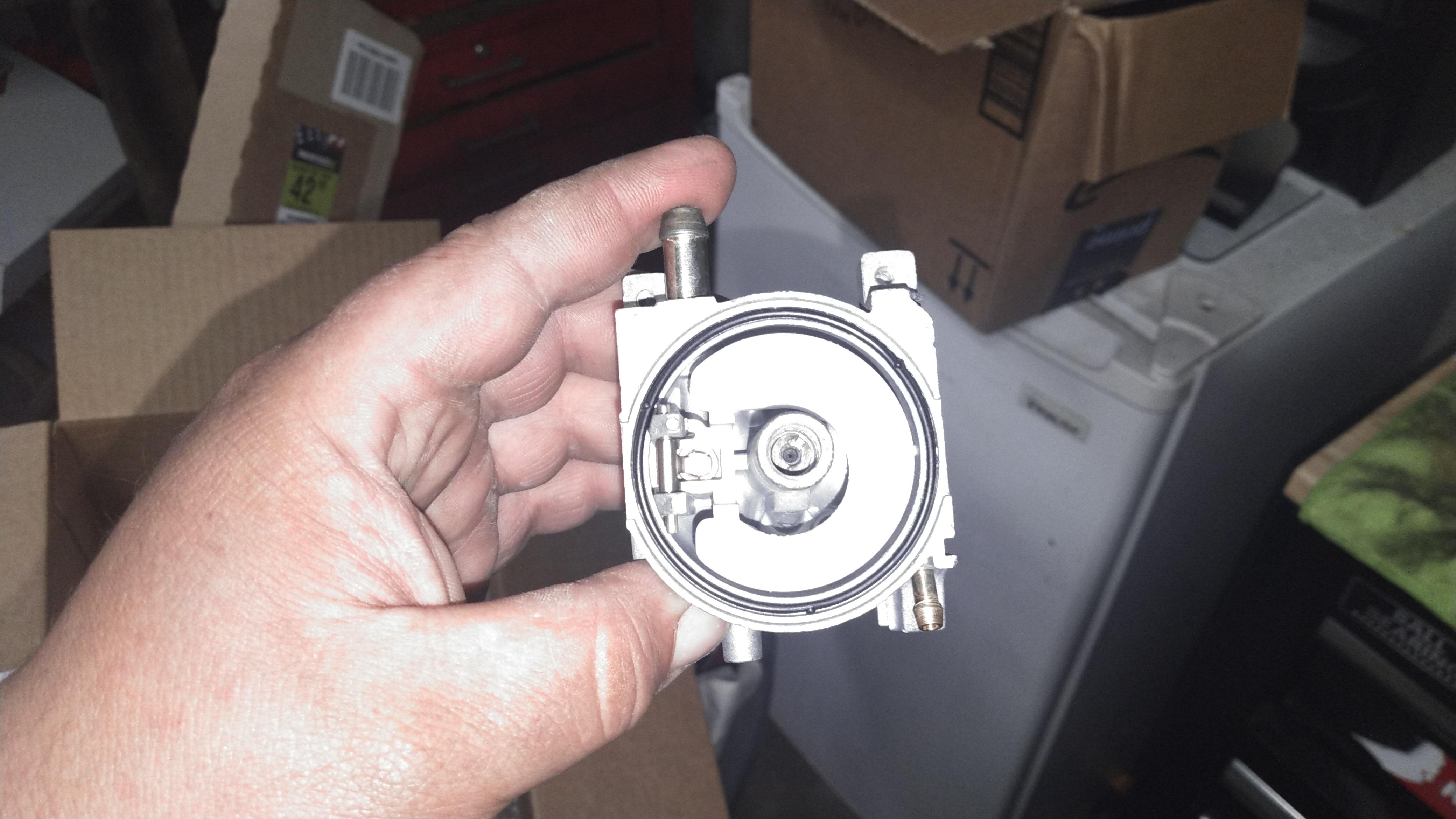

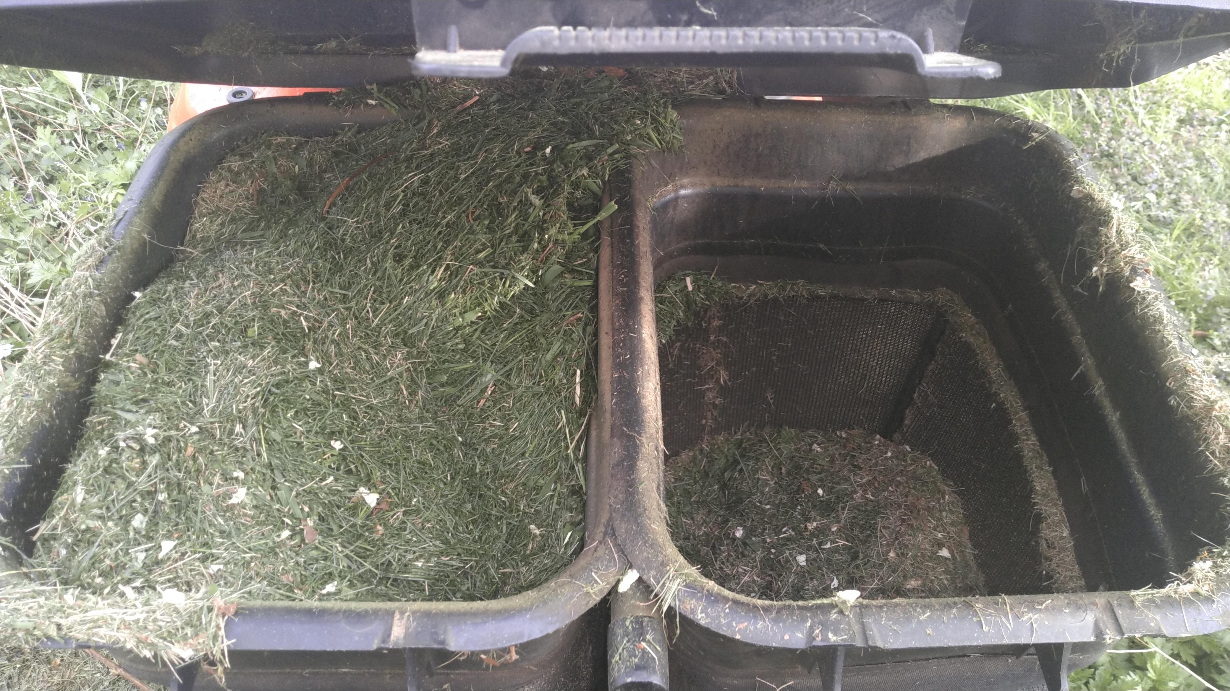

Successful test of the bagger on the Husqvarna rider and got started on the push mower that came in last night. I'll have the drive cable tomorrow. Carb is in the ultrasonic cleaner and it'll be out and back together later. New fuel line installed as well. Had some water in it as well so I drained and flushed the tank.

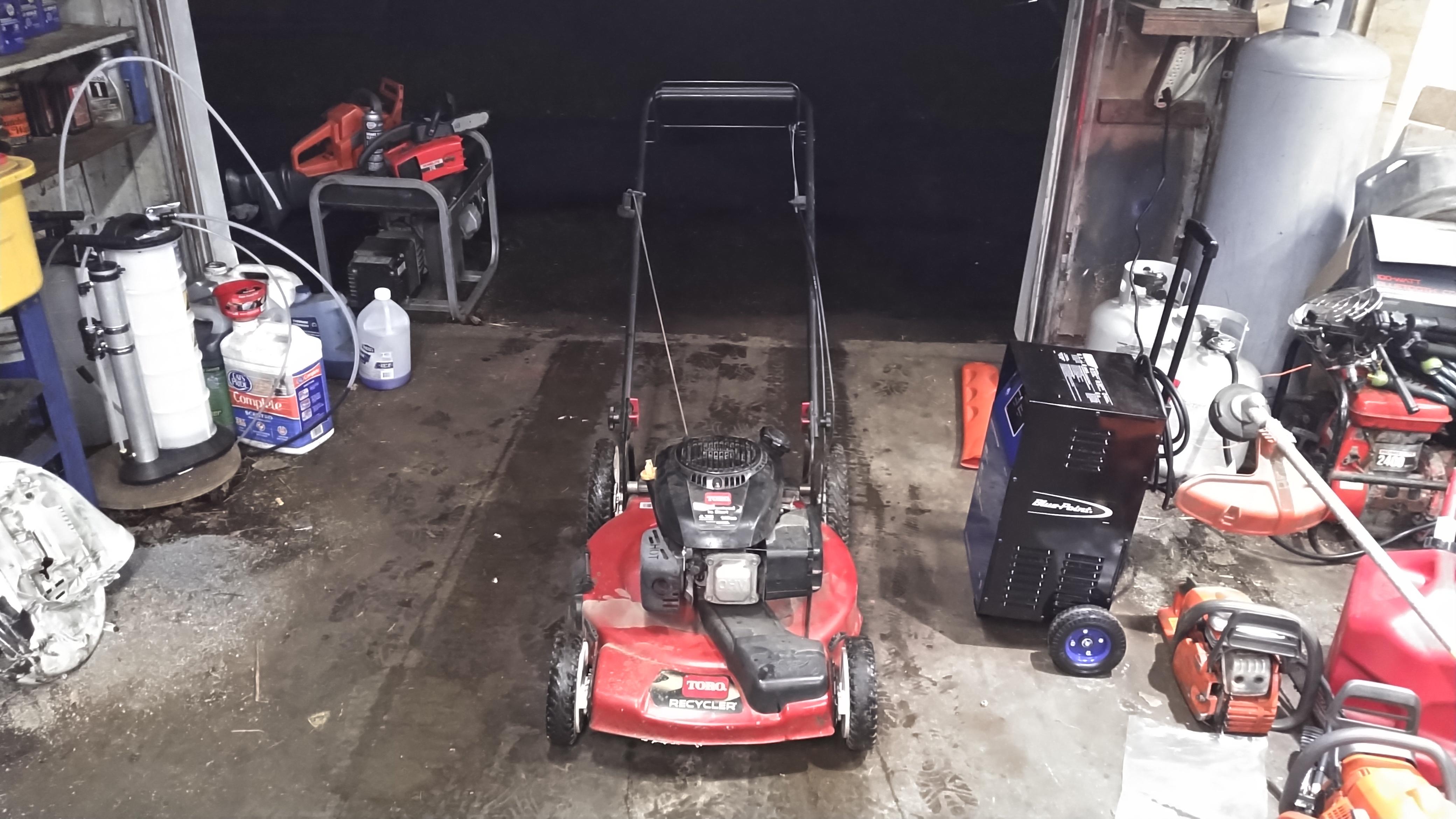

Been a very busy week here.

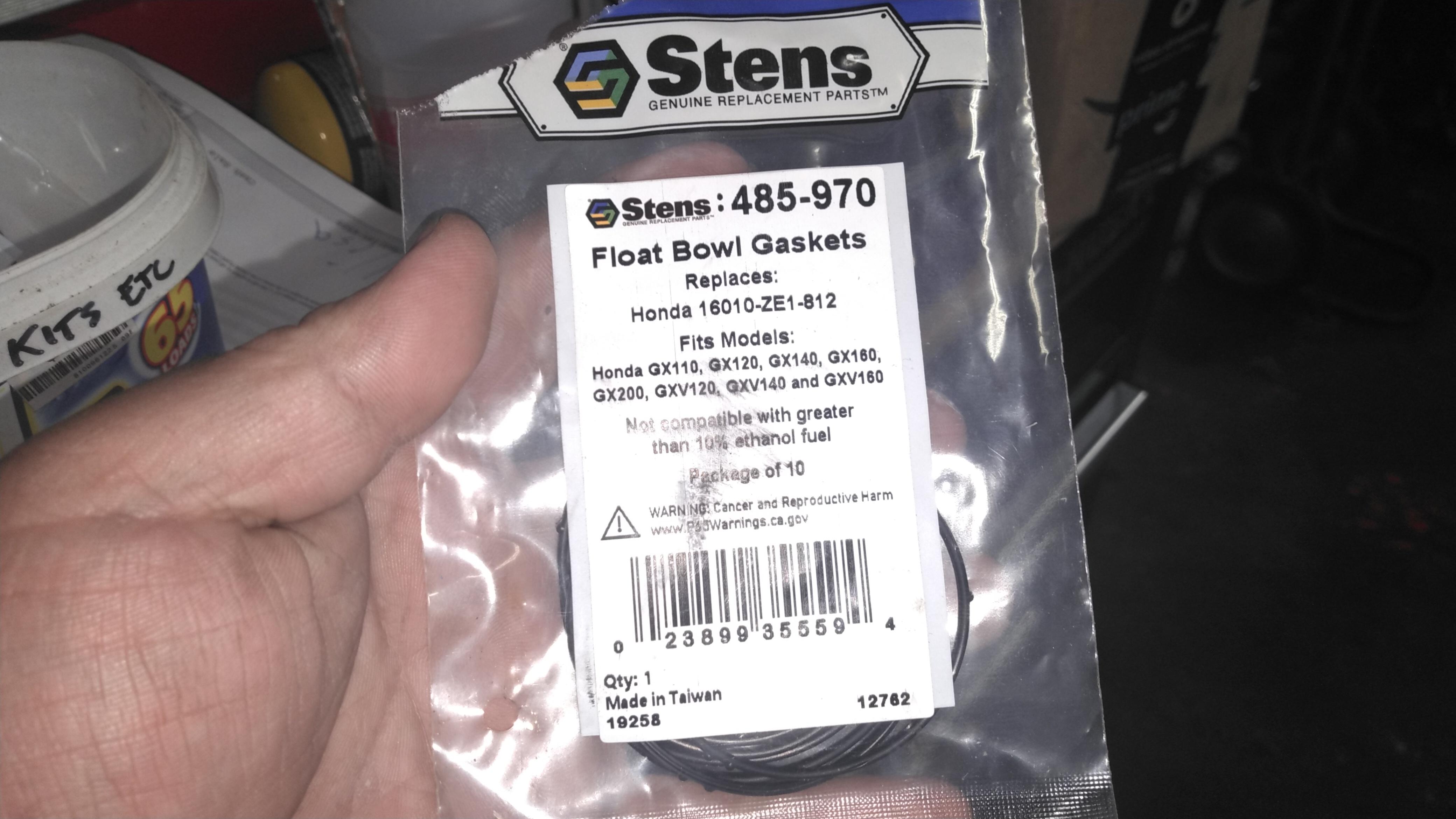

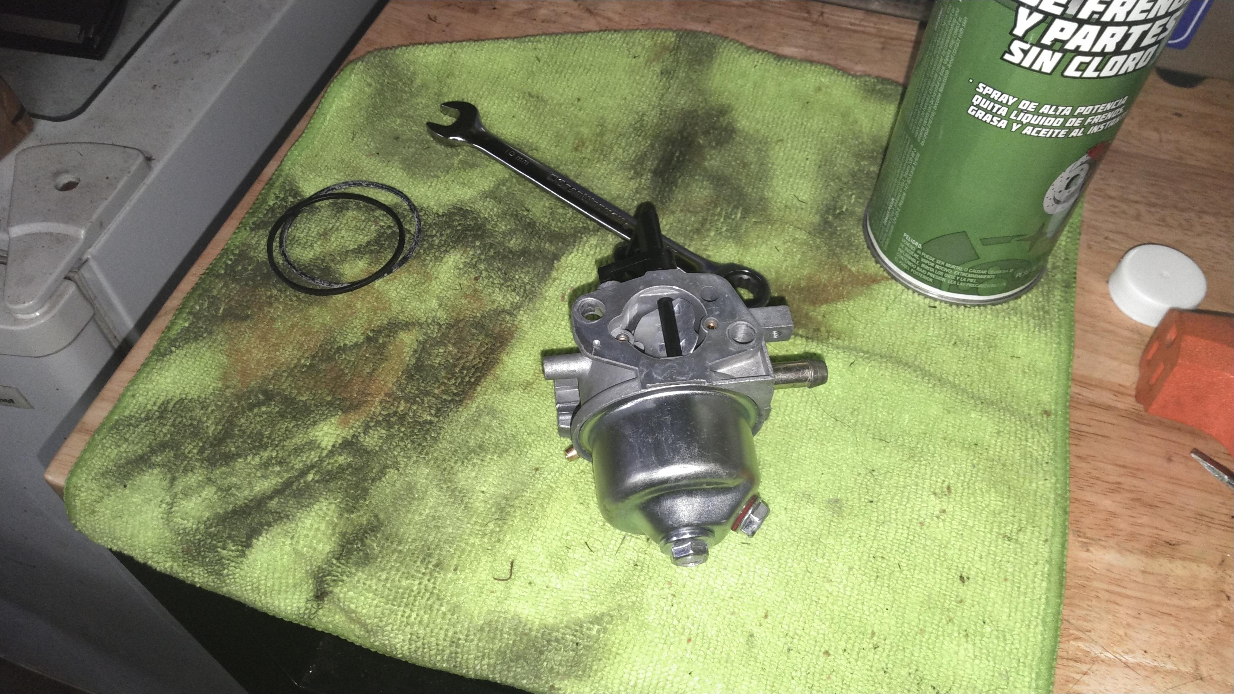

Toro Recycler with the Kohler 149cc OHV engine is done. Carb cleaned and bowl gasket replaced, new fuel line, tank drained, flushed and dried, broken drive cable replaced, oil changed, blade sharpened, air filter blown out, and spark plug cleaned/gapped.

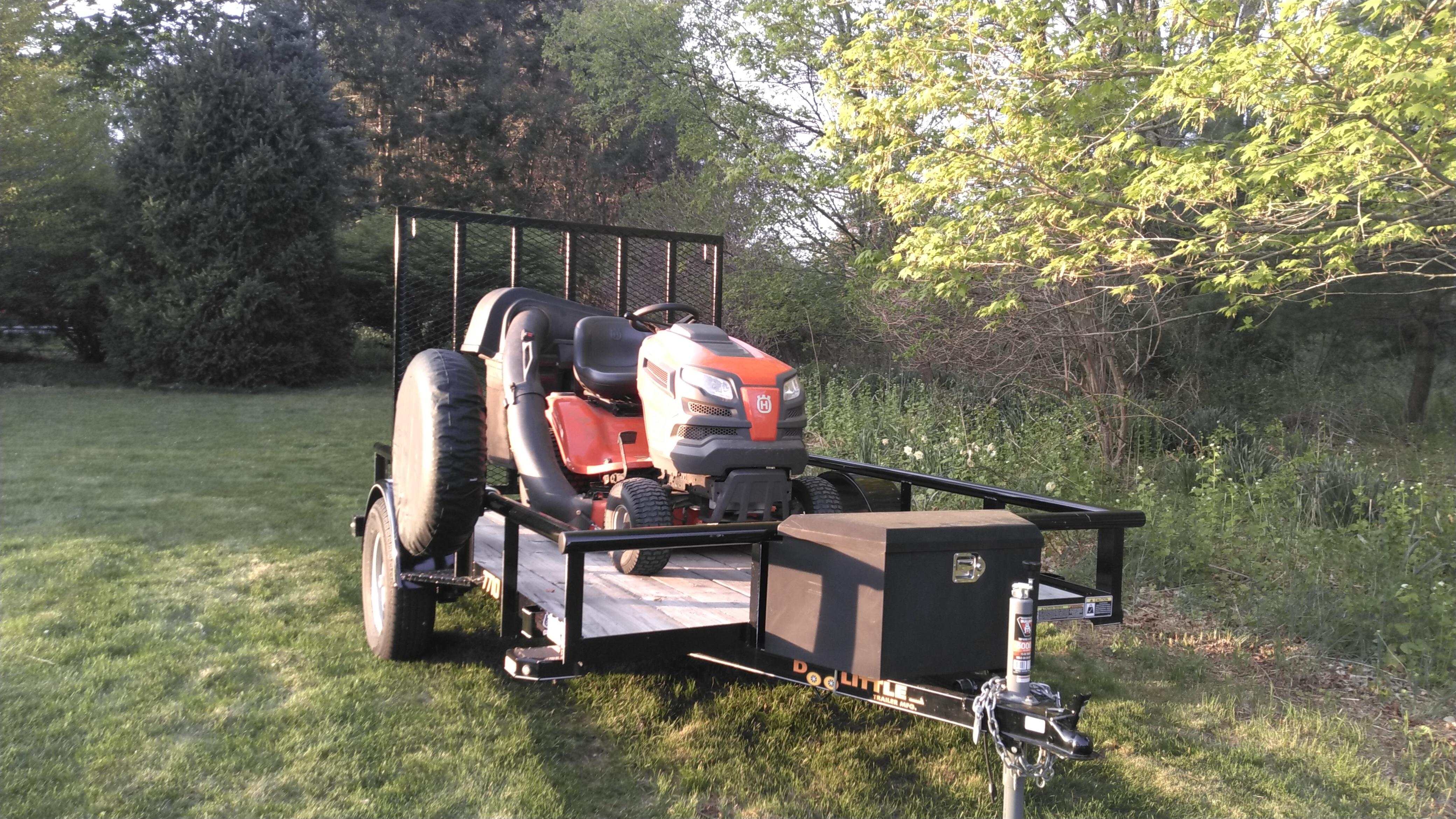

Husqvarna rider got serviced and I made sure it was bagging.

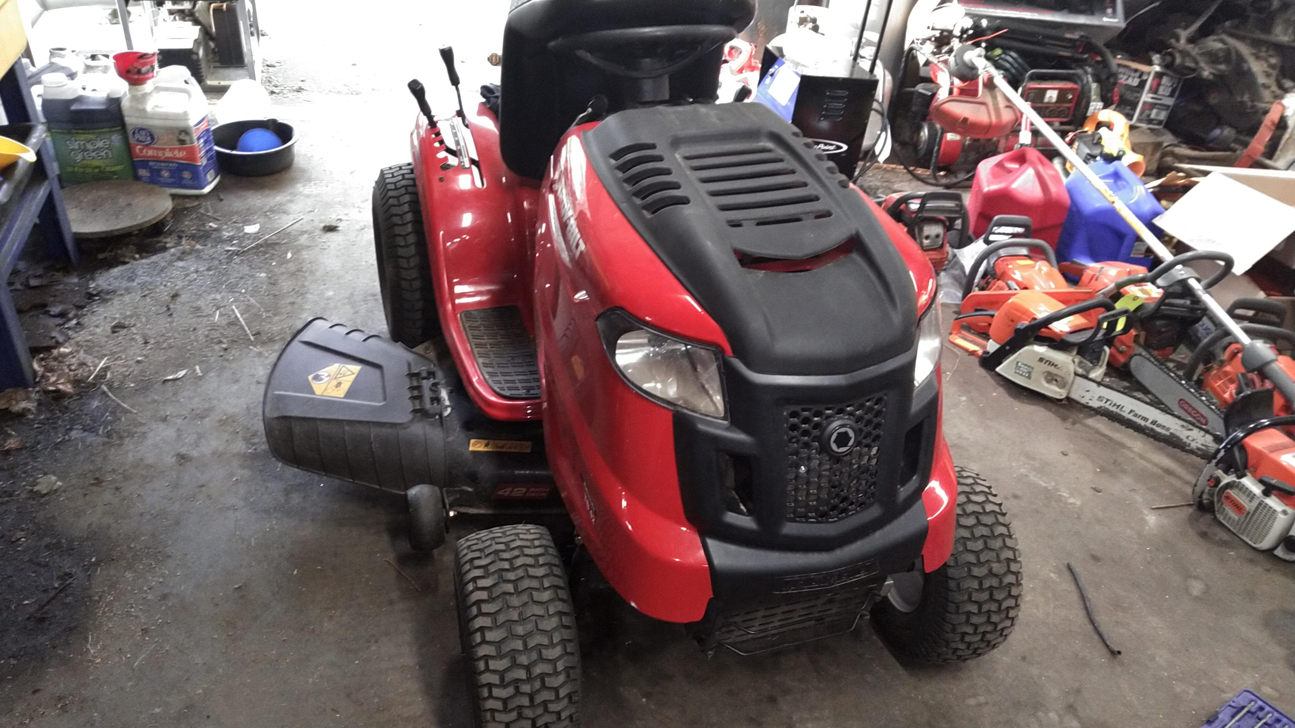

Troy Bilt 42 rider in for a service, deck belt and new blades. Picked it up this evening after work. Might need a battery as well, it's on the charger overnight.
