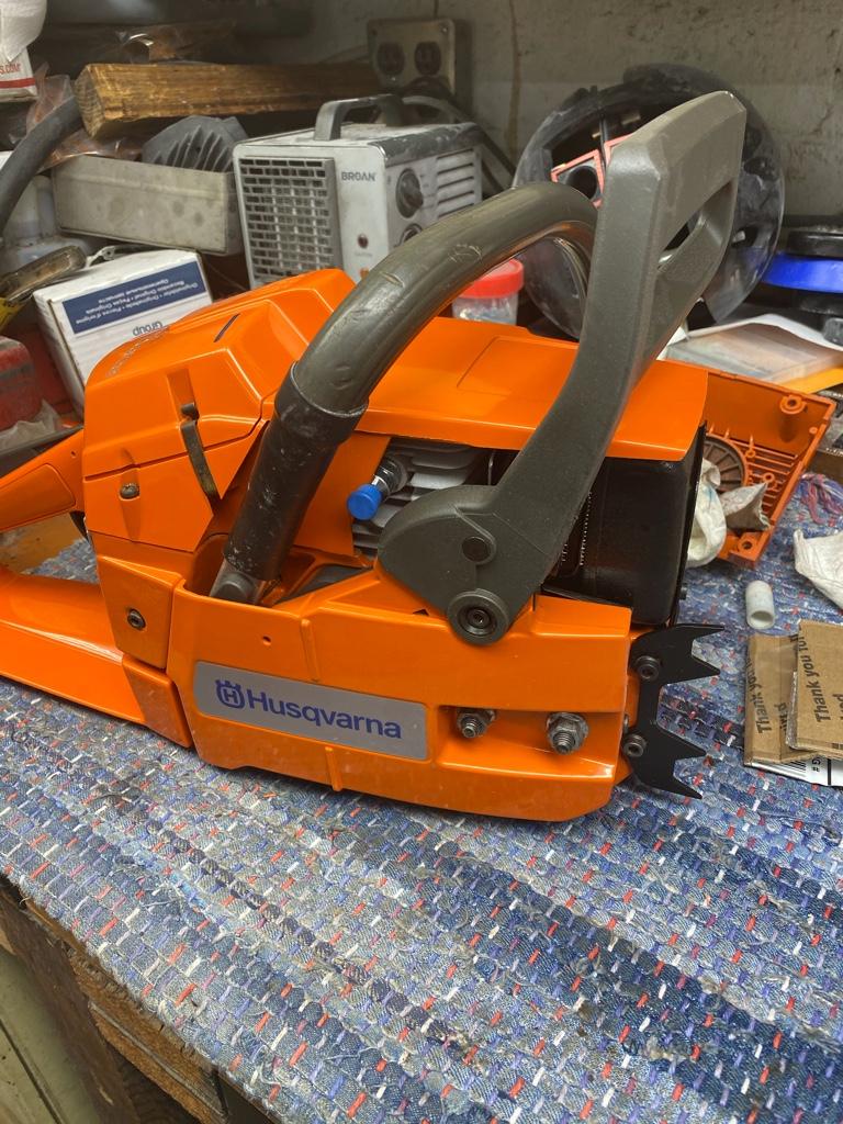

Took a 670 top end off and putting on a 272 top end for a customer.
A guy has to drill the impulse port in the carb and add a 630 or husky carb cover that doesn't have the external port.
View attachment 284060View attachment 284061
I've drilled into the intake block and added a impulse port so I could use the 670 carb. with a 272 cylinder.

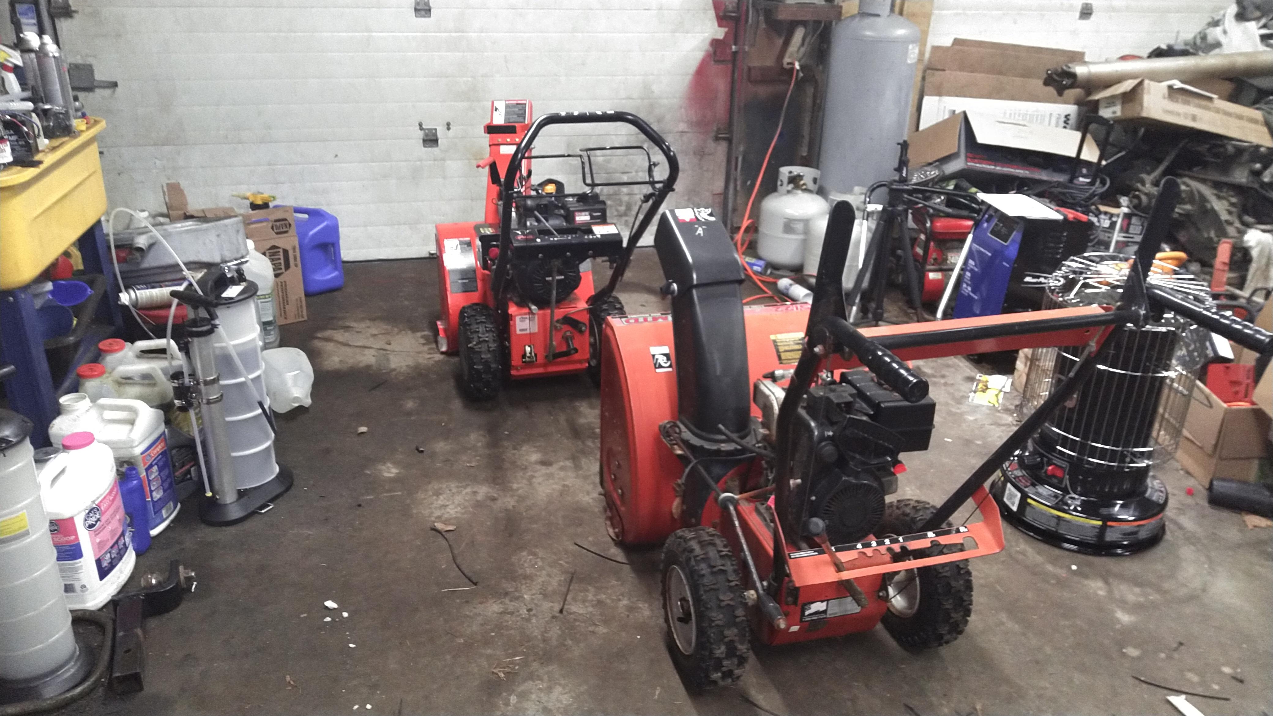

Snowblowers #10 & 11 I've worked on this snowblower season.
MTD is getting a carb rebuild, new fuel valve, fuel and primer lines, belts, auger cable and belts plus an engine service.
Ariens 5520 is getting a carb rebuild, new fuel valve, fuel and primer lines plus a recoil rope and engine service.
Started doing a bigger clean up of the shop which I'll be continuing on tomorrow evening after work. Put the old malfunctioning propane heater in the back shed for now. Picking up the new regulator/hose and fan kit this afternoon at Tractor Supply and I'll pick up the new heater next weekend. Have the kerosene heater for the time being.

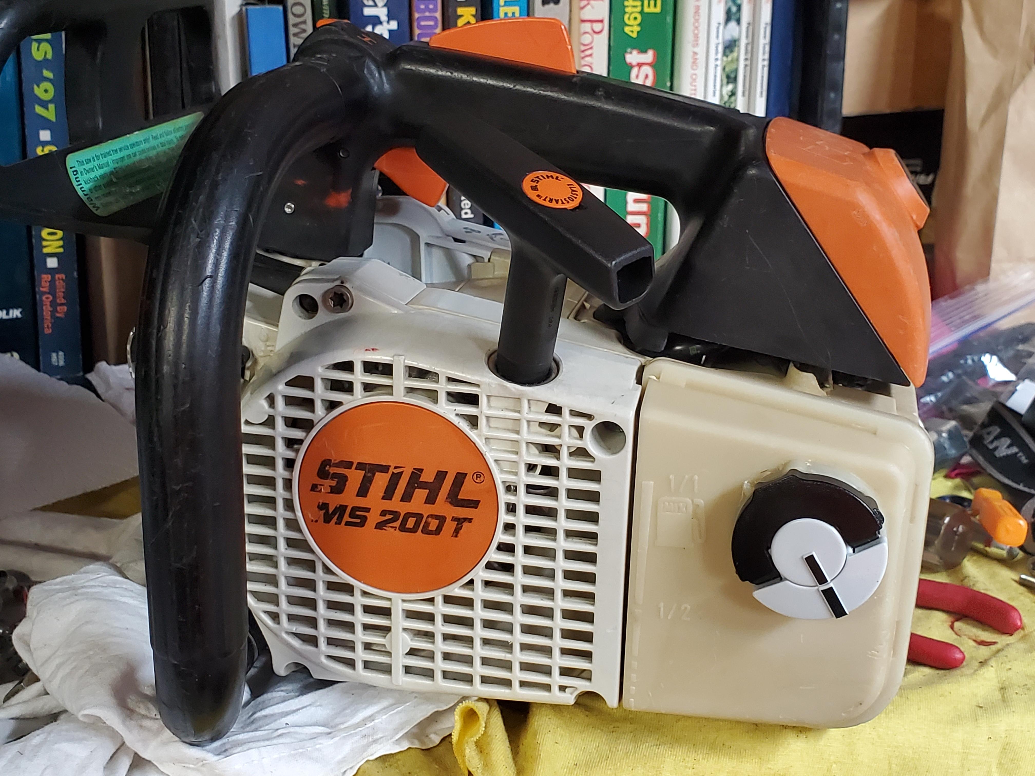

Finished my full rebuild on the new to me 200t. Did OEM bearings, gaskets, seals, piston, fuel line, filter, impulse line and carb kit. Got all new av's, elastostart and clutch cover. Did a muffler mod, timing advance and used a .015 base gasket. Ill fire her up tomorrow after a nap. Working nights this week.

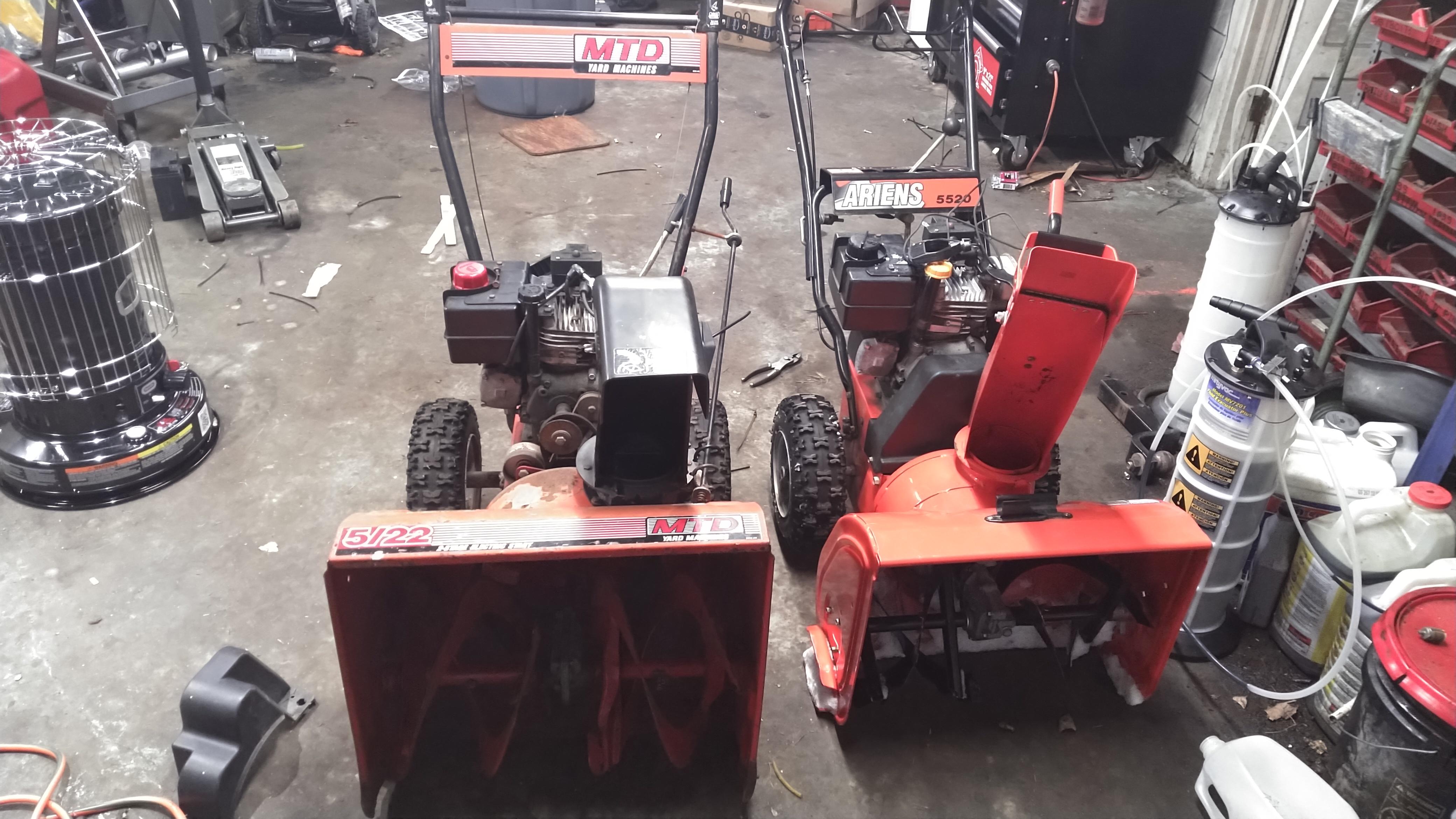

MTD 5/22 got the carb reassembled with a new OEM kit and aftermarket float, carb reinstalled, fired up first pull! Let it warm up and then adjusted the carb as needed. Changed the oil and spark plug. Still waiting for the belts and cable which I'll have this week. Tomorrow I'll get started on the Ariens and do some more cleanup.

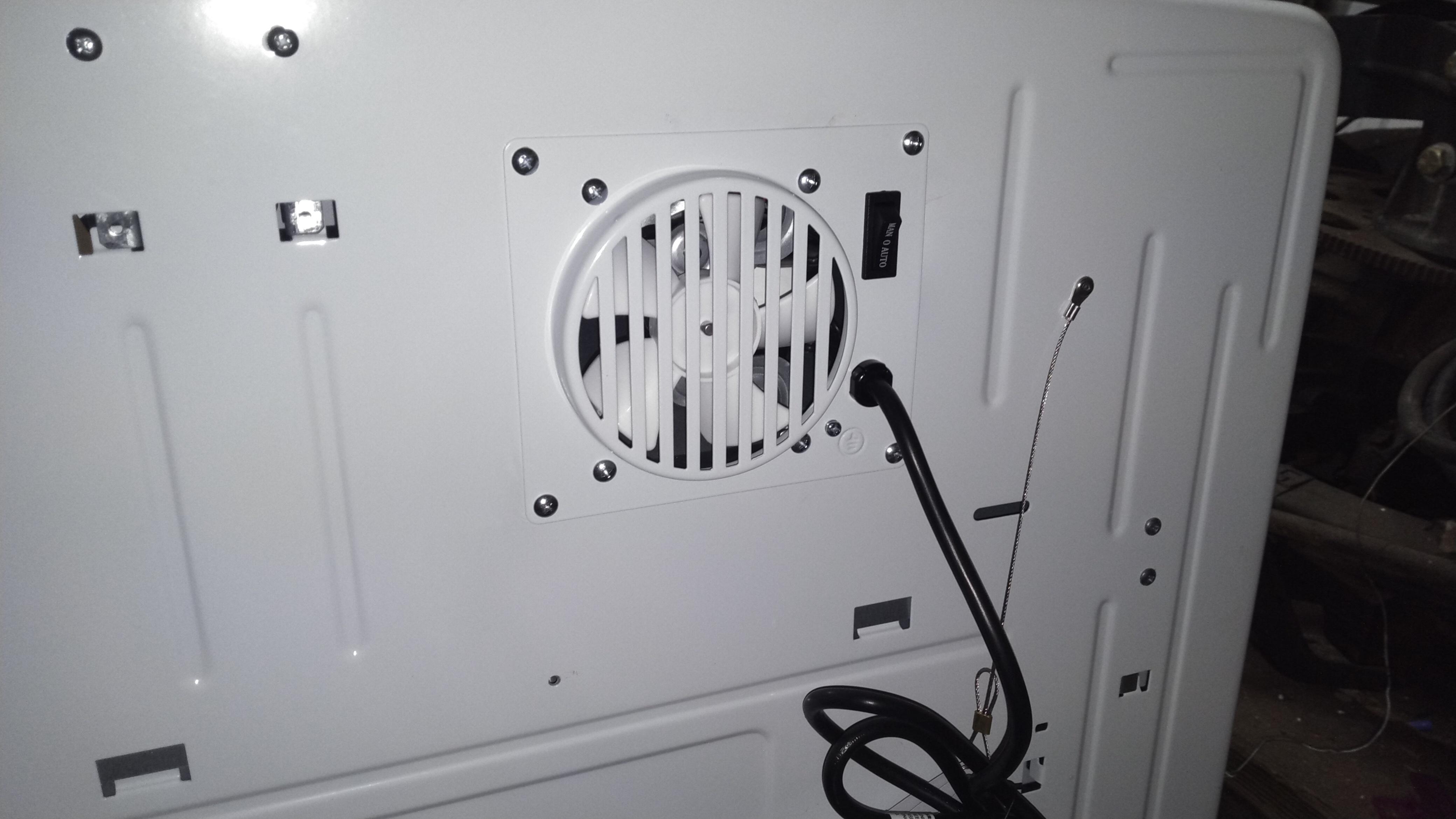

New heater is getting delivered Wednesday along with a fan kit, 90 degree 3/8 npt to 3/8 male flare adapter and a new 12' hose and regulator assembly. That'll be Wednesday evenings project.

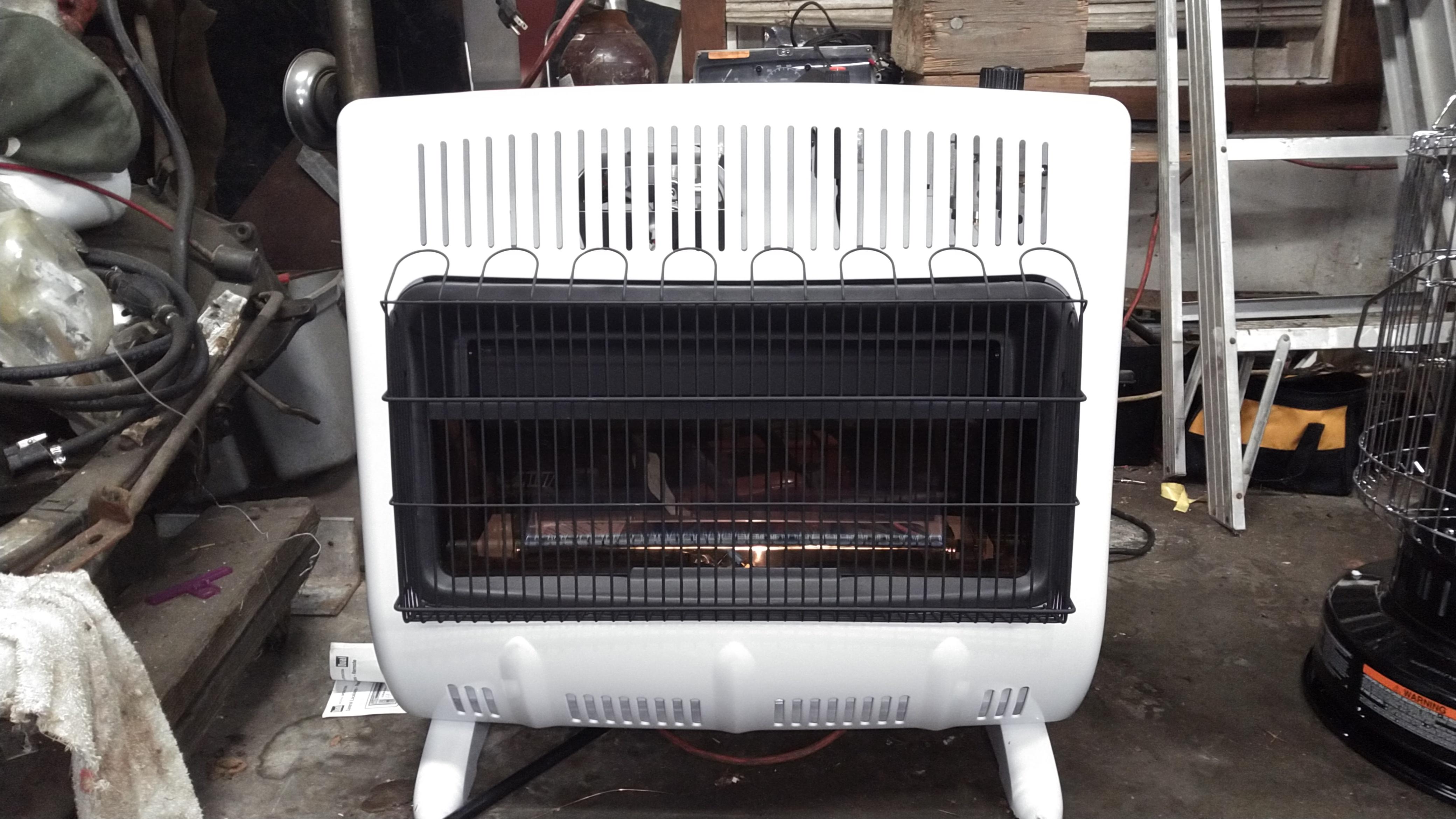

Heater ended up arriving this morning. Got it all setup when I got home from work. Pumps out tons of heat. Took about an hour to get setup. Gonna do some cleanup after dinner.
