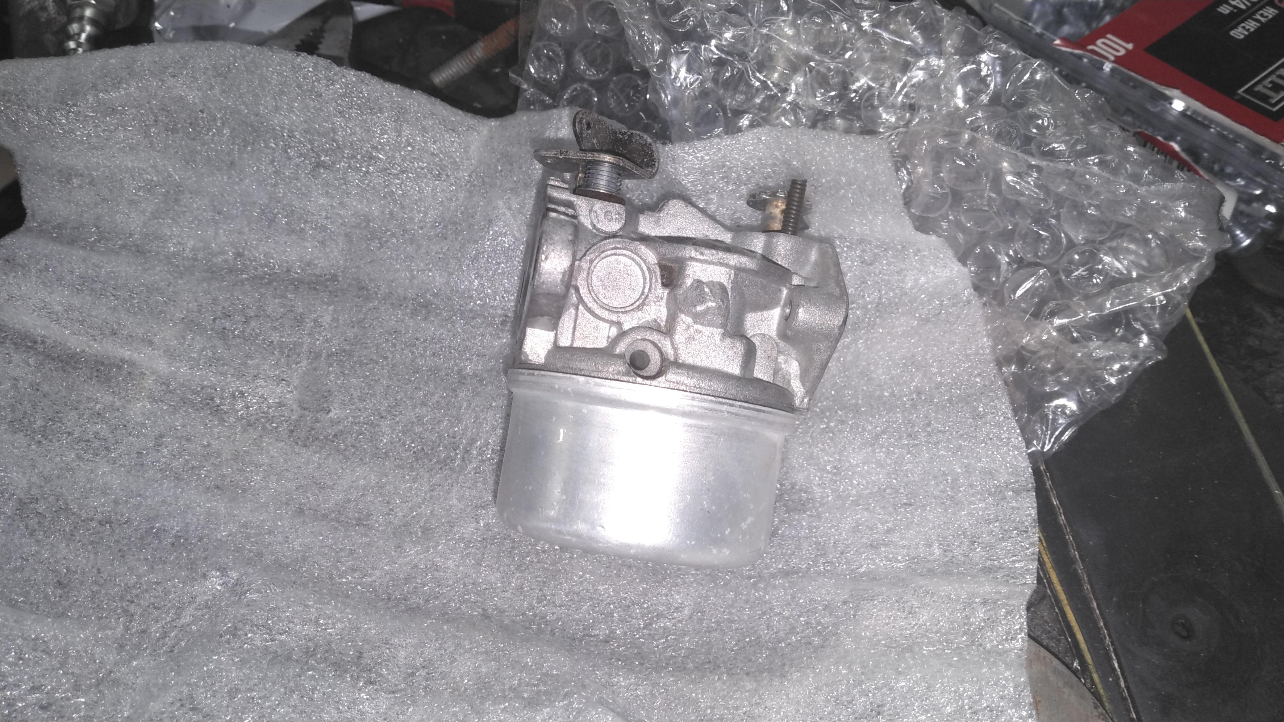

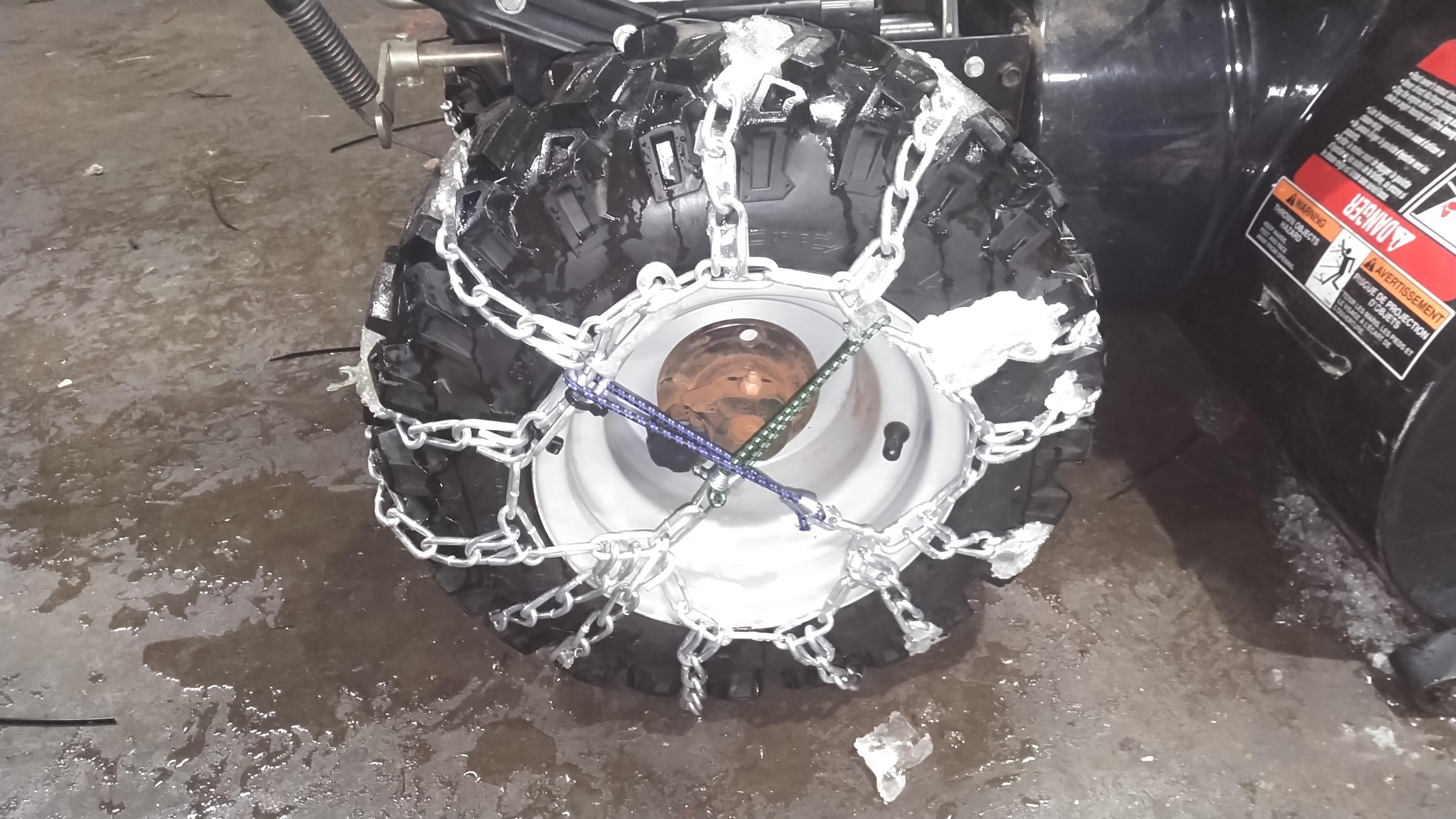

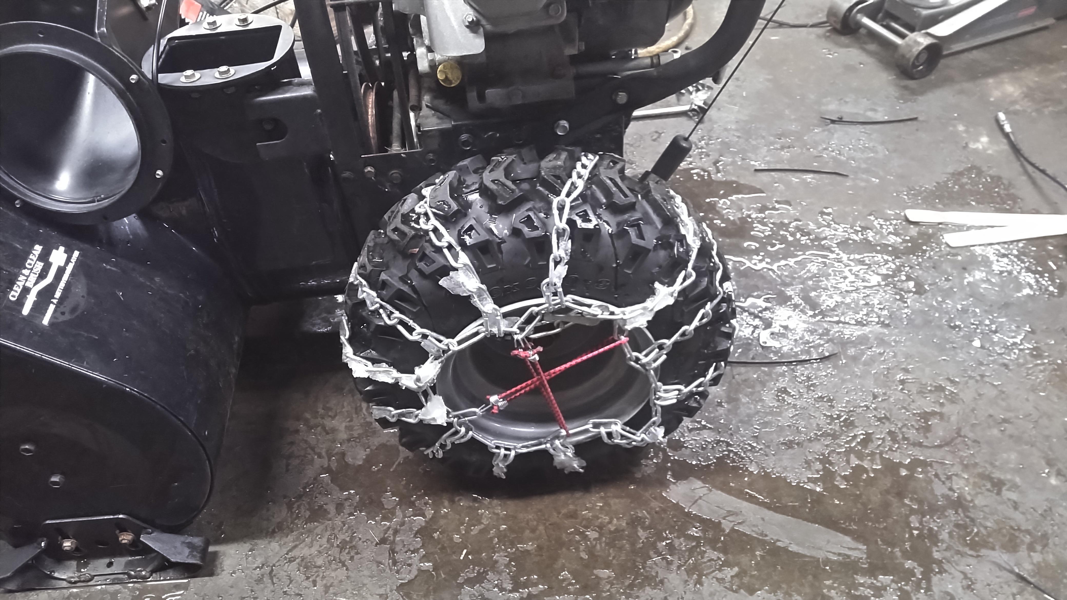

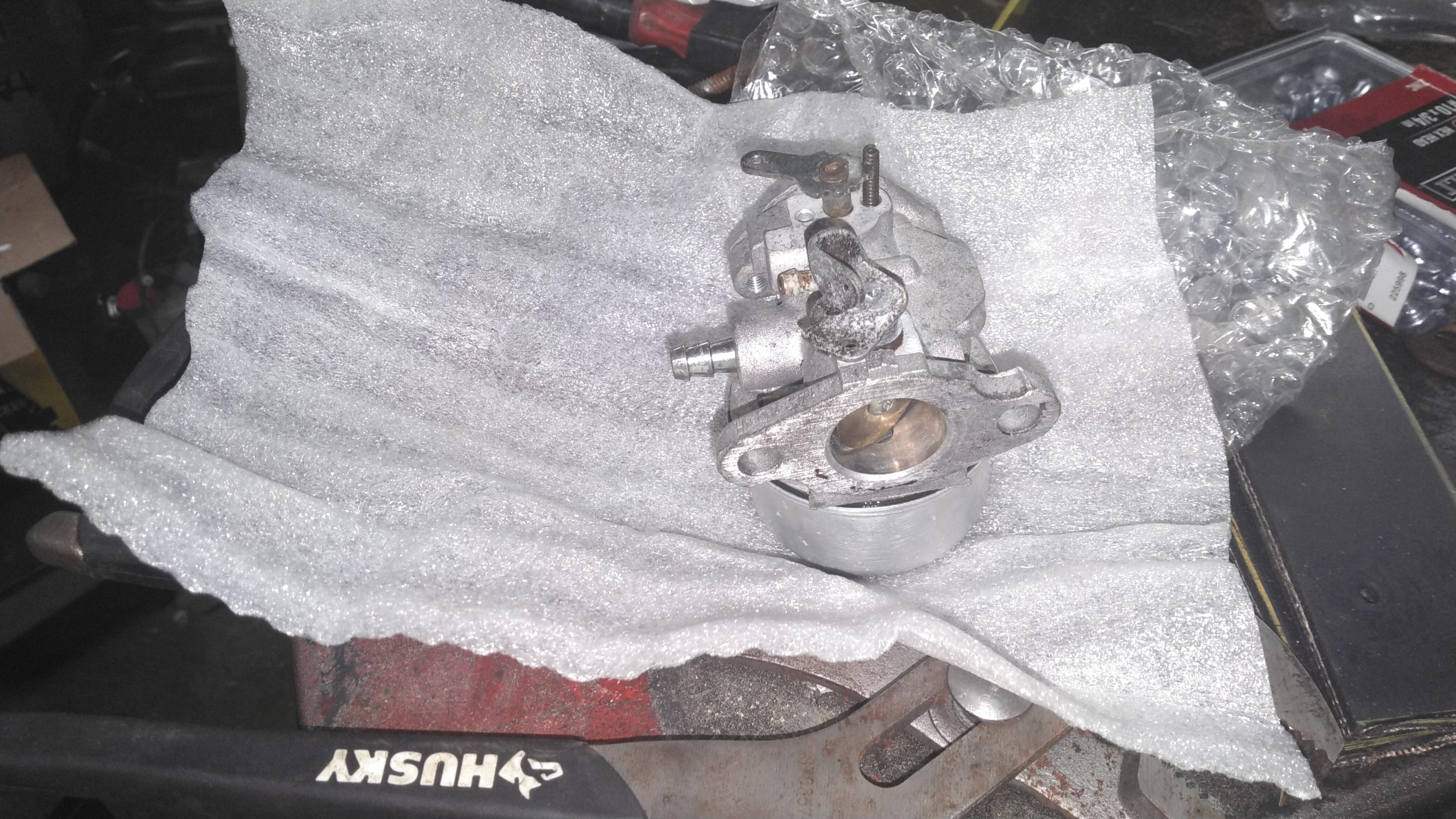

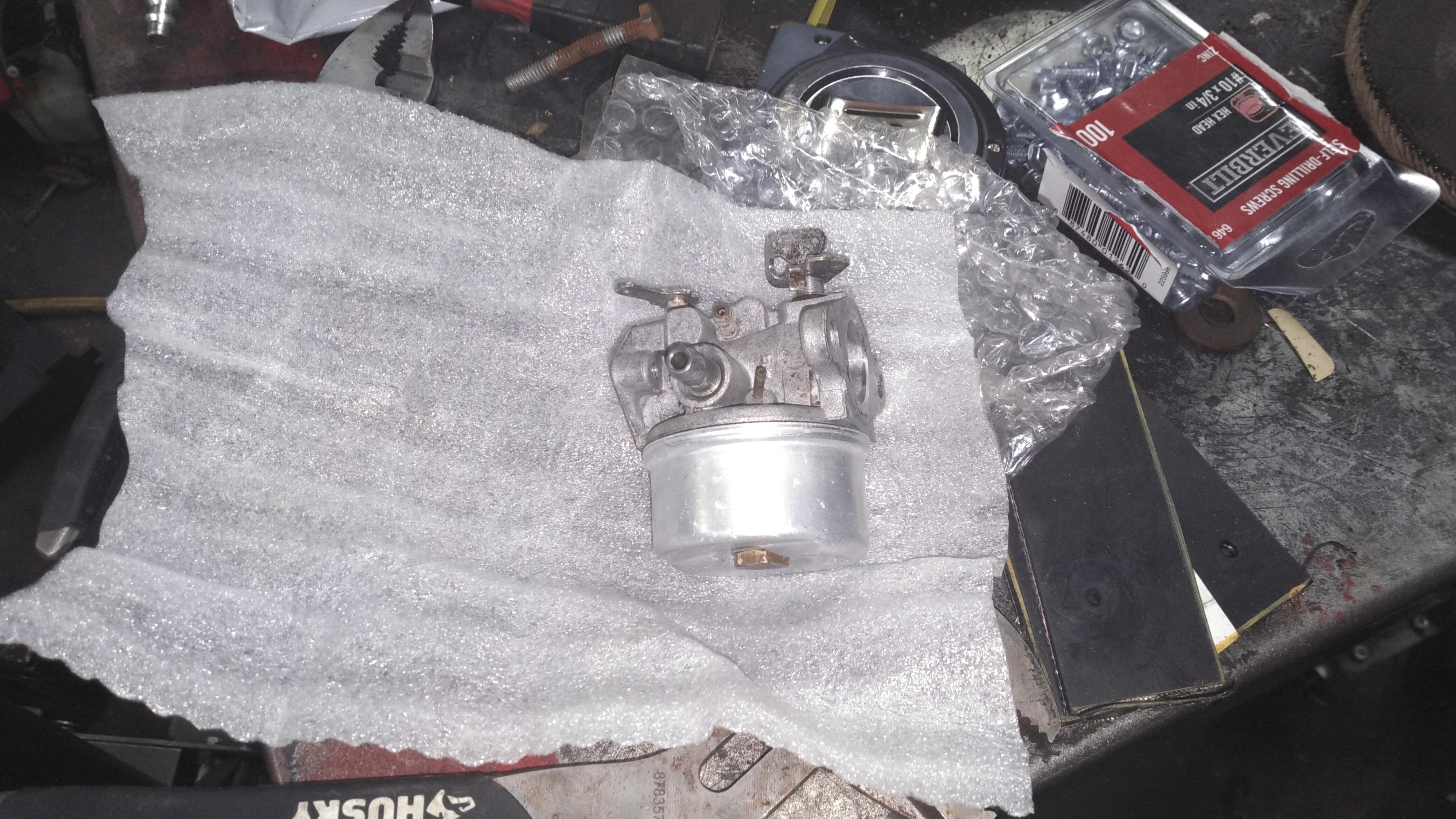

Tire chains installed on a Murray snowblower, greased the augers, adjusted the scraper bar and shoes. My 12" 1/4" quick change impact driver bit extension will be here tomorrow so I can do the impeller mod. Only just waiting for a shear bolt kit as one shear bolt was missing and the other one was just a regular bolt. Not going to send it out with the improper shear bolts in the auger, have him hit something and ruin the gearbox.
Cleaned/rebuilt a Tecumseh carb for a buddy of mine. Just need to mail it back to him.
