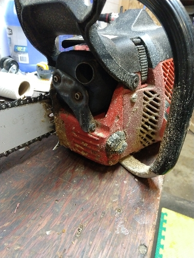

She may be ready for 3/8 chain..it really likes the big muffler.

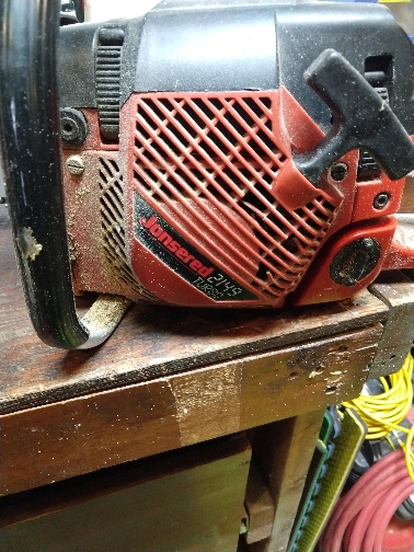

I love a 2149!
Me too! It is a great running saw I did some light grinding on this saw a few years ago. no lathe work...just transfers to Mike's #s the best I could. The saw is hard to stop with.325 chain.
Here she is dusted off with 18" 3/8 Sugi.
Going to try it this week

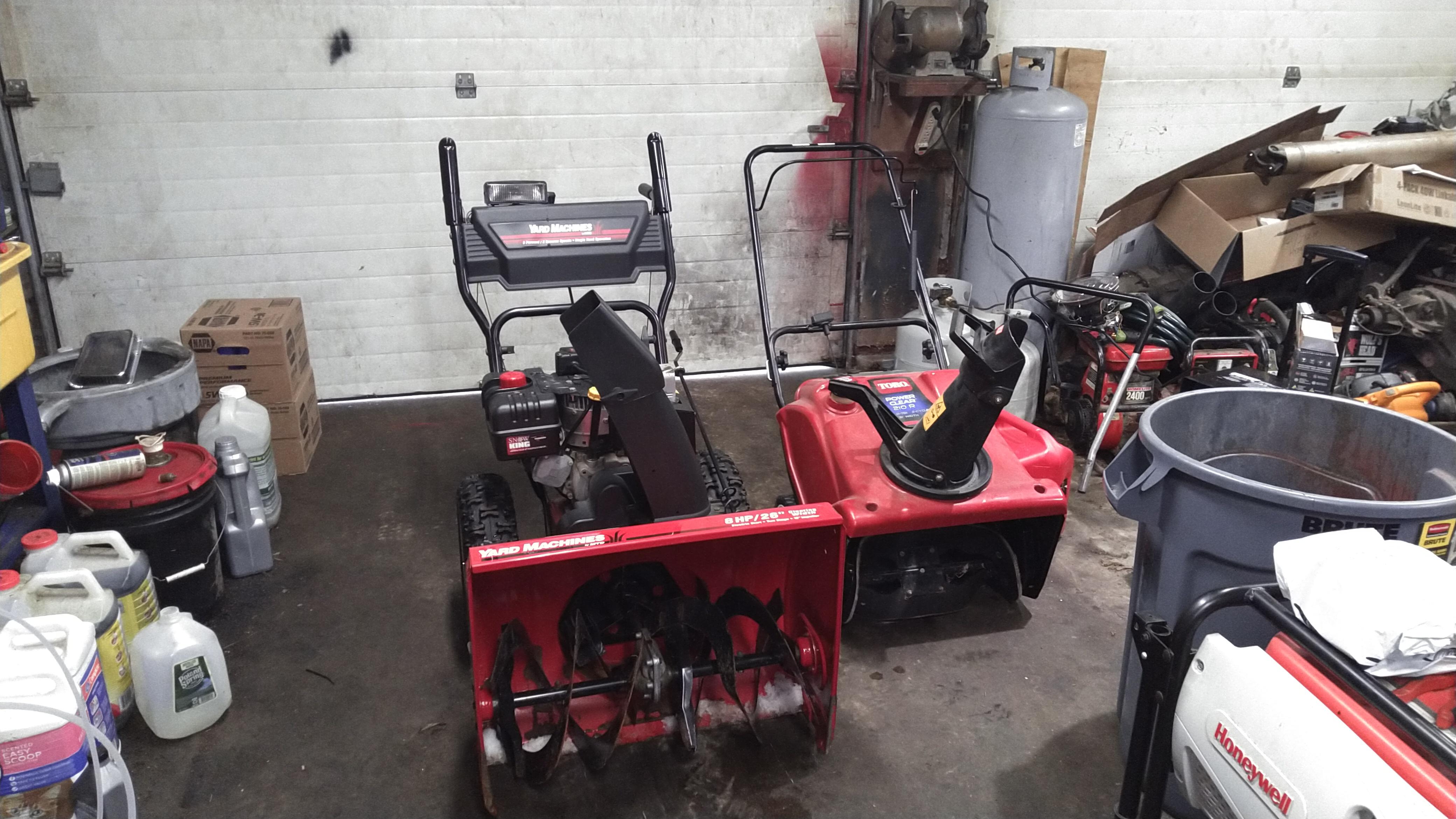

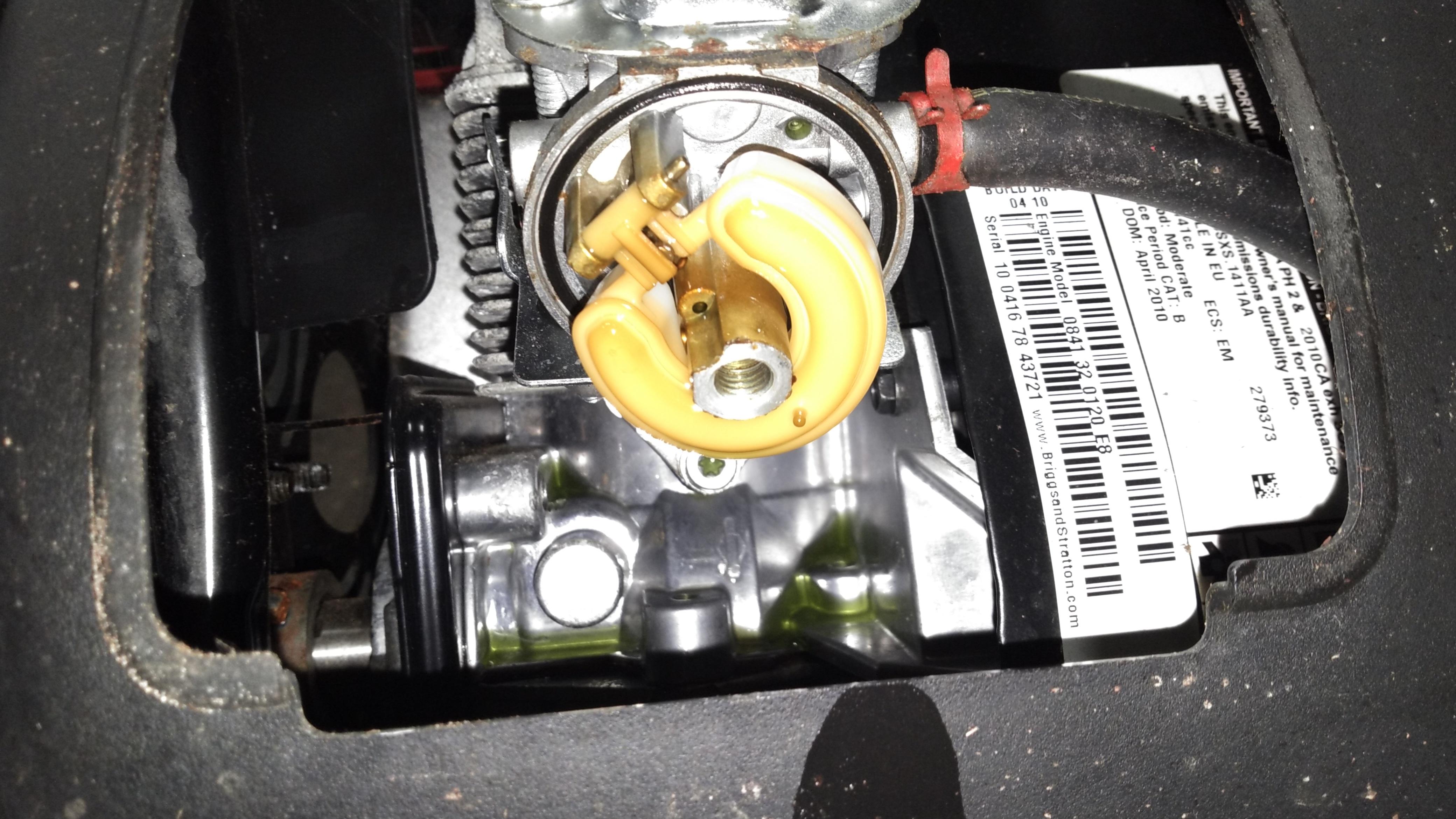

Picked up two snowblowers for service/repairs. The Toro is a Briggs R Tek 2 stroke and wouldn't start due to rotten fuel and a dirty carb, however the ultrasonic cleaner took care of the carb. Flushed the tank with some fresh fuel.
The Yard Machines 8/26 is in need of a carb rebuild (runs but surges), a service check over, and a new 120 VAC starter. An OEM one is almost $200! There are the Chinese ones on Amazon for $65 that have good reviews. I'll have to talk to the owner. Changed the oil, plug, and ordered a set of slide shoes for it.
Went to Napa and stocked up on oil as well. Their brand of oil is on sale for $2.29 a quart till the end of the month.

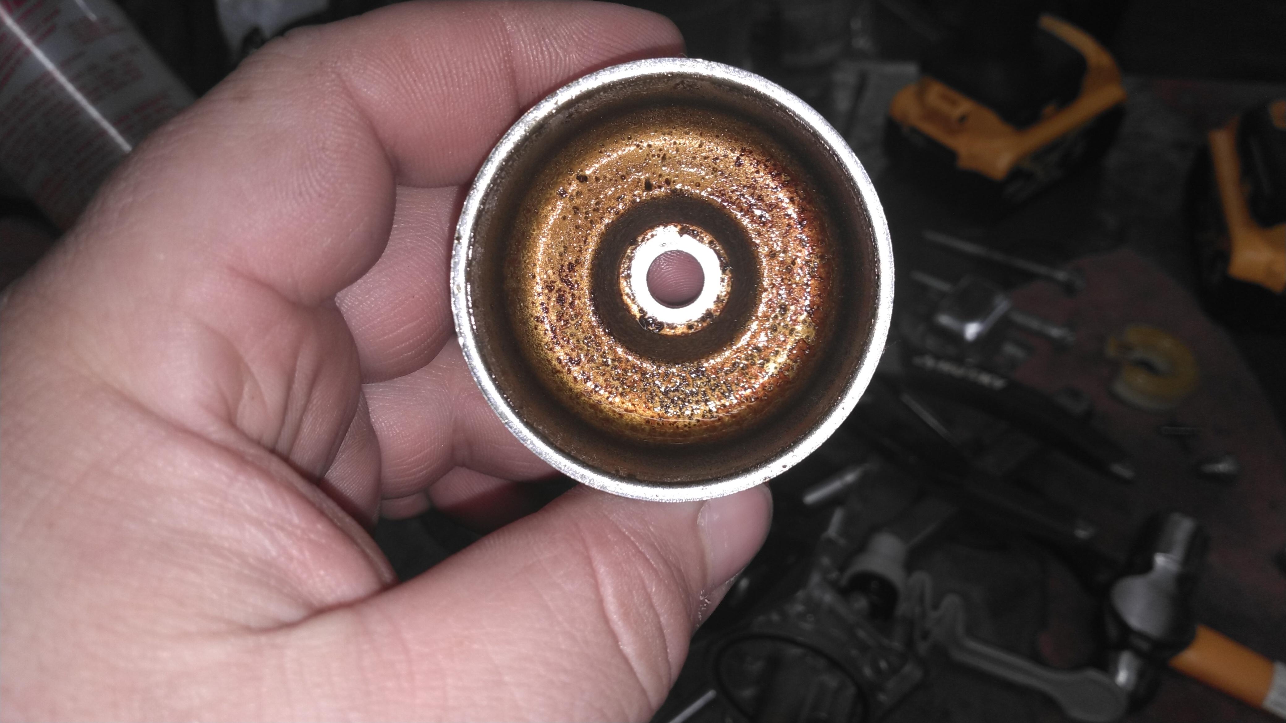

Cut off wheel on a dremel works better for making a slot for the end of the 194 deflector. This one is kinda sloppy because I tried to use the sharp corner of a flat ended carbide burr.

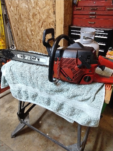

F77A0C4A-18EA-4B3B-A01F-5117EA3BFA62.jpeg 2061C39D-D4DE-4731-B081-D474C2619E6C.jpeg Converting the 266 case to fit the 272xp cover and clear the larger 272xp style air cleaner. Some machinable epoxy smearing into the lip to drill and tap the back cover screw that does not line up. Then a stainless steel tap drill and tapped to the front cover hole. With a hold down screw and some locktite for the front screw hole that’s does not line up. Minor modification to the top cover is pull the screw and take off the thickness of the tab from the plastic so that hat sits flat still

View attachment 281433 View attachment 281434 Converting the 266 case to fit the 272xp cover and clear the larger 272xp style air cleaner. Some machinable epoxy smearing into the lip to drill and tap the back cover screw that does not line up. Then a stainless steel tap drill and tapped to the front cover hole. With a hold down screw and some locktite for the front screw hole that’s does not line up. Minor modification to the top cover is pull the screw and take off the thickness of the tab from the plastic so that hat sits flat still
I see the raging cajun has his thinking cap on tonight LOL!!
