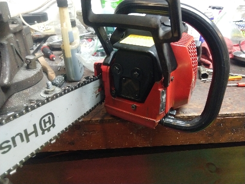

Anyone with experience using the 2 piece china coils for the series 1 jonsred 625? Have the neighbors saw at the house going over it and after rebuilding carb and going to tune the thing idles great and accelerated fine up to a certain point then starts missing. Almost 100% the coil is breaking down all the switch wiring looks good. Don’t like china parts but kinda the only option for these commonly failed ignitions.

Symptoms sound as if you have a one piece coil flywheel with a two coil set up. I've used a couple of the chinacom two piece kits and honestly have worked well. I should have a pic saved of the two different key positions on one and two piece flys. Let me try to find the pic. You helped me out on the 020 parts awhile ago.

The flywheel could be the problem for him. I have the China coil on my saw you sent me to build and it’s working fine for now. I wouldn’t sell it with that on there but it is working.

This saw is all original the neighbor has owned since new and it’s never had the flywheel taken off, has the 2 piece sem ignition. I’ll dig further into it tomorrow to make sure it’s not a switch but pretty certain it’s the coil. Told him his only option is a china set and he said to try one.

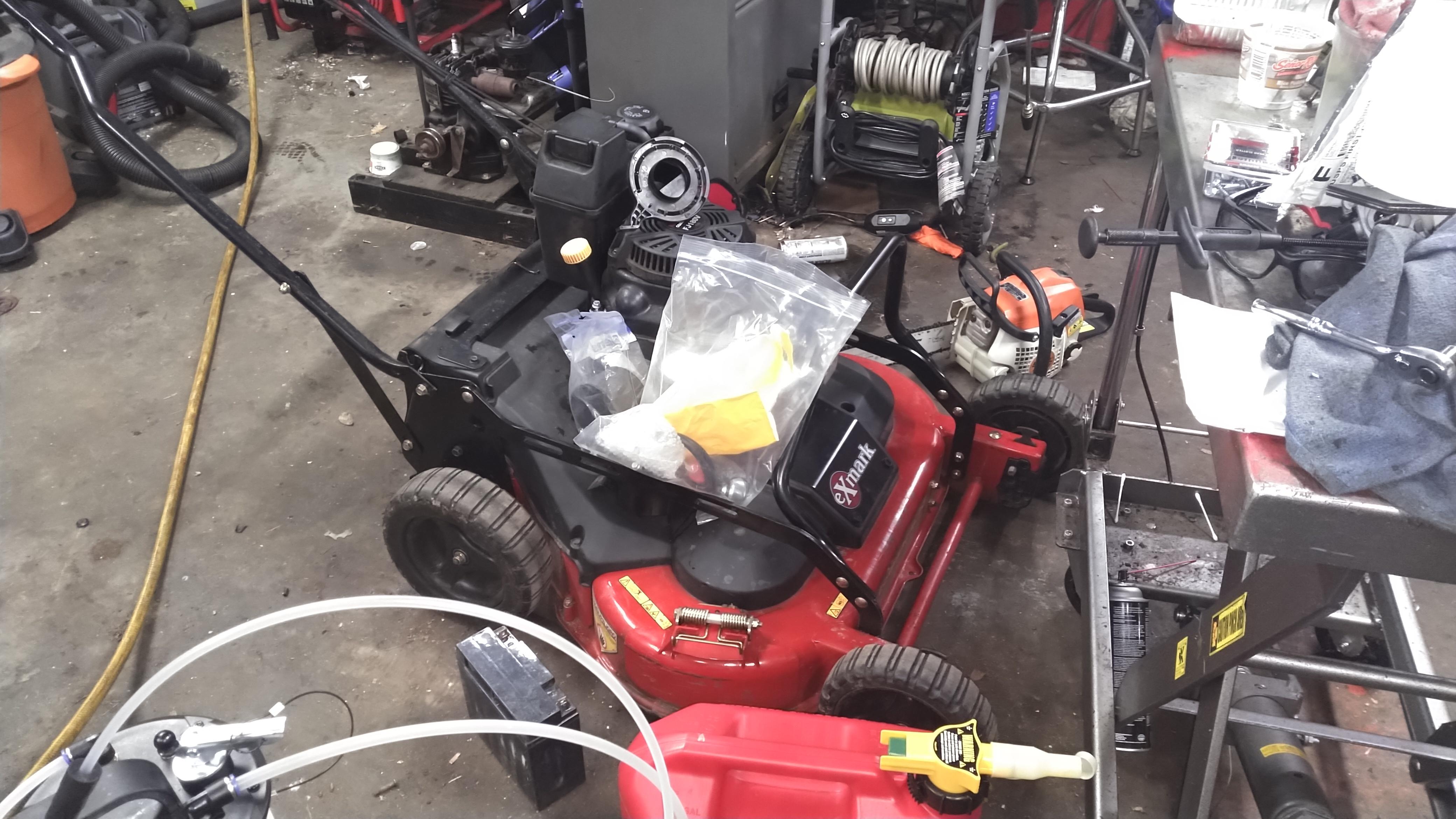

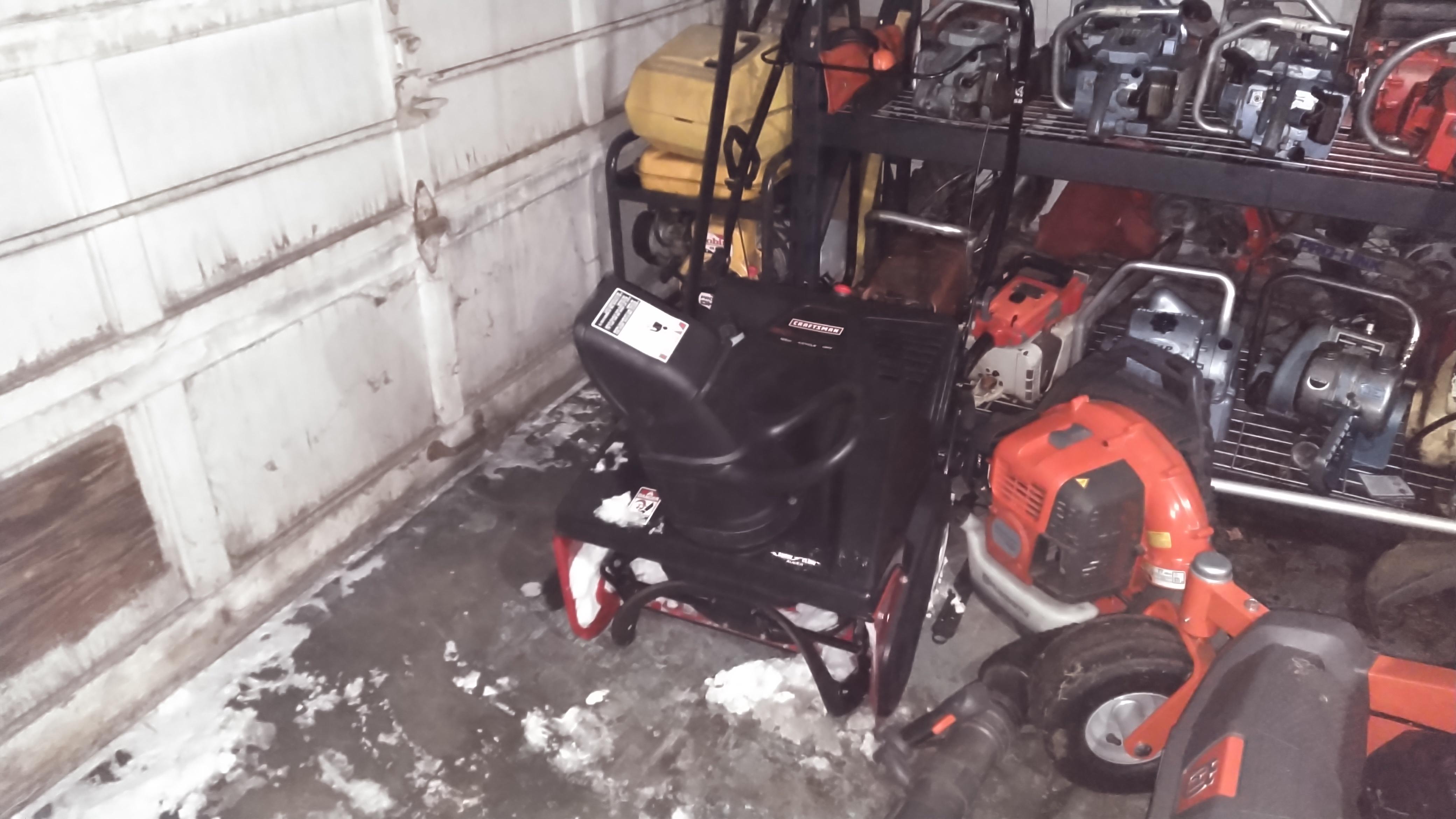

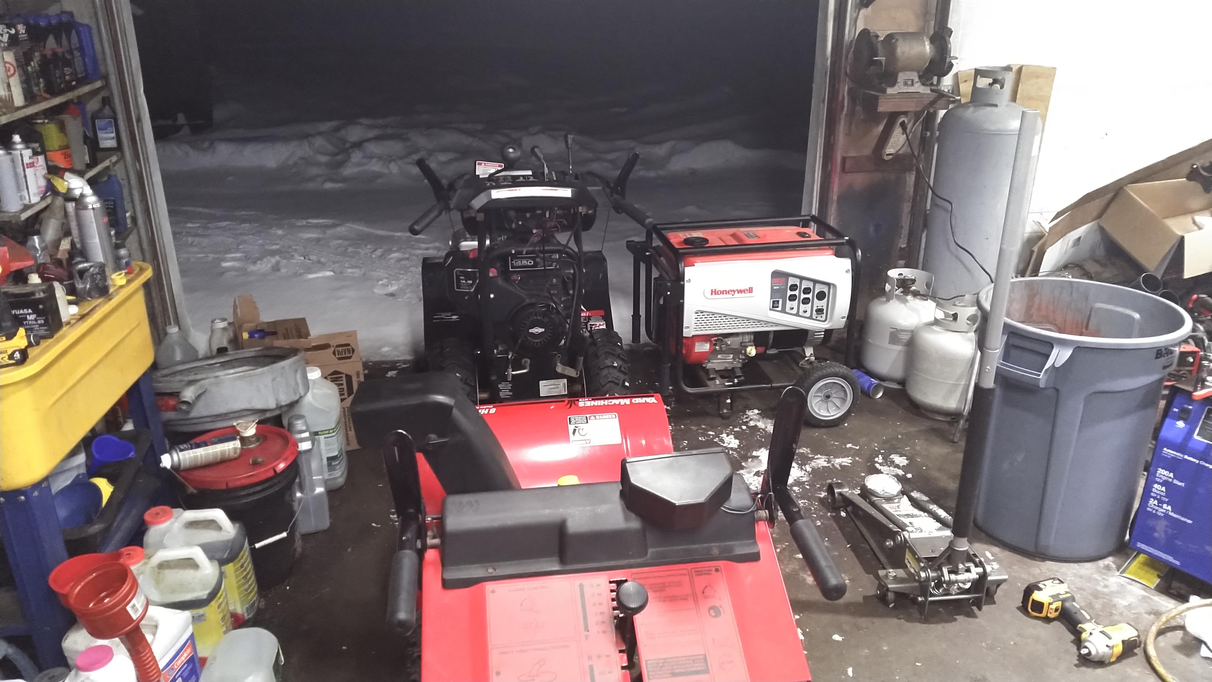

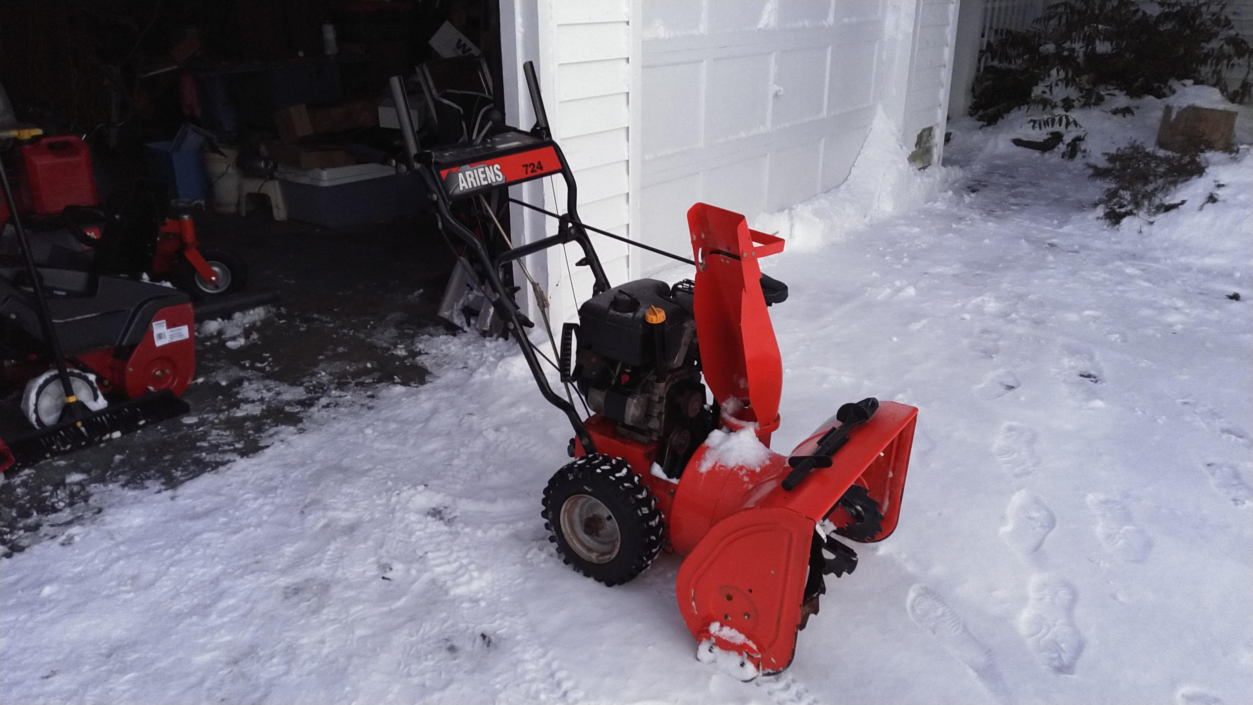

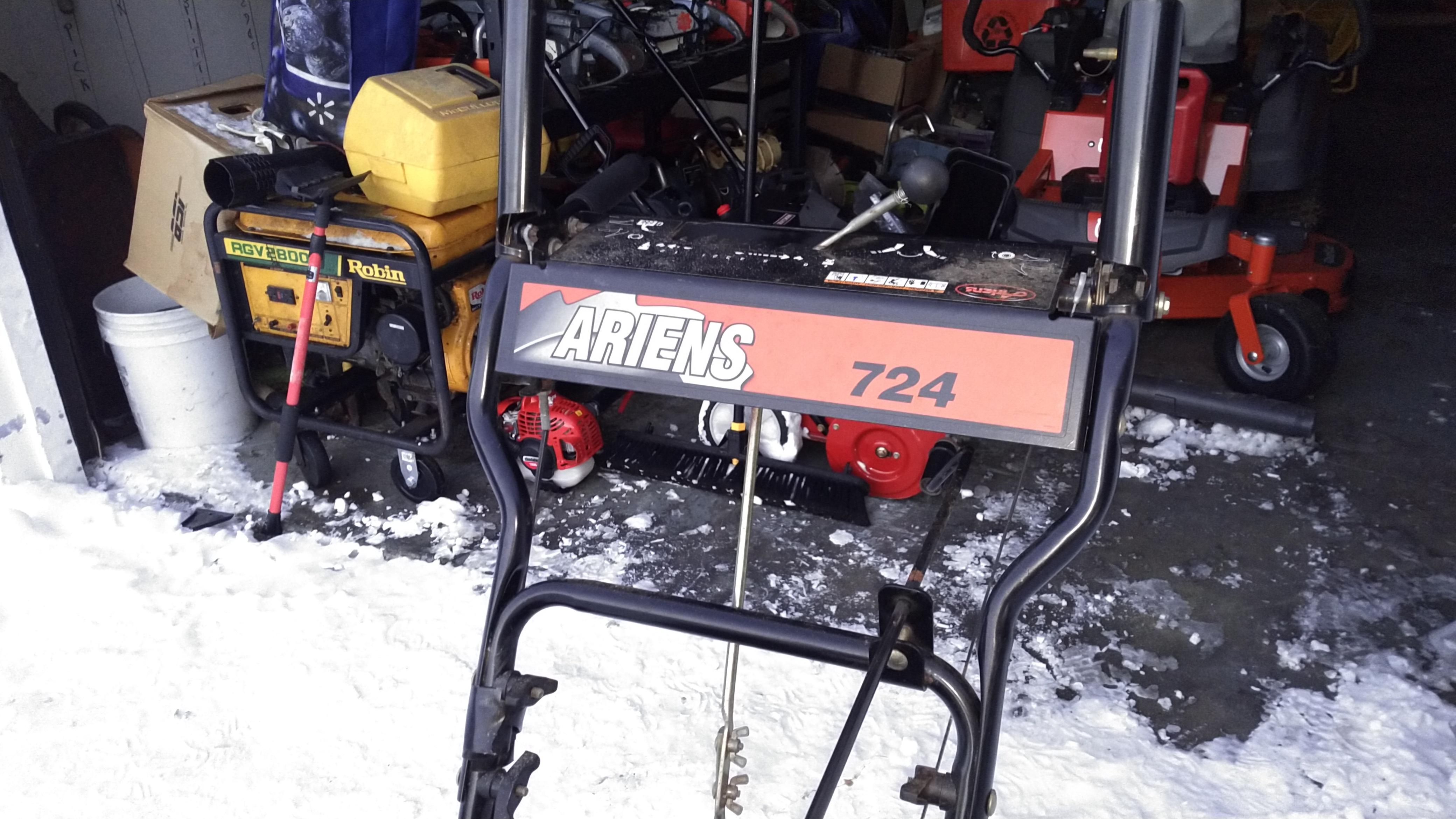

Shop is full! Honeywell 5500 generator got a new carb, plug and oil change.
Yard Machines 8/26 is getting a service, new skid shoes, carb rebuild and a good used starter.
Murray 14.50/29 is getting an impeller mod, service, new recoil rope and grip, and a set of tire chains.
Craftsman single stage got a new carb
Exmark Commercial 30 is getting a new carb and throttle link spring.
My new to me Ariens 724E is going to be getting a service and a set of belts.
Thursday after work I'm doing a road service on a Craftsman 24" two stage snowblower.

Job security! I love it!

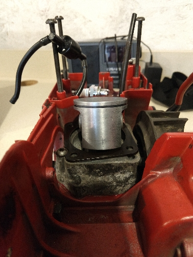

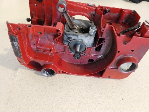

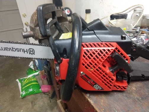

Got saw in the box put together tonight
2051 p/c on a bunch of 2054 parts in the mix
Somebody stripped muffler bolt holes badly and replaced with 5/16 hardware bolts .
I will see if it runs tomorrow.

Nice! You don't happen to have a spare clutch drum washer do you? The one before the e-clip, they are NLA.
