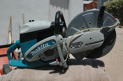

Not according to this -
<< Back
Larger View
MAKITA DPC 7321HD concrete cut off saw
Price: $549.95
MAKITA DPC 7321 HD 14 Inch Power Concrete / Metal Cutoff Saw
COMES WITH ITS OWN MAKITA TOOL KIT, AND SIX NEW 14in. NORTON METAL CUTING BLADES.
This saw has been tested, works great and shows normal signs of use.
Features:
Reinforced aluminum blade guard with 70° range of limitless positioning using a marked knob handle
Cushioned operator grips with 4 vibration-absorption rubber buffers for increased operator comfort
Improved ignition system with larger flywheel and rare earth magnets for more power
Starter grip and decompression valve located on the same side for faster starting
Cutting arm position simply changes from center position to flush (outboard) position allowing cuts directly adjacent to curb edges,
(Features from manufacturer website)
Specifications:
Displacement cu in (cm3): 4.5 (73)
Bore in (mm): 1.97 (50)
Stroke in (mm): 1.46 (37)
Max. power hp (kW): 5.6 (4.2)
Max. torque Nm: 5.0
Idling speed 1/min: 2,500
Clutch engagement speed 1/min: 3,800
Engine speed limitation 1/min: 9,350 ± 145
Max. spindle speed 1/min: 4,300

Appears correct. Must be a 2:1 difference in the pulleys then. A couple of my blades say 54-5600 on them also
