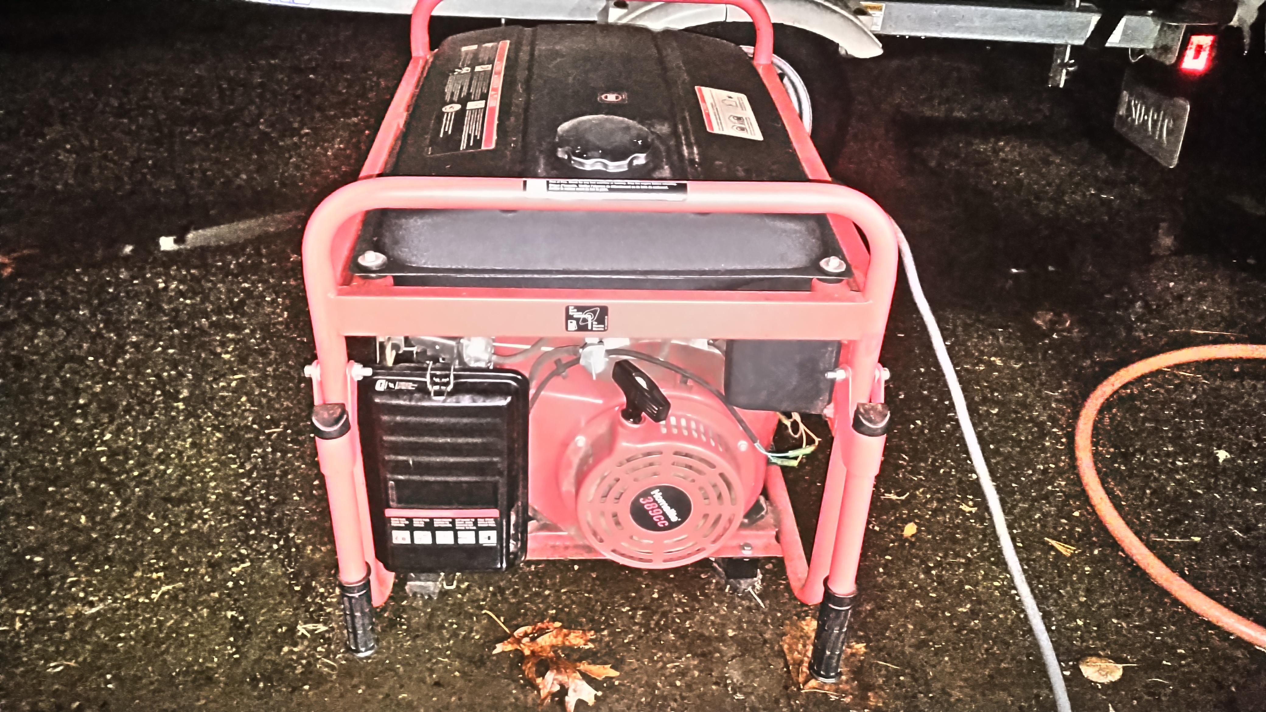

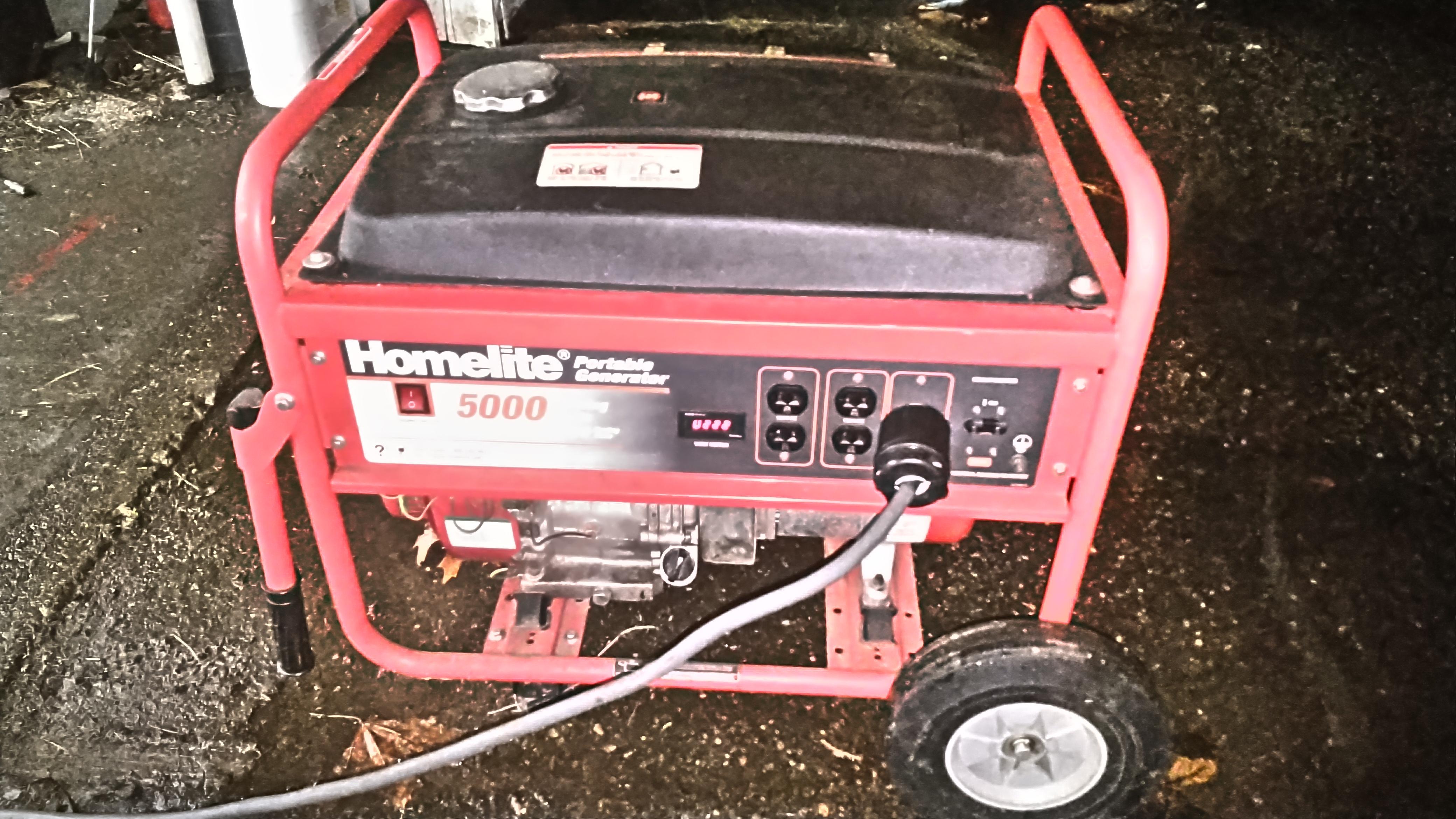

Lost power this evening. Generator is up and running. Glad I serviced it after the last power outage. Started right up. 5000 watts does pretty much the whole house with the exception of the cooktop, oven, air compressor, and dryer.

Generator all put away. Fuel stabilized and carb run dry.

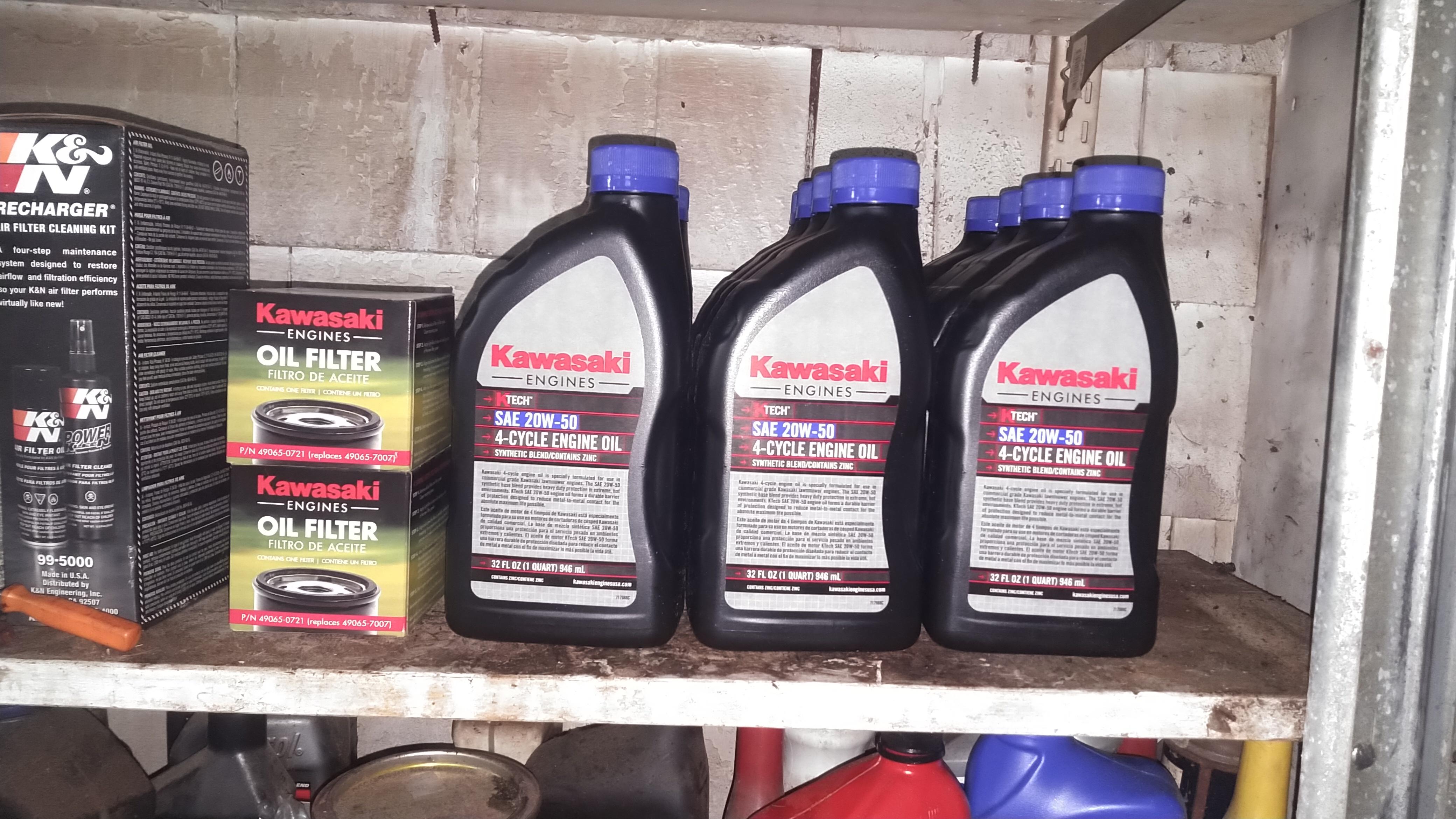

Got the case of oil for the Kawi on the new mower. Picked up 2 oil filters when I picked up the mower, oil I bought on Amazon.

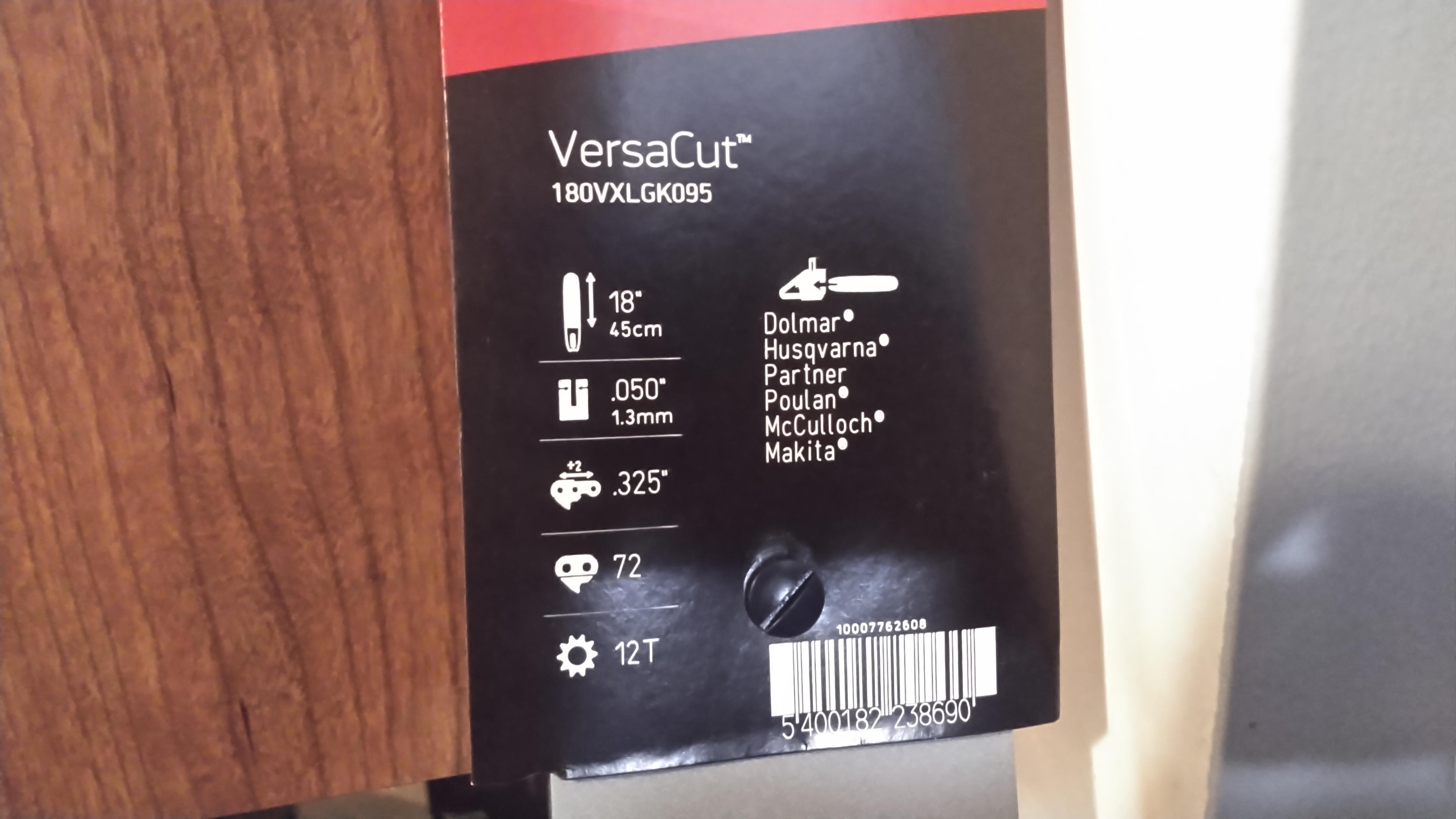

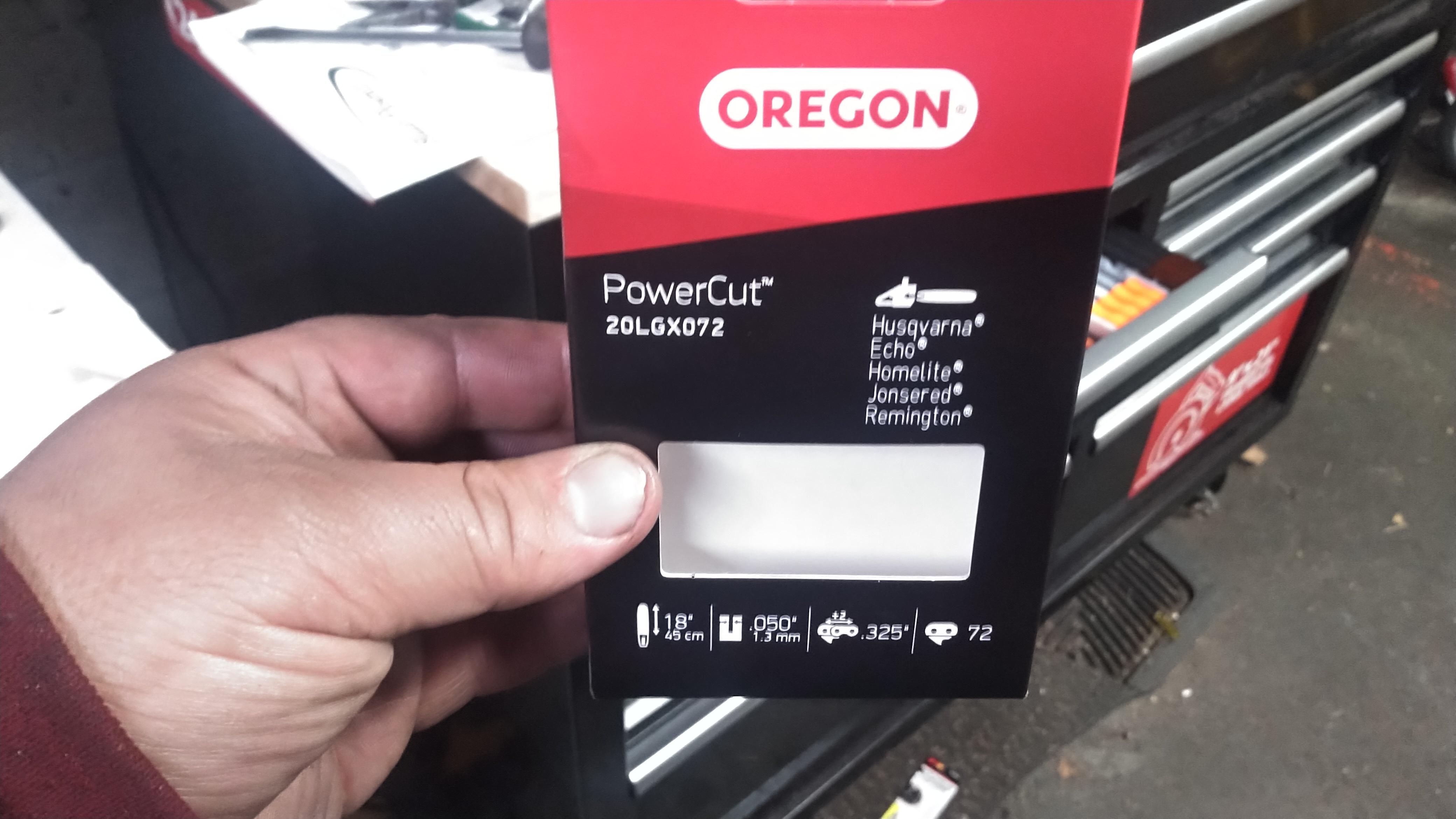

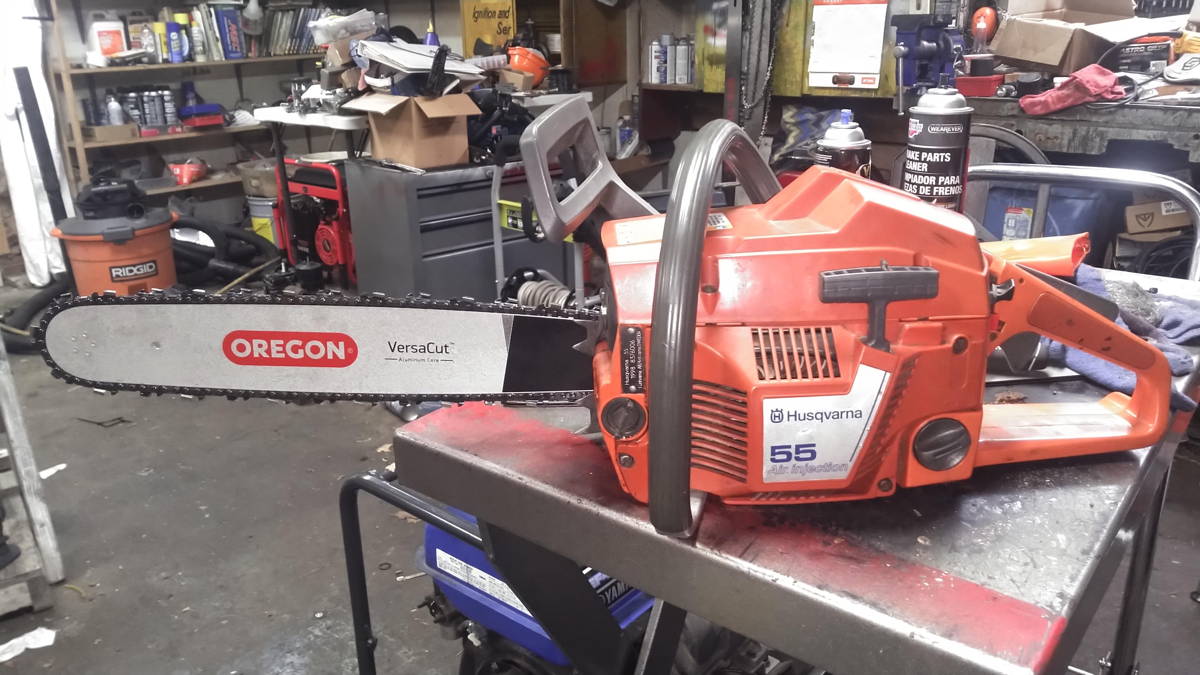

Got the 55 setup .325 7 pin 18" bar, will see how it does this week.
