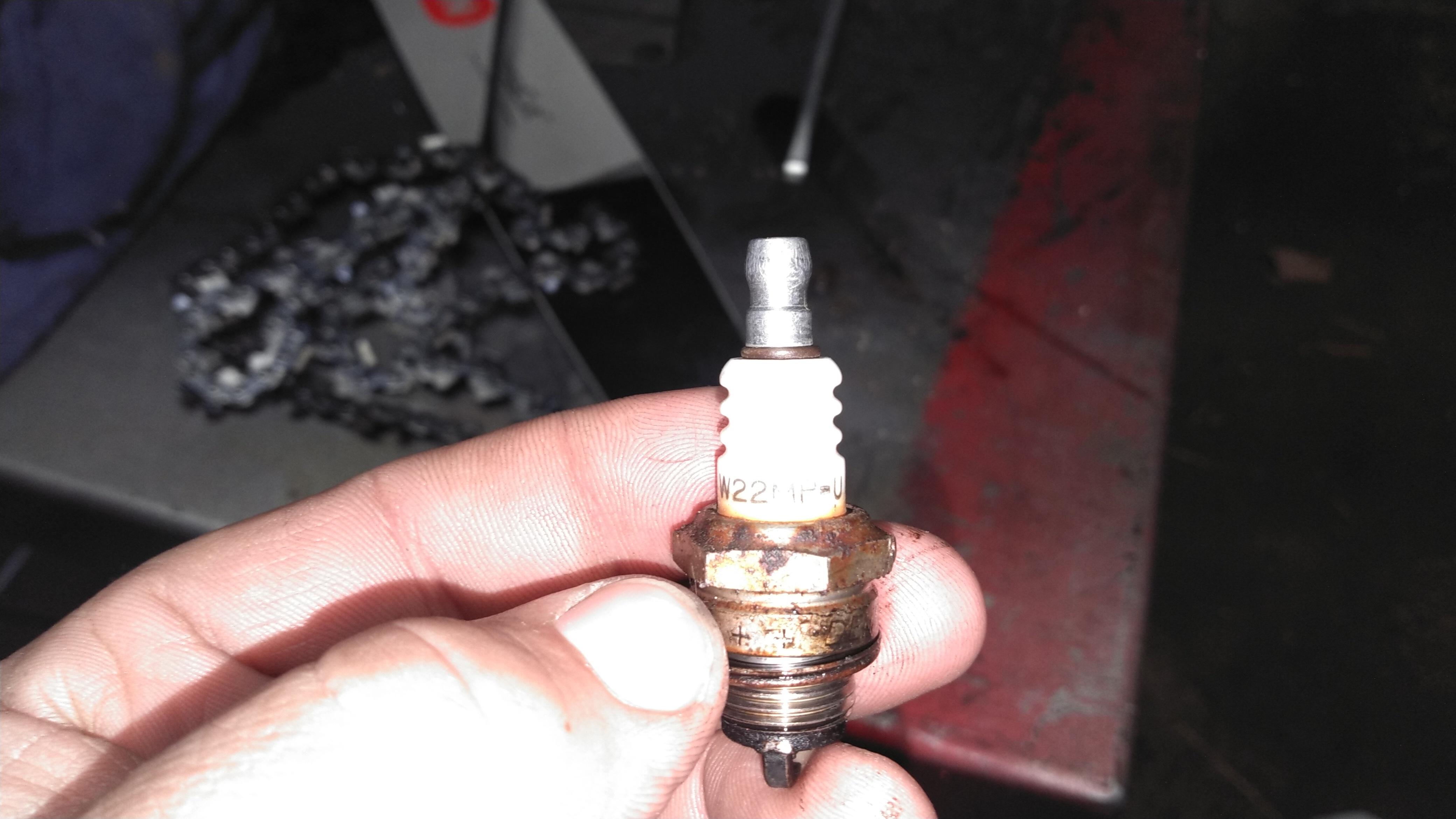

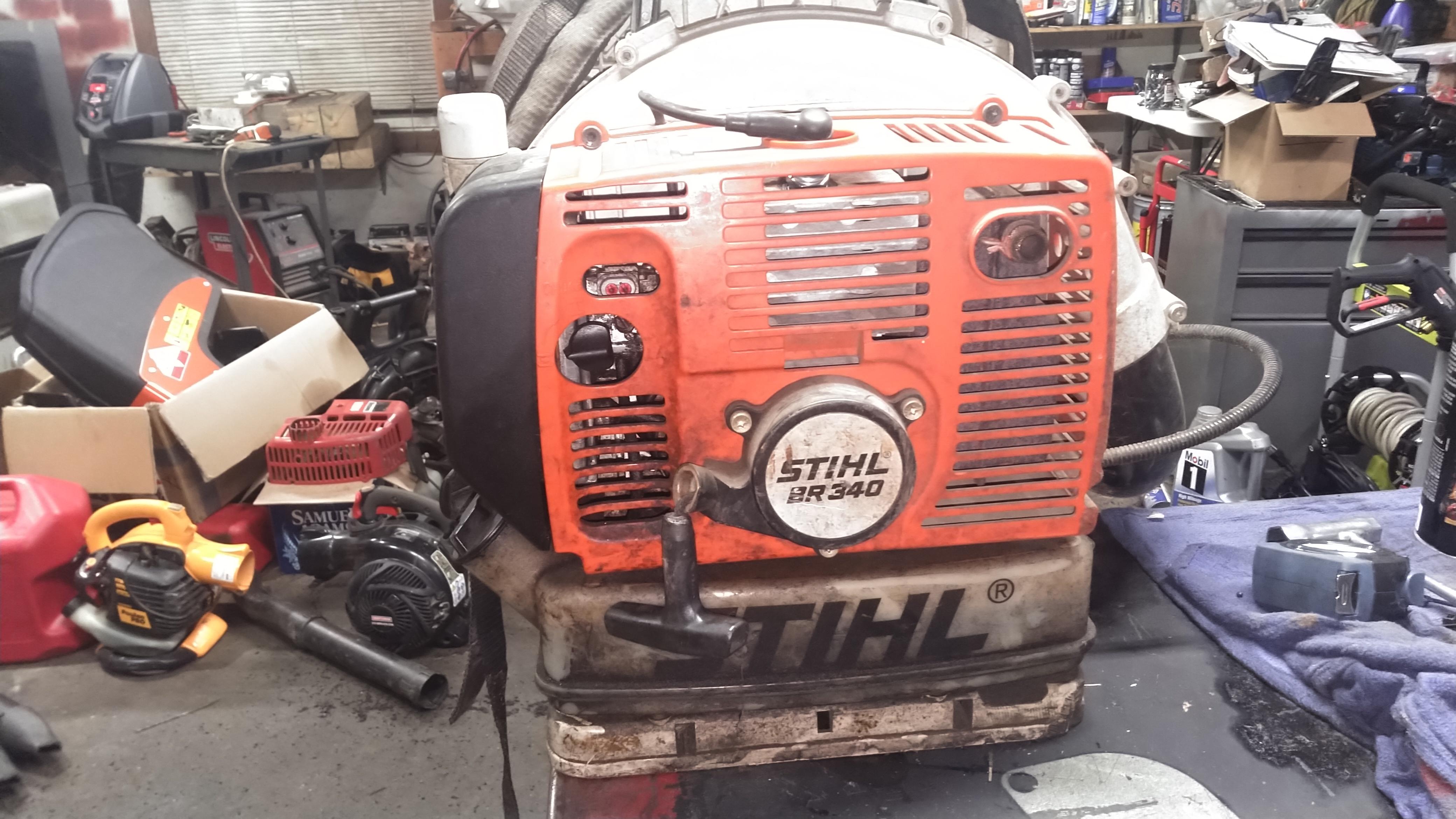

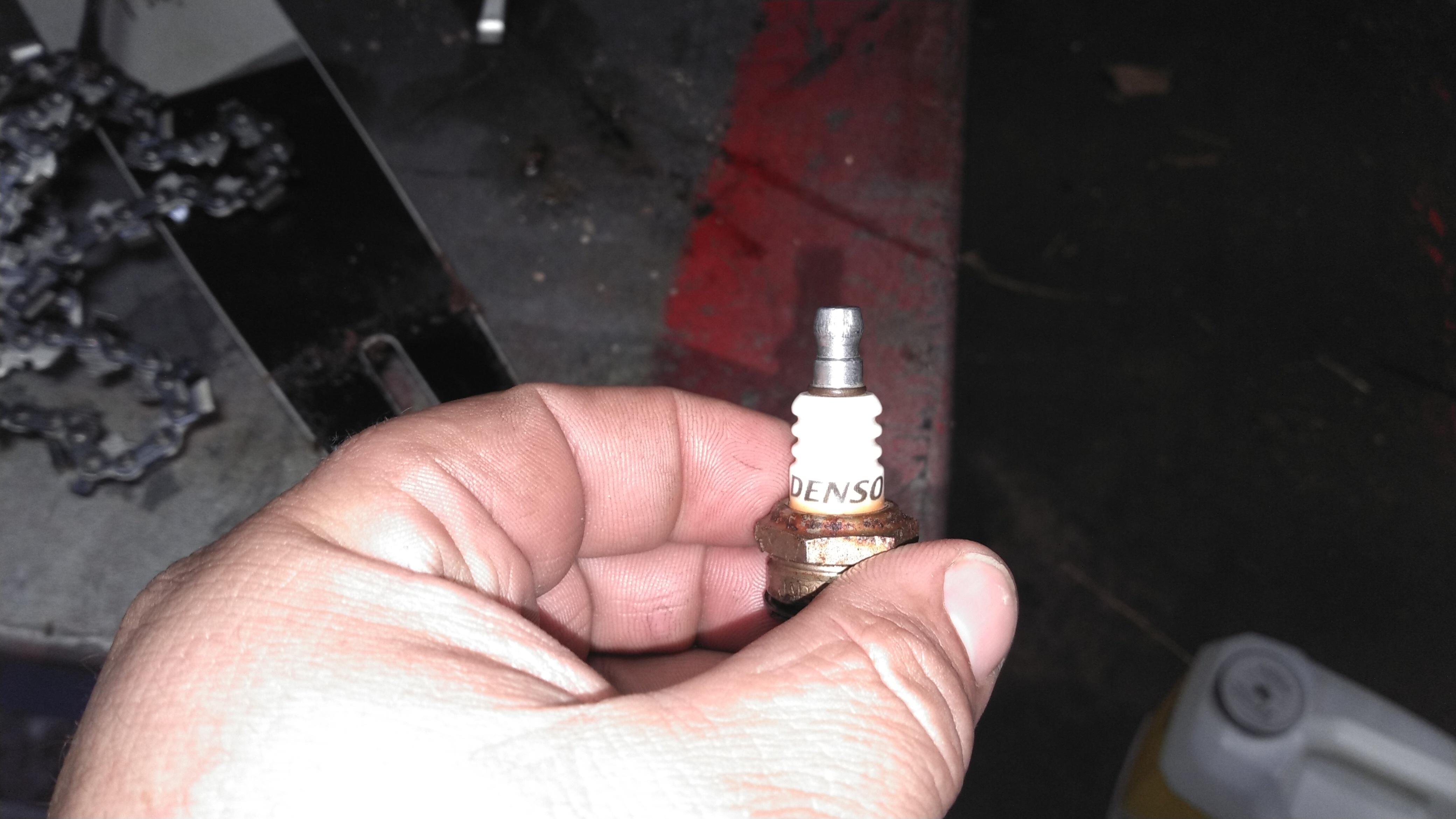

BR340 owned by one of the guys at work. He says it will only run a short time then die. Did the basic checks and they were okay. Tossed a new plug in it and put my spark checker on it and let it run at full tilt for half an hour and it didn't die. I'll let it sit overnight and try it again tomorrow evening.

Finally got the BR340 diagnosed. Tank vent is intermittently not venting. New vent on order. Started right up and ran good for a few minutes then starting losing rpm, cracked fuel cap and rpm picked right up.

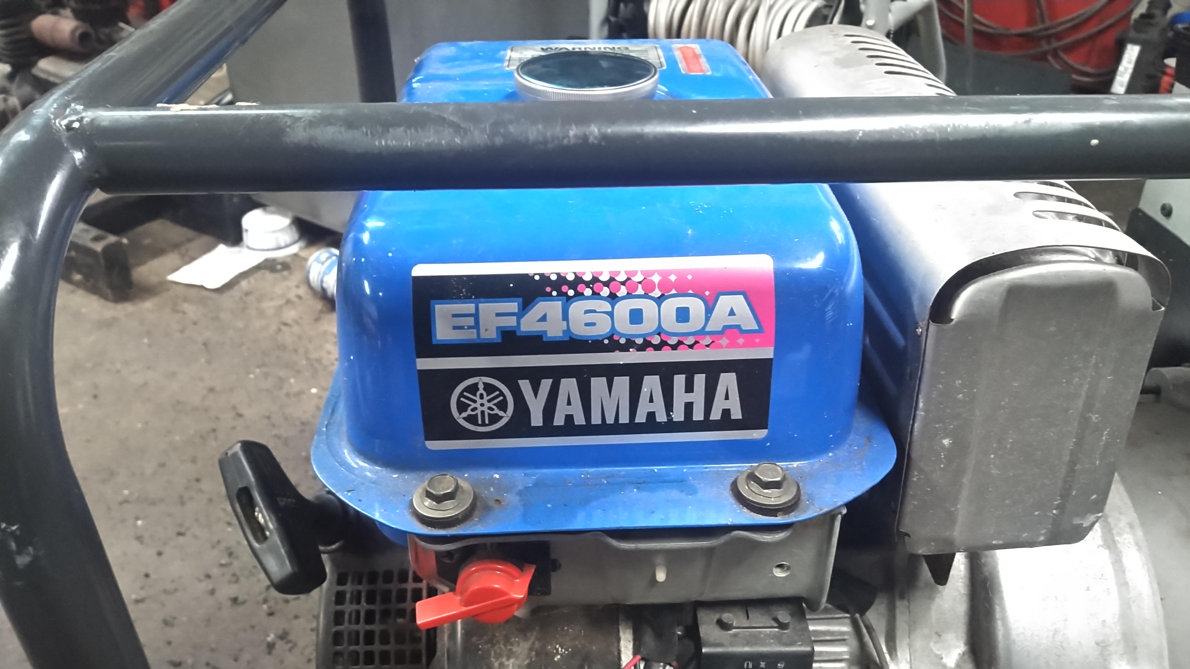

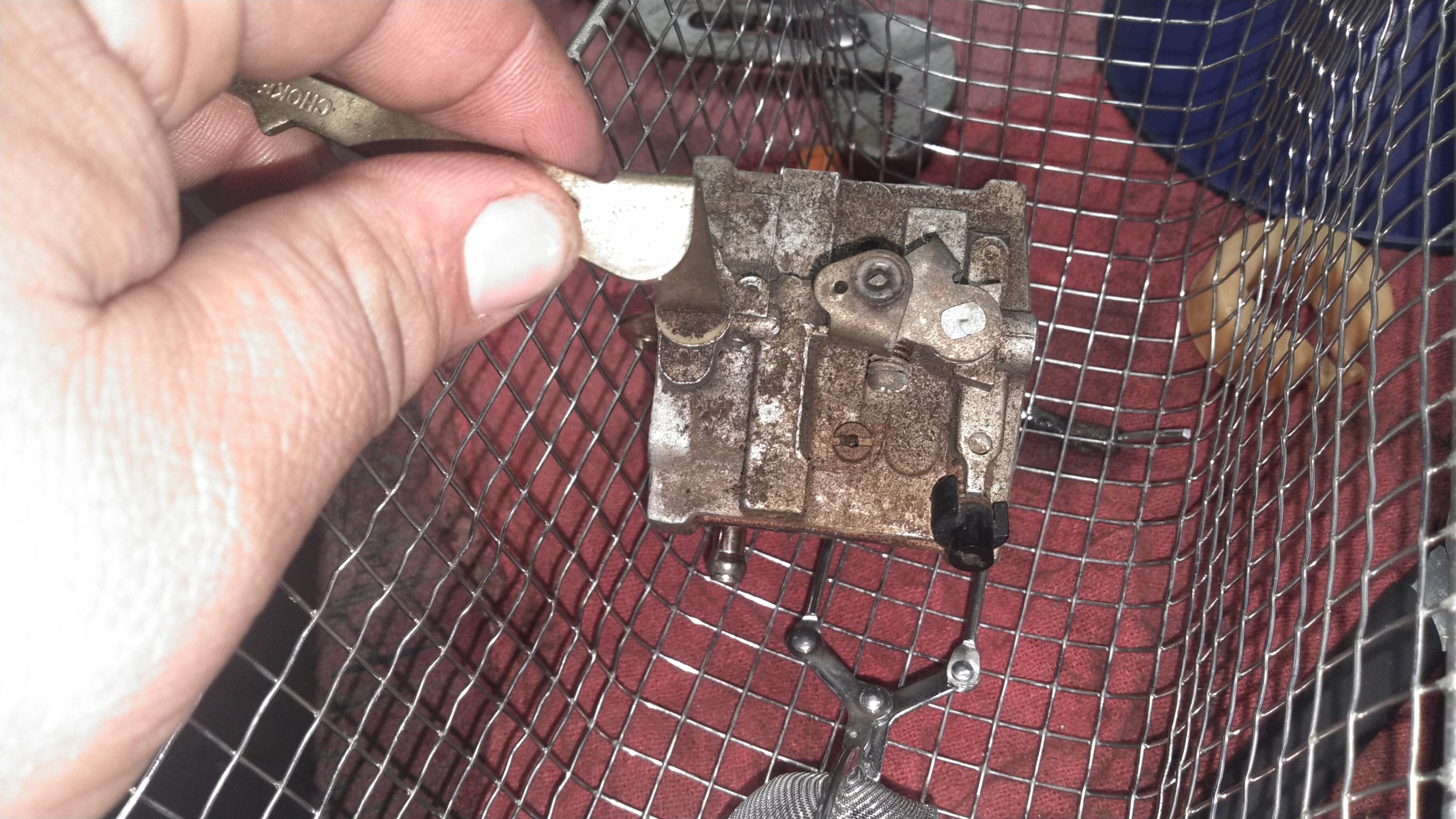

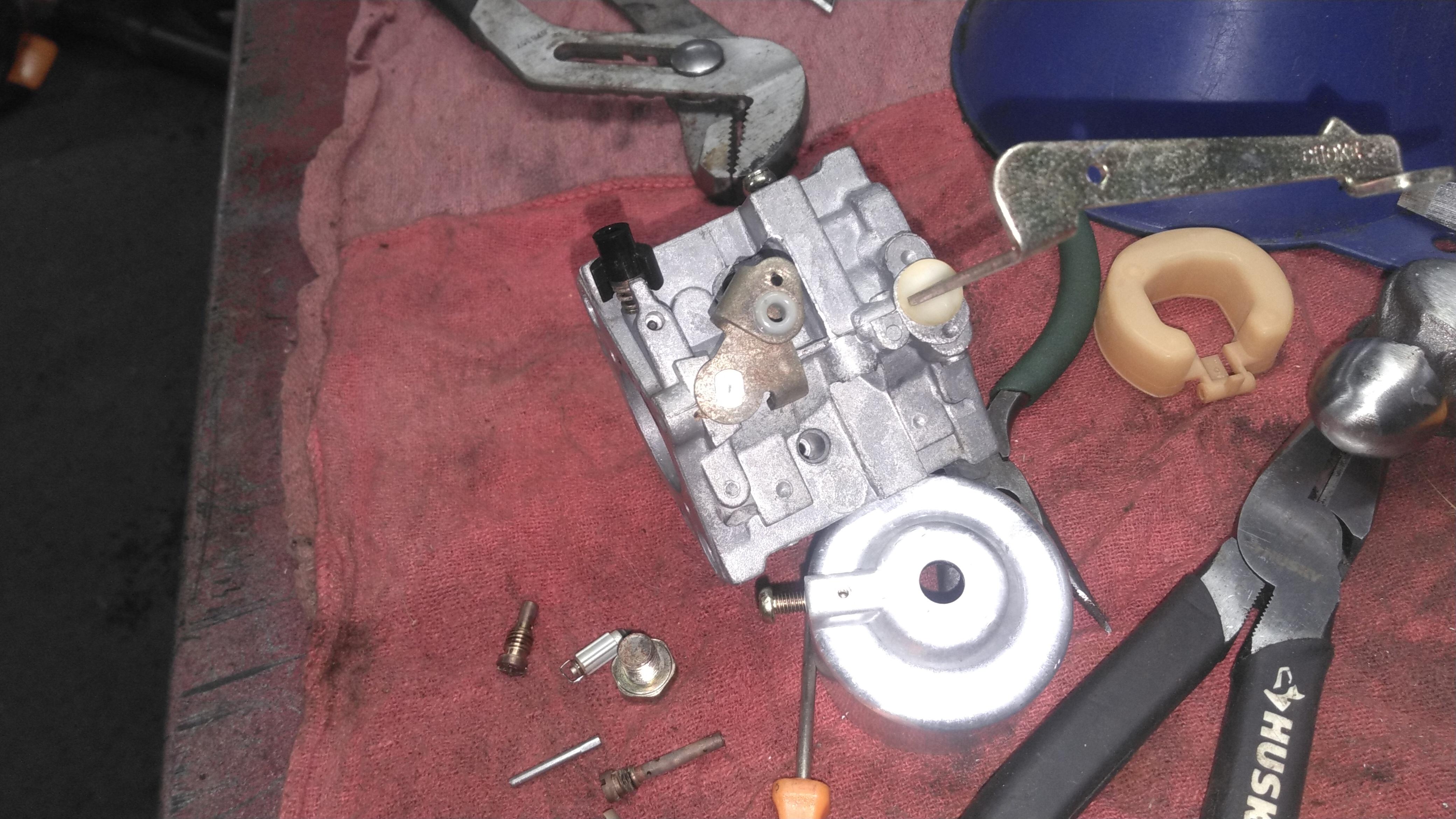

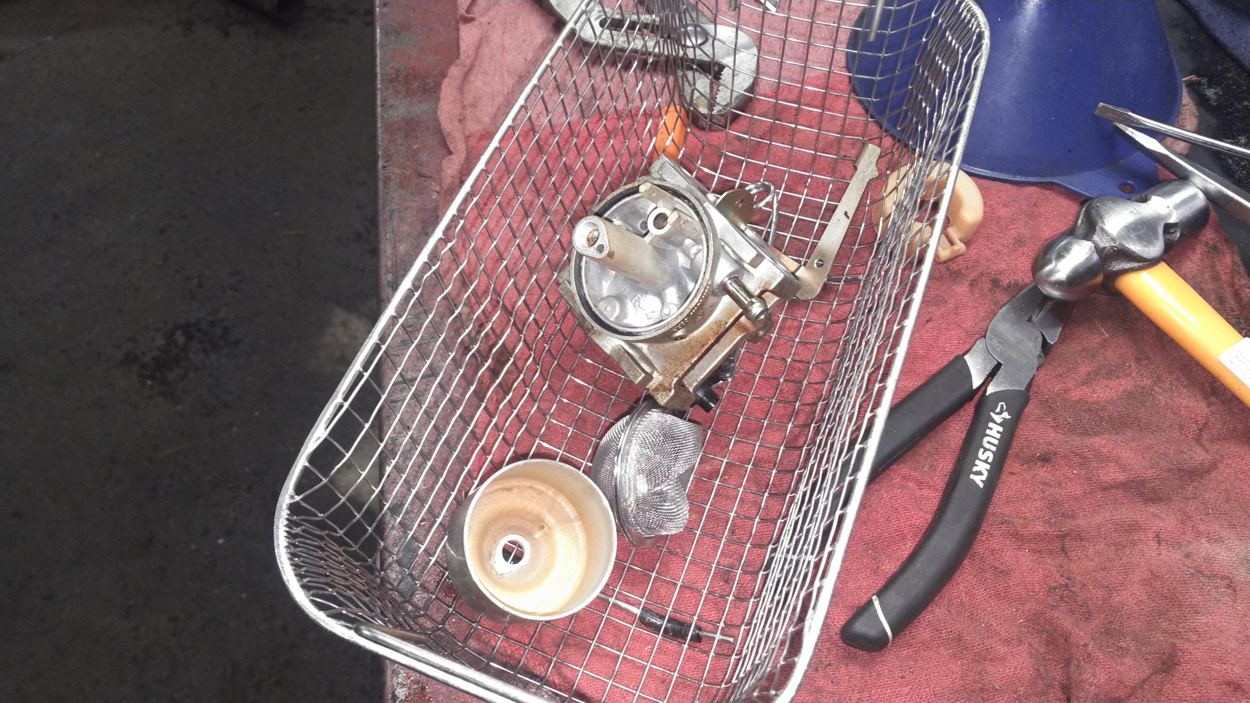

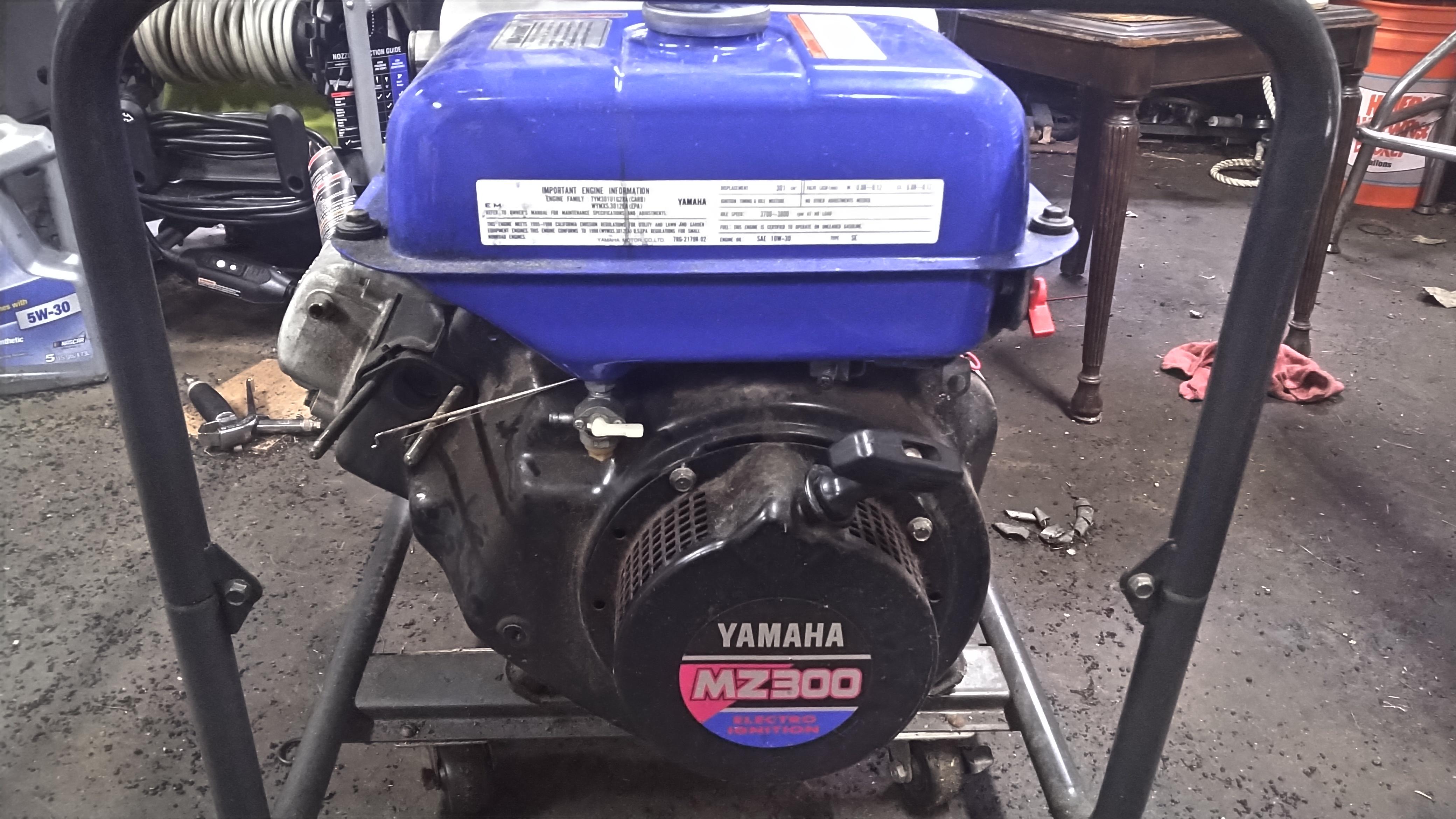

Yamaha MZ300 on a EF4600A generator carb clean/rebuild. Ran good but carb was dripping. Getting a hot bath in the ultrasonic cleaner and a new needle and bowl gasket. Also getting a new fuel line/plug/oil change/air filter.

Yamaha carb cleaned up nicely last night. Waiting for bowl gasket, needle and needle clip.
