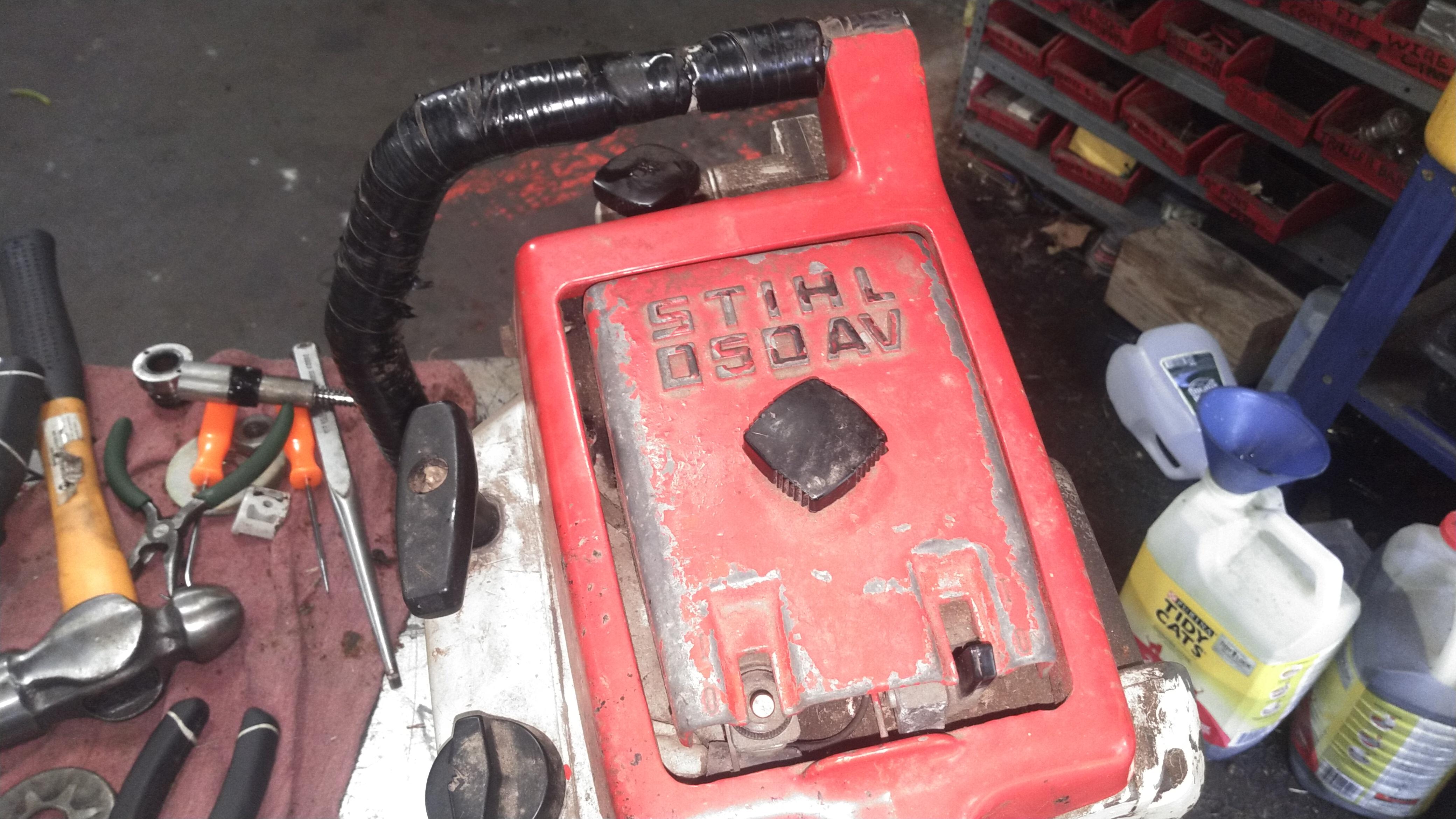

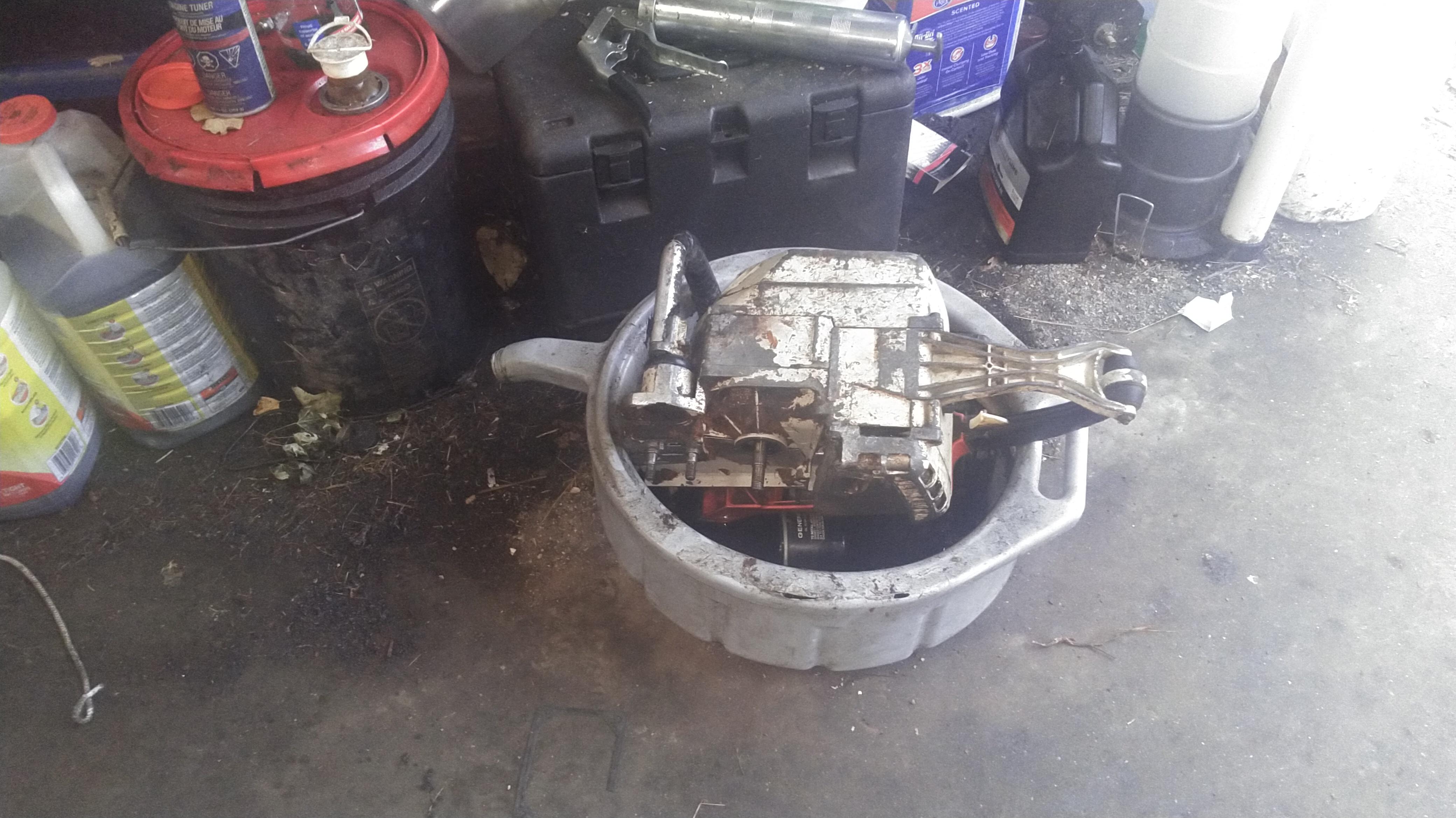

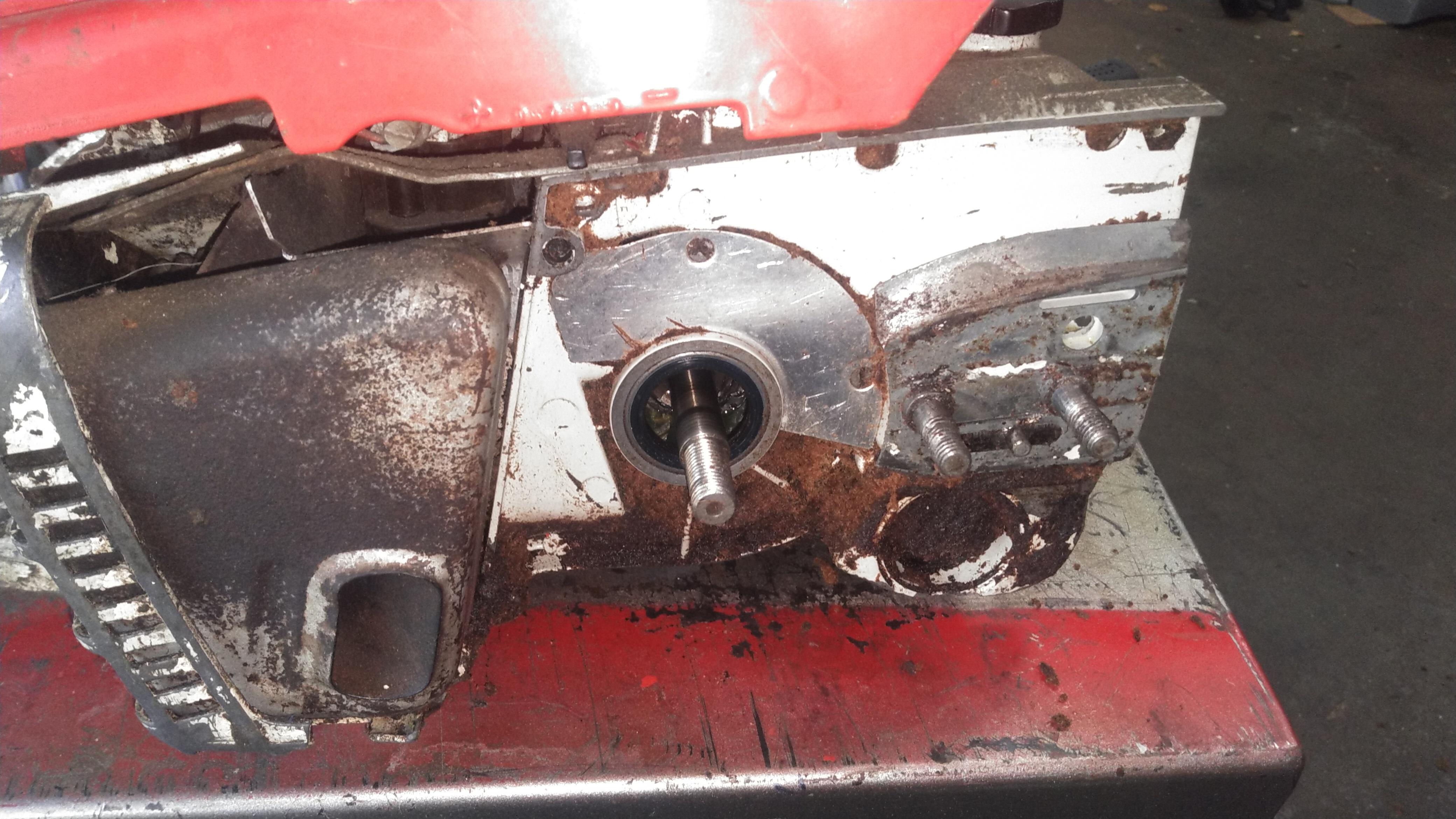

050 for disassembly and inspection. Bar/chain and clutch/oil pump drive off to allow oil pump removal to see what style of rubber ring I needed for the pump. Tipped over in the drain pan to let the "bar oil" drain. Looked and smelled like gear oil. Sprocket could probably be replaced but it won't see much cutting time so I'm ok with it. Setup .404 7 tooth. Ordered parts.

Whats wrong with it?
The super awesome design fault of the crankcase melting near the oil pickup... which fried the seals. Crankcase is junk. Saw isn’t even worth a set of cases or my time and labor I would charge. I been through this before with a 455 rancher and it just isn’t worth it $ wise fixing these types of saws when they have complete failures.
Seen a lot of these saws ran with the chain brake on. It usually fries the side of the crank case where the clutch/oiler gear is. Its true the design is not great (even for me a Stihl_head).

I appreciate the offers guys, but the saw is already back with the owner. Not worth my time or the money I would charge him to fix this type of repair.
