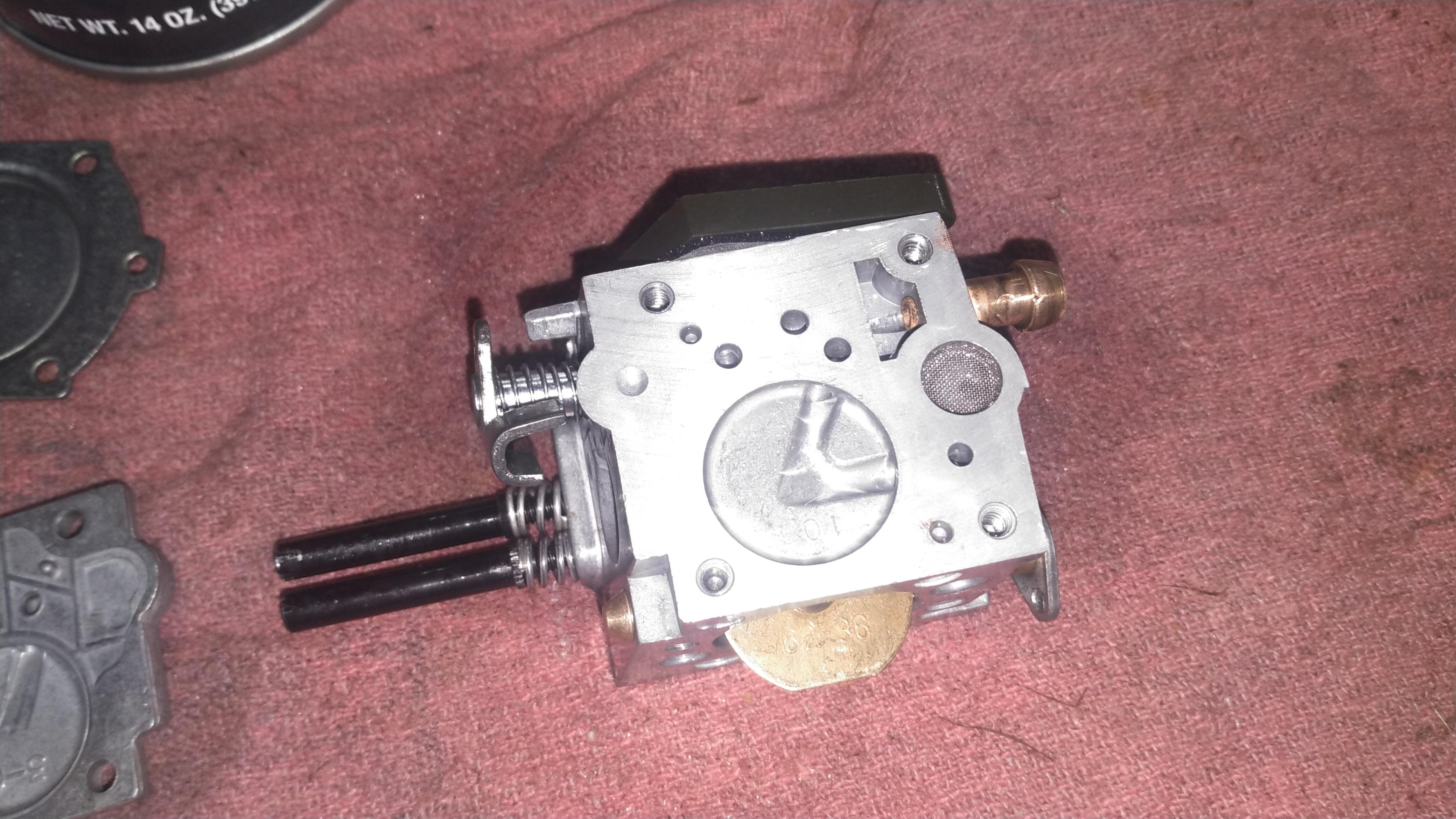

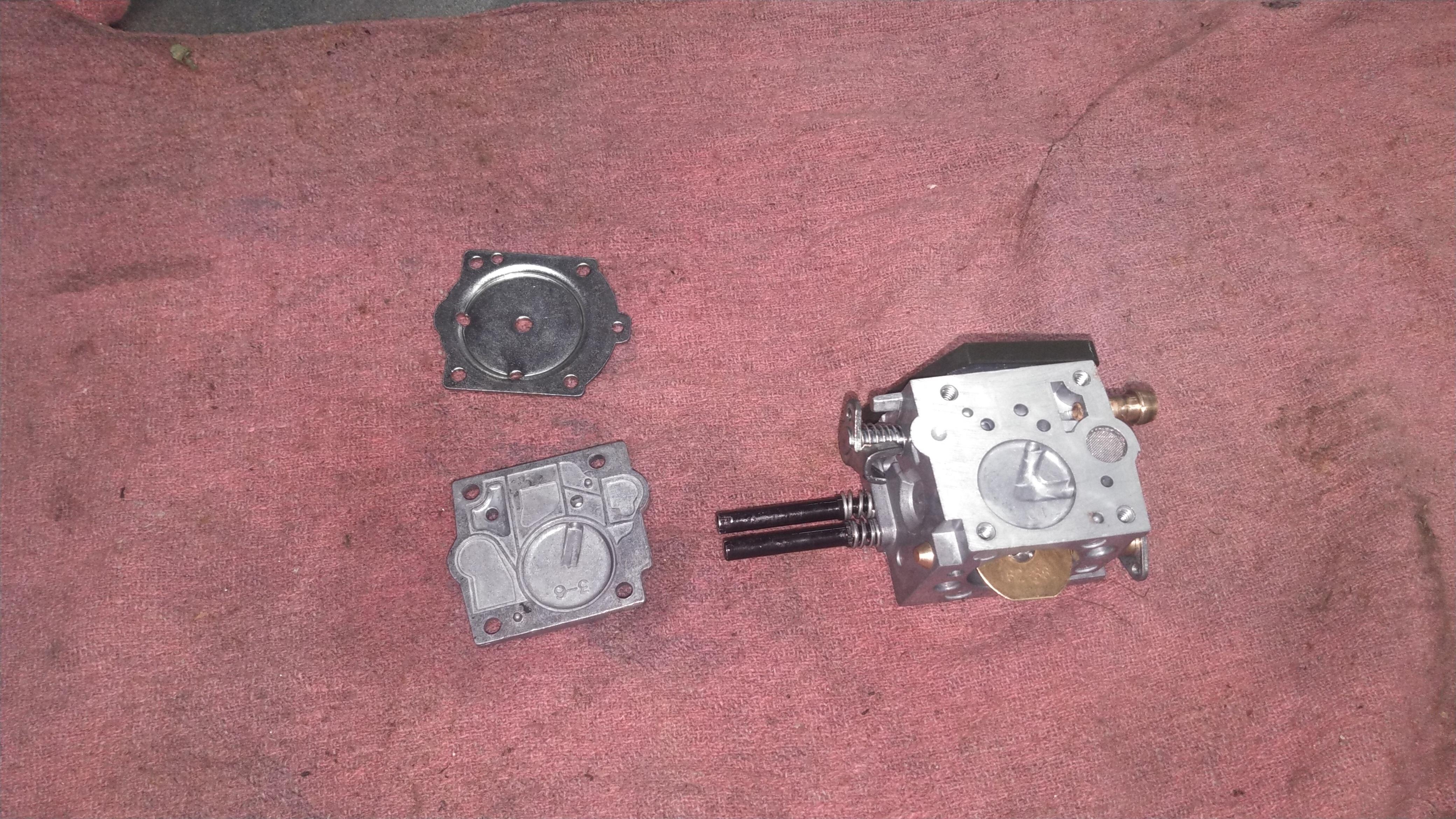

1/2 hour in the ultrasonic cleaner does a carb good. Kit will be here Wednesday. Hopefully running by the weekend.

Do yourself a favor and pop the Welch plugs, the check valve is under the small one. I often find them disintegrated or turned to goo.
