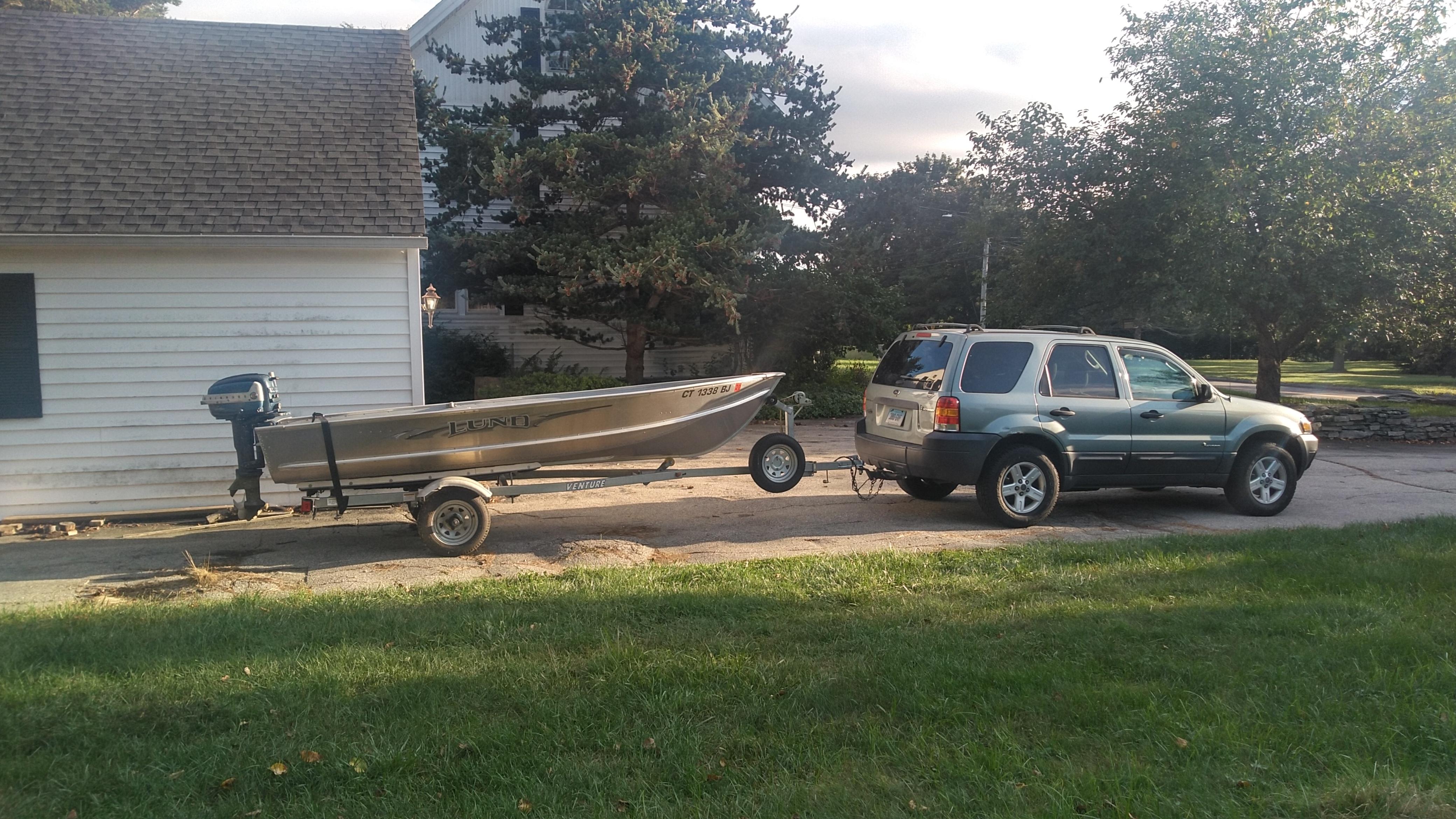

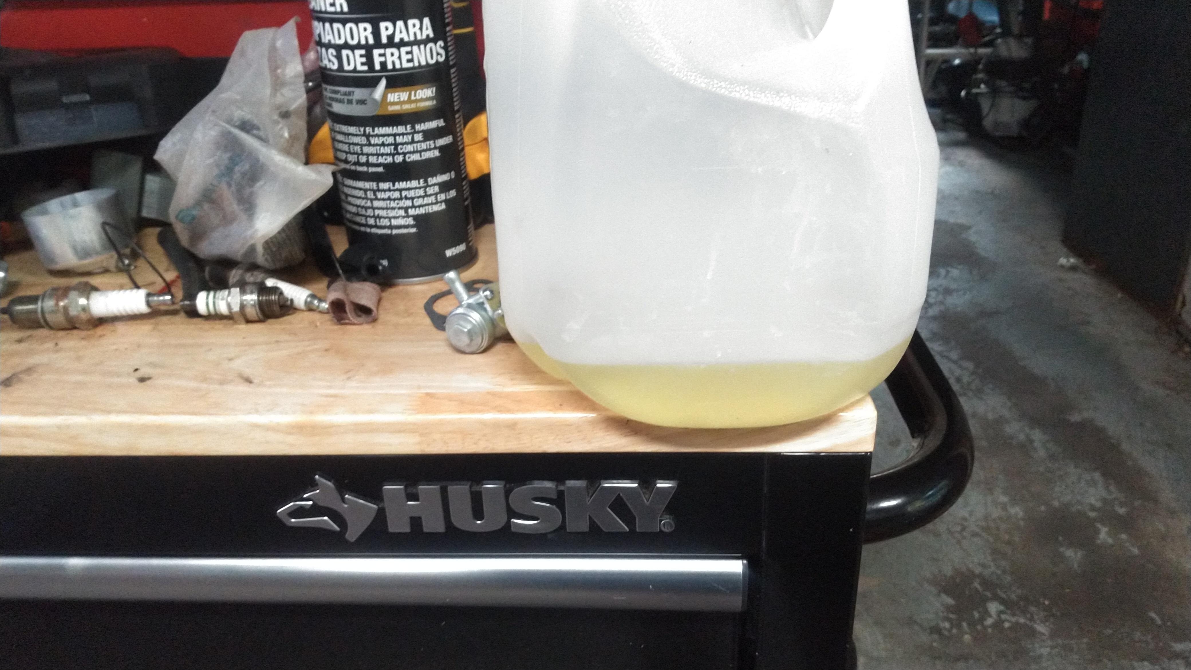

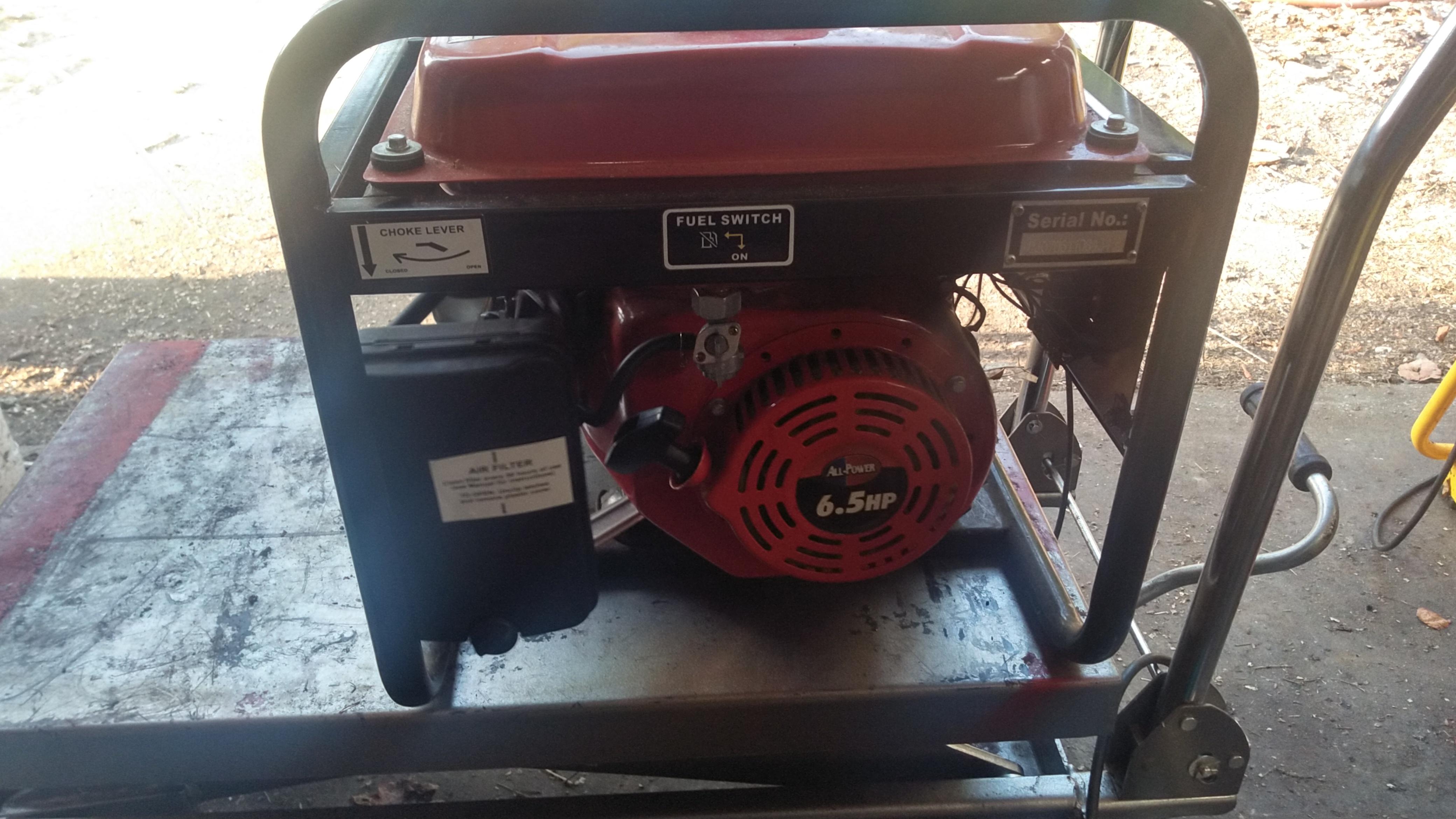

Chinese generator test ran well under load, started on Craftsman push mower with plastic carb Briggs, found dirty carb and water in the fuel. Letting everything dry overnight and then I'll ultrasonic clean the carb tomorrow after I get back from boating.. greased bearing buddies, checked air in tires, checked trailer lights and evicted some unwanted tennants from the trailer tongue. Hooked up to the Escape and ready to go in the morning.

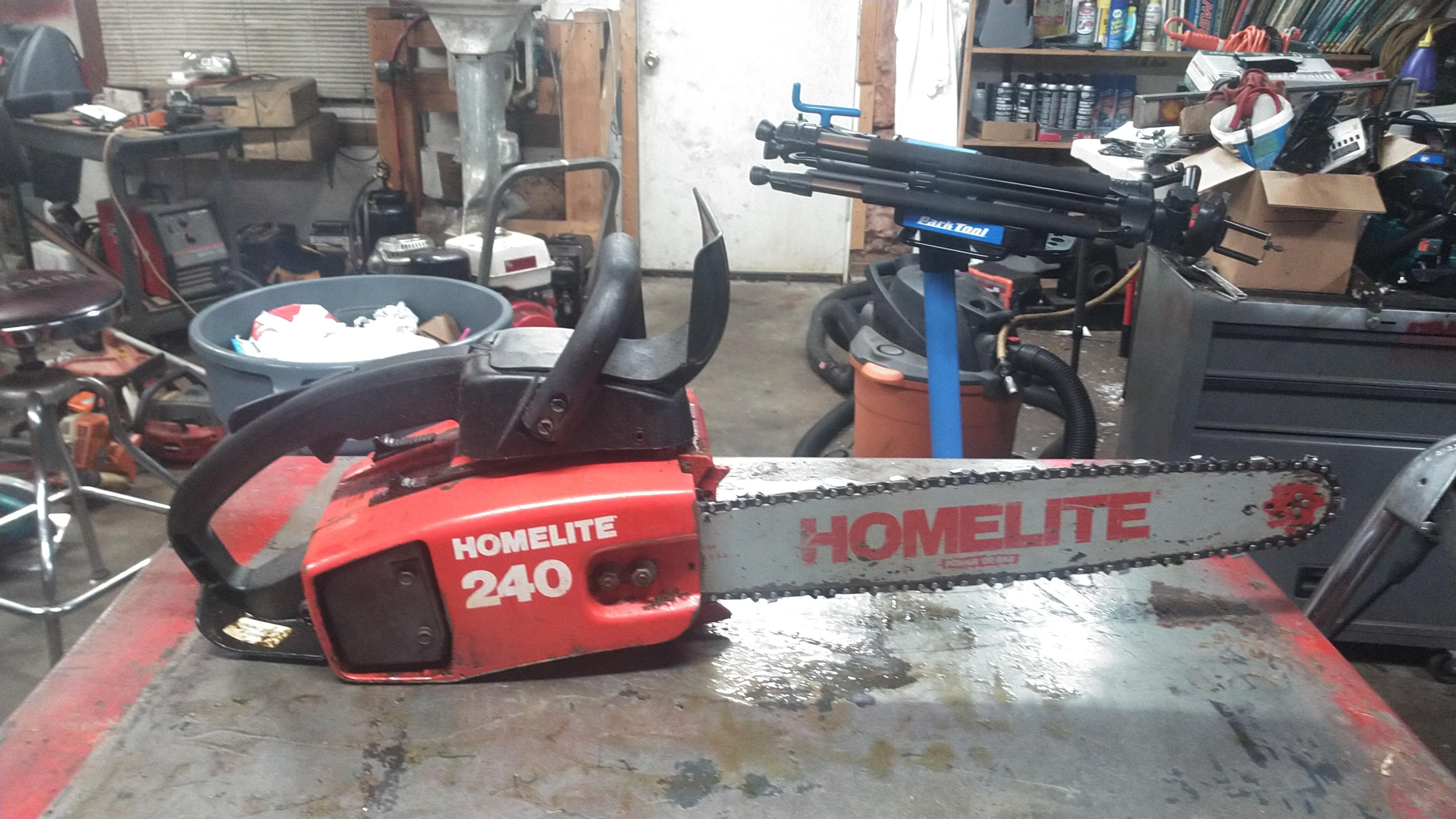

Homelite 240 that I got for free the other day. Added fuel, bar oil, choked it, turned the switch on and it came back to life pretty quickly. Tweaked carb slightly and it was running sweet. Oils nicely too. Chain looks good so I'm just going to let it eat tomorrow.
