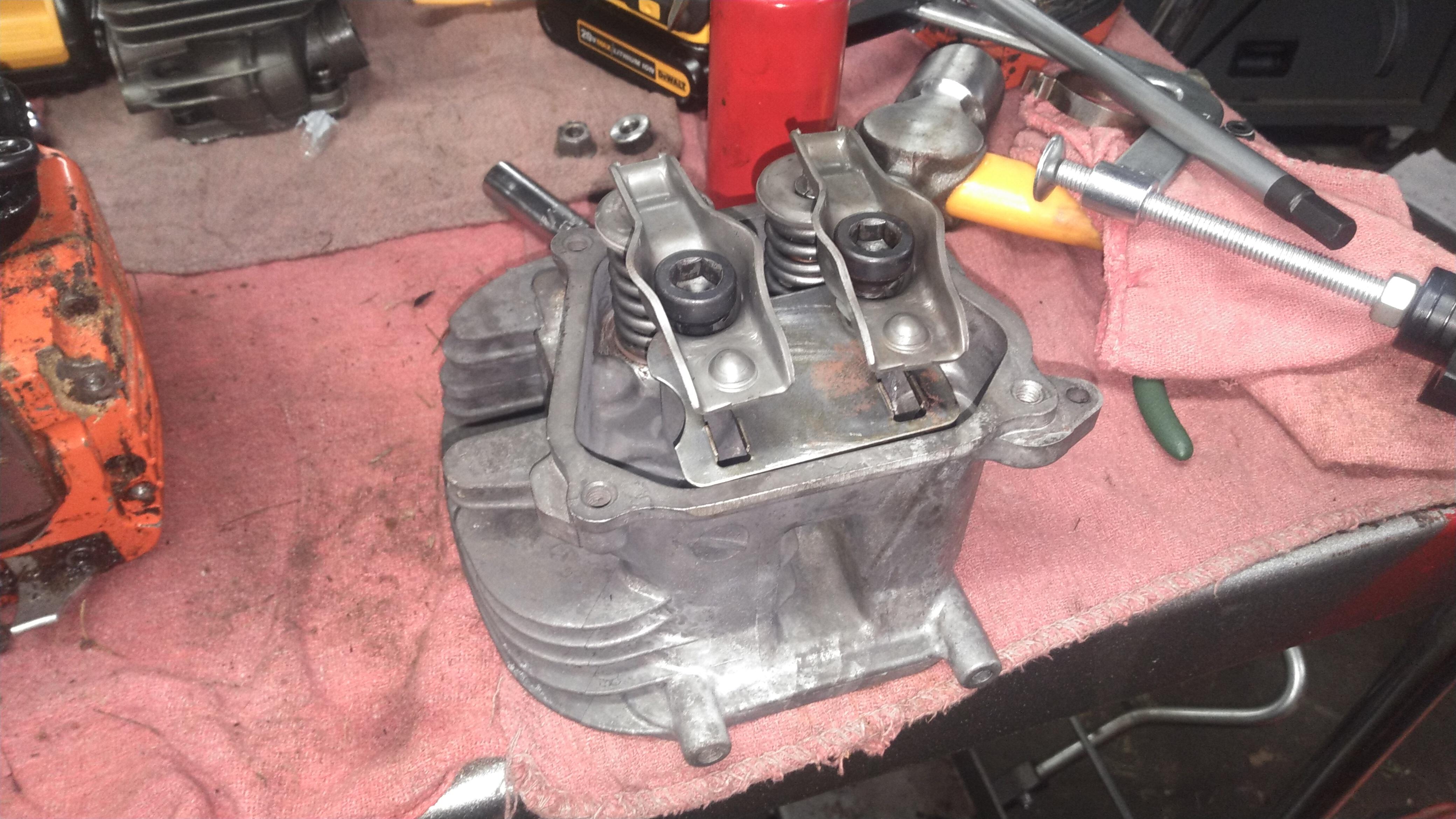

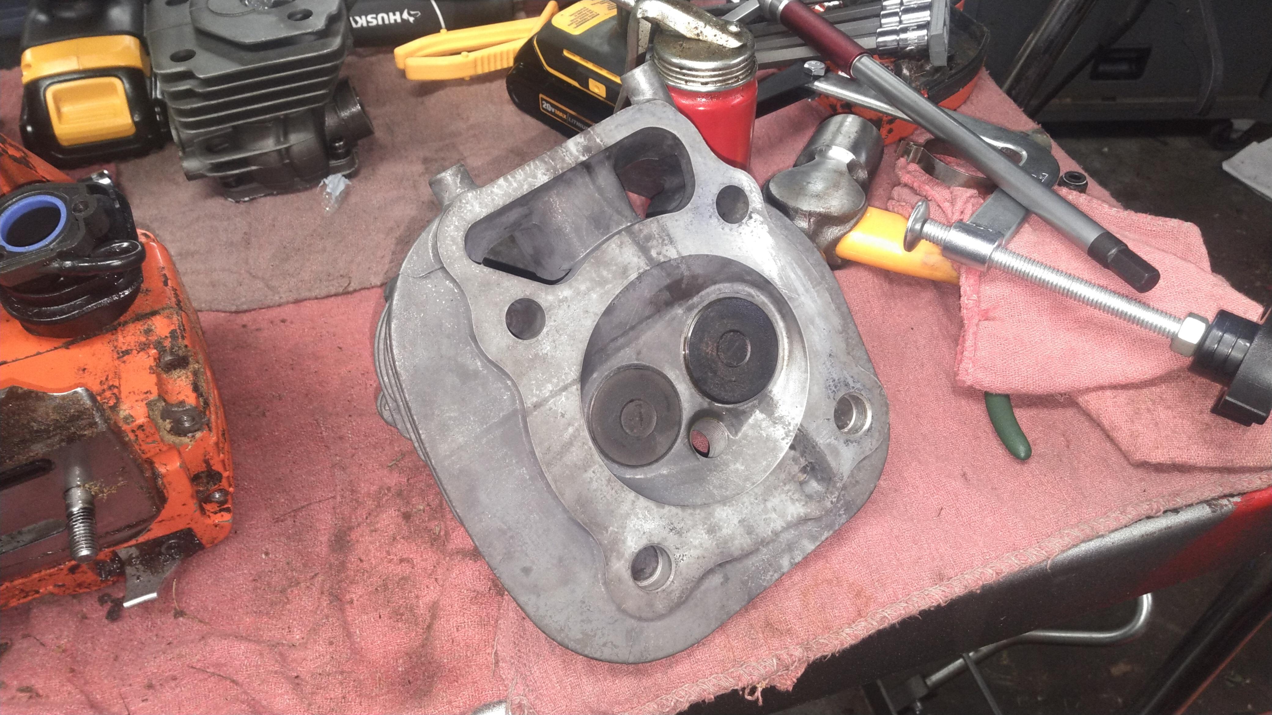

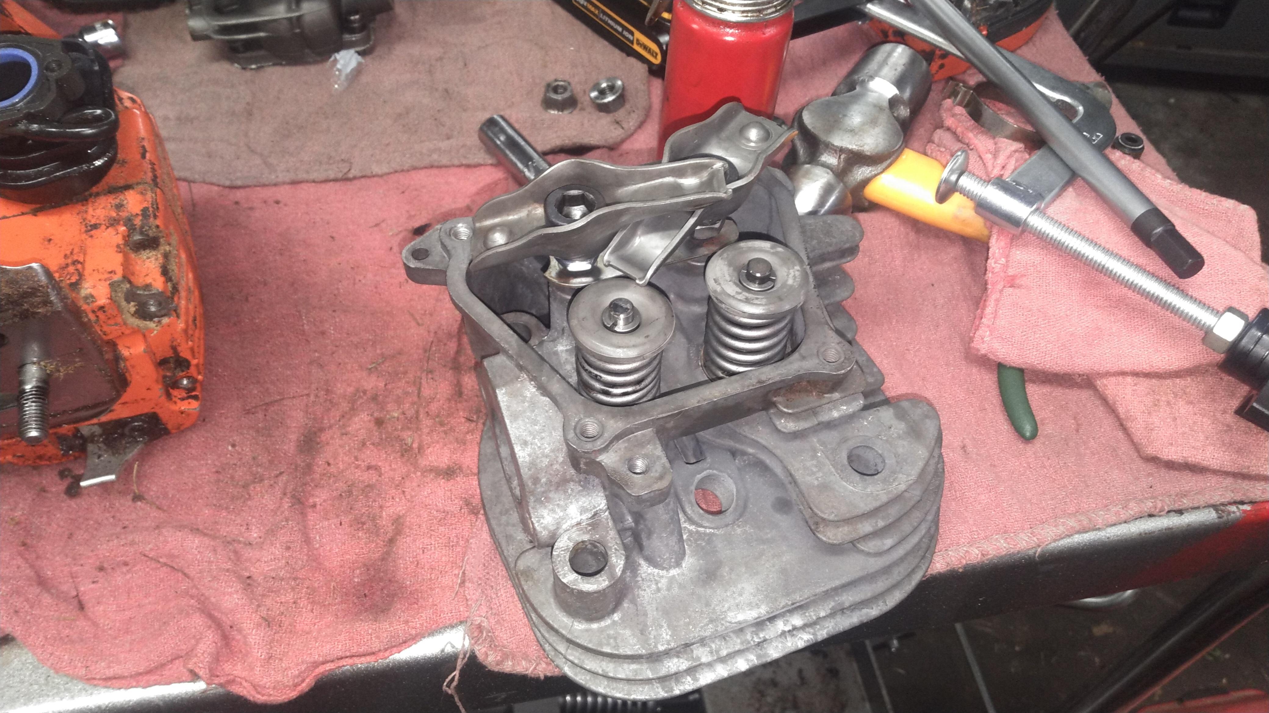

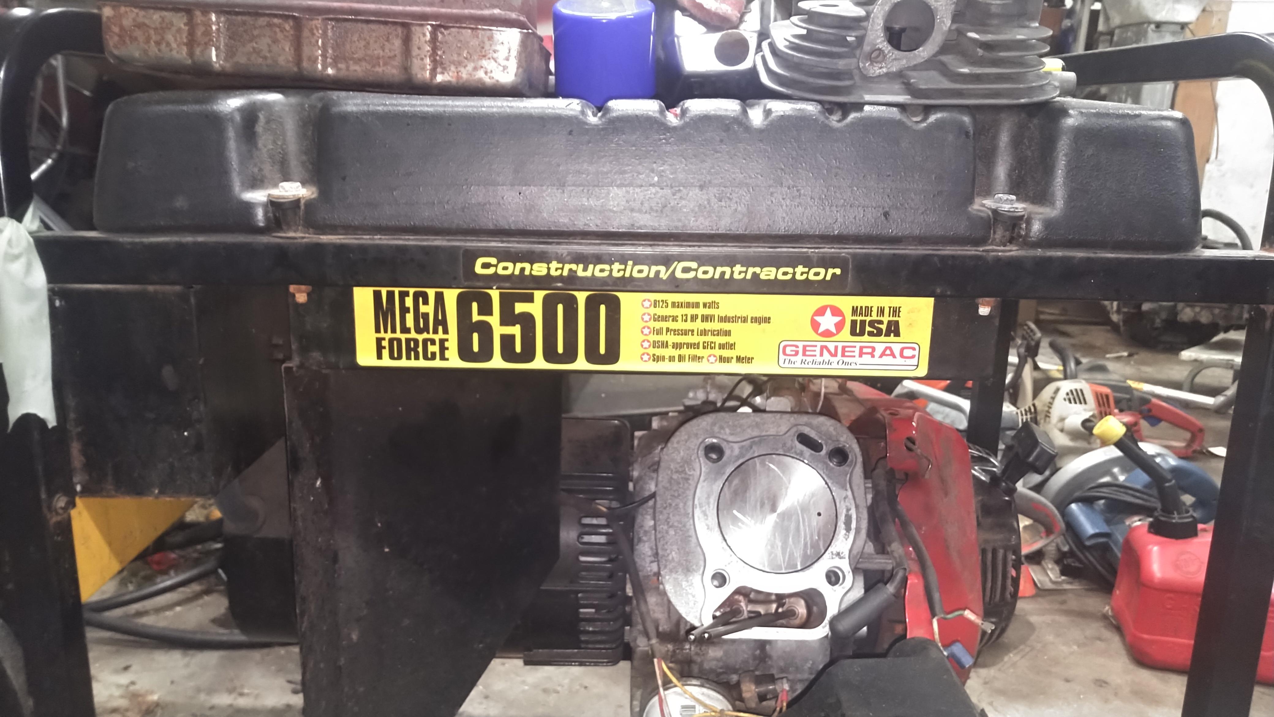

Generac cylinder head reassembled and ready for reinstallation as soon as I get head bolts. It's also the last customer job in the shop.

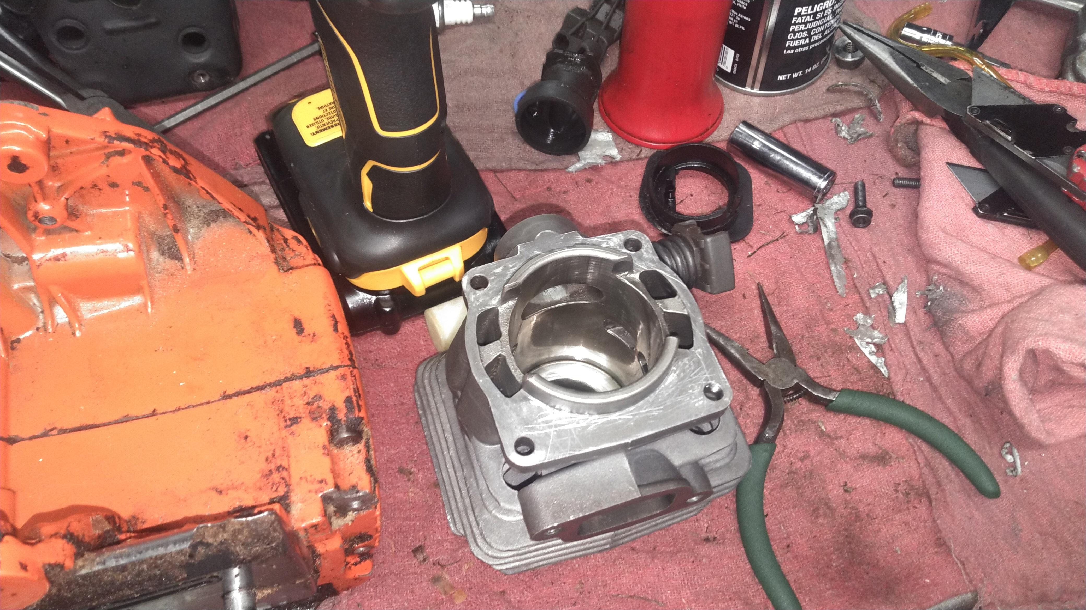

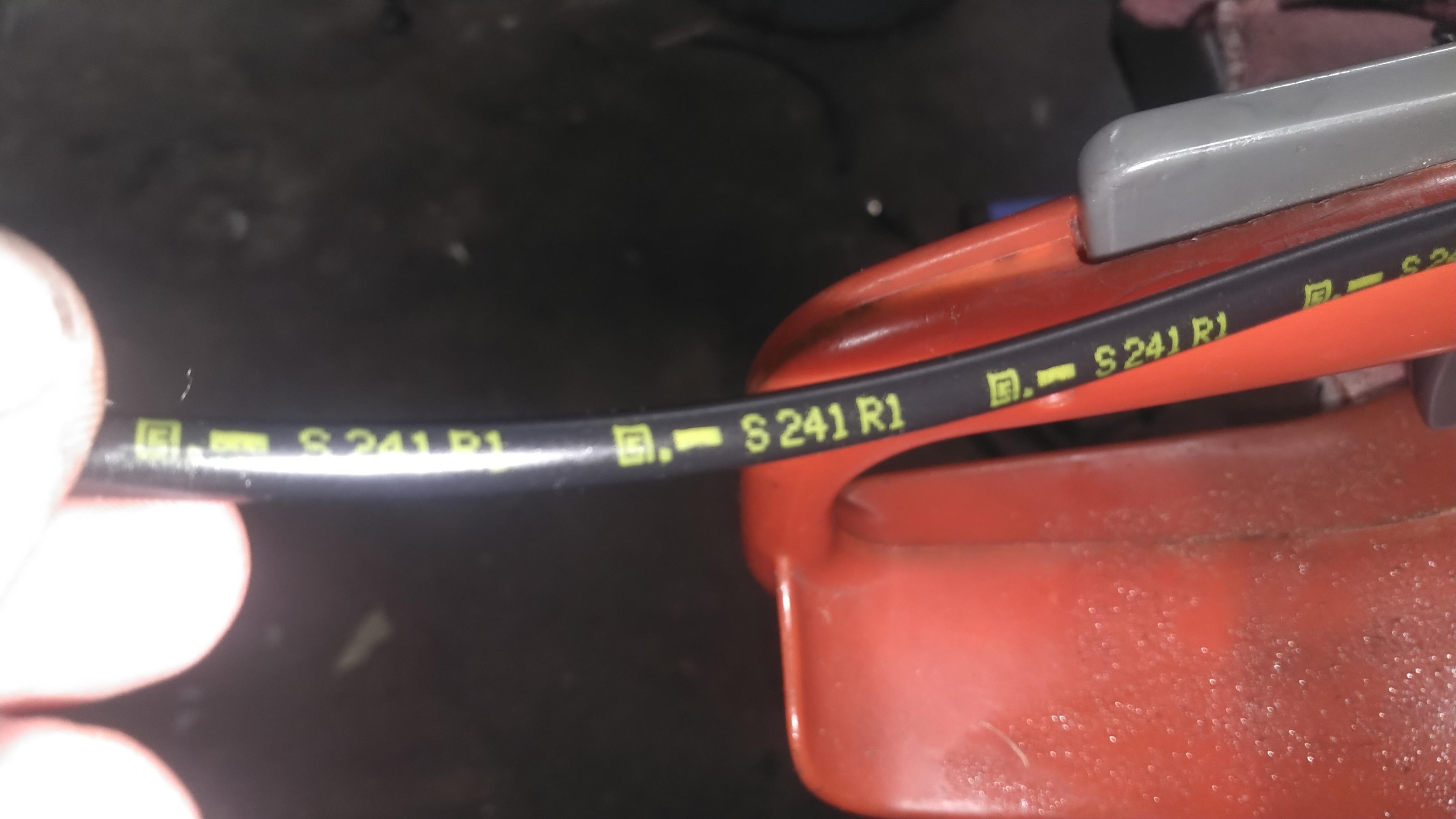

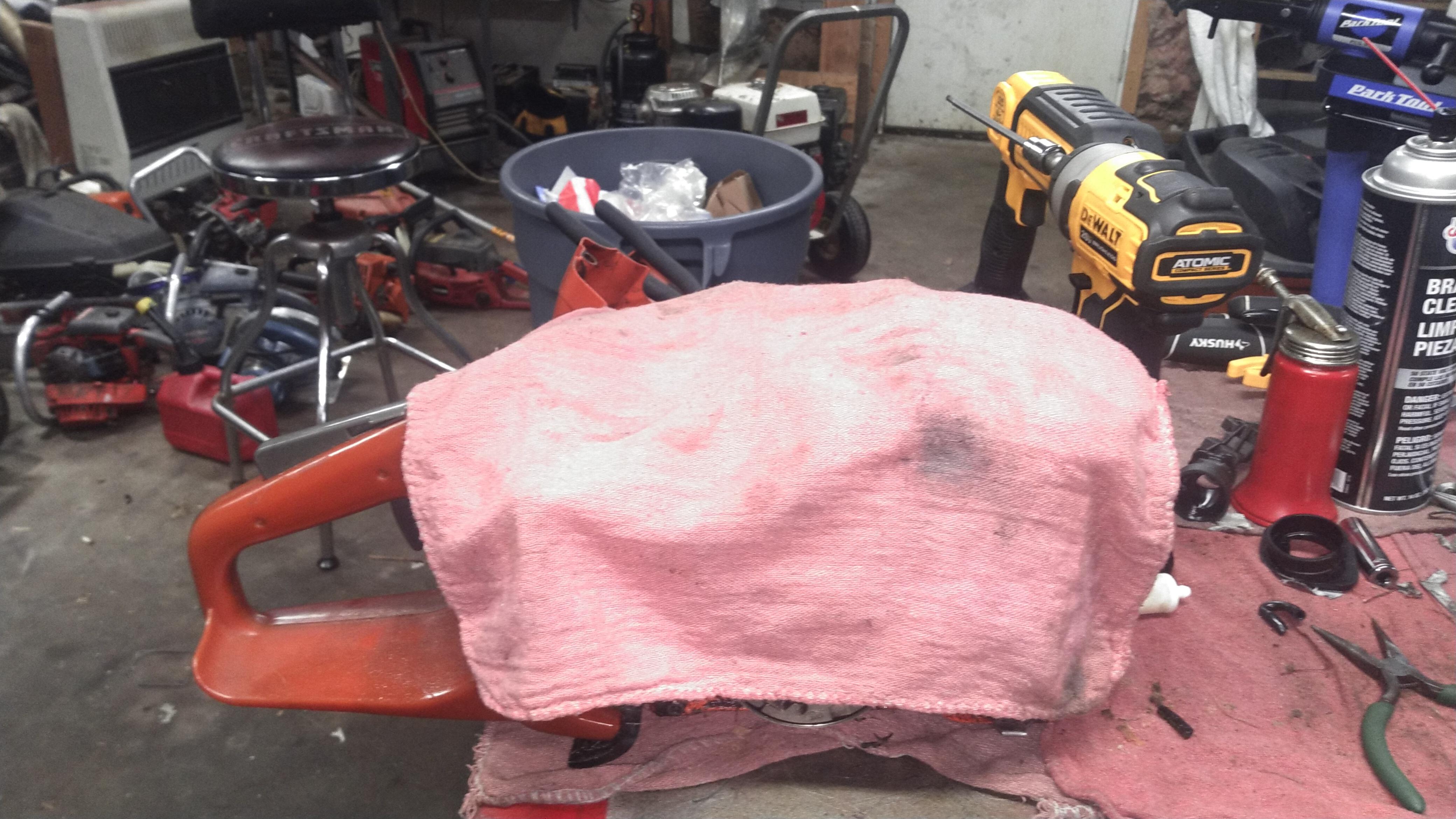

Cleaned the crankcase and cylinder gasket surfaces on my 357 and also installed a new fuel line and filter. All covered till I get my parts.

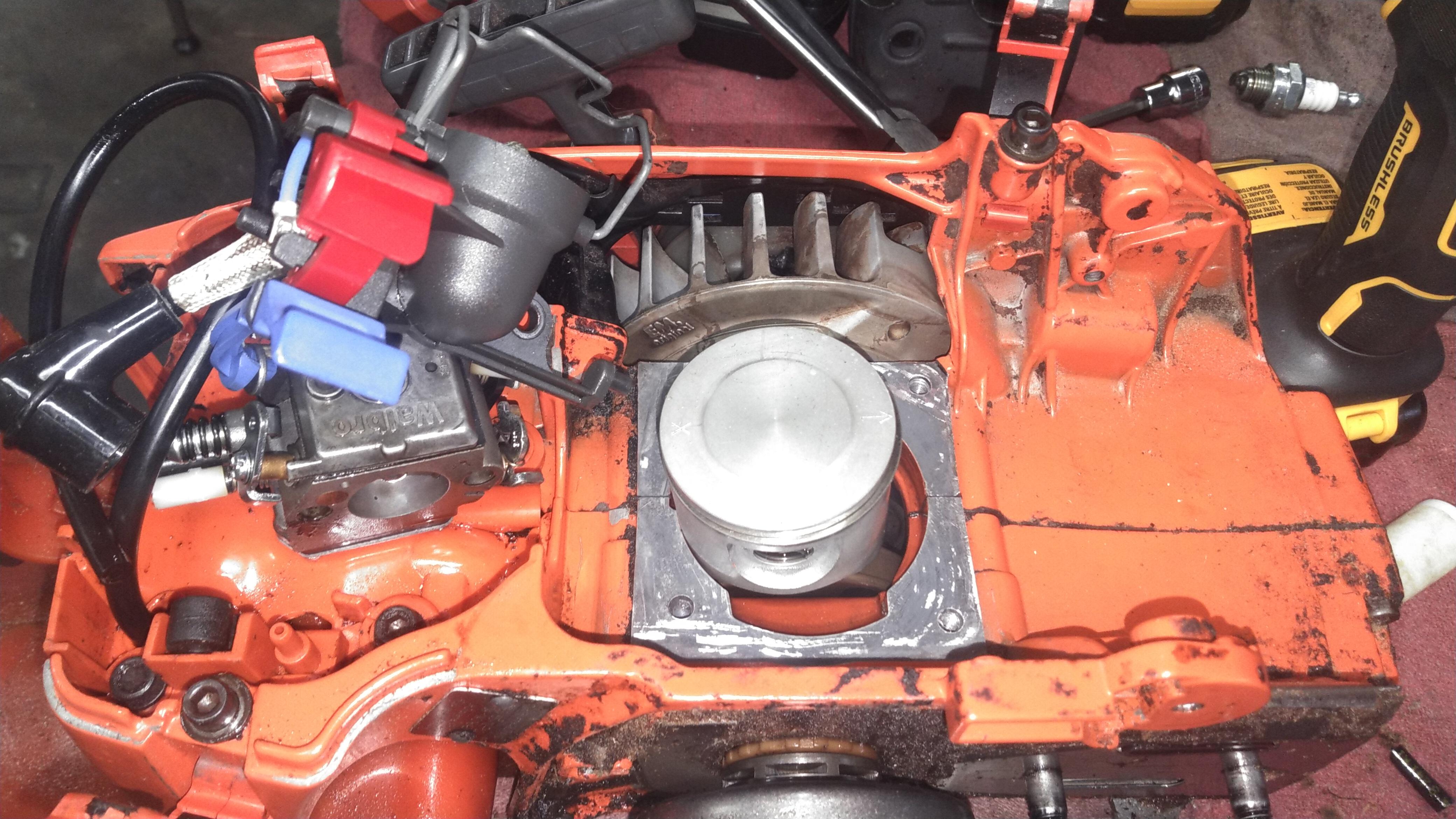

Got one of my 660’s back together, needed crank bearings and seals, I had put a new piston in it and some port work, along with a new clutch, the pto bearing was loose, and flywheel side was rough, put oem bearings and seals in. Did two heat cycles and it seems to be running well.A39F4E4C-74C2-4CC8-8116-3416C89687F6.jpegEFCA4C05-1842-436C-BA15-1A9F348EC41C.jpegit was a high hour logger saw

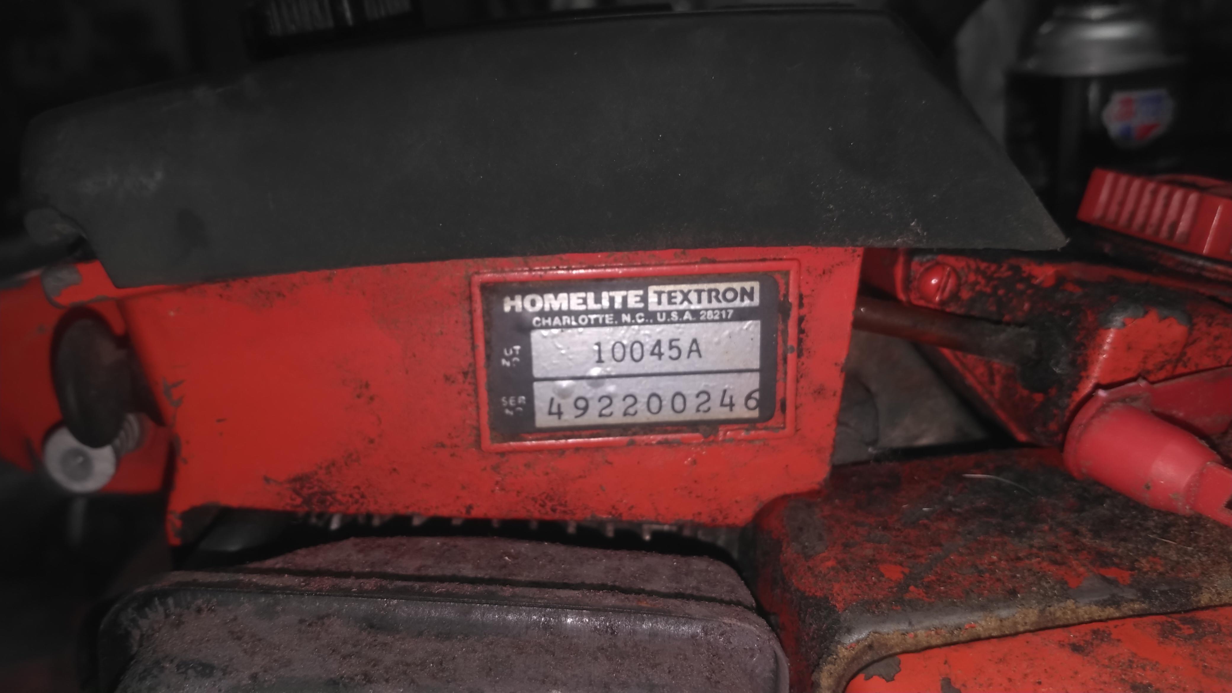

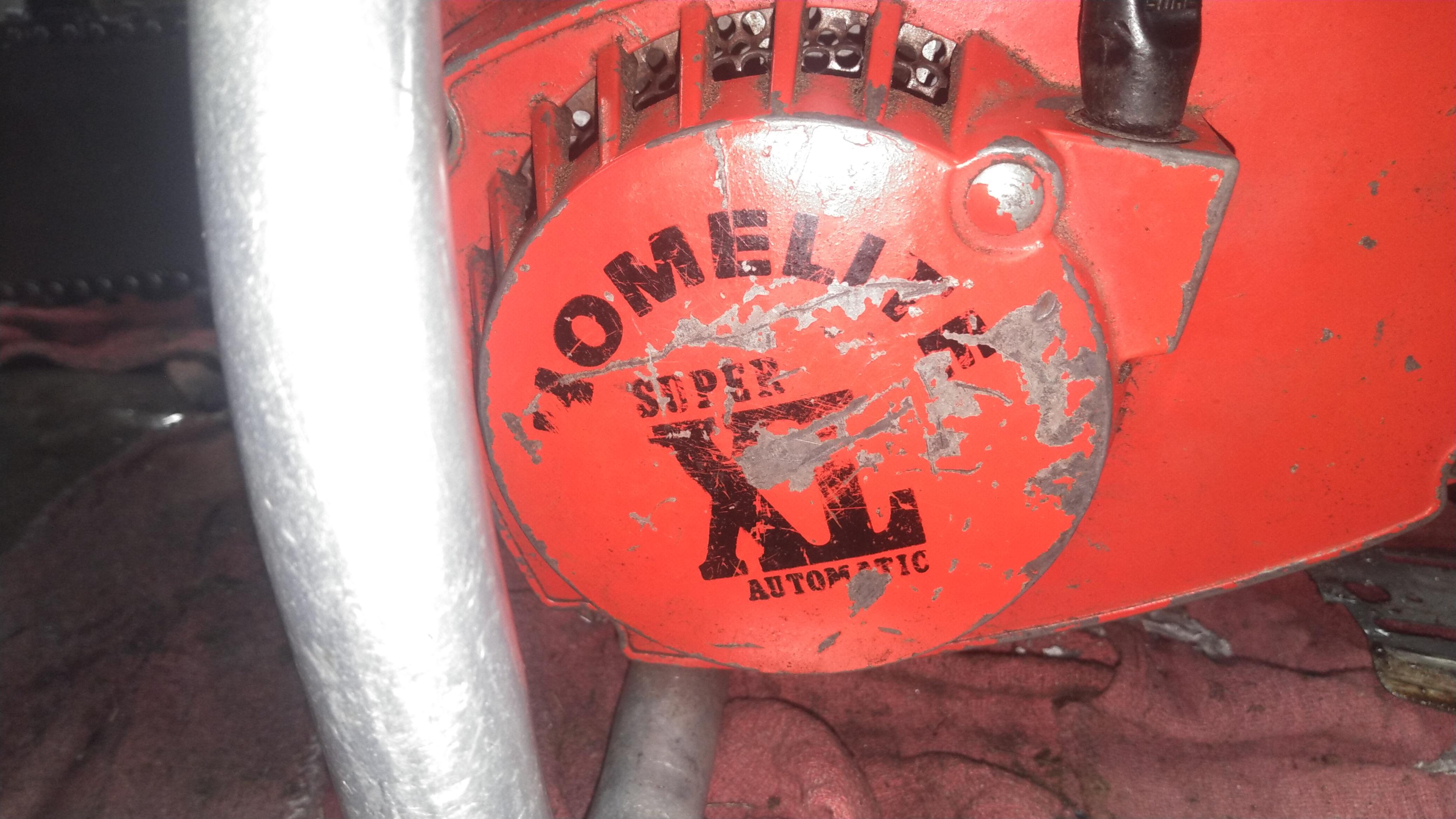

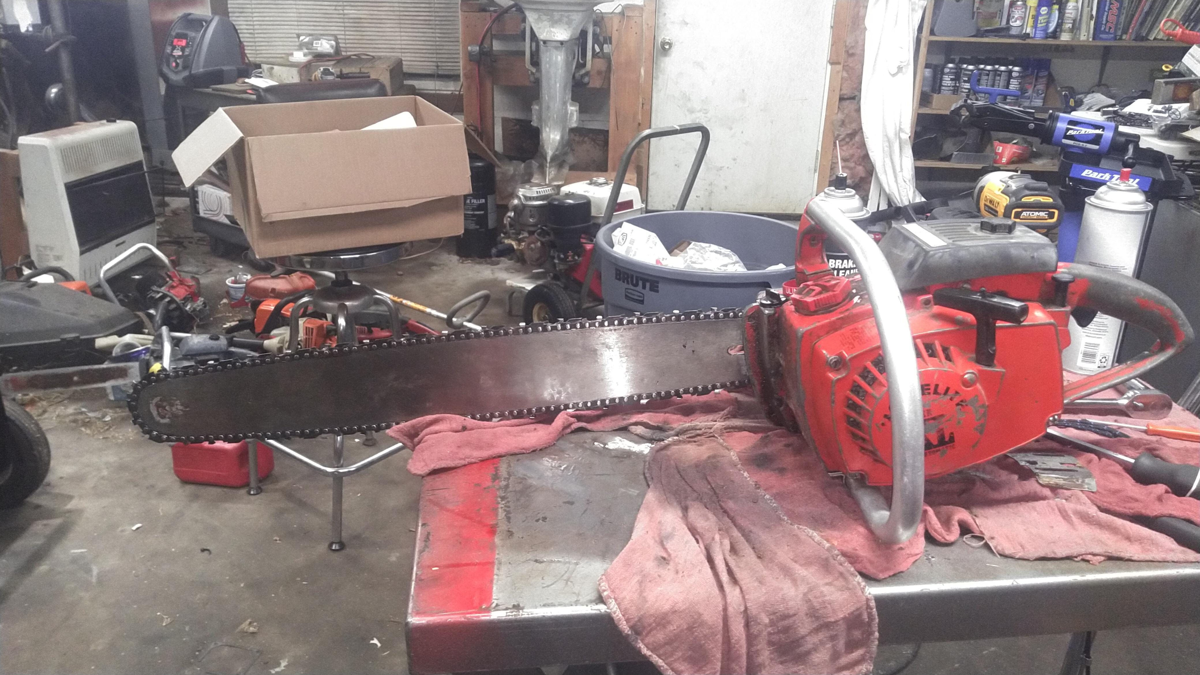

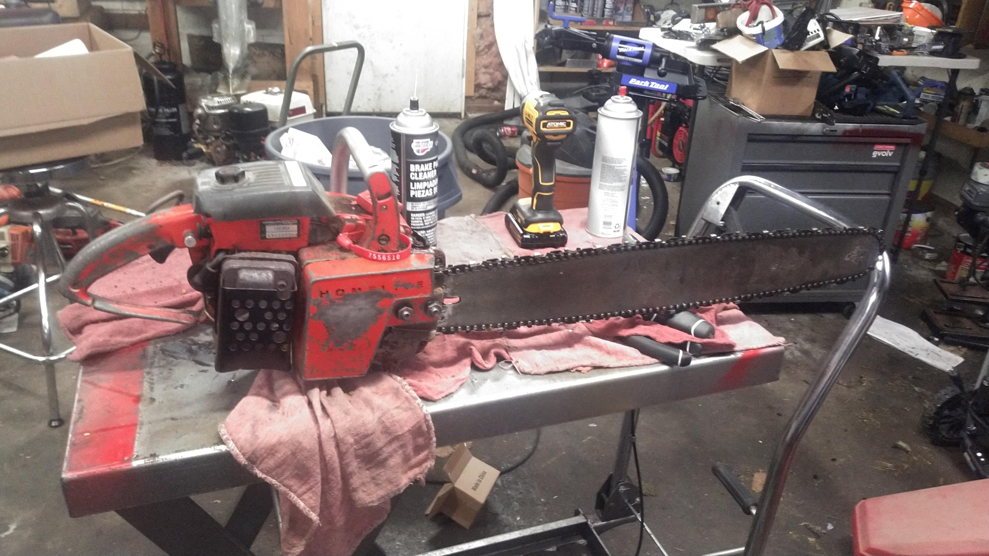

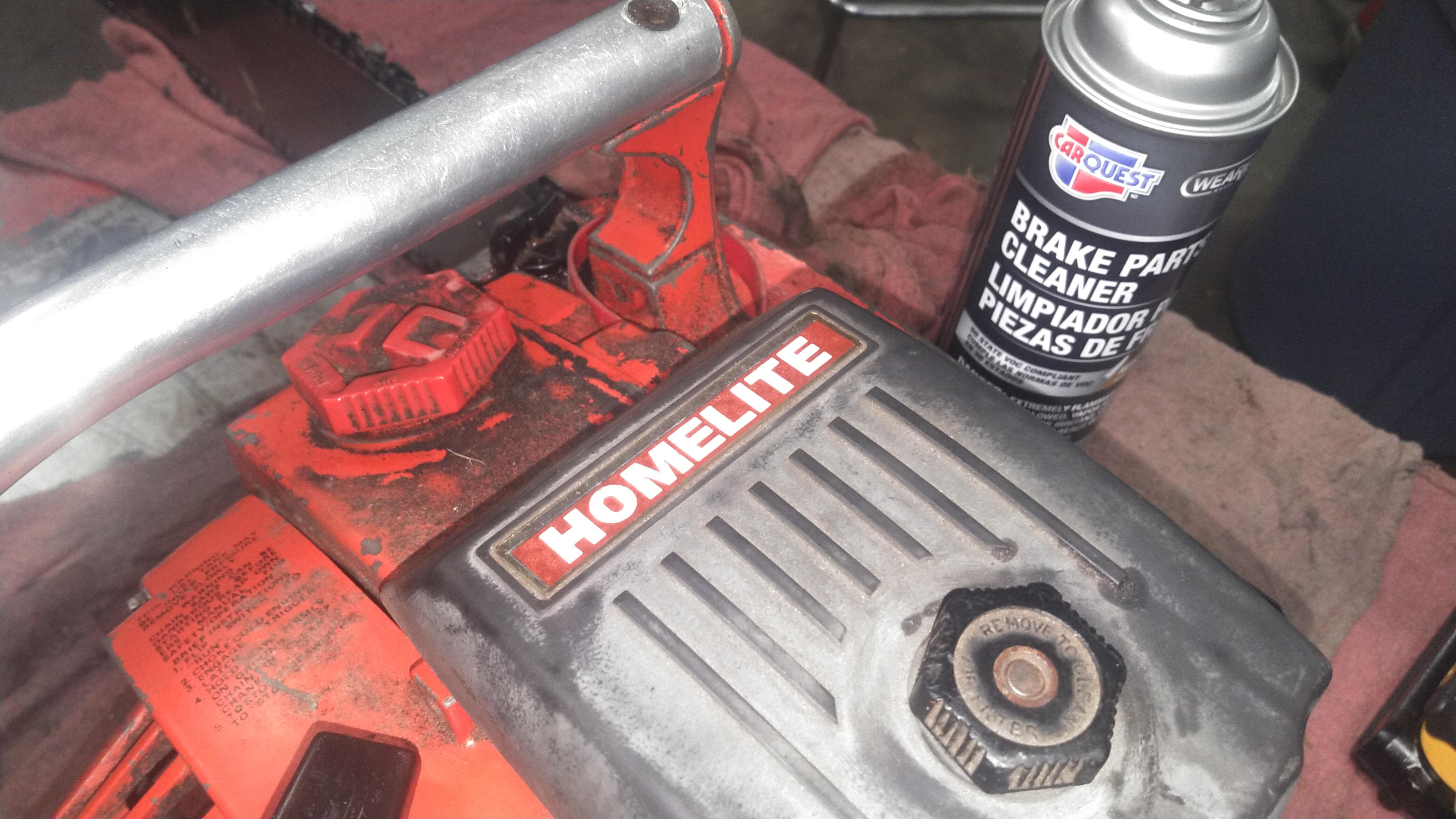

1980ish Homelite Super XL Automatic. Came from a customer who decided to not repair it. Dumped some 40:1 and bar oil in it and it popped off pretty easy. Tweaked carb slightly and running sweet. Found a good outer bar plate for it and made sure it was oiling. Reinstalled bar and chain and ready for the wood.
I remember running a XL12 looked like that but manual Oiler.
Did a great job till I replaced it with a Stihl 036 in 1994. Man I thought I hit the jack pot of saws.
Similarly, I replaced my Homelite 330 with a Stihl 10 mm 044 in Dec 92 … never ran the 330 again!
