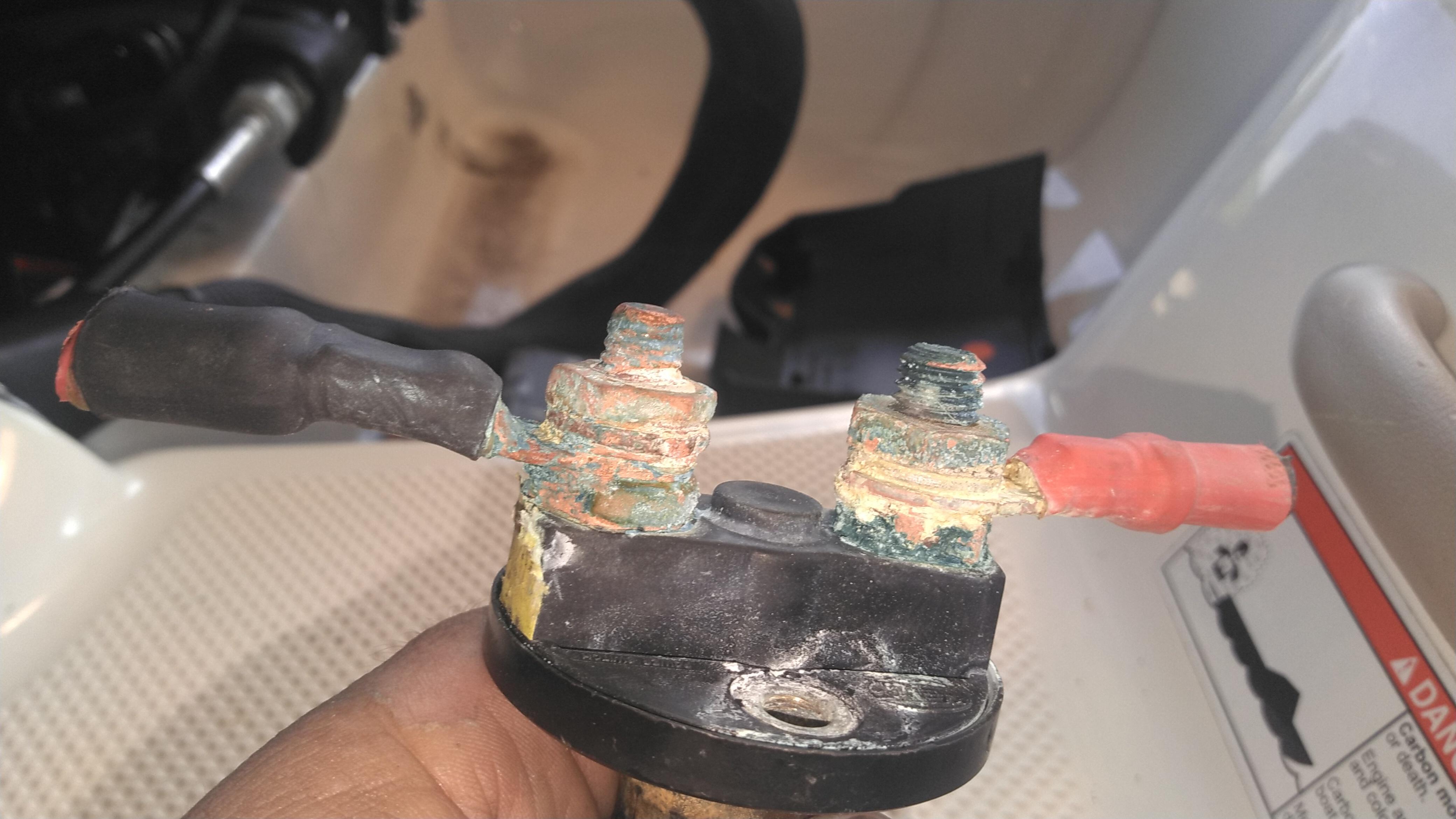

No crank no start on a Bayliner today.

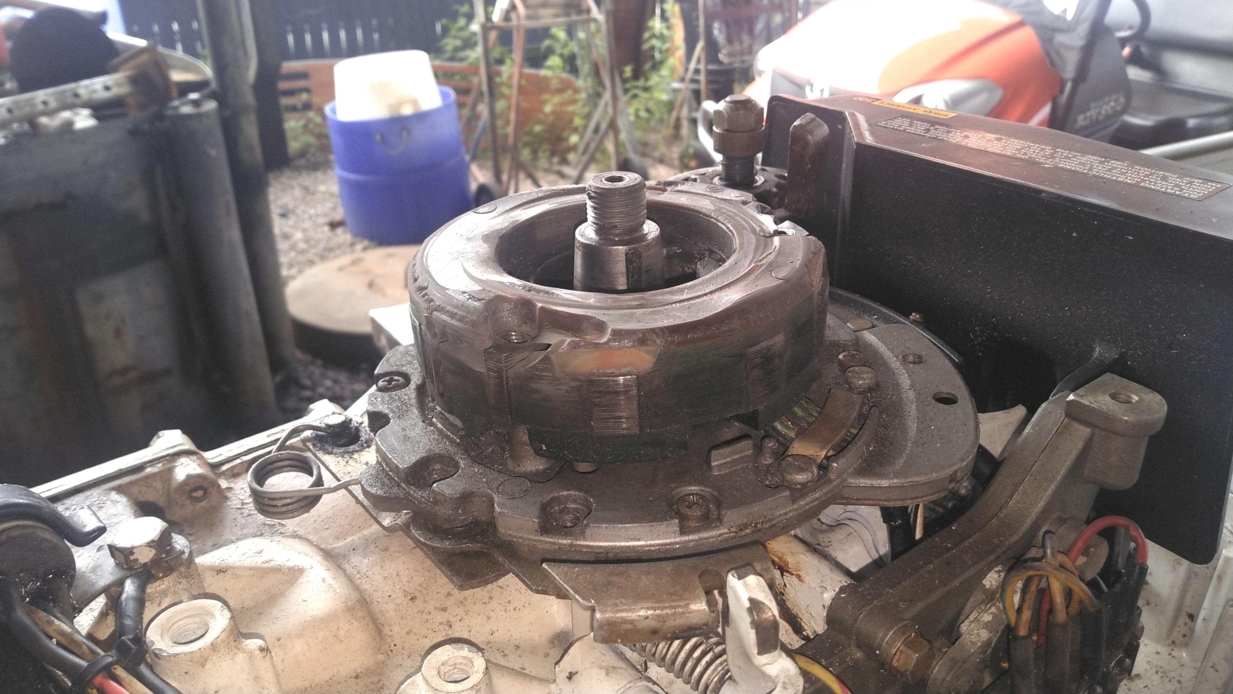

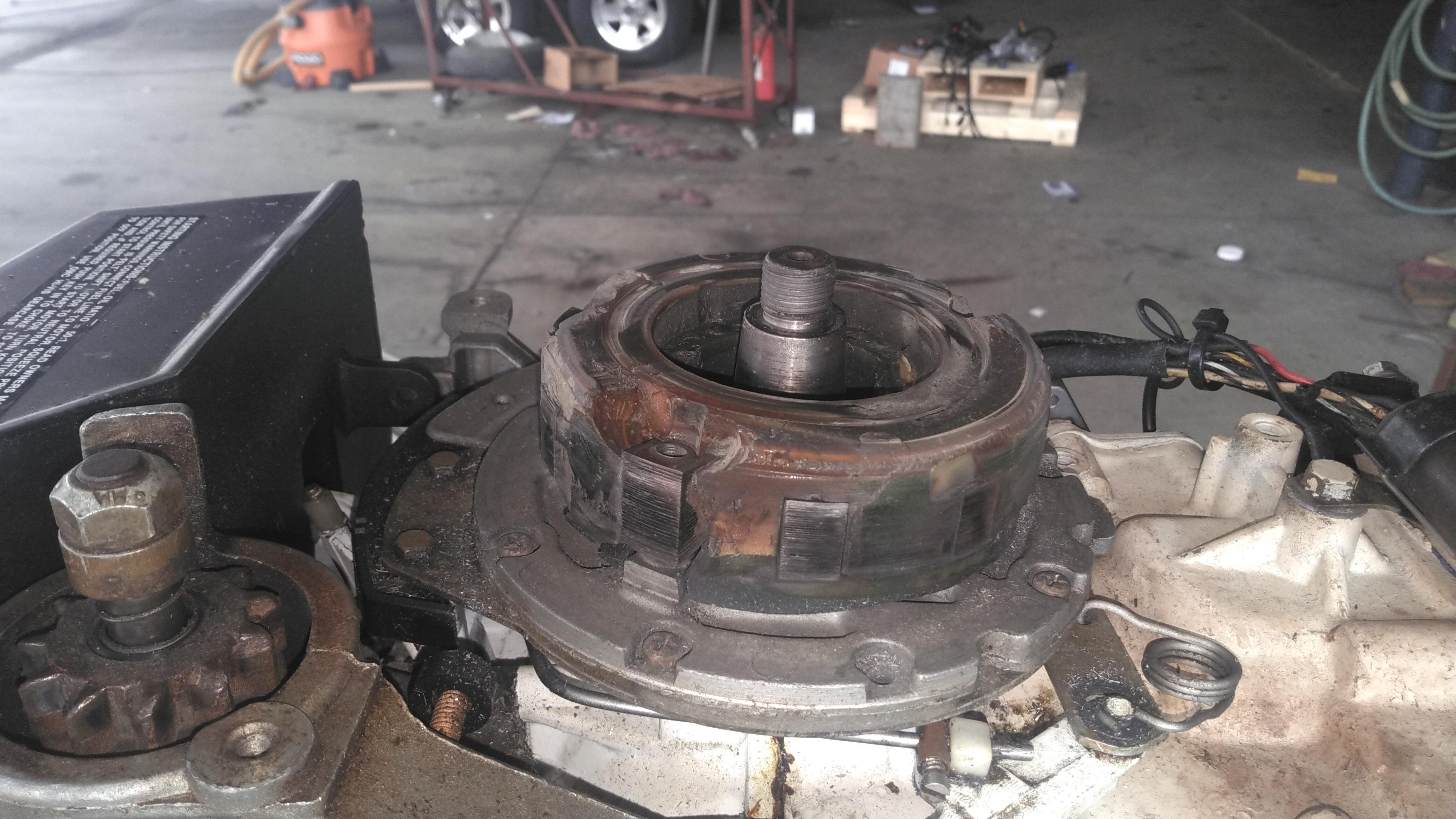

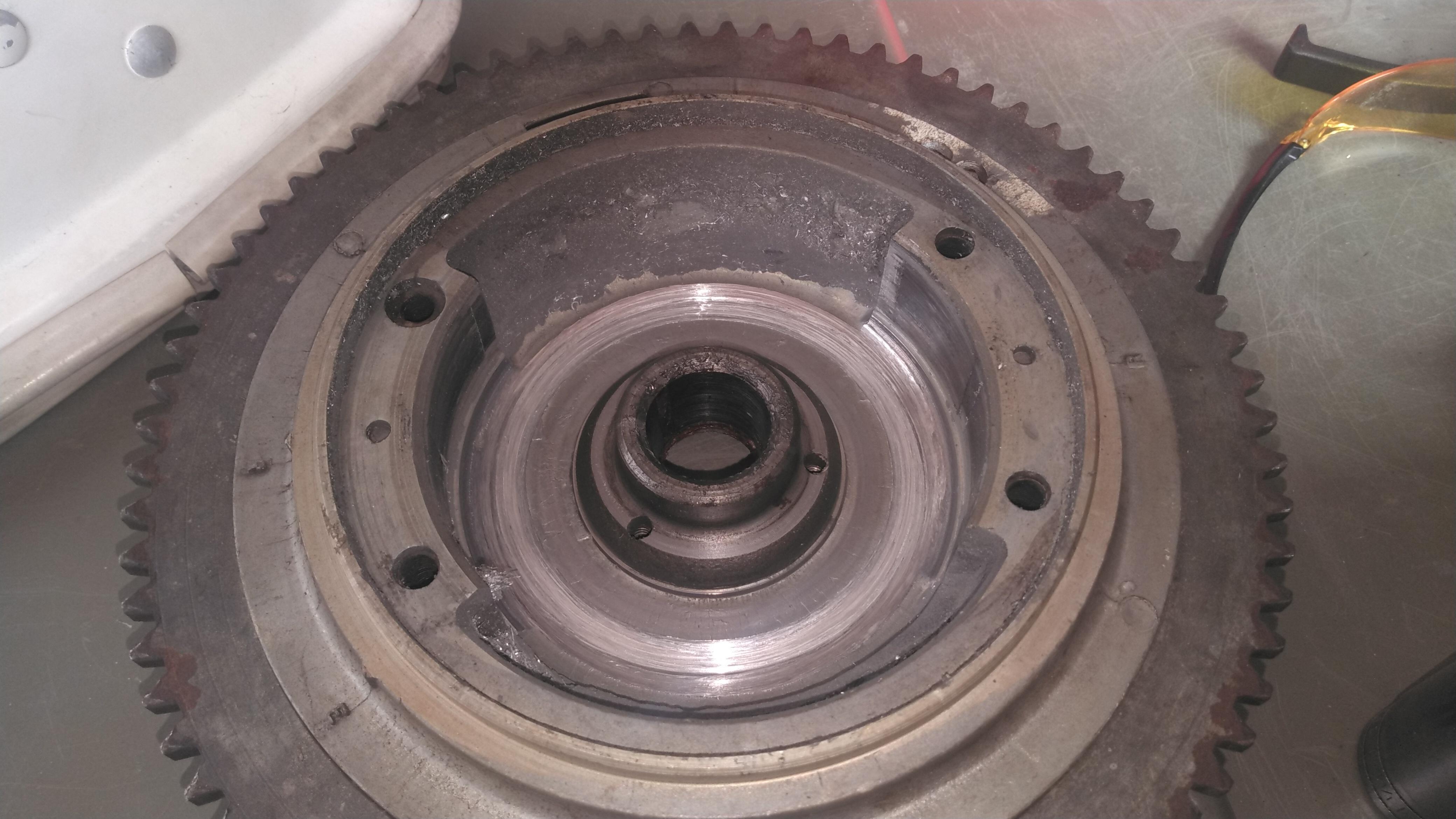

The Johnson 35 that I worked on a week ago came back, but for an unrelated issue. It was running along fine and just died and would not restart. Pulled the flywheel and found the stator loose and damaged, flywheel was damaged too. Pulled the stator plate and flywheel off the 25 I got the exhaust tuner off of and once it was all back together it started right up.

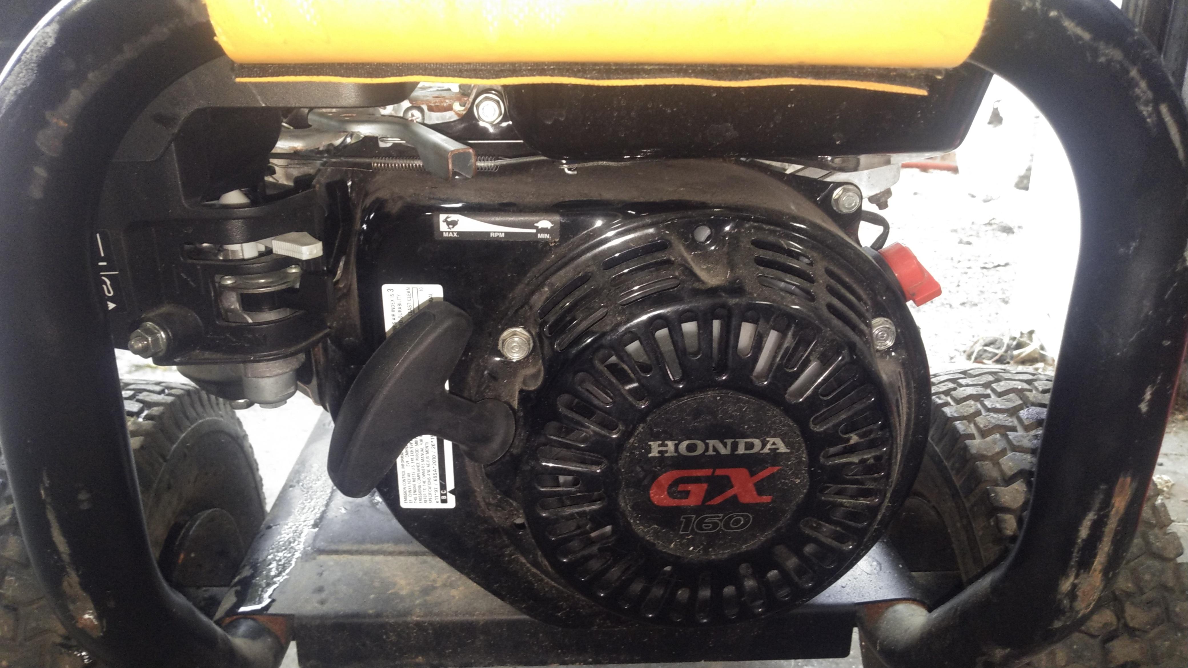

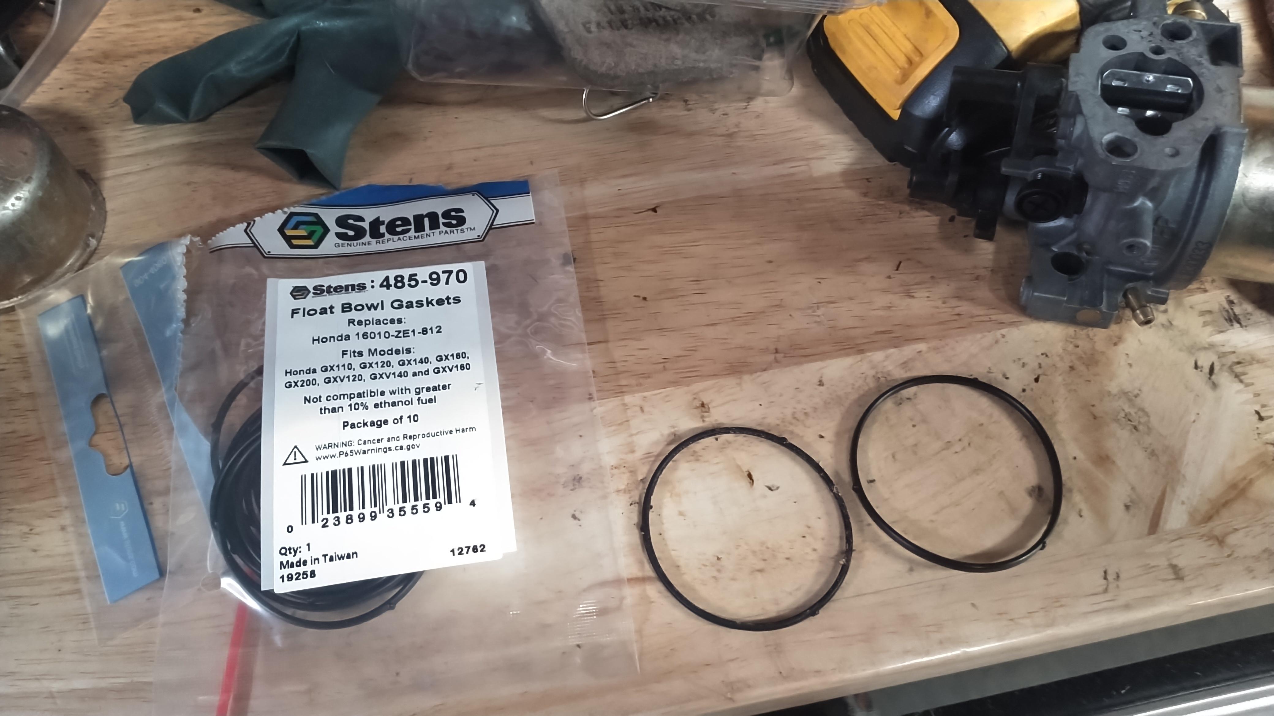

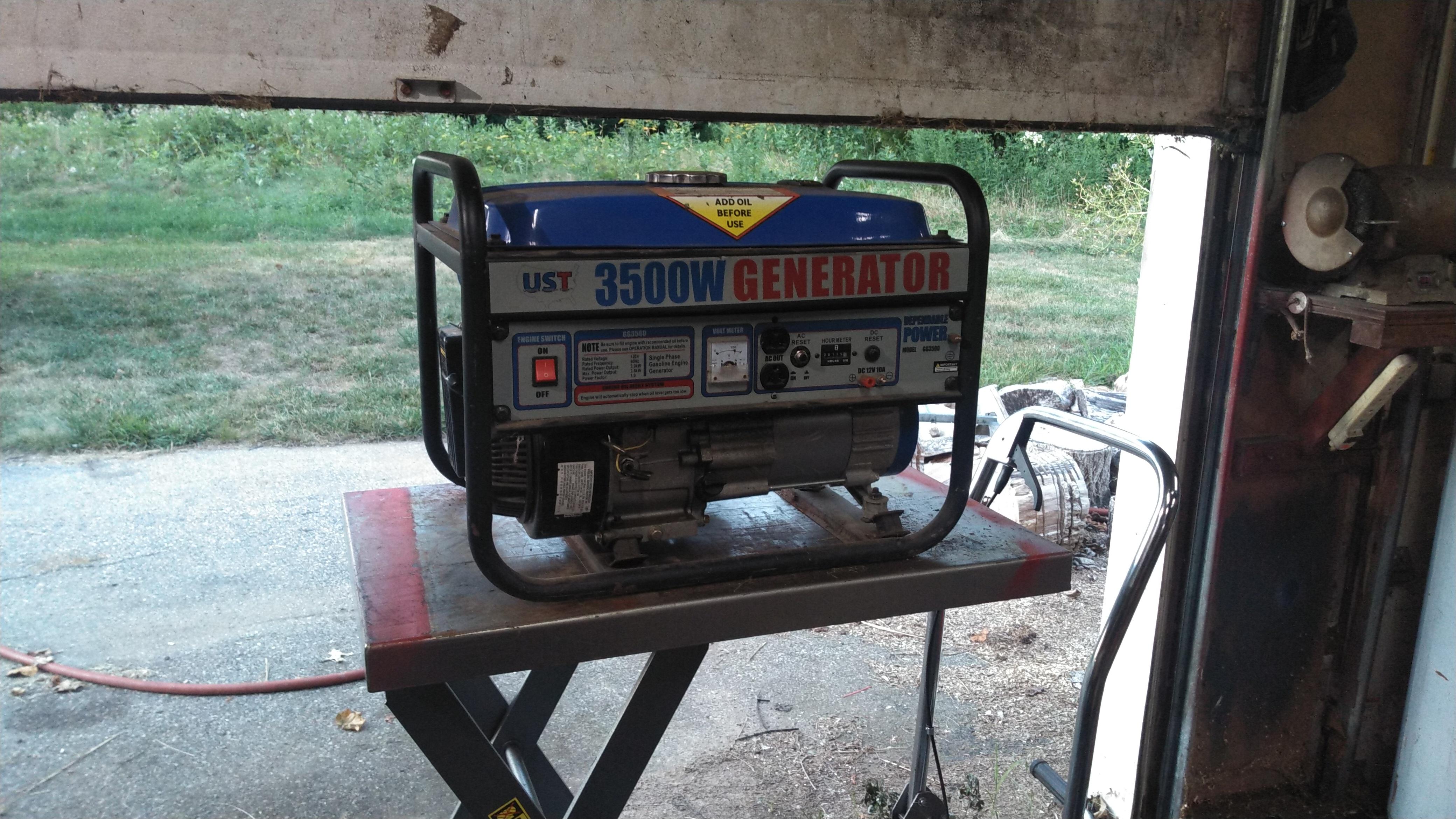

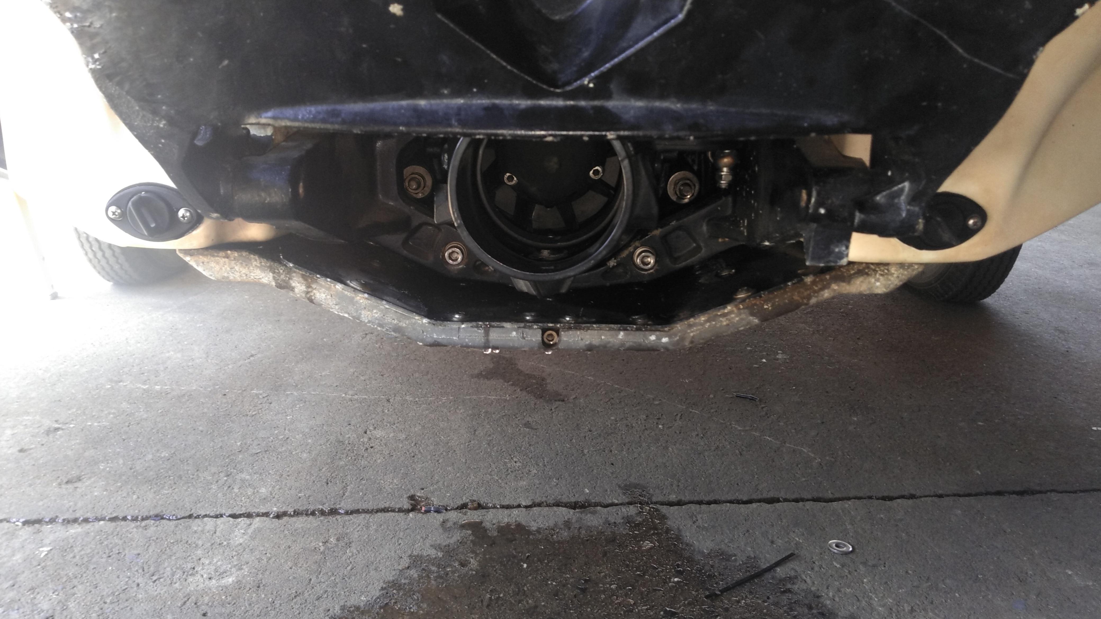

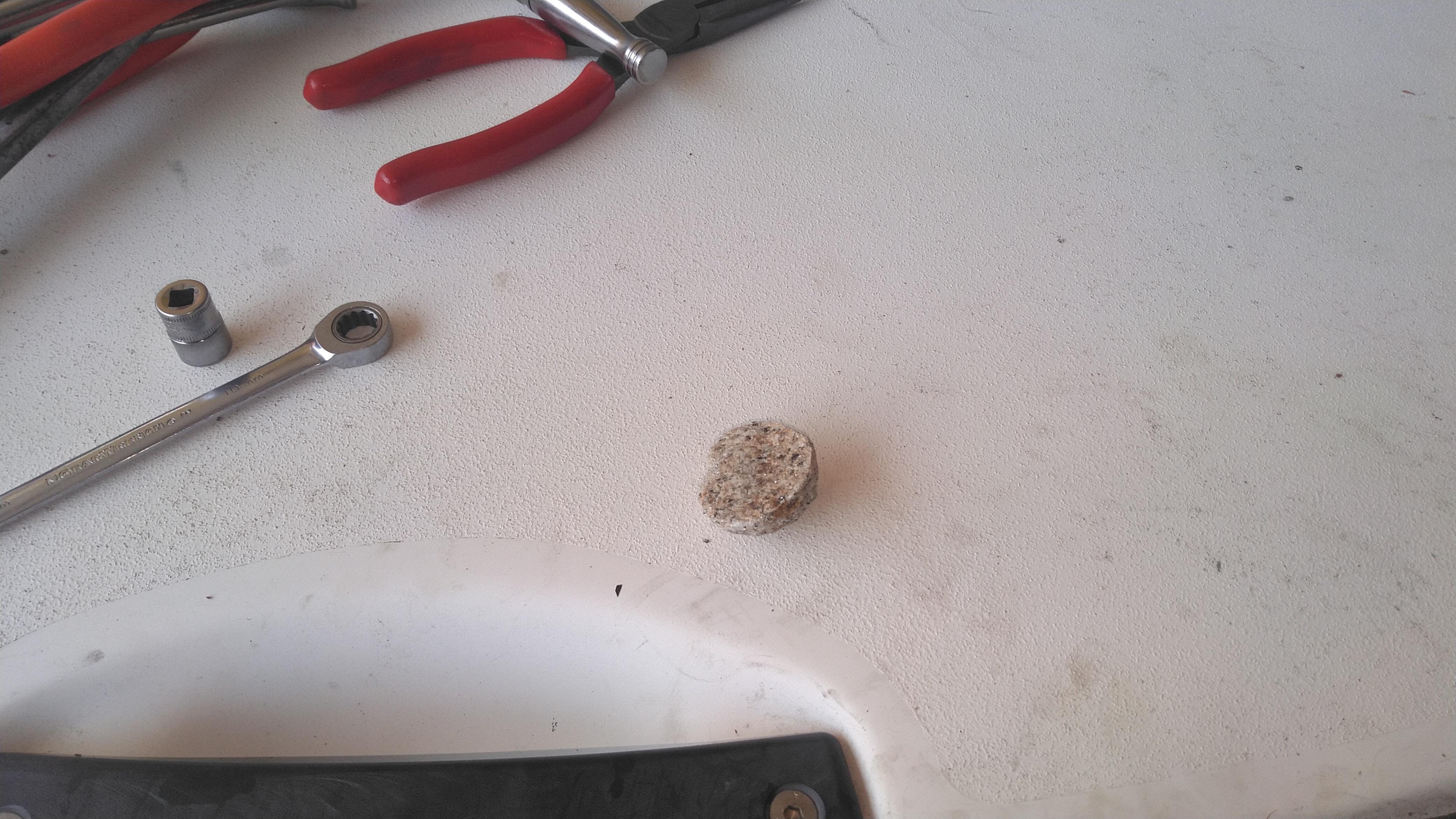

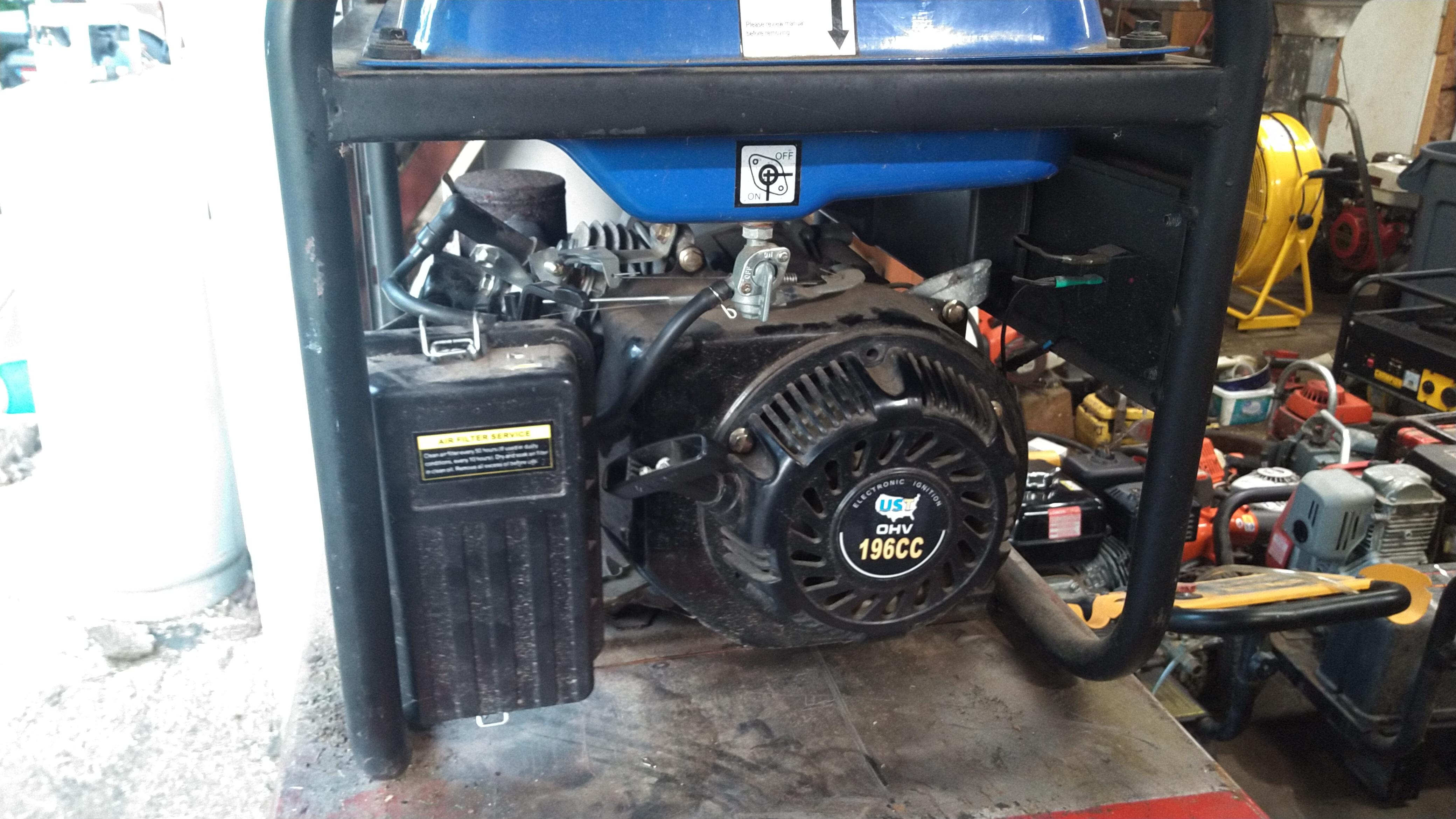

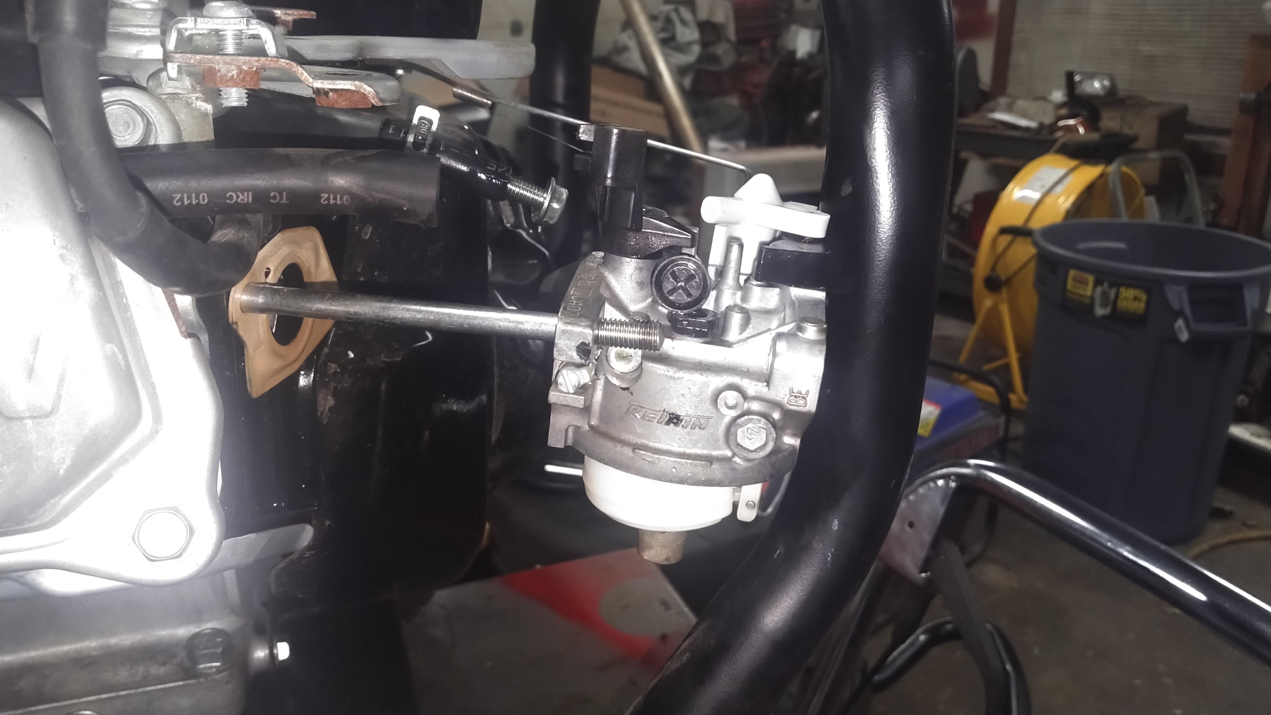

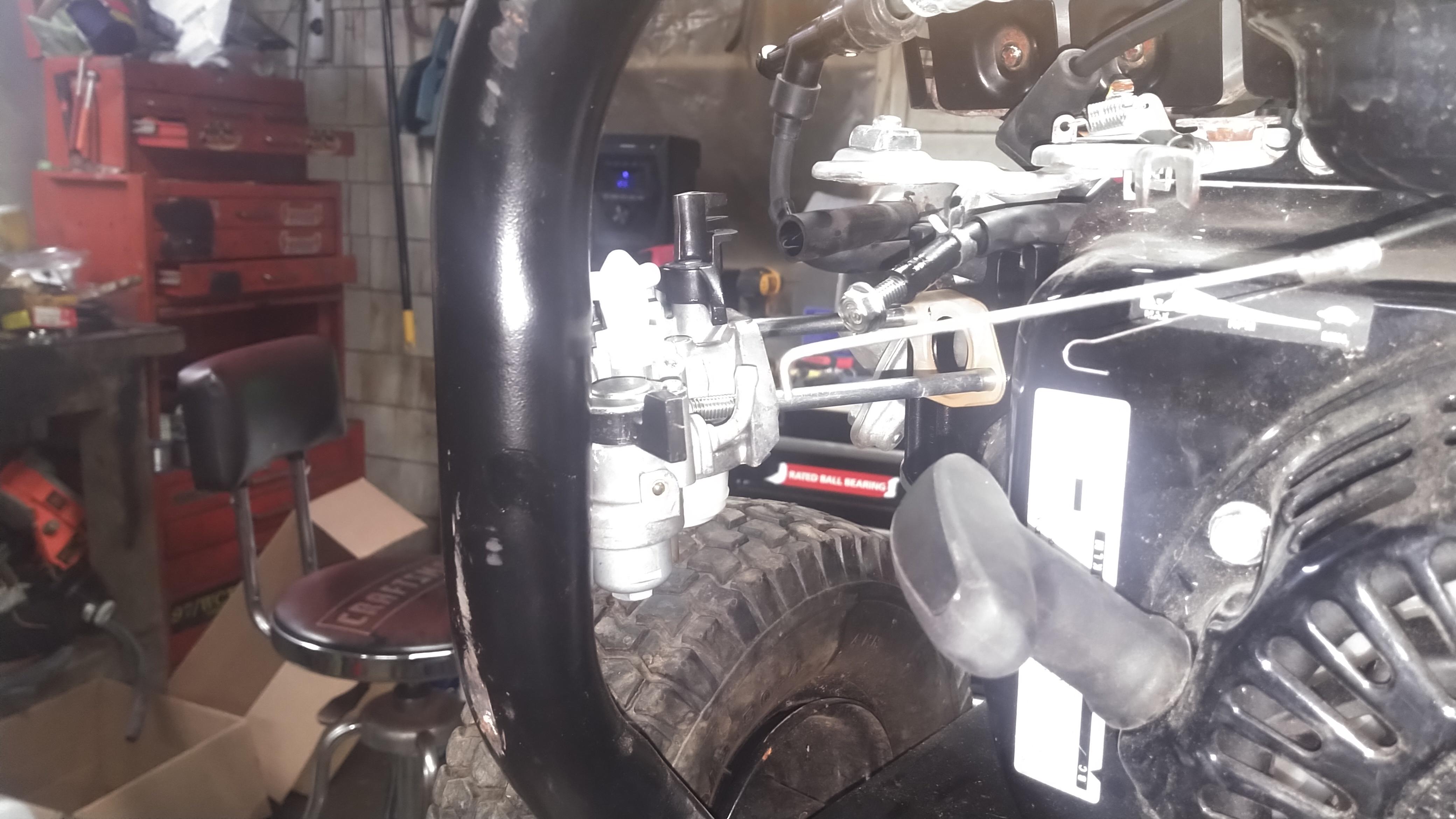

This morning at work I extracted a rock from the jet pump on a SeaDoo jet boat, then got another boat done and started prepping a sold used boat. Got home and put a new carb on the 3500 watt Chinese generator dropped off to me last weekend. Ended up having a bad needle and seat. Also found a solution for float bowl gaskets on the smaller Chinese Honda clone engines.

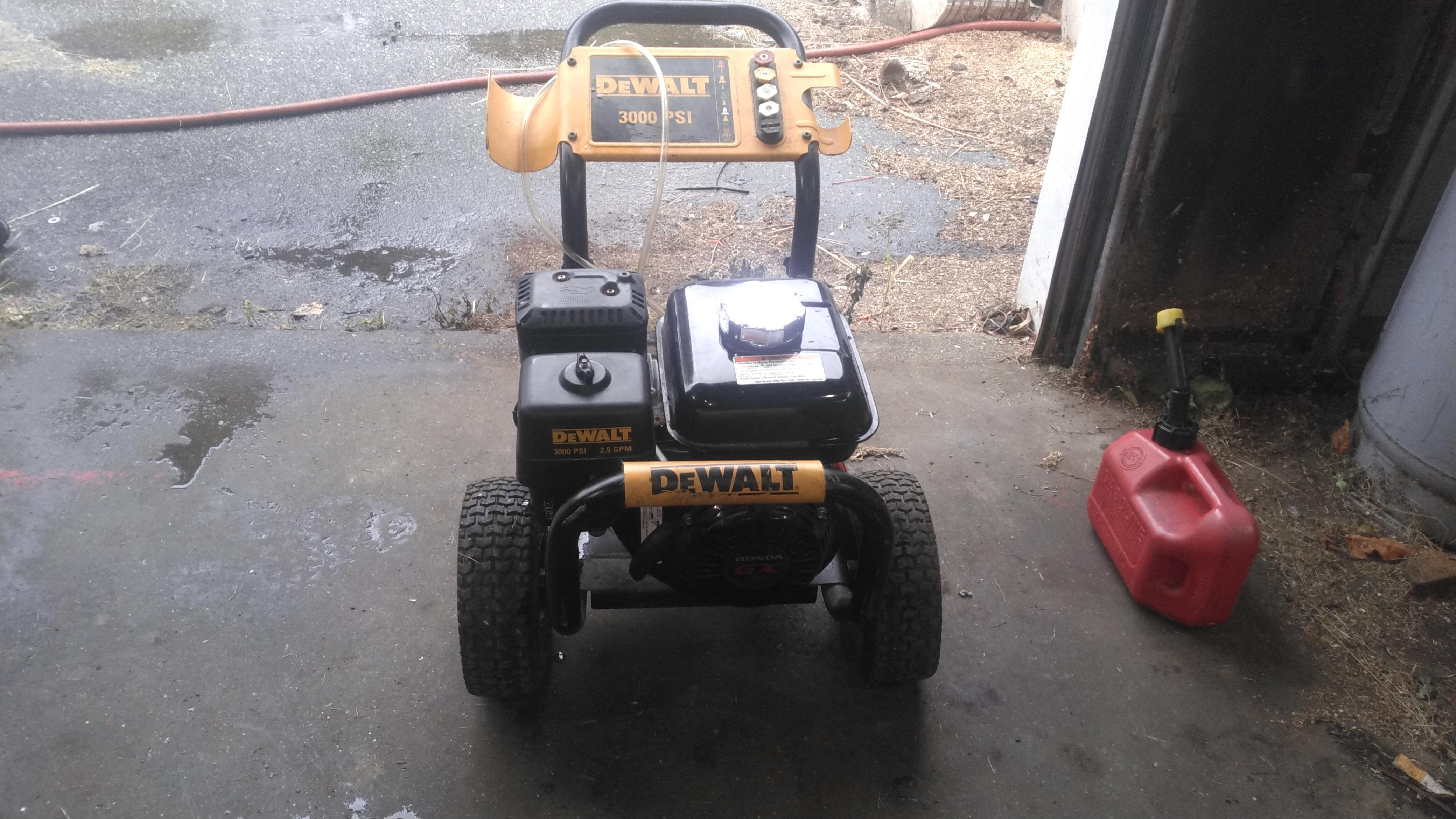

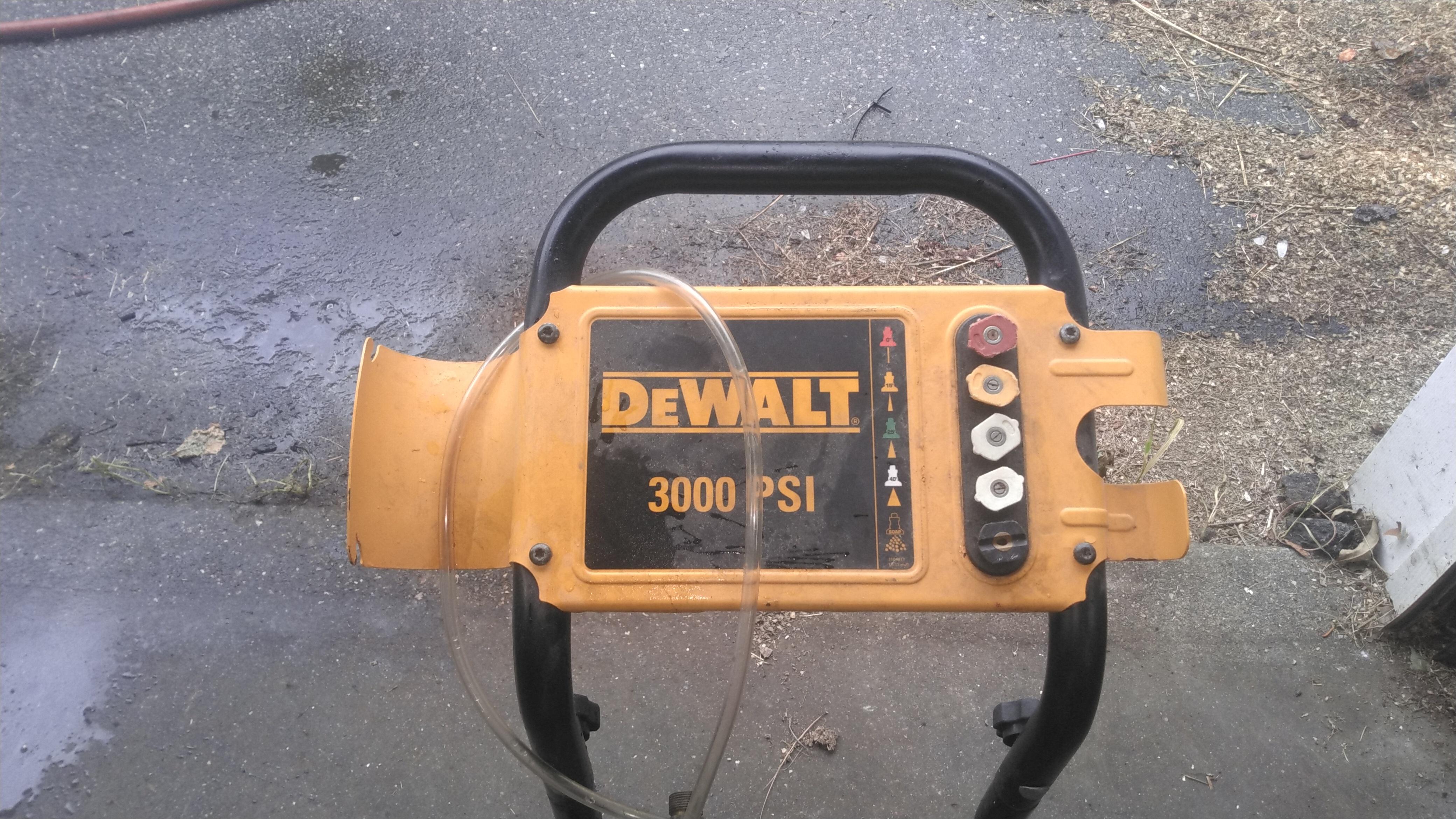

DeWalt 3000 psi pressure washer. Came in for not running. Found stopped up main jet in the carb. Ultrasonic cleaned the carb and replaced the bowl gasket. Tested with water this morning and it ran great. A bit of a pain in the butt to remove the carb, frame stopped the carb from being able to be slid off the studs so I double nutted the studs and removed them.

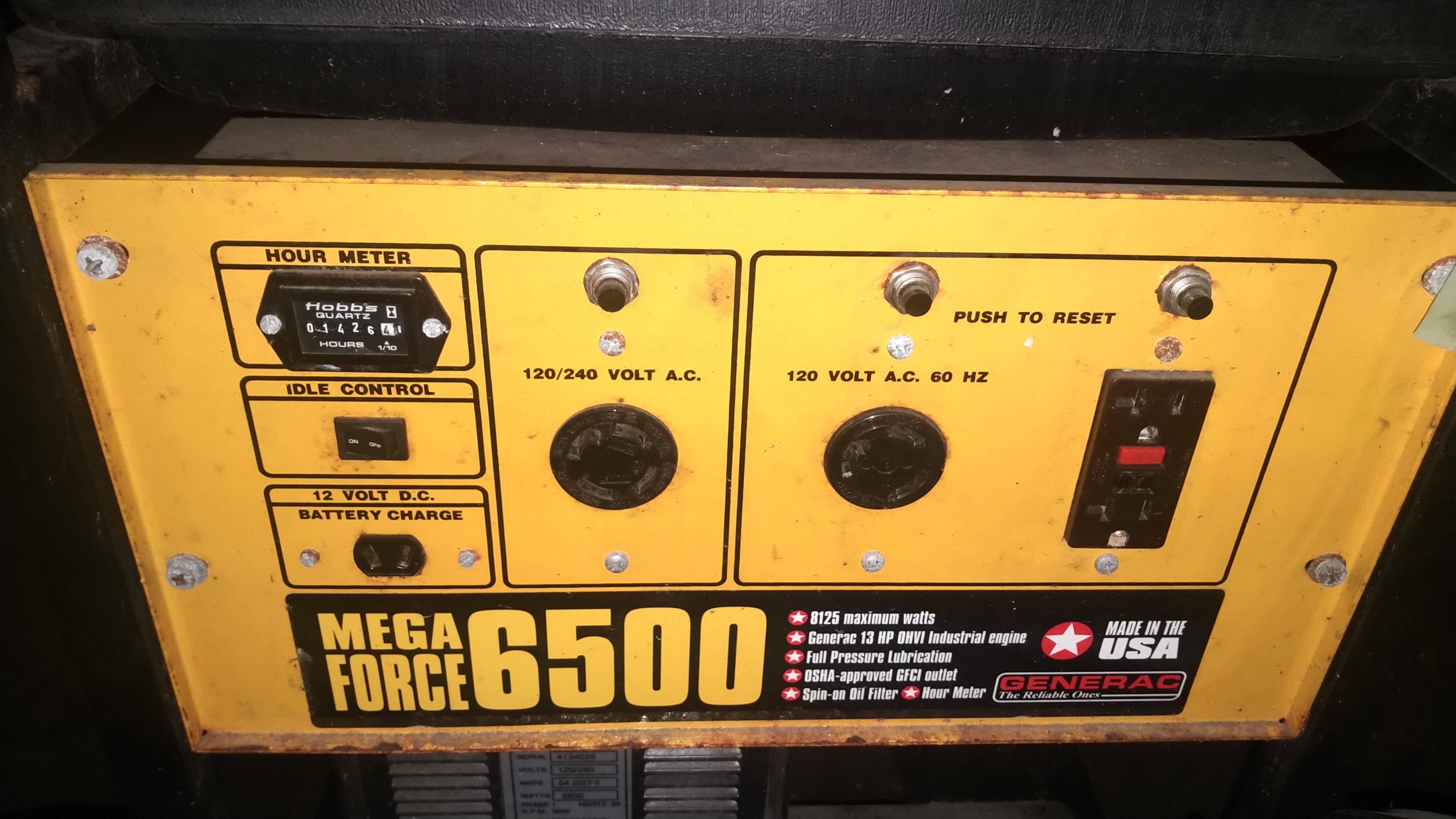

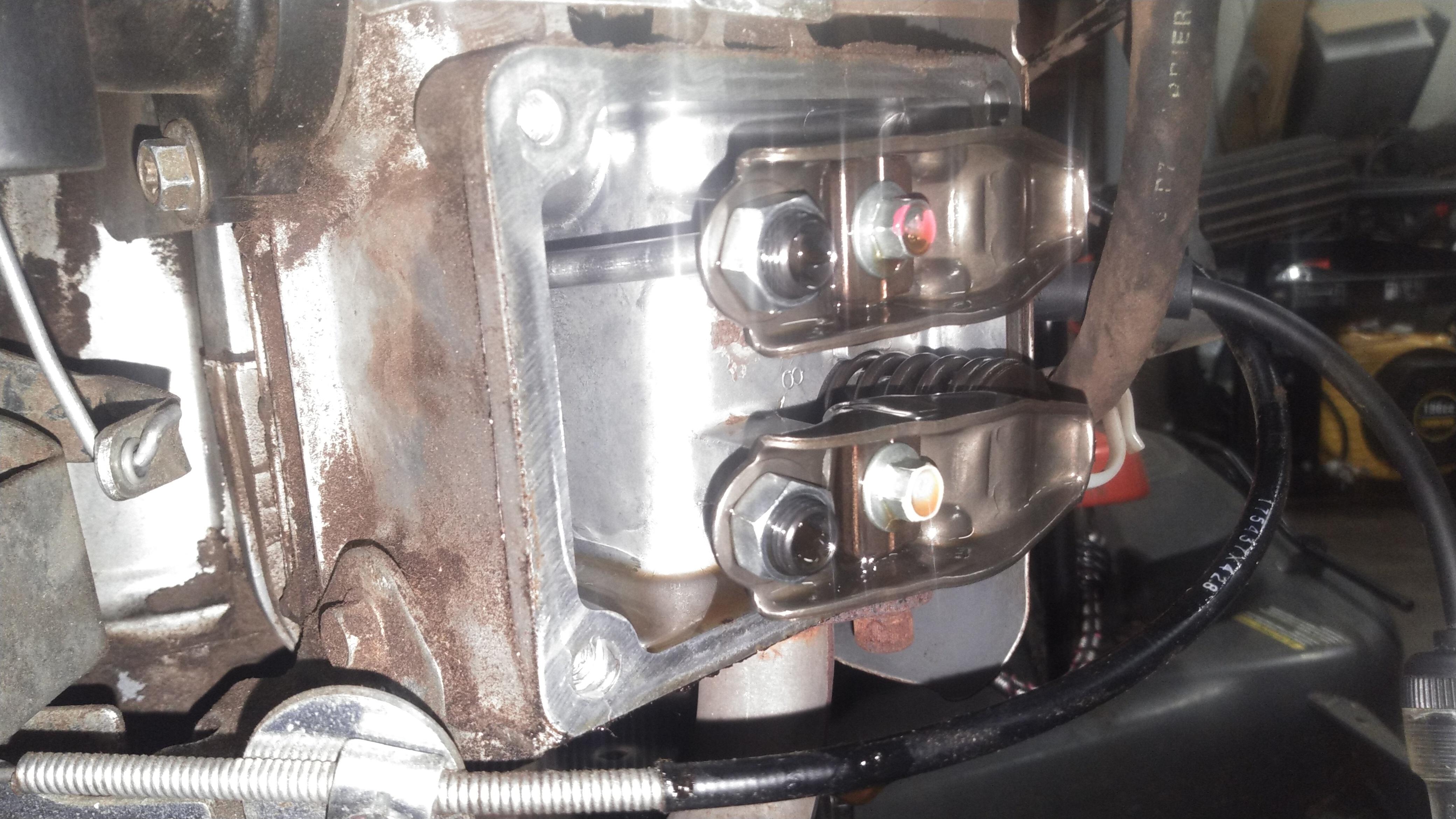

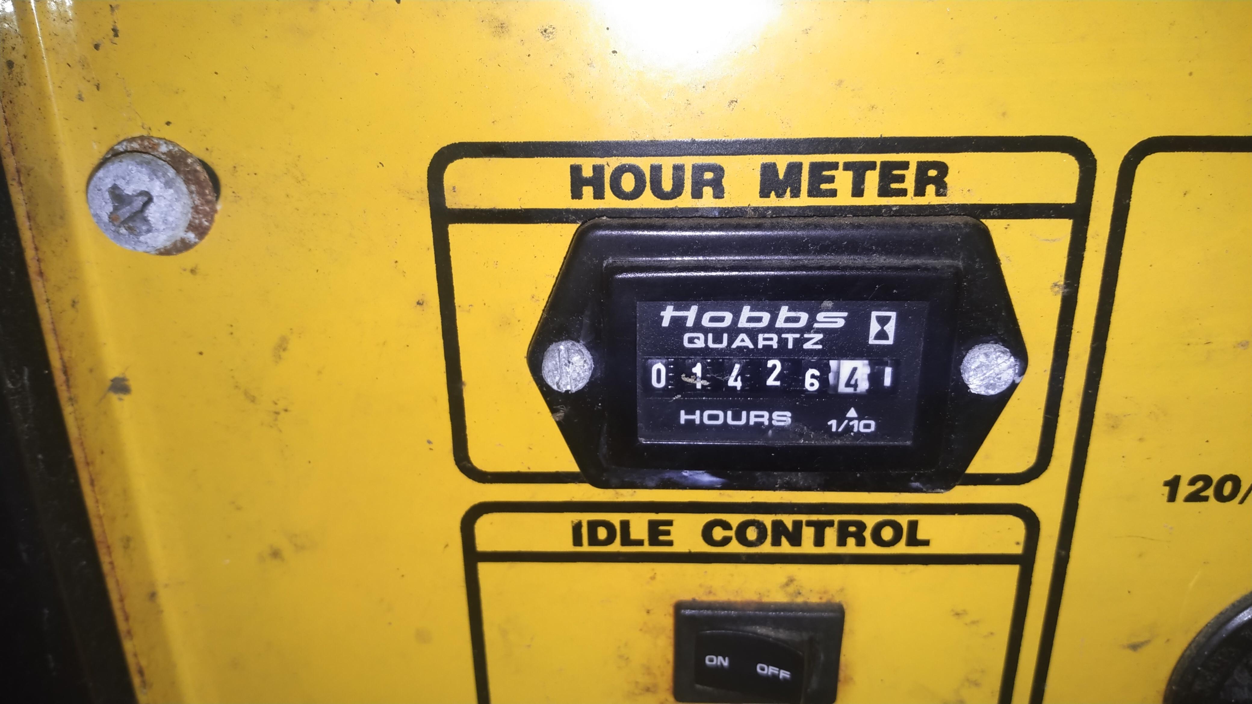

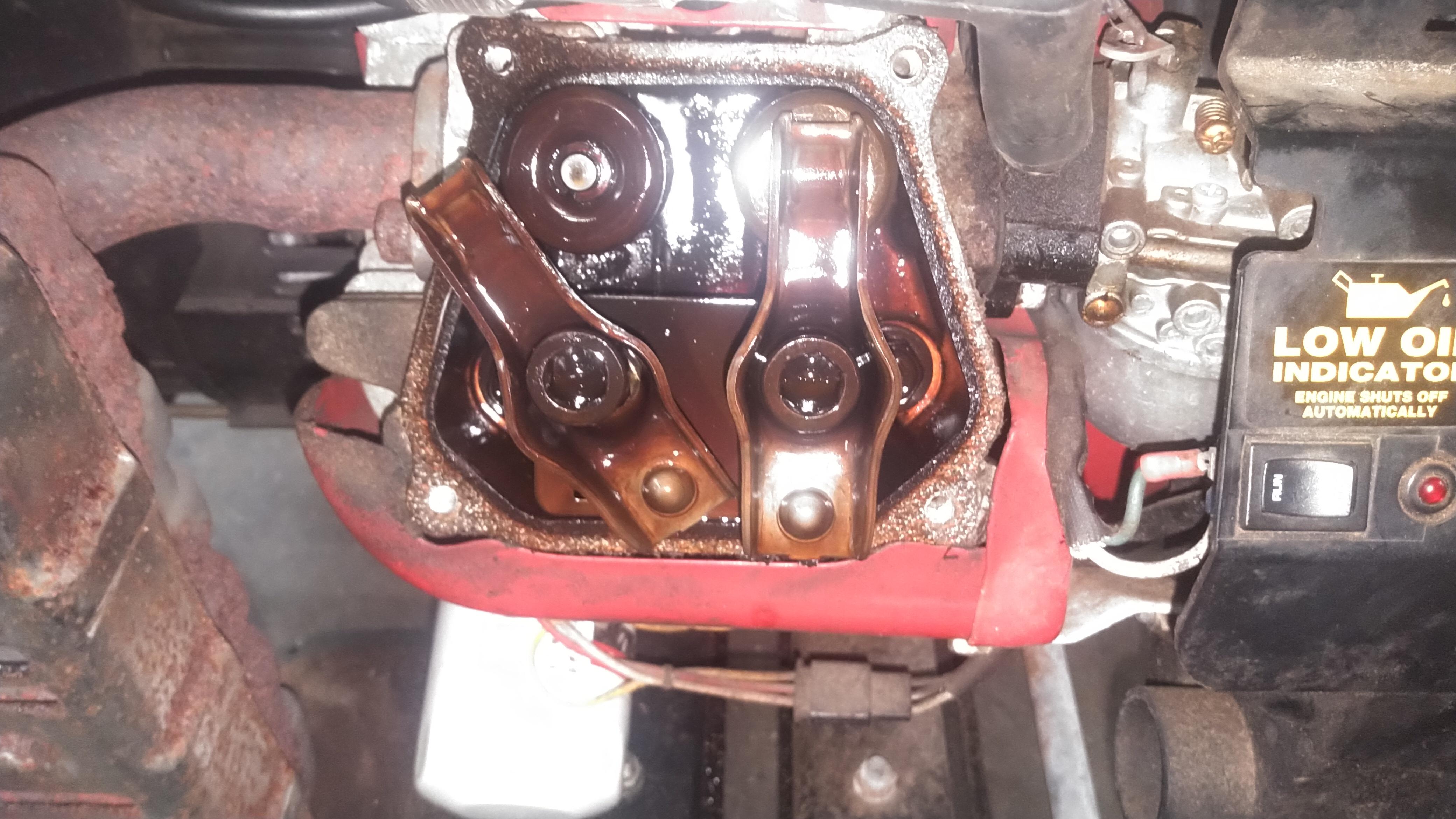

Another machine with valve problems. 2nd engine with valve problems this week. 6500 watt Generac Mega Force with 1426.4 hours. Ran out of fuel and would not restart. Massive compression loss through the exhaust valve. I think it dropped the exhaust valve seat. Gonna pull the head off and see what the damage is.

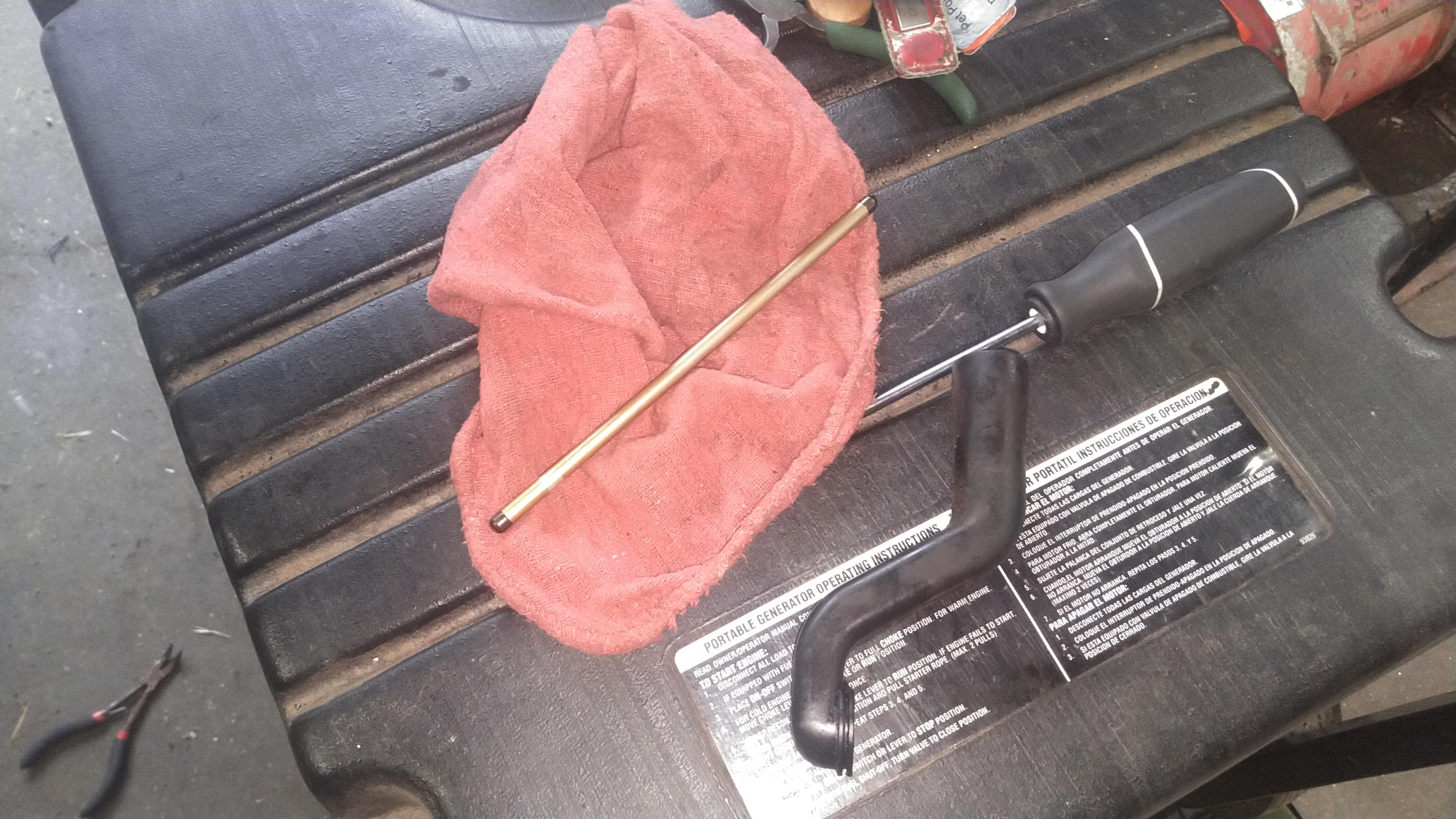

First engine this week with valve problems was a Briggs Intek 23 with a missing exhaust push rod and bent intake push rod. Waiting for push rods and a valve cover gasket. Gonna put the push rods in, adjust the valves and see what happens.
