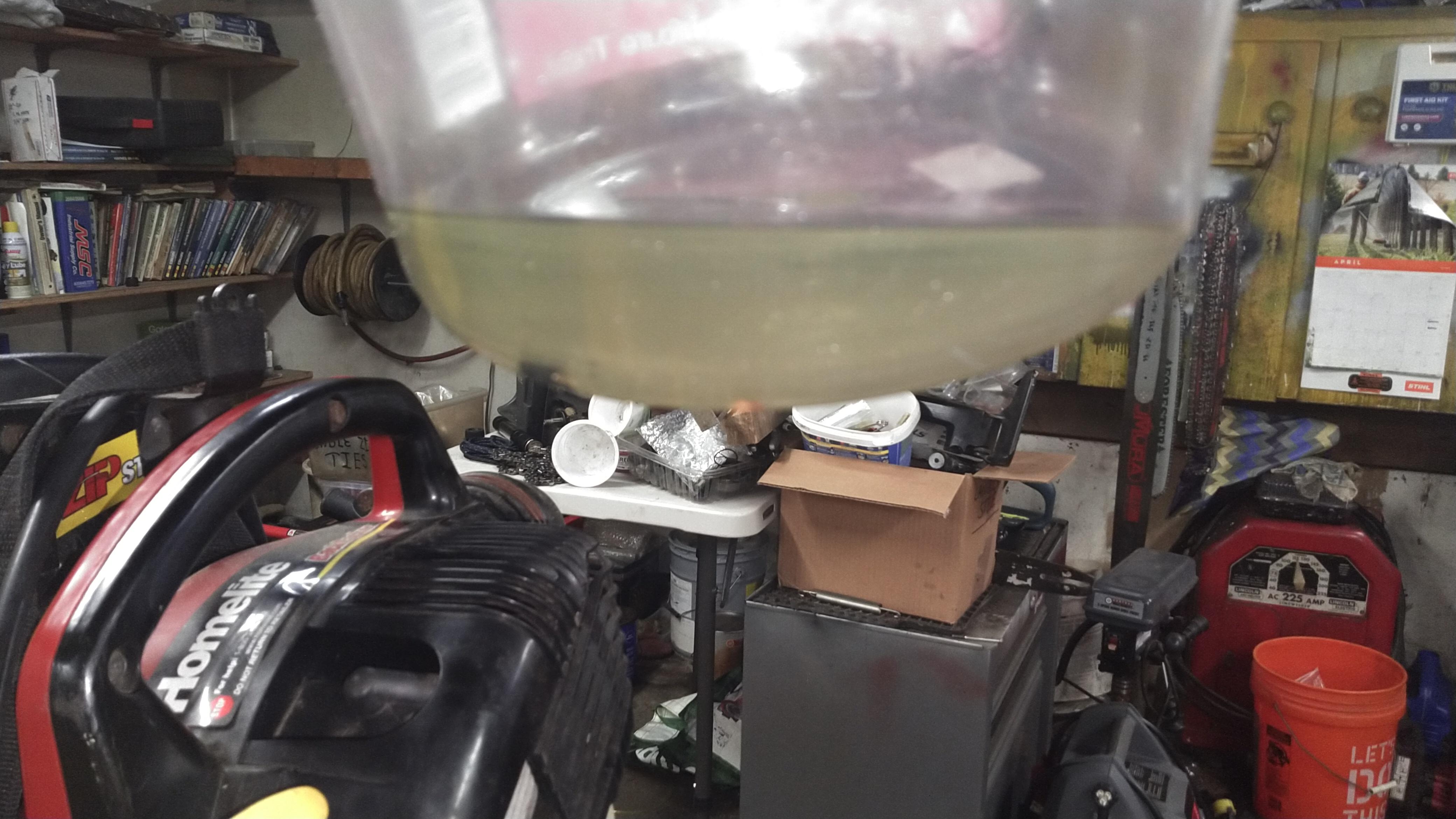

This lovely pile.... customer complaint was won't stay running. Found the typical rotted fuel lines and hard carb diaphragms. Dumped the fuel tank and it was straight gas... luckily it wouldn't run long enough to cause damage. Piston still looks fine. Getting fuel lines, filter, carb kit and new air filter (was missing).

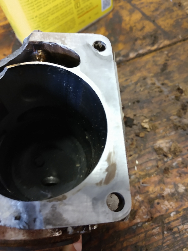

MS461 in for some repairs. Was ported by someone...I have no idea who but here is another example of what happens when you sand the cylinder base instead of cutting it on a lathe. Time to price out a new cylinder kit.
Nice wash pattern, too
It looks oblong? Like a crush. Or is that a camera illusion?
How do you tell that it was sanded and not machined?
It's pretty caked up also.
Wasn't crushed, just my *s-wordty phone. I can't get a great picture but it's clearly been sanded.

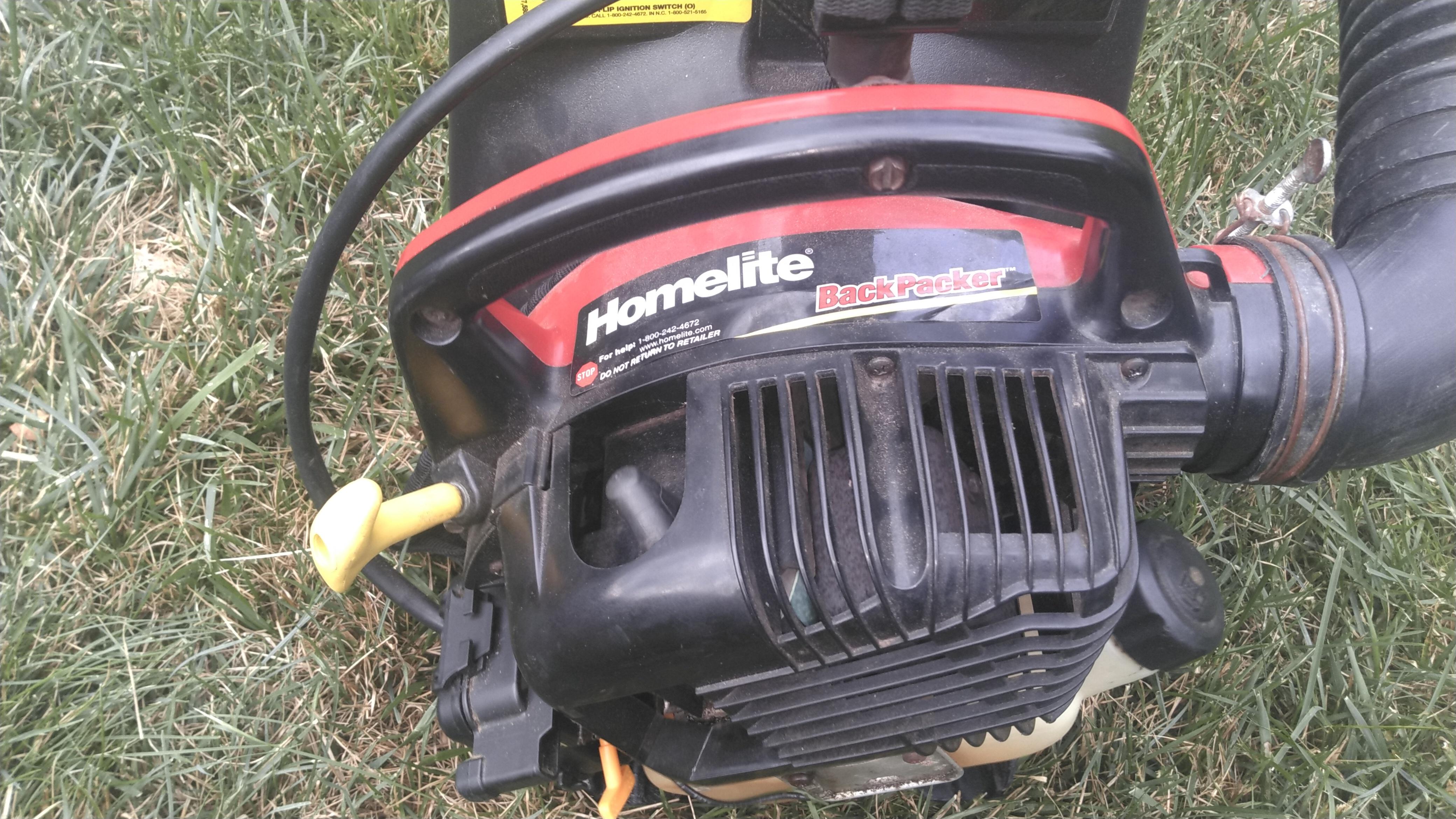

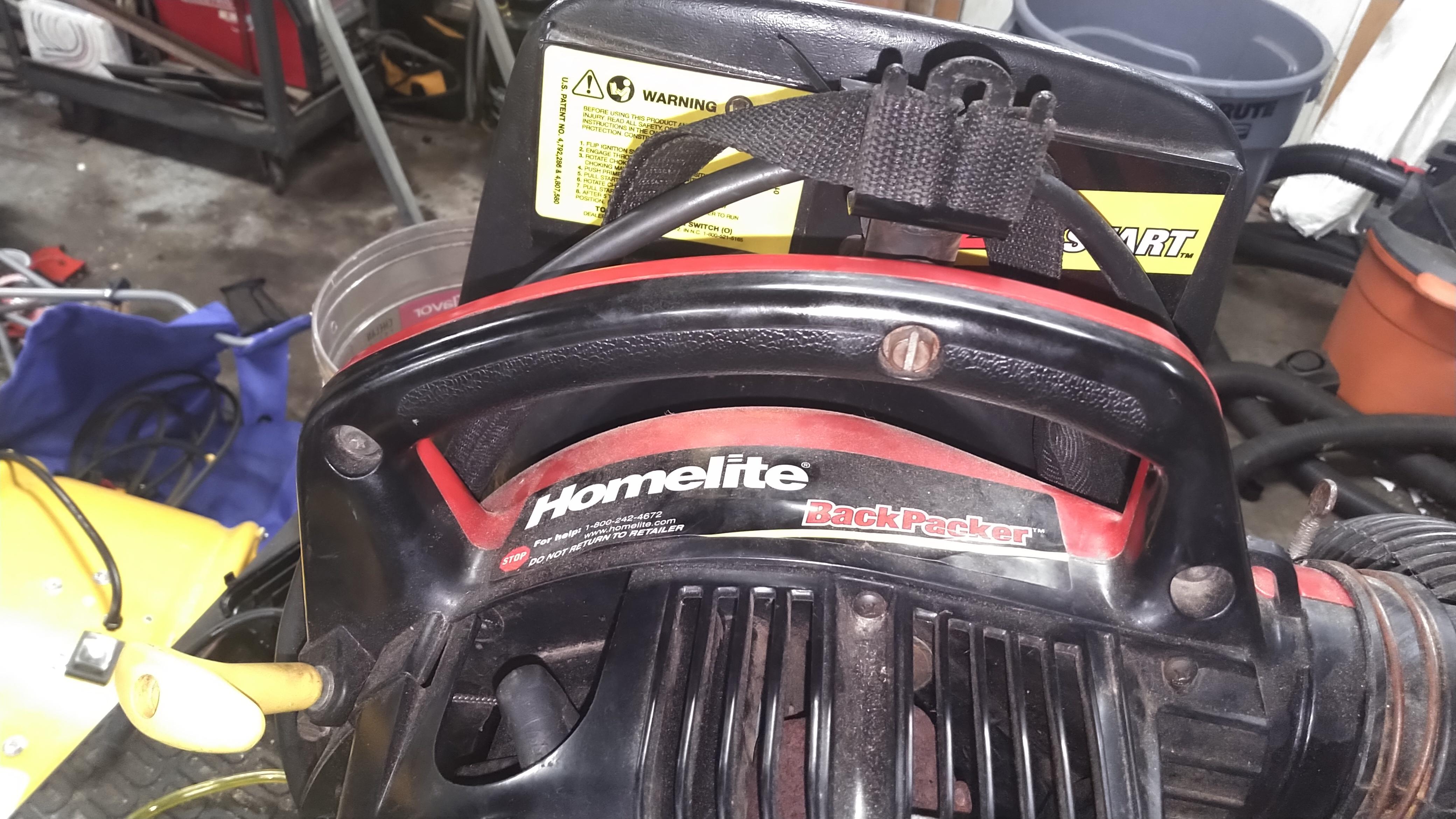

Finished test running the blower I did last night. Ran good. Tweaked carb as needed.

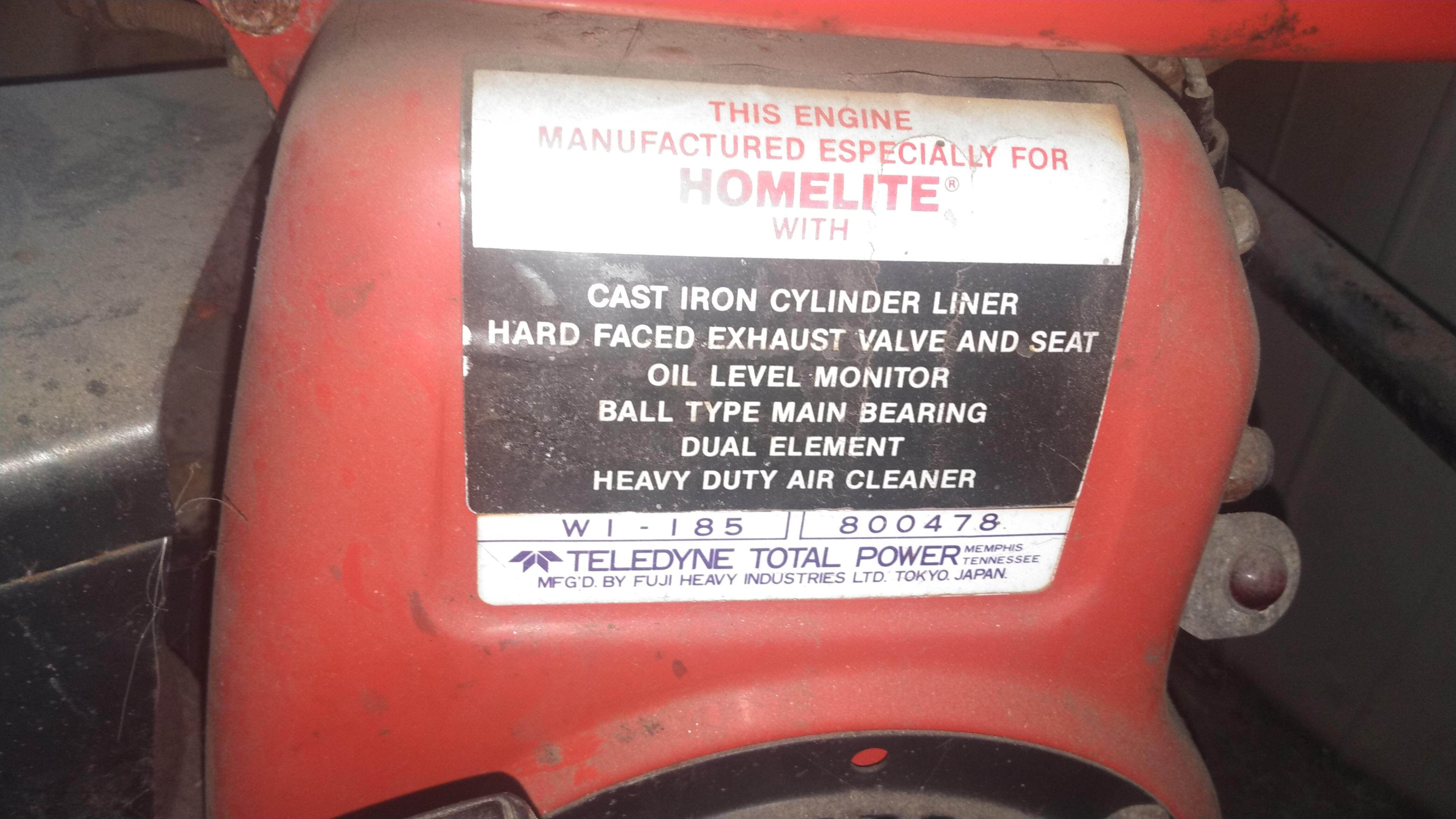

Up next is a Wisconsin Robin powered Homelite generator that needs fuel system help. Fuel smells rotten and I'd imagine that the carb needs cleaned or replaced.
So whoever ported it can cut a pop up piston but can’t cut a cylinder base. Nice:bash:
