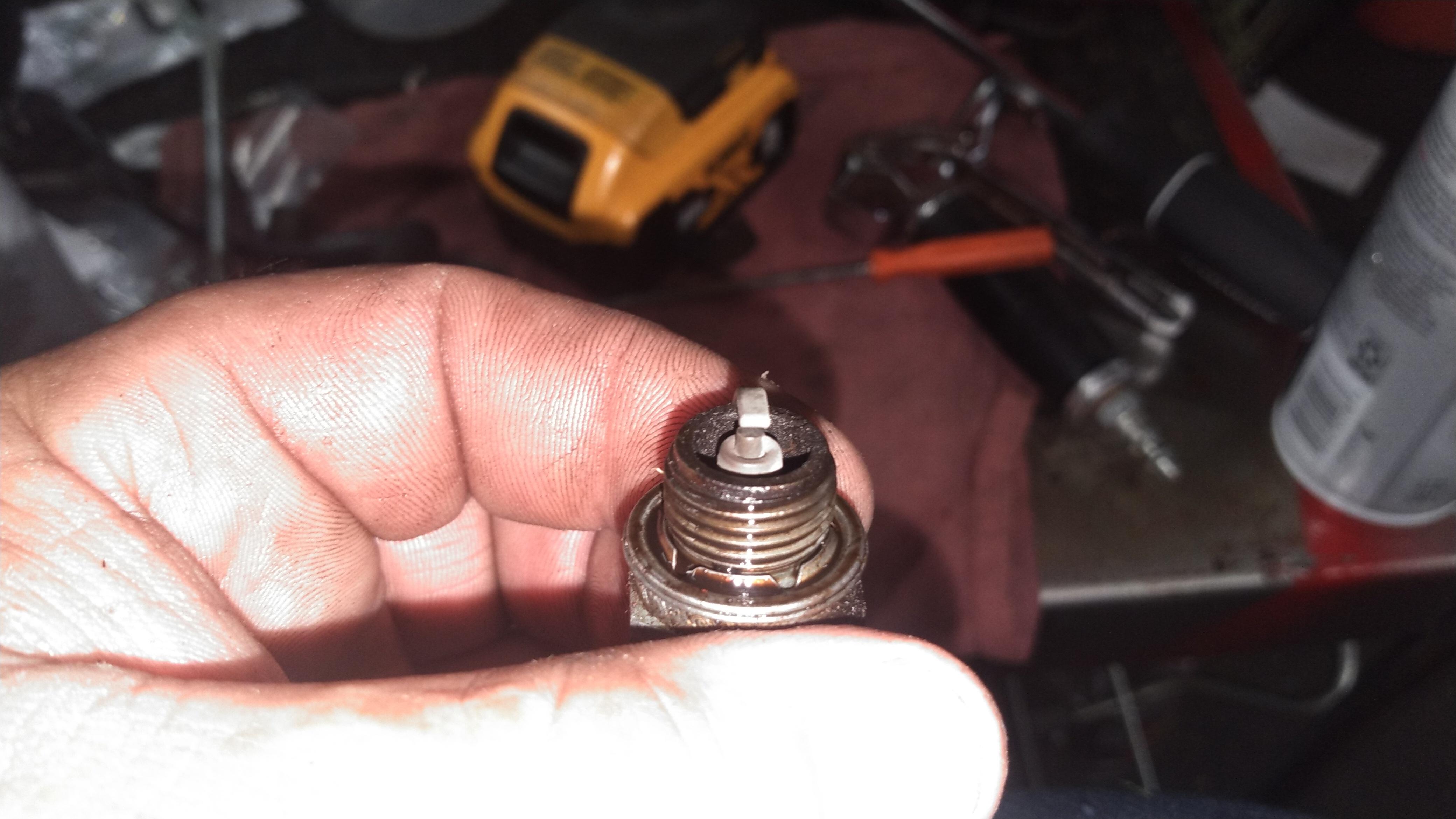

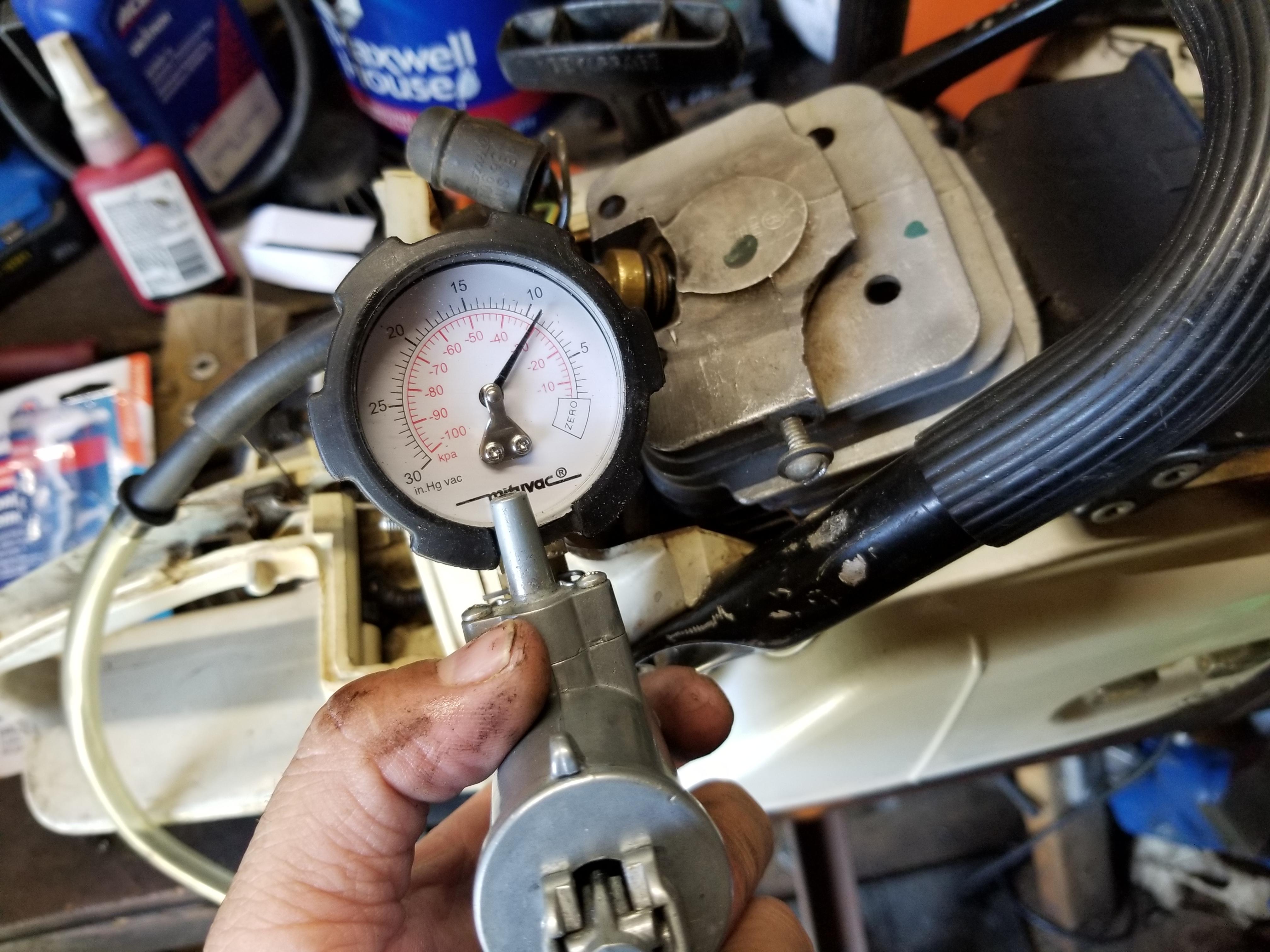

My 038 is on the bench for a check up. I noticed when i was done milling with it, it kinda stumbled when i turned it uprite after the cut but starting to think it must have been too rich. It held pressure and vac no problem. Will probly pull fuel line out and check it too before i run it next.

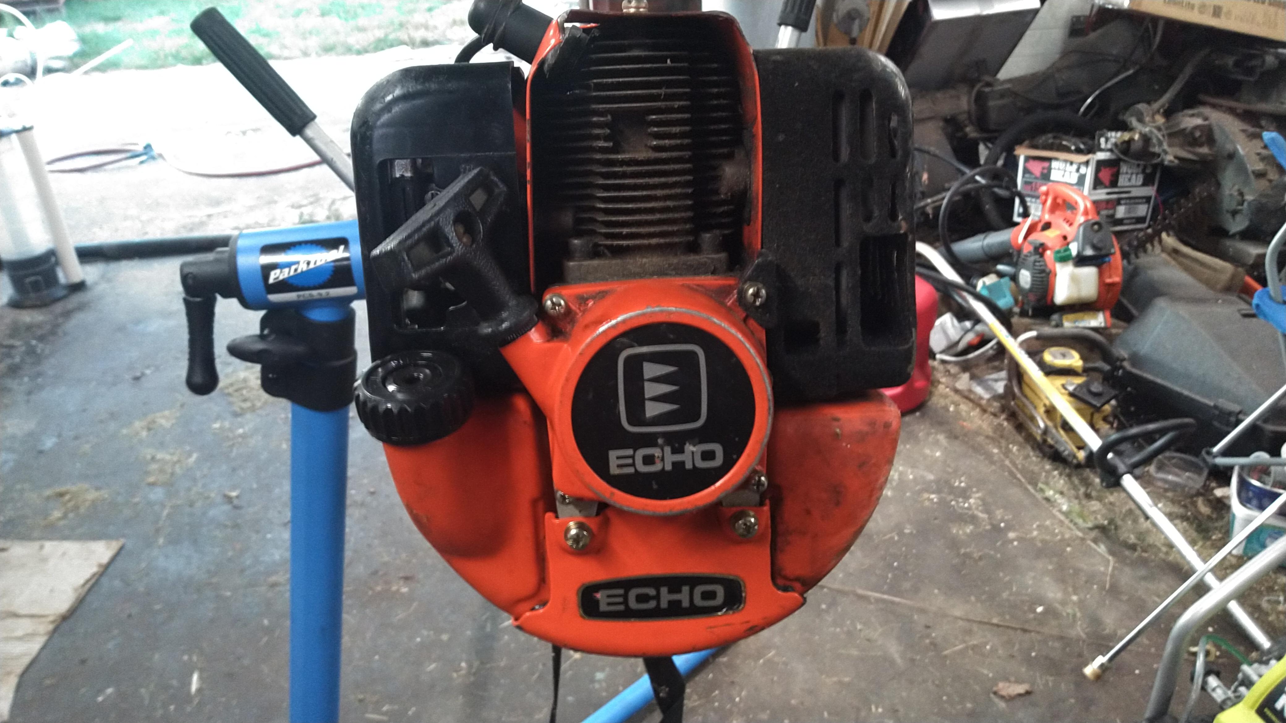

Echo SRM 300 AE brushcutter. Came in for repair. Ran ok at high speed wouldn't idle. Found low speed needle fully seated. Reset both to 1 turn and adjusted as needed. Set idle speed as needed. Gonna do some brushcutting with it to see how it does under load tomorrow. Will probably end up tossing a plug and fuel filter in it as well.

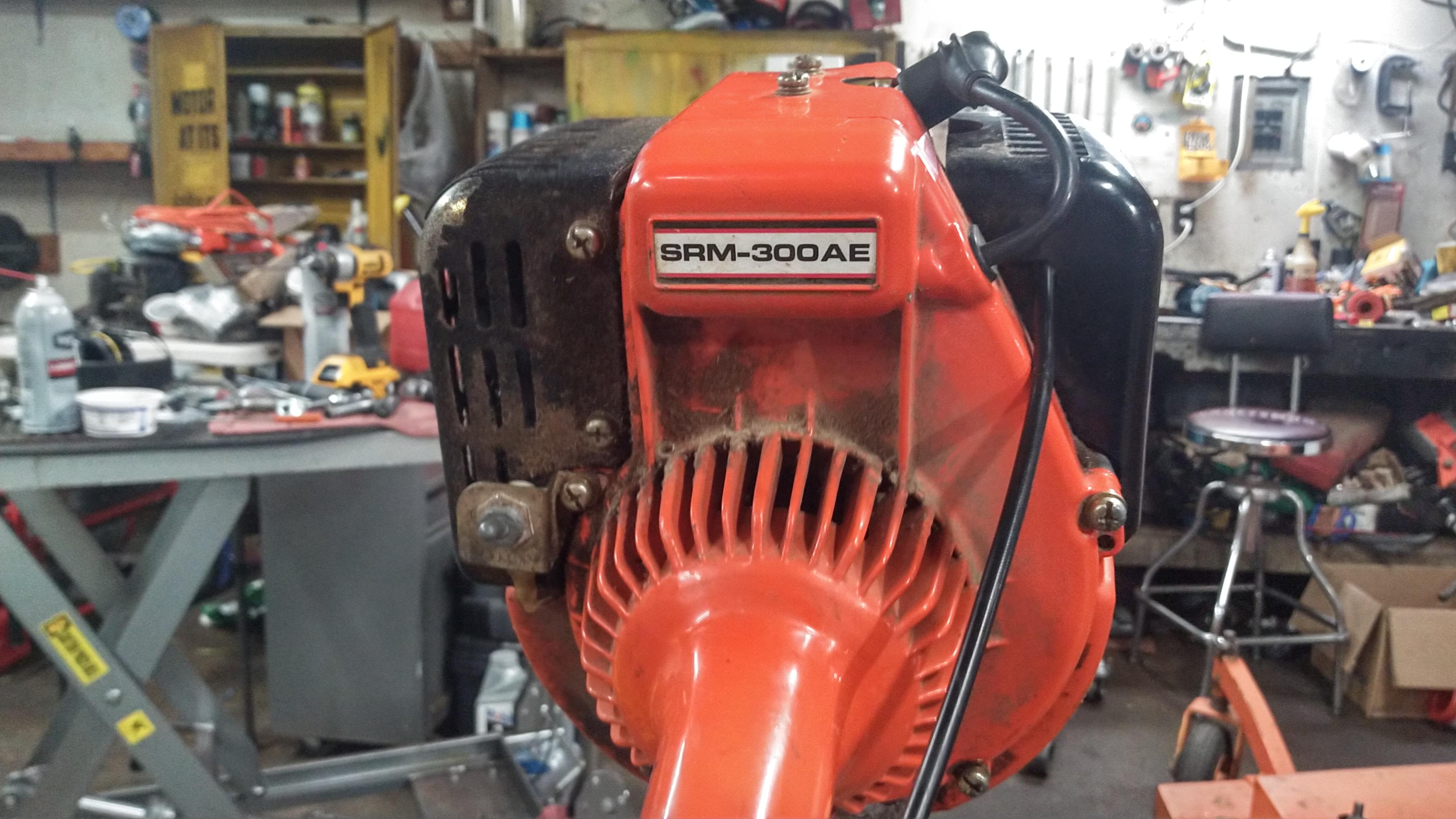

Echo SRM 300 AE complete. New CJ8 plug, new fuel line and fuel filter serviced. Did some brushcutting with it and tweaked carb as needed. Did some research and it's 30.8 cc and was made 1983-85.
