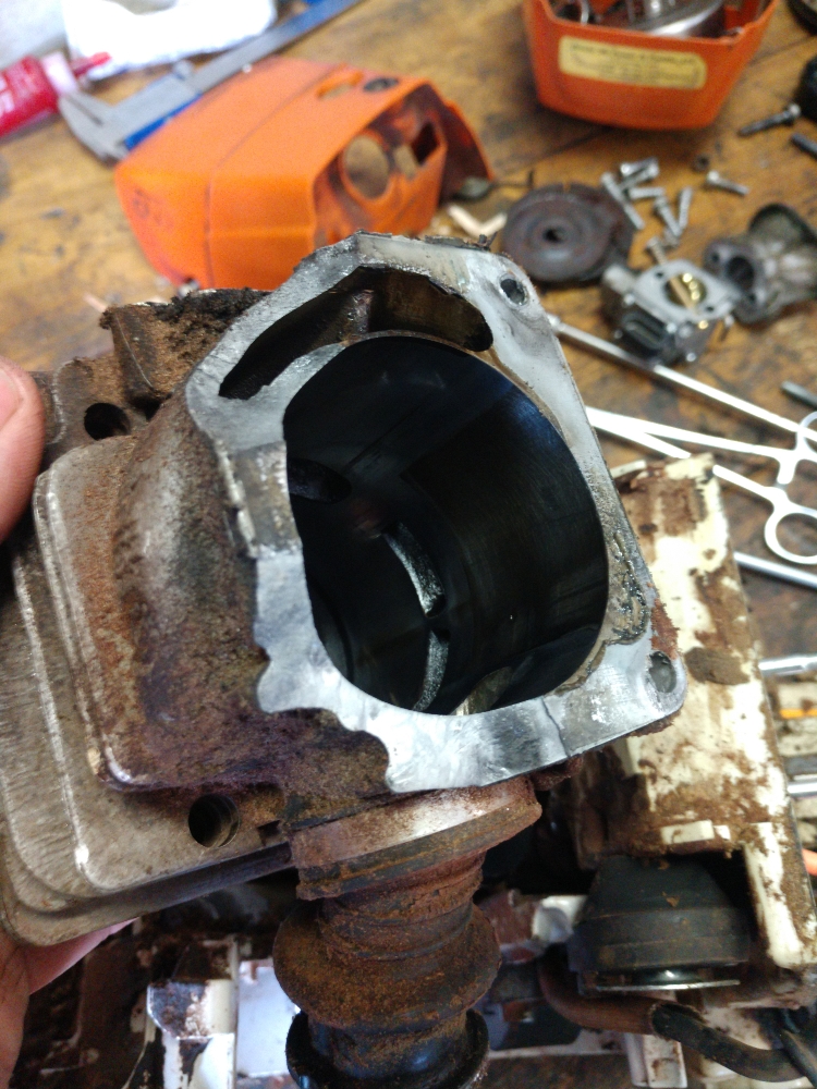

MS461 in for some repairs. Was ported by someone...I have no idea who but here is another example of what happens when you sand the cylinder base instead of cutting it on a lathe. Time to price out a new cylinder kit.
WTF??

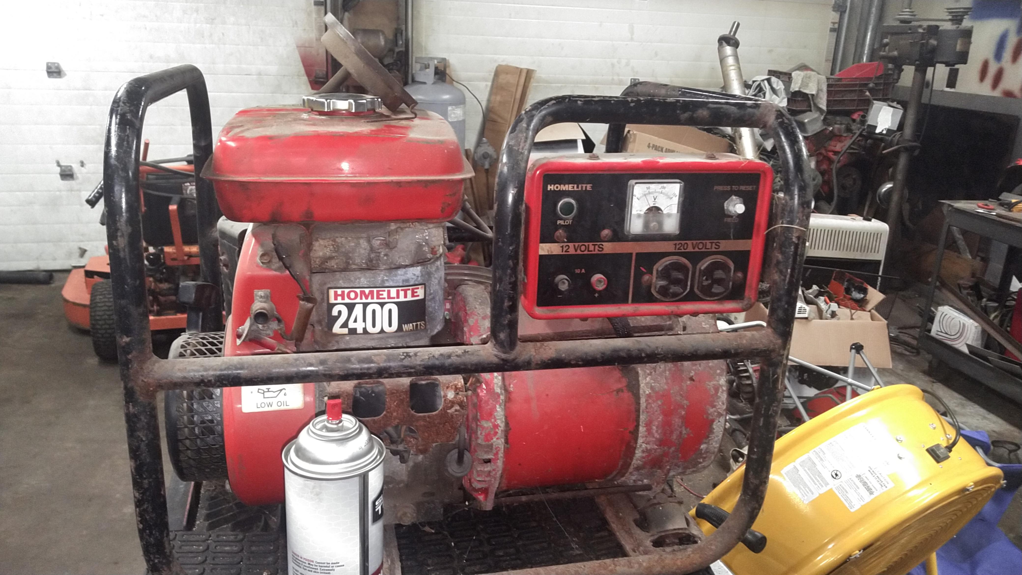

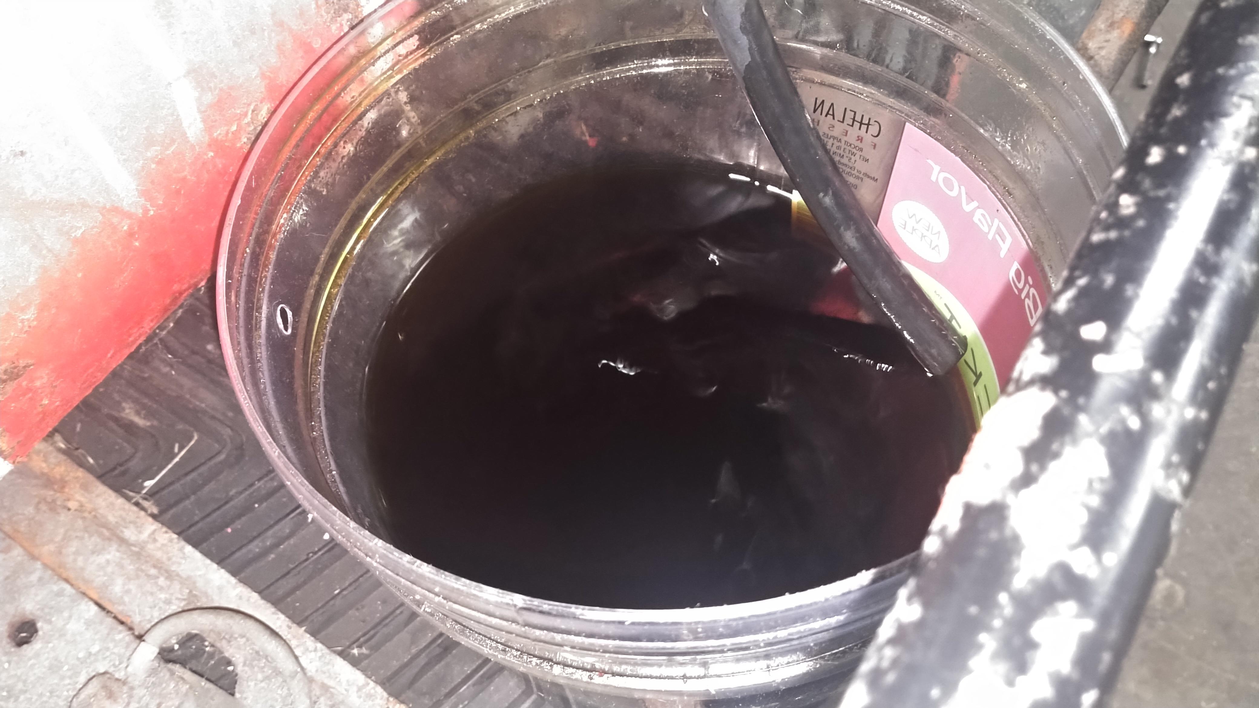

Got started on this little generator last night. Popped on a prime shot but wanted to run away. Pulled carb off and found both sticky throttle shaft and governor linkage. After an hour in the ultrasonic cleaner the throttle shaft moves like new again and some oil on the governor linkage had it working like new again as well. Drained fuel tank and it looked like he was making furniture stain in the fuel tank. Ordered a carb repair kit and I'll clean/flush the tank.

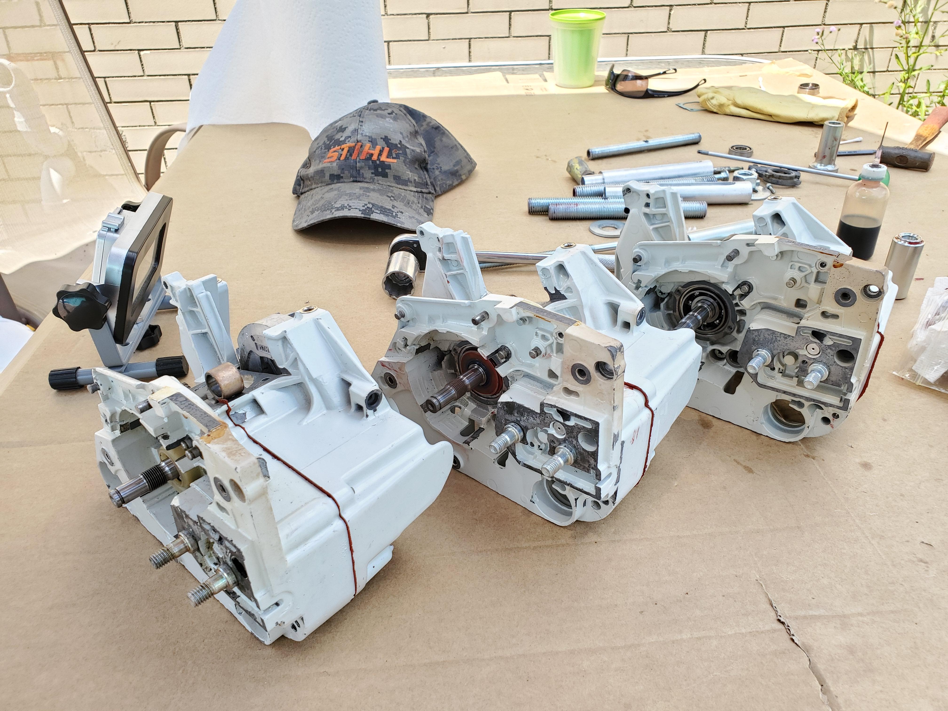

Resolved to put rings inside and new paint on the outside. This the first saw I’ve seen that requires you to split the crankcase in order to remove the cylinder. From what I can tell it comes apart as three pieces. The case halves and the crank/piston/cylinder assembly. I could use an idea on removing the cam from the crank. I thought I’d push the seal in and get under it with some 2-jawed pullers. Would love to save the seal though. 00AD095C-0D4C-48B4-A6CA-E0B4F4EC0460.jpegBFC4EE8C-967F-48C4-9279-512A5850A172.jpegE22754EF-9FD1-479D-8864-3A54FD1DDA05.jpeg
