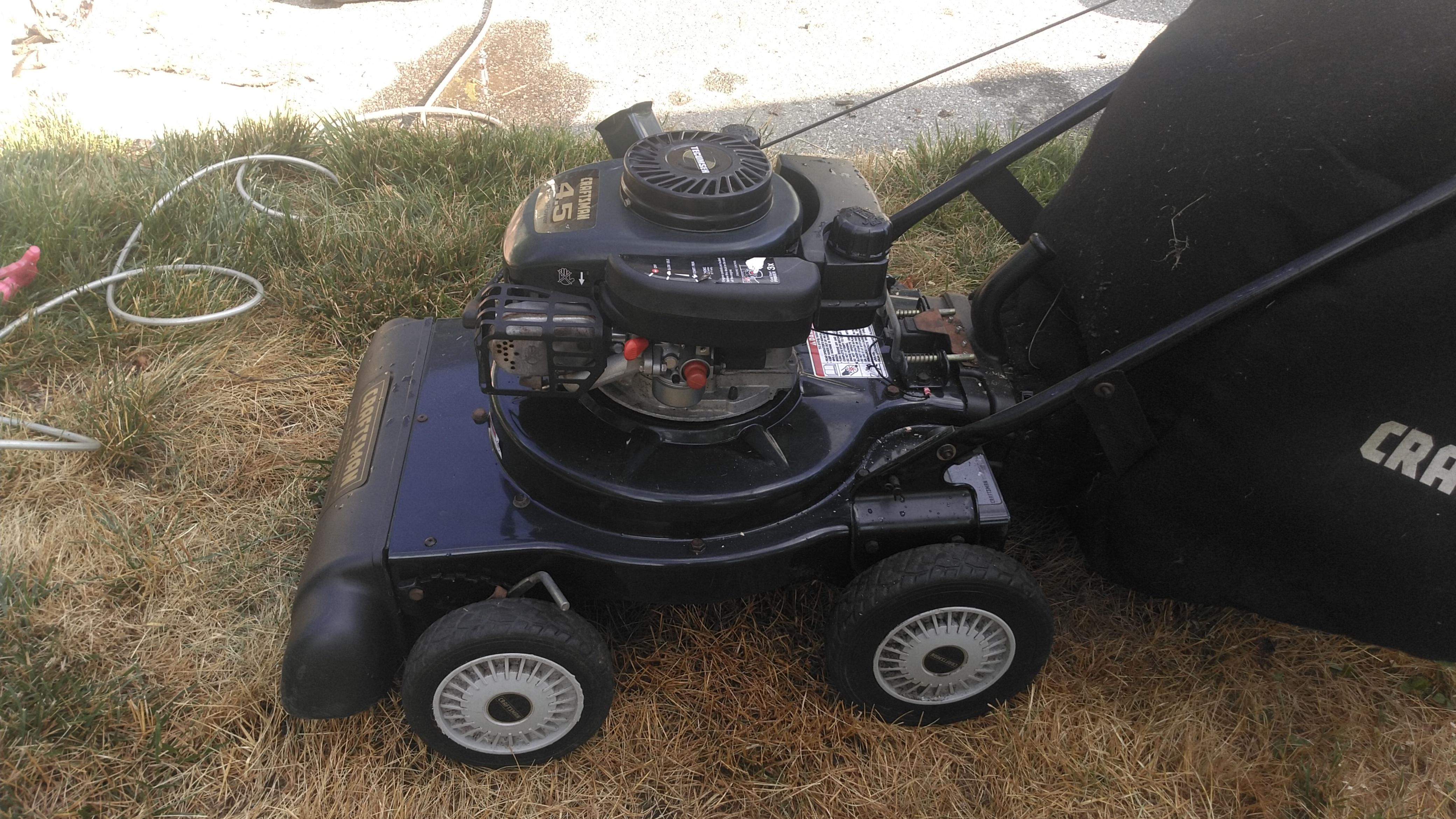

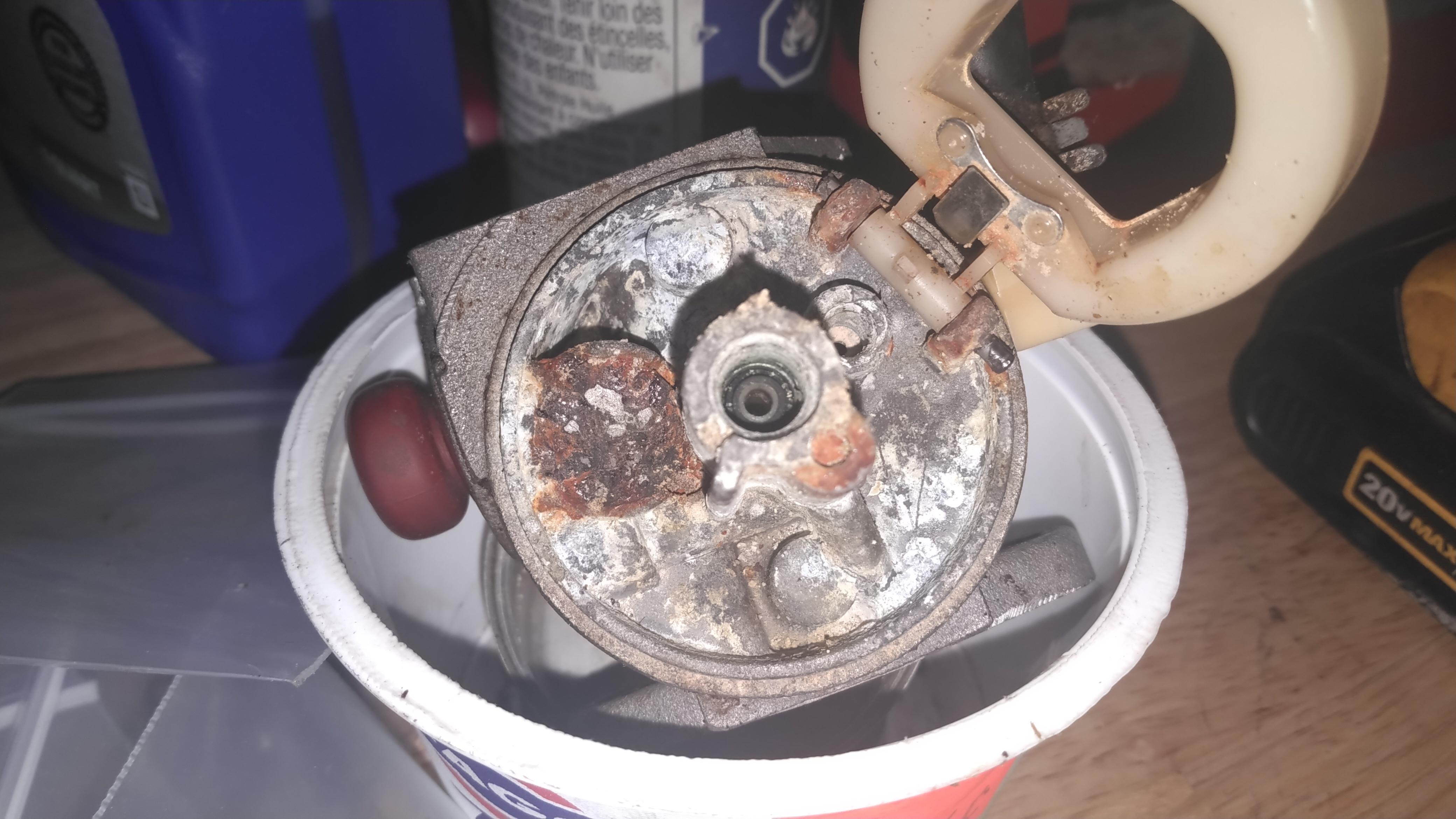

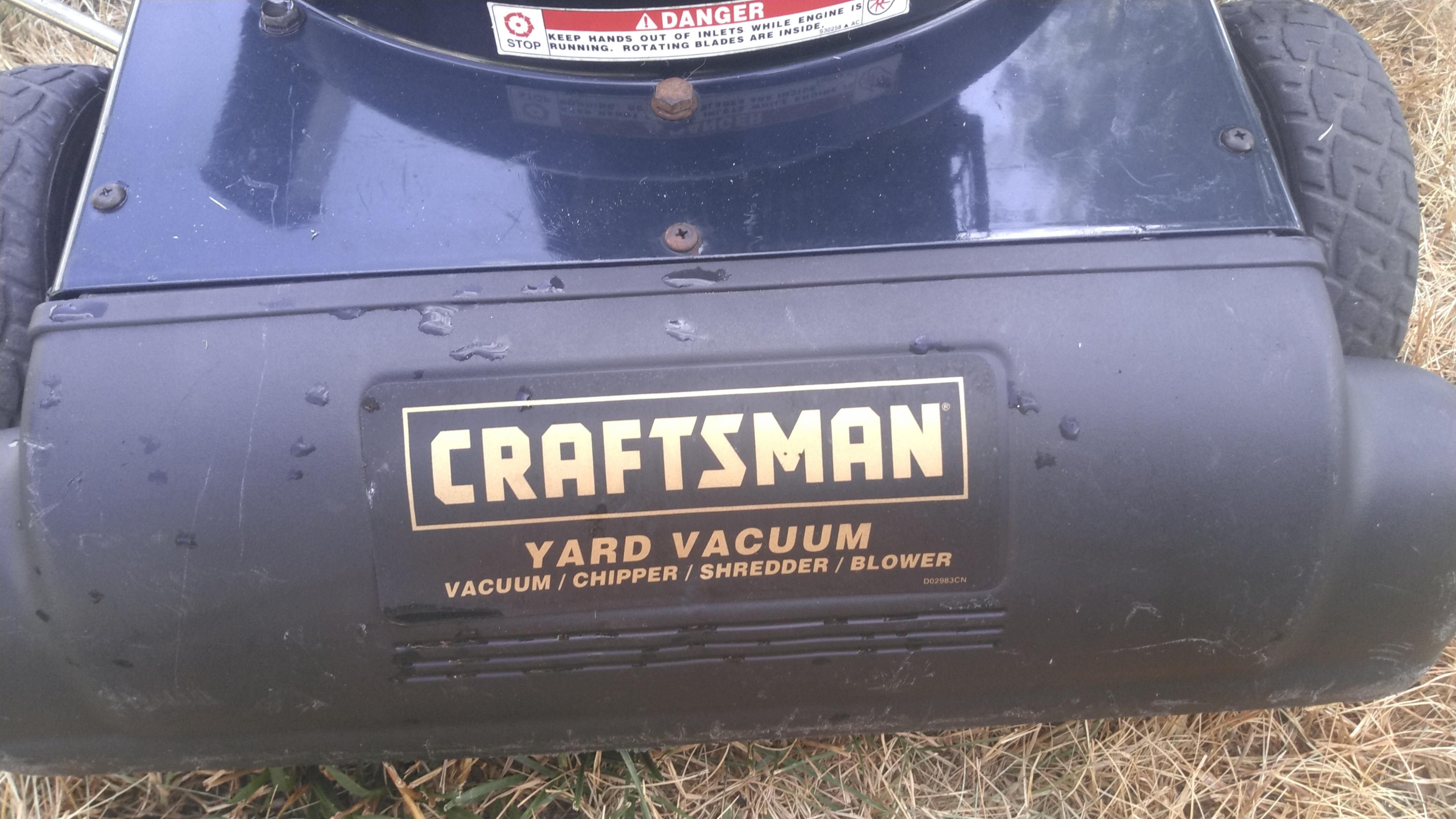

Finished up this Craftsman yard vacuum. Originally came in for a no start. Had no compression due to stuck open intake valve, had no spark due to kill wire grounding out on blower shroud. Had badly corroded carb as well.
Freed up valve, bead blasted head, reassembled with new gasket. Put heat shrink on kill wire that was grounding out. Installed new carb. Runs nicely. Tested this evening after work. Pressure washed, changed oil and plug.

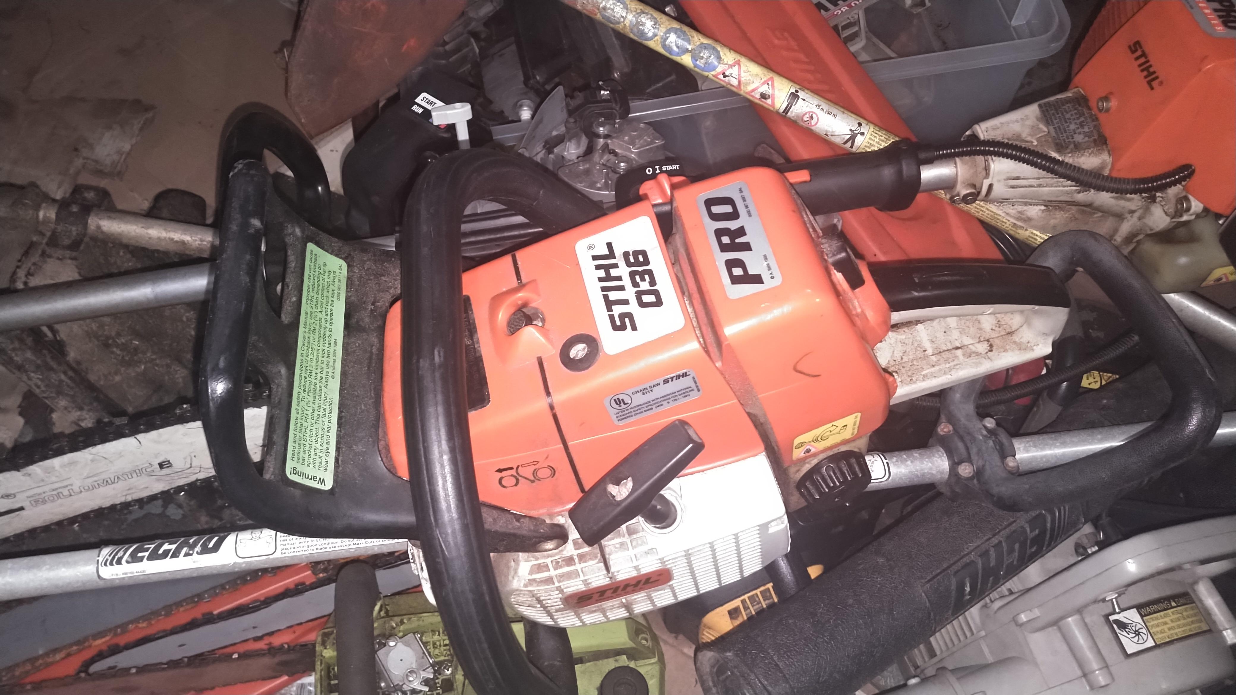

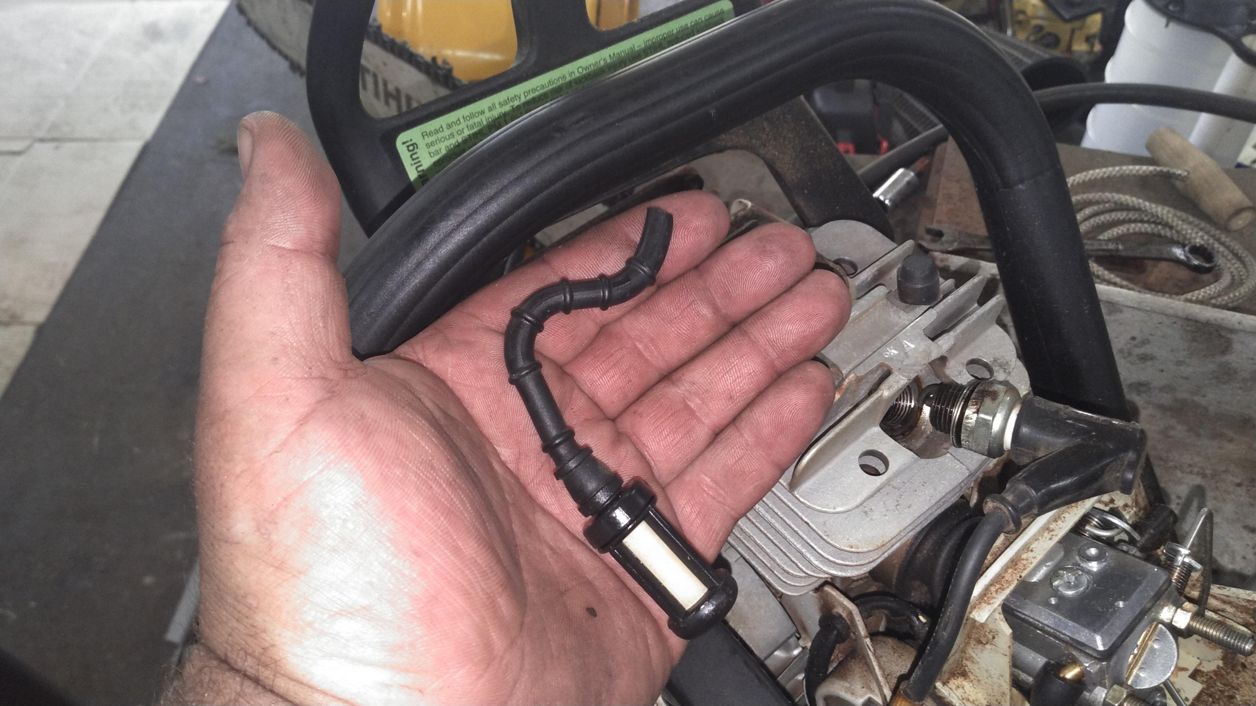

036 Pro that was dropped off for a hard starting concern..I don't think that the fuel line should be rock hard. Broke off in my hand trying to get filter out of tank. Getting impulse hose as well.
FS85 wouldn't prime, have a carb on the way.
Echo hasn't run in a while, have a carb kit on the way.

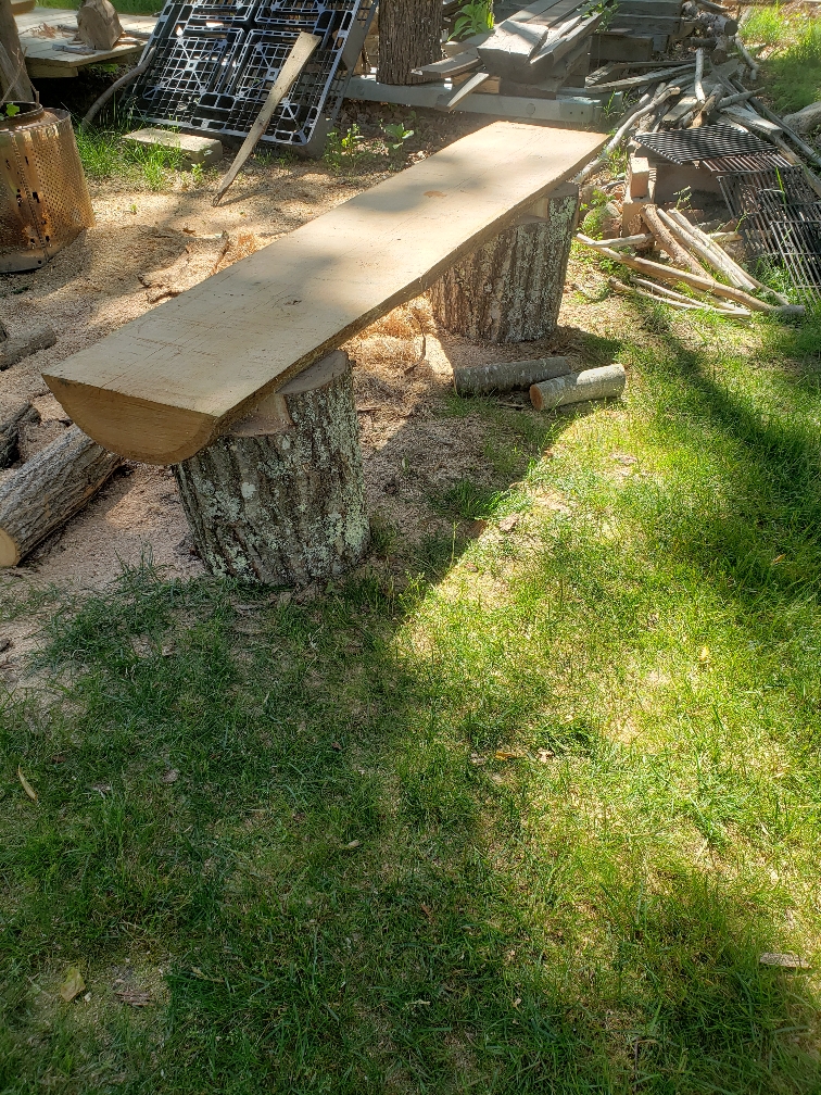

My other Daughter visited on Father's day, and now she wants a bench too, so I'm working on this Hickory one and it is kicking my A$$!
It has very unique live edge, which I'm trying to preserve, and sanding Hickory by hand is an exercise in frustration, even with 60 grit paper!

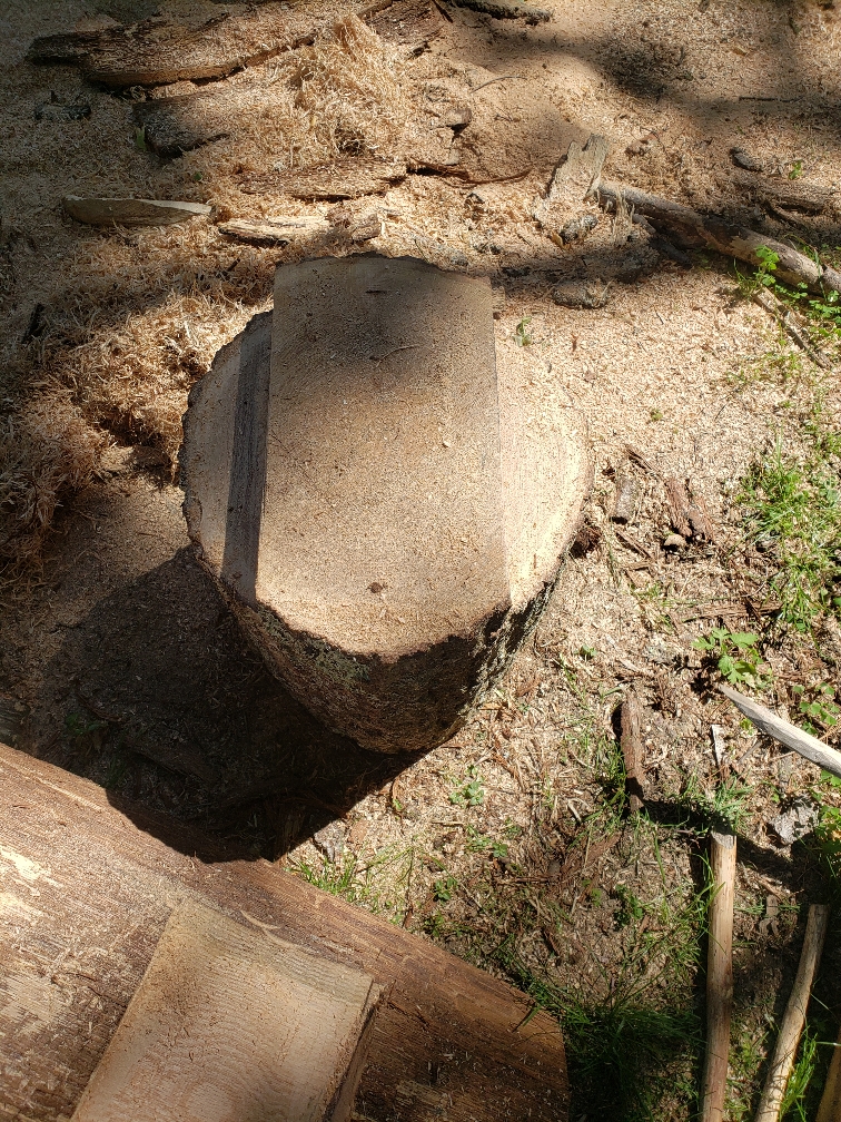

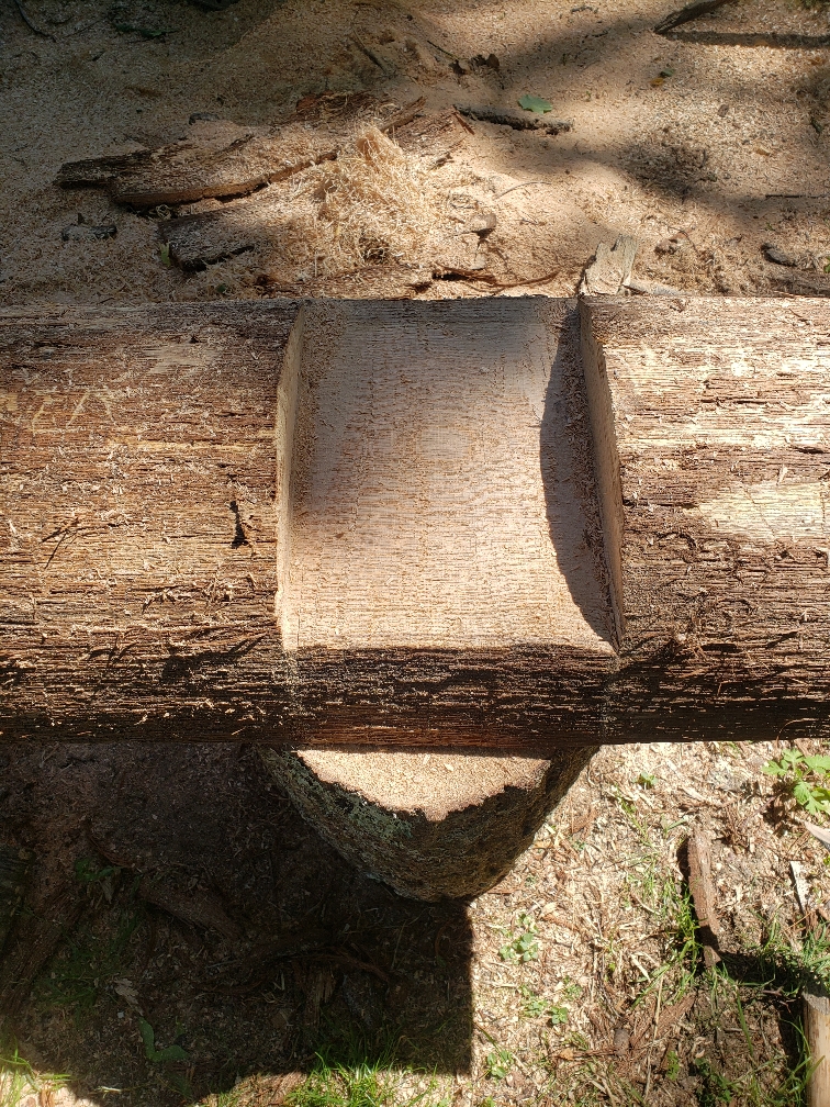

Since others have asked before, this is how I do a half round leg on a flat bench. (the bench is up side down in the pics).
