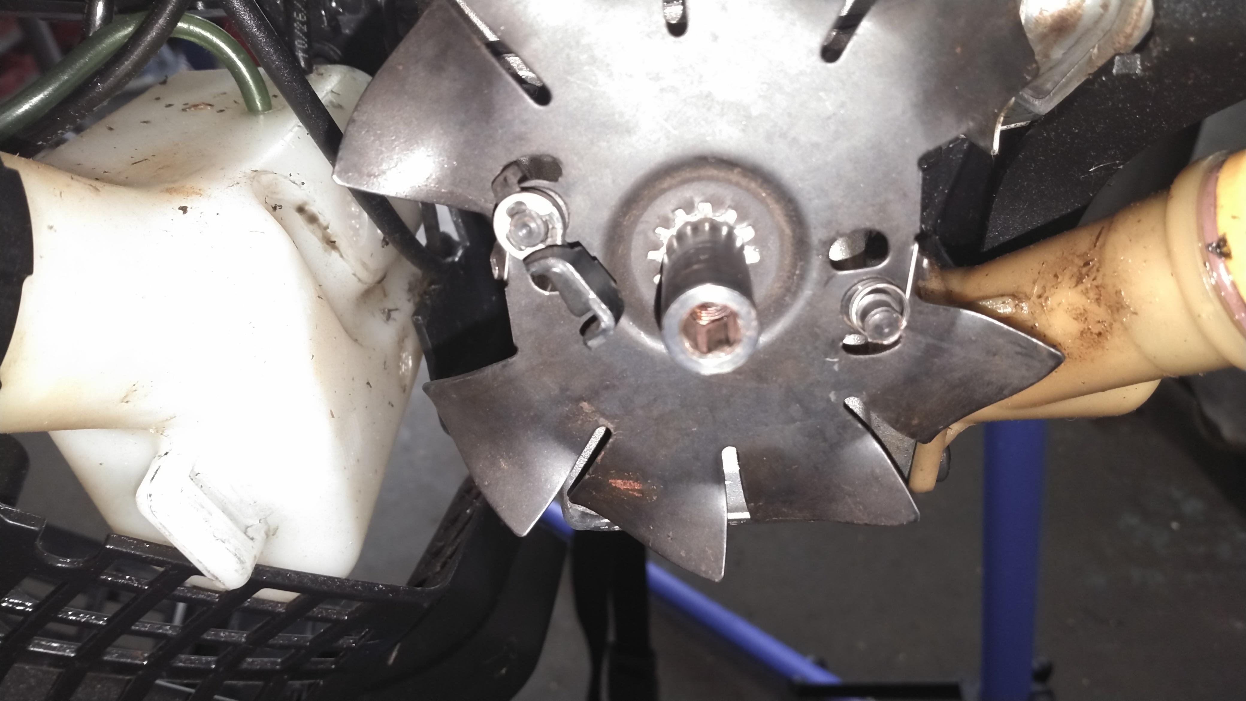

Got this skilsaw 1631 a little more back together. Here my progress so far and a little mock up
