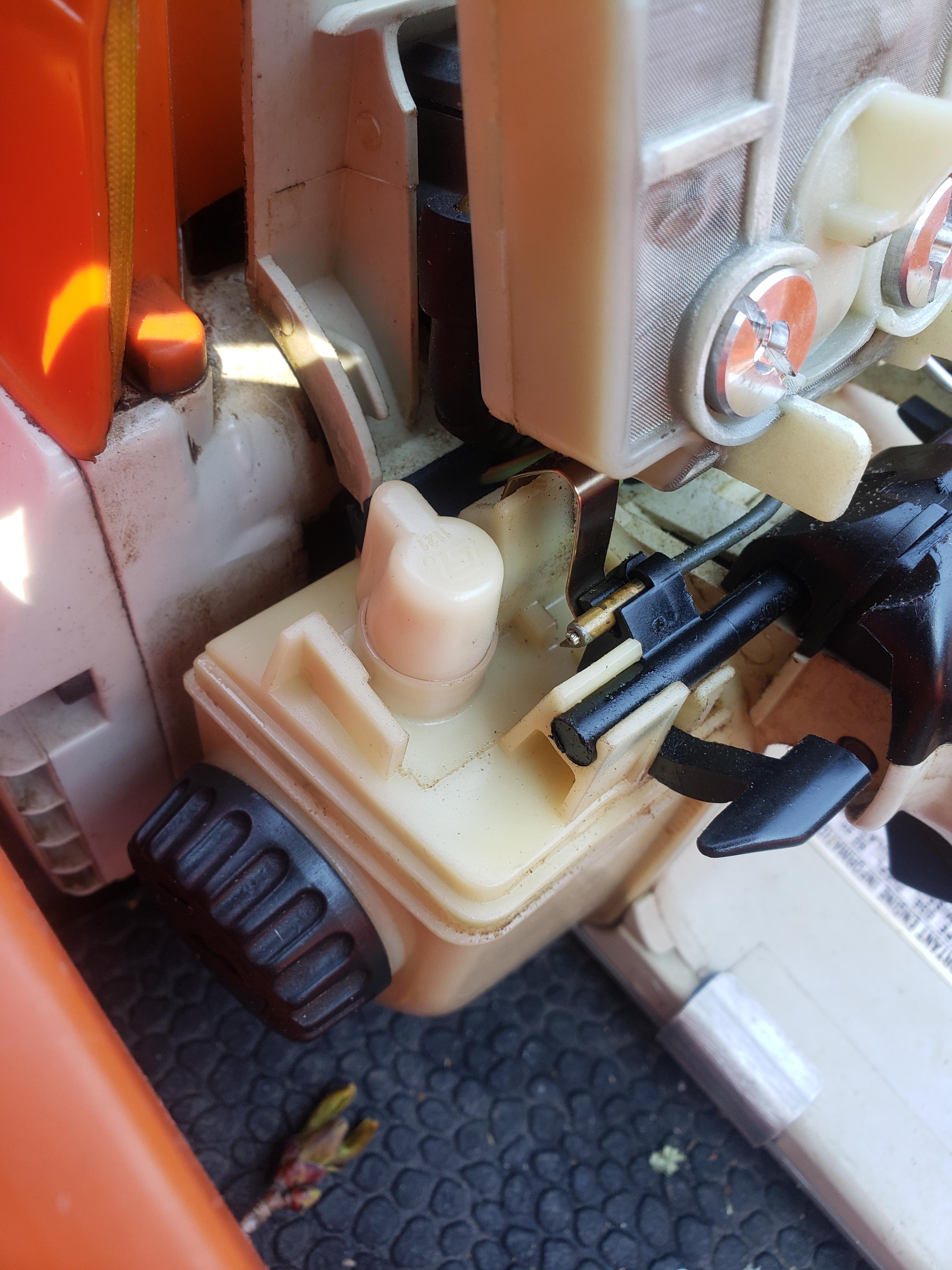

Gave the ms280 a hit with Rip Off cleaned up good.
It's definitely a different saw design I wouldn't call it hard to work on just a couple different steps than the norm now I've work it out it will be a breeze to put back together. Not sure if it's been apart before the sealant looks dodgy to me.
Bit more cleaning to do on the main case and cylinder and I can see what I have on my hands and go from there.
