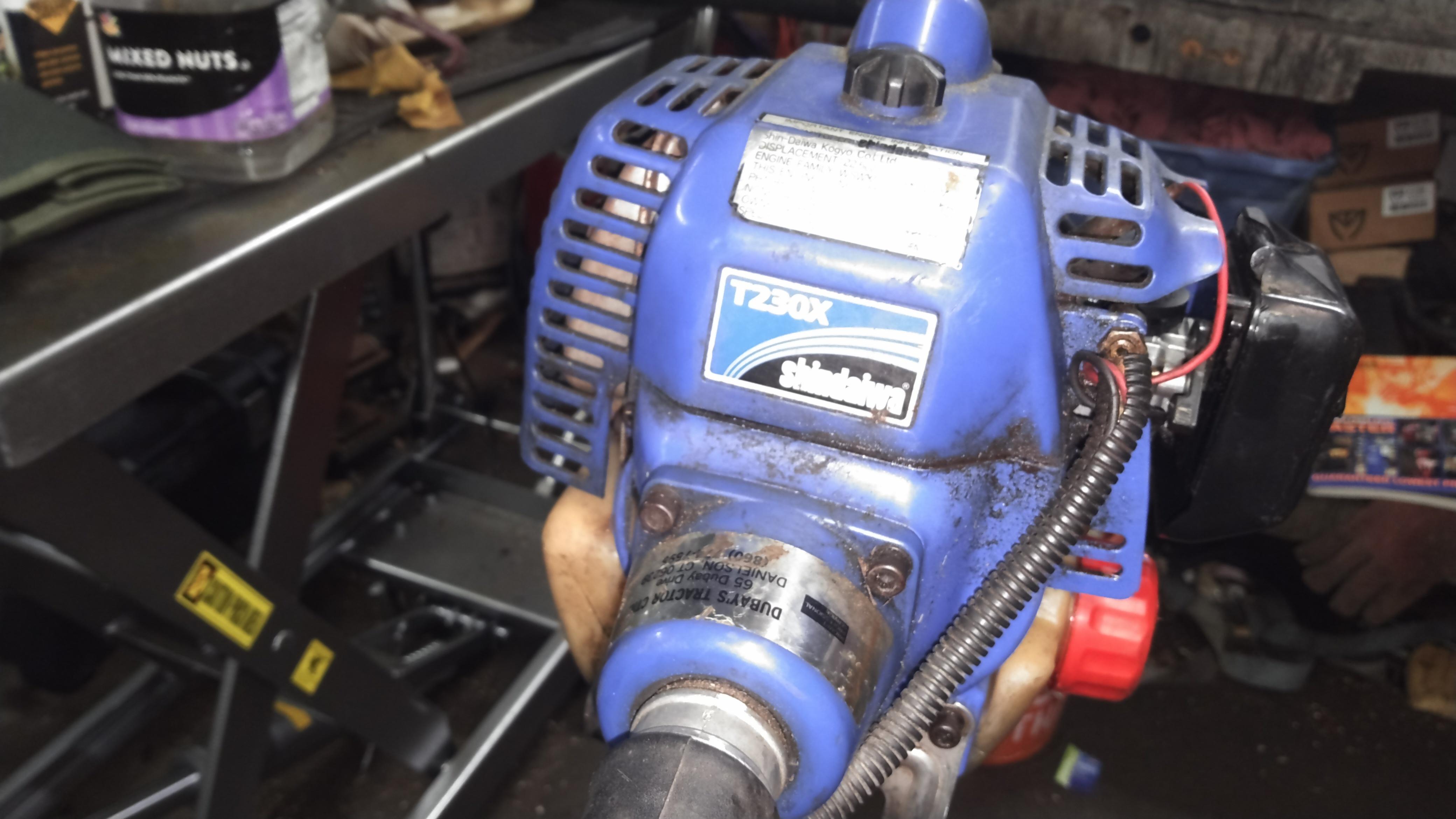

Shindaiwa brushcutter got a new carb, fuel lines, fuel and air filters. Runs excellent just need to wash it.

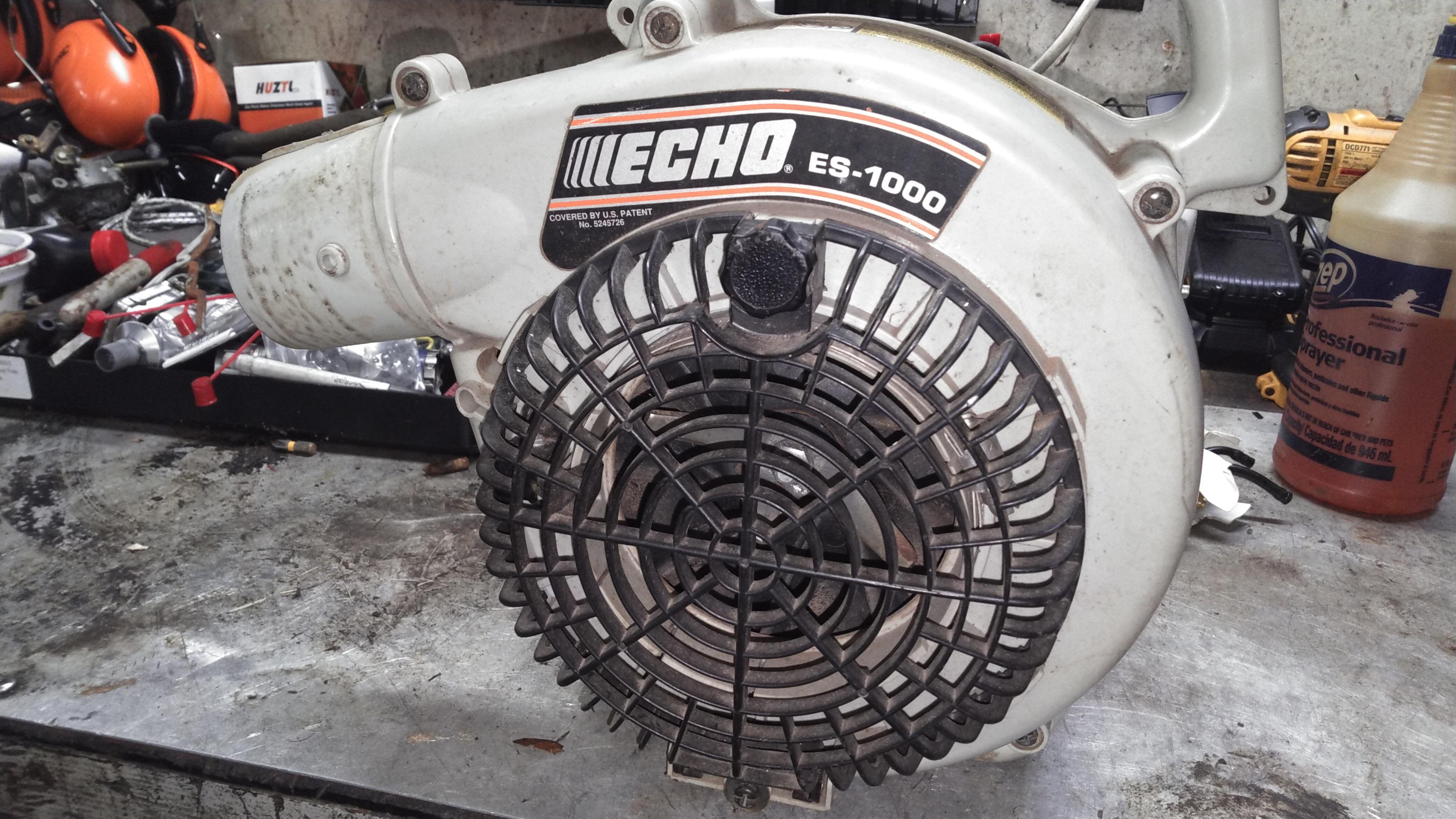

Echo blower got checked out however customer decided to just buy a new one. He gave it to me. I'm going to fix and sell it. Just needs carb kit, purge bulb and fuel lines.

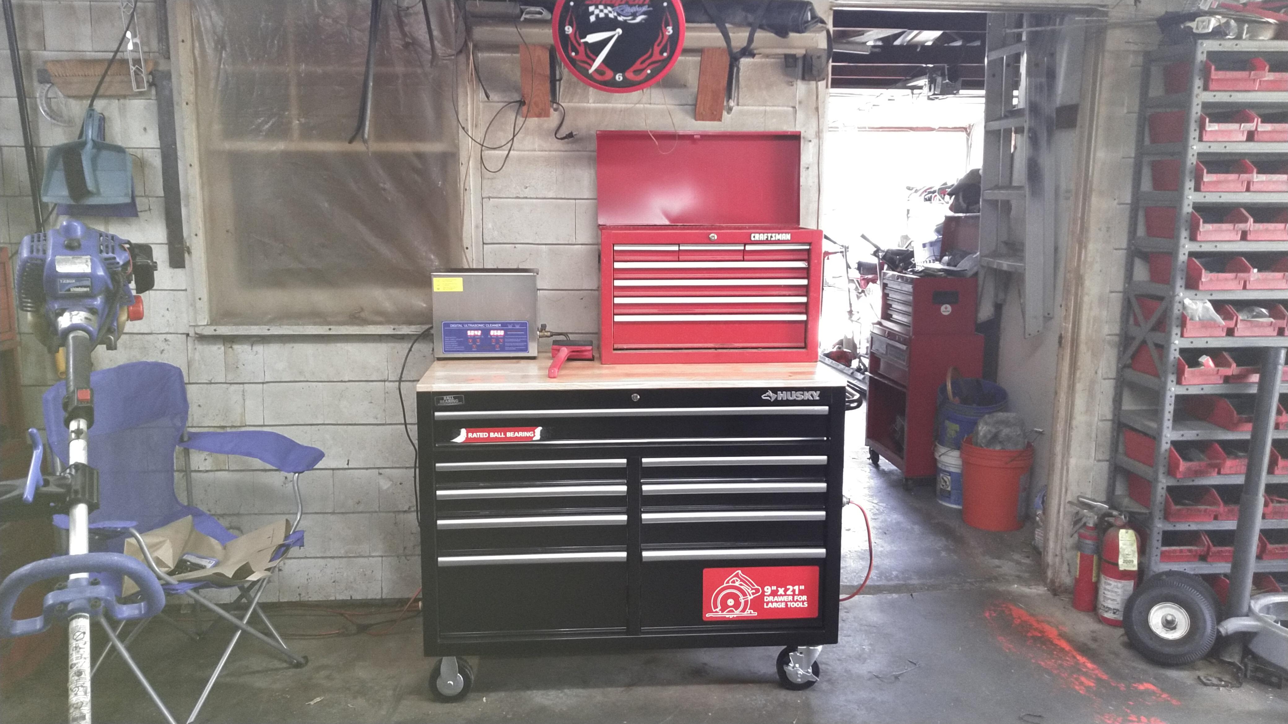

Dug out the Craftsman box and put it on top of my new box. Will most likely be used for parts storage.
