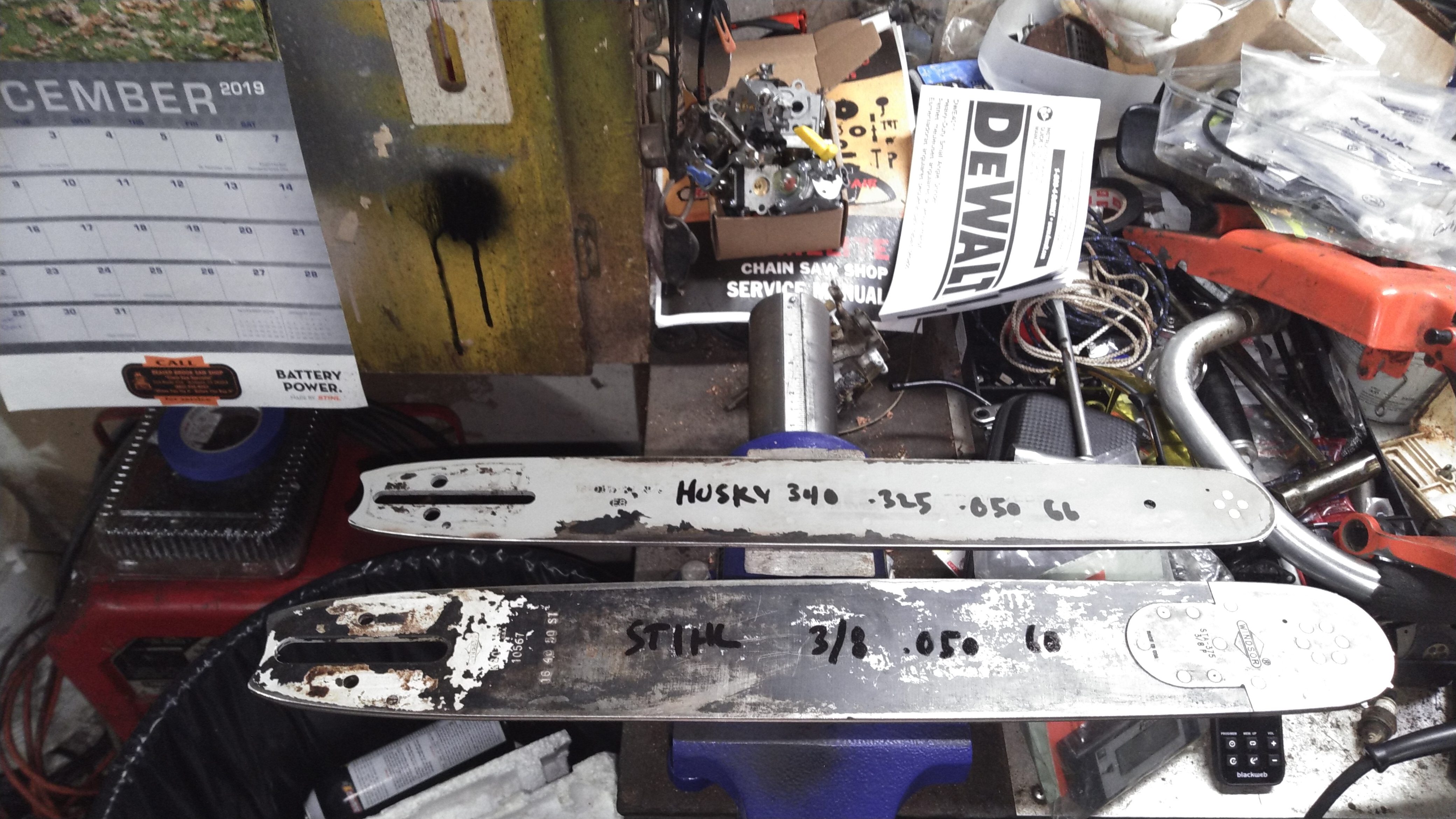

@PhilbertI'm no expert..
Sanded this down to 220. It had deep grinding marks so I didn't go far enough to remove them all.
Not sure why it got spotty, never did before. But after sanding, I used acetone to clean it, then just wipe of the liquid and let it sit for a minute, then wipe with a water soaked rag to stop the process. You can do it multiple times for darker color.
I like how the blueing didn’t color the aluminum plugs.
oh, and sweet music in the background.
Maybe a bit of oil still hiding out in those tiny holes?
Looks great to me, Jason

Thanks for posting that.
Can you leave it on longer instead of doing multiple coats?
I have painted bars, but never blued or lacquered any.
Philbert
Yep. A topcoat of clear can be applied to protect the finish. And slight warming the metal helps darken the color. I didn’t this time because I wanted the different shades. These two bars I did warm a bit.
This one has about 3 years use. I’ve never seen any rust form. But if you want it to last longer with hard use, may want that additional layer of protection.
