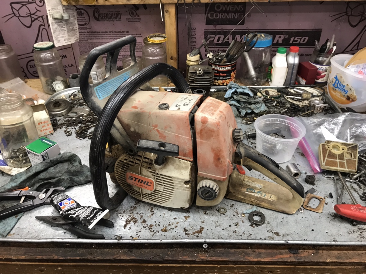

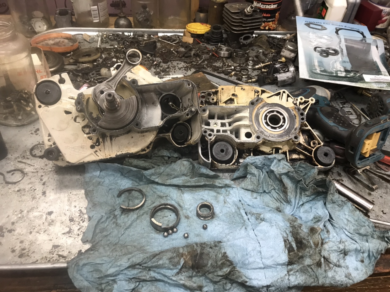

Ugly Betty 034 build. Closed port 034 jug with meteor piston and new seals and lines. It’s turning out ok so far. Sounds pretty mean when I fired it up last night. Lots of flex in the AV so probably have to swap those out fresh. Put an original 034 muffler can on it with MM.
Shifted it to the side for its bigger, uglier cousin the 064... be a while since I’ve been in one...
New Japanese bearings on both sides with new seals... and then halted by my own forgetfulness... regular 066/660 crank case gasket to big... [emoji2959]
Flywheel side seal might be too big too, if you ordered them all for a 660
