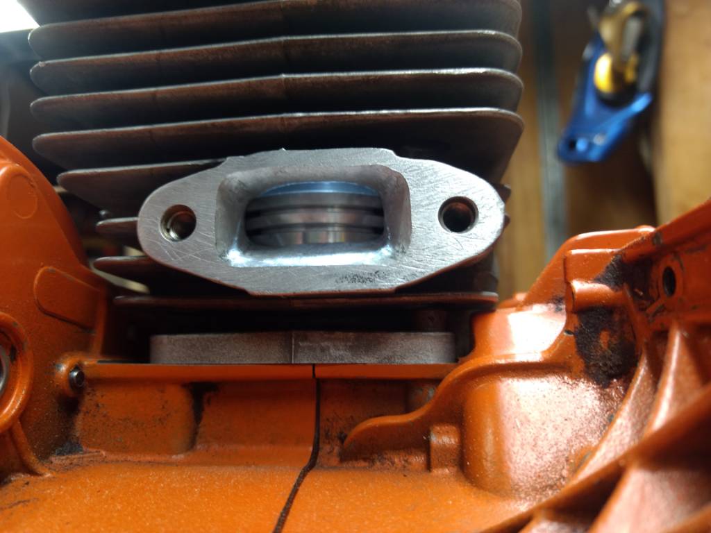

Put a spinny thingy in here for a bit.
Still a bit too flat.
Exhaust should be right at 98° when curved a bit more.
How much blow down do you guys like on these for a work saw 24-28" (arm and blade)?
Intake at 79°
Hooskie is a bit proud of their oil pump and drive!
P.S. it's a 385
