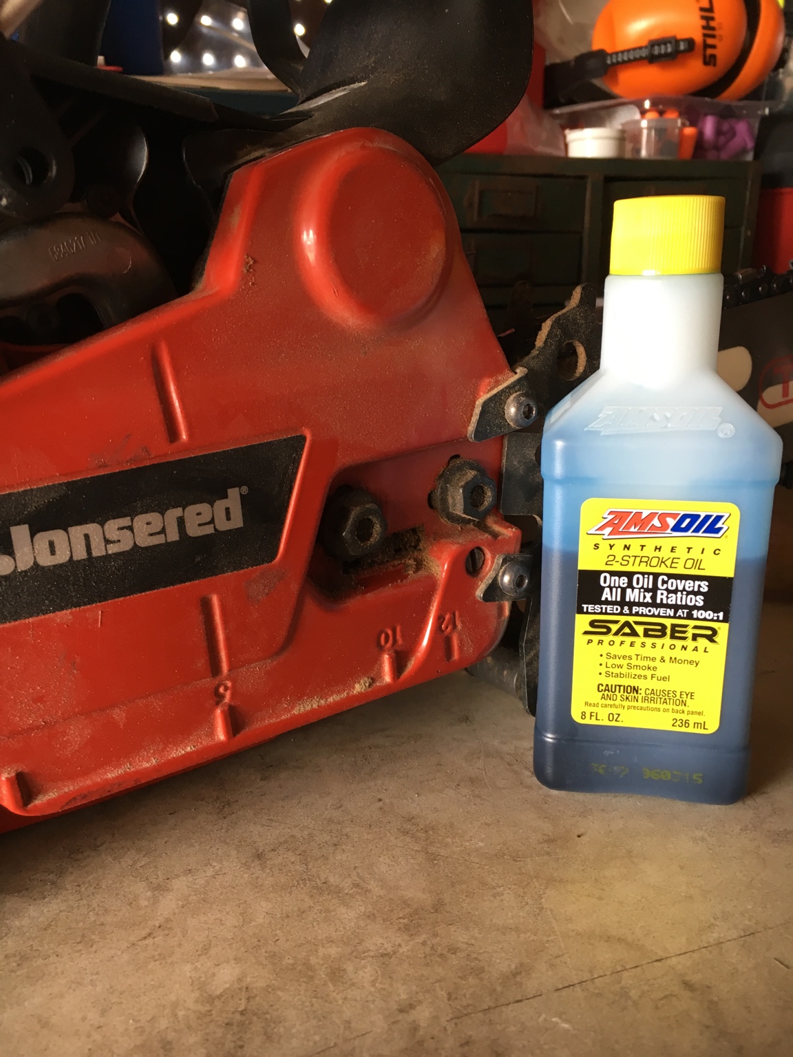

FTW??

Didn't you just get rid of a bunch of that stuff? Lol
Yeah i sent about 6 3.5oz bottles to MustangMike but decided to try it based on what Brian said about it. The stuff I sent to Mike was older didn't have stabilized in it I don't think but not that that really matters.
