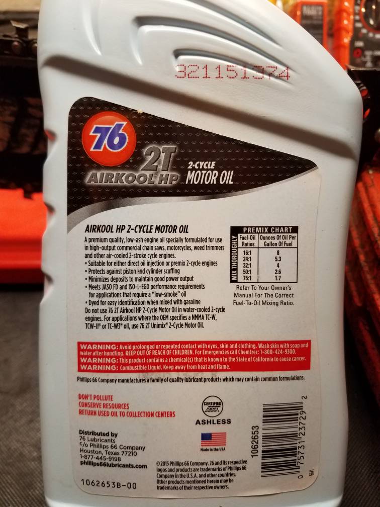

I bought a case of the oil and have used up about half of it, so far so good.
What do you guys think of it?
http://lubeoil.com/wp-content/uploads/2012/11/Airkool-HP-2-Cycle.pdf
@bwalker @CR888

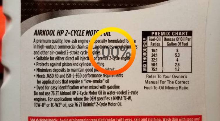

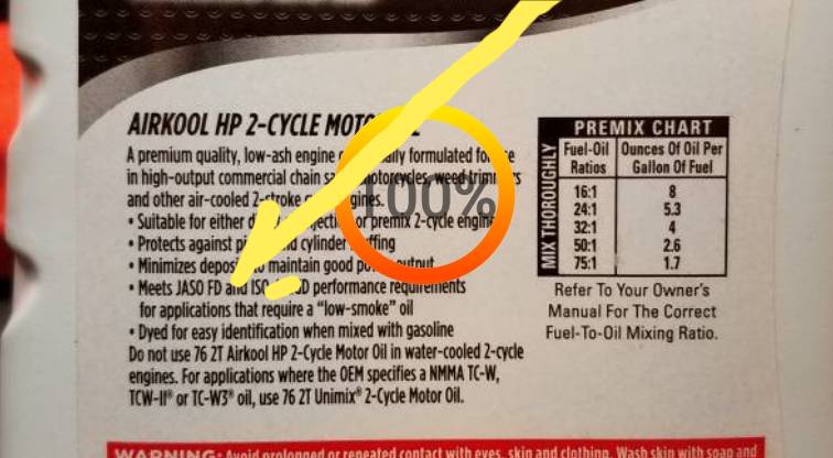

Says Jaso-FD rated right on the back panel. Unless I am going cuckoo?
No, it says "Meets JASO FD", which is not the same as receiving an FD rating from JASO. They haven't paid for the testing, so they can't put the little logo on their bottle.

It's not FD rated and is in fact a NMMA certified boat oil. It also says to use where OEM specifies a TCW3 marine oil. No OPE OEM does this currently. Lawnboy mowers and Toro snowblowers(same engines) did, but they havent been produced for years.

Please reread the label.

It says NOT for use where tcw3 is specified
