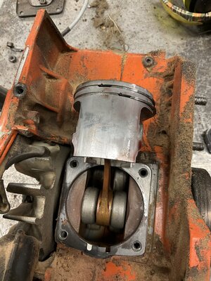

This is sufficient loob—RA at 50:1. Although it doesn’t keep the bearing pockets on these garbage Husqvarna crankcases from wearing out (395 pictured; the same customer has had the same trouble with almost all his 372’s).
Crank looks dry as a cork.
For what it’s worth, 50:1 mixed with vegetable oil leaves a nice sheen on the piston. 100:1 with good oil is plenty lube for the piston and cylinder. The extra oil is for the bearings
Edit..
What oil/ratio in your opinion would help to solve the bearing pocket issue?
It’s been a couple weeks since the saw was run, so some of the oil has drained off the crank. There is a puddle in the bottom of the crankcase.
Edit..
I don’t think more oil would help. This customer tends to over tension his chains, which exacerbates the problem. But I see worn Husqvarna pockets for others too. My hunch is that they have a little too much magnesium in the alloy, but I have no proof to back that up.
