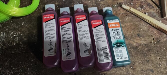

Its semisyn HP Super.....not Ultra!
Jaso FD.....ISO L-EGD...
Dunno for Makita....I think its mineral.....but without any standards printed on the bottle...
Think that @Wilhelm praises that oil?
Run the red Makita oil at 40:1 and You'll be fine.
I have literally bough the last box full of it having been in stock in Croatia, 12x1 liter.
I am not certain whether it is mineral or semi-syntetic, but it leaves a nice oil coat on the internals and once a PH is up to work temps it burns with no to little notable smoke.

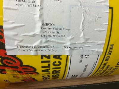

In the USA oil companies can list it being full synthetic when the rest of the world would not call it synthetic. Such is the case with the Schaeffer’s 9000 above, according to the data sheet it contains group 3 highly refined mineral oil. So it’s marketing commanding a stiff price.

Here over the pond....Germans have such a law....that you can not label an oil as synthetic if it doesent have certain % of synthetic components....
So if german language says that it is synthetic oil then it is....

If you knew what goes into making a group three oil you would understand why they are called synthetic. PAO's, who no one would argue against them being synthetic, are made from natural gas. So what's the differance given they both start out as petroleum?
