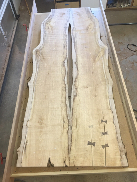

I was making a live edge spalted maple table with a gap in the middle and wasn't able to get the slabs close enough for a proper glue up so I used the procedure described above where I cut out the gap between the boards with this straight edge. Worked great.
It's one of my many half done projects. Wood was punkier than I would've liked, it needs a lot of epoxy work.

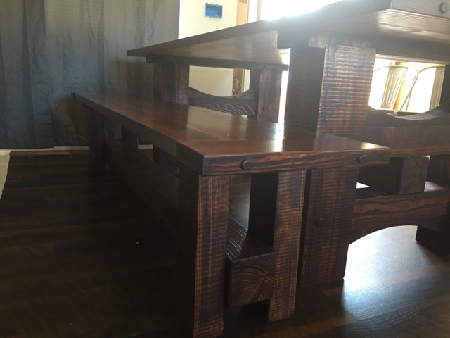

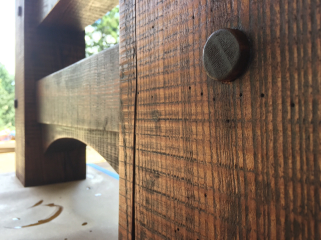

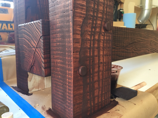

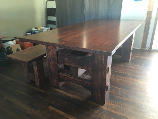

Here's a table I just finished. The lighting is terrible. Looks much better in person. Customer wanted it rustic so I left all the saw marks and cleaned it up with a brush sander. It's very smooth to the touch.
This was a big Doug fir that fell in a storm. I split it in half with my CSM and then squared it up on my BSM. After drying, back on the BSM to mill the parts. The legs are made with massive through tenons pegged with 1" pegs.

Yea, ditto what they said! I see the staining is still in process.

Thanks fellas. The tables done just an old pic of the staining in progress.

Very nice indeed. Do you know how heavy it is?

I don't really know. It's really heavy though. It breaks down into 4 pieces though. Top, legs, and stretcher. Top is 84x42x1.5" the legs are 7"x5" I'm horrible about guessing weights. Maybe 400-500 lbs

I hope you didn't charge them by the pound for that thing!
It is beautiful though, great work!
