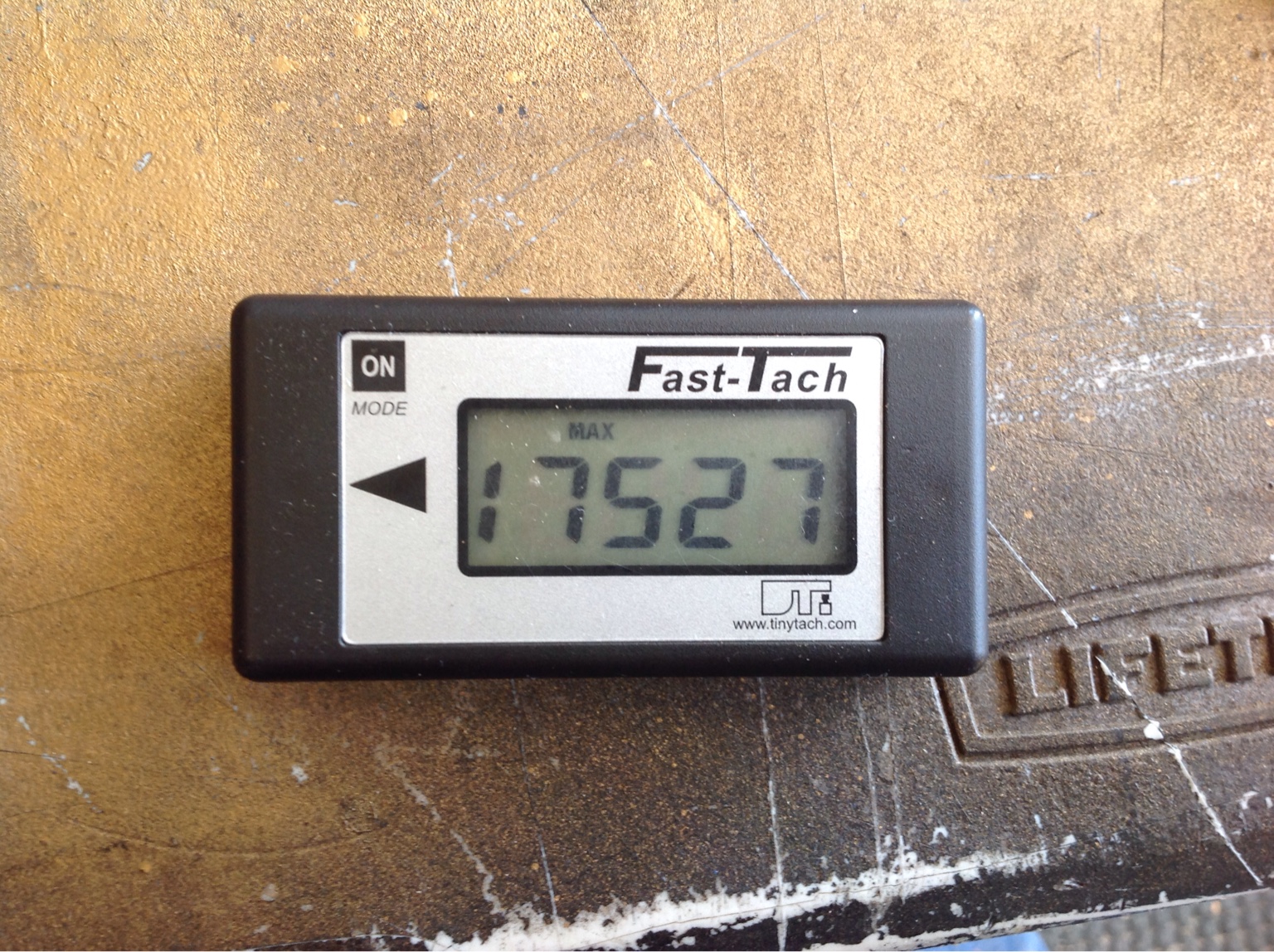

Tough to tune. Leaned out and couldn't richen at one point. It was happy at around 15,500. Really happy.
I looked at the tach afterwards and saw this
This is a piece of red oak.
I'd say it was a medium fail. I plan on swapping the coil out, playing with the timing and maybe tossing the 194 back on just to see.

Holy RPM! Never seen 175xx on a tach before. I love that fact that this is late 80s tech and in continues to evolve. Can't wait to see when you get it all dialed in.

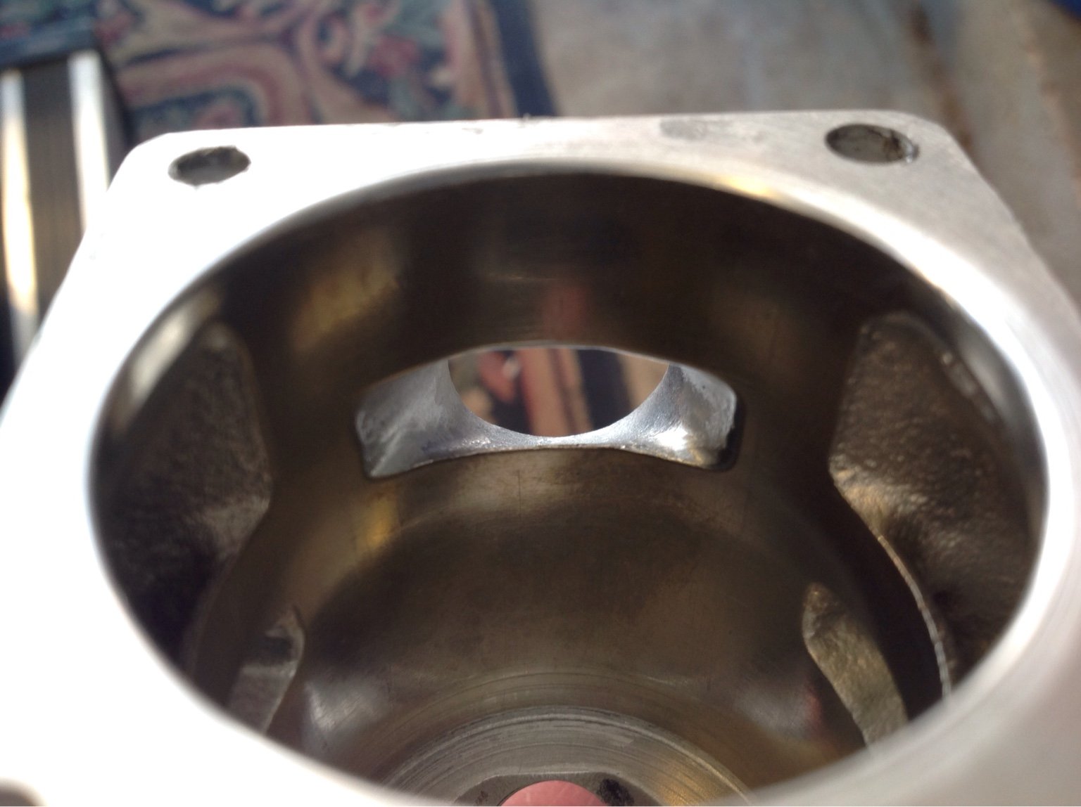

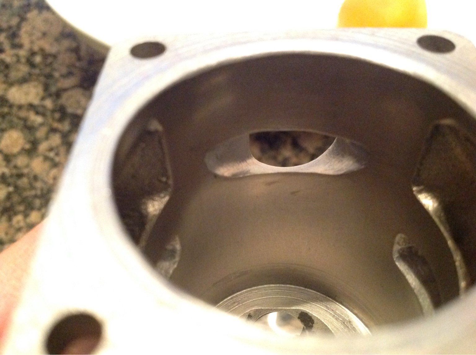

This saw has never run right. I'm swapping the coil next. May toss the stock 194 back on.
The piston has some fine vertical scratches on it. The tach didn't tell the whole story. It only got one shot during the lean piss rev. The saw probably saw 18,500 briefly.
