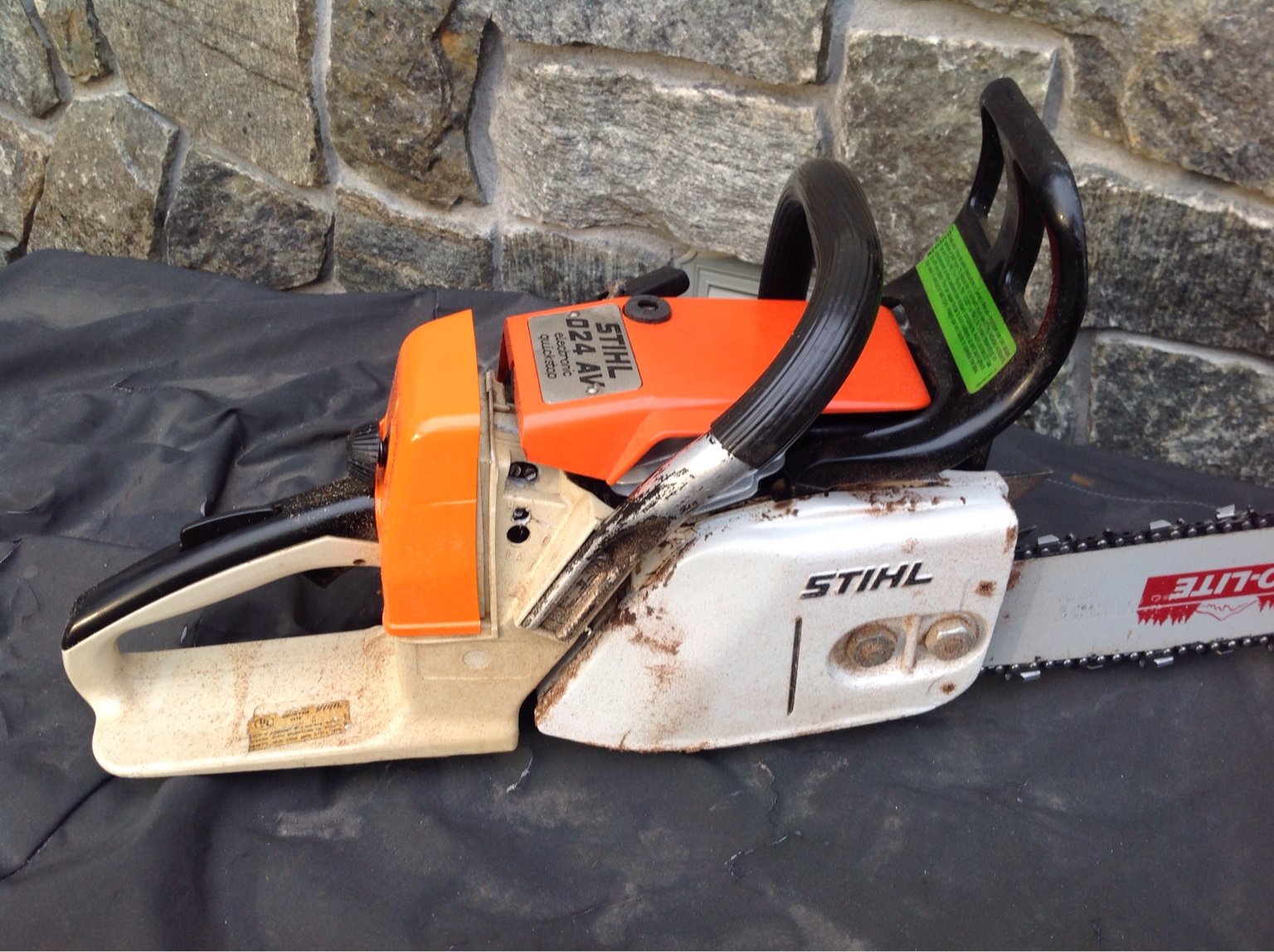

Swapped the coiled tonight.
Anyone know what this skinny coil is for?
I was told it was from a 260. Bolts don't line up.

Our 260s at work do not have that coil. I kind of looks like a 210 coil

I made the cardinal mistake of changing 2 things at once.
This is a different coil. Same timing. Added a factory ZAMA carb.
Set at around 15,600. A bit fat. Turning 11,500-12,000 in the cut.
Got the AF cover to fit.
