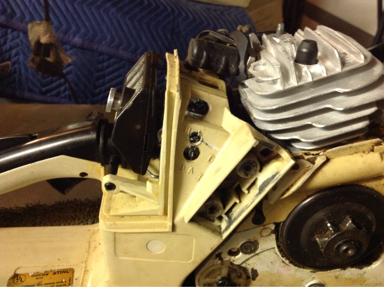

Back into this saw. Added an 044 boot and carb. Thanks to @Definitive Dave
Below are some pics of the boot mounting. The tab isn't directly at 6 O'clock as one would imagine for proper line up.
Gonna add another deflector to the muffler and hopefully get her fired up today.
I didn't like the pancake intake. I opened it up like I do on my other saws.

Can't say I'm proud of this hack job to fit the 44 carb. I slipped with the burr when attempting to make the idle hole. I should have rotated the studs like @huskihl did.
Just a note, the 024 air box is tighter than a 026, in many dimensions. There's a lot more hacking needed to fit a 44 carb.
The filter sits around 1/8" further backwards making the cover tough to fit.
A V stack will bolt onto the 44 carb, but the handle cover will not fit if you try.

The air filter cover fitting tight...there's a plastic tab sticking out of the filter that goes inside the knob. I trimmed 1/16" off of that and the cover went on better. There's actually a good bit of room still between the filter and cover, but I drilled some small holes in the front left of the cover.
I couldn't get mine to fit without rotating the carb, or I wouldn't have. My air filter / cover is now cocked about 1/8" to the right. But, like a husky has 5 different colors, when stihl av's wear a bit, the covers don't line up perfectly either. Meh
