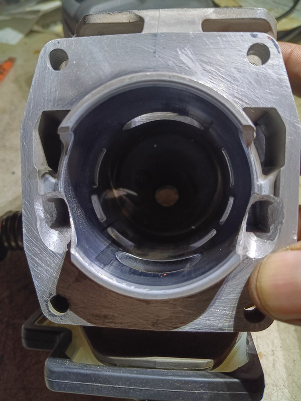

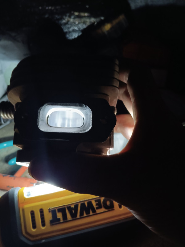

I went mildly ape-sh it with a pneumatic burr grinder. Only opened up secondary lowers. Left the primaries alone. Flattened top of that goofy round exuahst port.
Hogged out some of the muffler baffle and bent/pryed open the deflector.
Base gasket deleted. Used threebond 1207d. Bout .040 squish.
Removed the carb limiters.
Sanded down molding lines and sharp edges on the inside carb stack.
when that sealant cure for coupla days, will see how she pulls a 32" bar with c83 chain. Will run it against my ported cs 8000. I don't see 73.5 cc's of "triple port" out-cutting old school dual-port 81 cc's

Some slightly annoying things:
As some folks know, the carb limiters are a btch to remove.
The muffler gasket imprint showed that the gasket wasn't seating completly at the bottom of the muffler. Came this way from the factory. I found some sort of gouge at the bottom of the cylinder exuahst port. Had to file it flat.
I guess some former husqvarna folks, went over to echo and were part of the team that designed the saw.
It's a weird saw its like a 372 oe, that got butt fked by a yz 125, on halloween.

To me the transfer duct shape of the A transfer ports looks terrible. Hard to tell for the B's as they have been logged out.
Does not look at all like a OE 372 to my eyes.
Inside they’re somewhat similar. The two lower transfers branching into three uppers is a little weird. I believe that’s just to get it to scavenge a little better.

Hahaha 😆, 372 on half choke. Yep! 60 thou squish, 106 degree exuahst roof.
The fkn Conway Twitty of 70 cc saws:
"You want a man with ah slowwwww chain"
