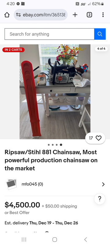

I would definitely keep running it. I'm not sure on build dates, maybe others can chime in. We were only talking porting gains from equal saws. I think most guys on here prefer a desirable saw that can be tuned with a screwdriver and a good ear, heck with computers and bullsh## 😂.
All this can be had right here:
