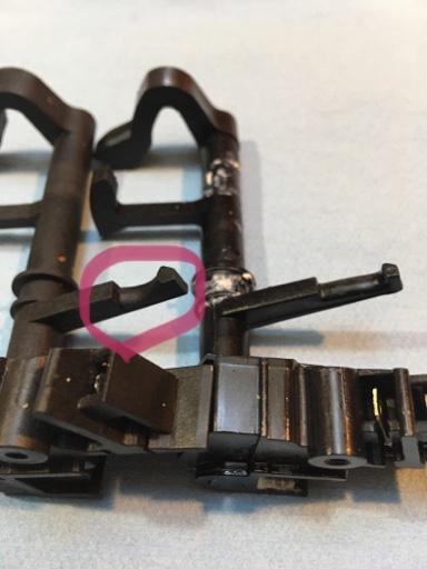

Visual difference between Farmertec and Stihl trigger parts. I saw a post asking about the quality of the latest kits. Well, I bought a clone MS-660 from someone on E-Bay. Towards the end of the two year square deal warranty it started to get very hard to start and run, so much so, I could only start it by holding the trigger down with a bungie cord to start it. Always popped off choke. The seller was no longer on E-Bay so I could not contact him.
I ended up replacing these trigger parts, going by the board recommendations and from looking at the schematic, and seeing what looked low quality to me.
OEM STIHL parts:
1122-182-0902 switch shaft (flexes less then the aftermarket from Farmertec)
1122-182-1502 throttle rod
1117-182-4500 torsion spring
1117-182-0805 trigger interlock
Since a picture speaks a 1,000 words, here are some pictures I created for a short video:

Somewhat related:
Switch shaft for MS440. OEM on the left.

Big difference there, I can see that having problems. On mine, the OEM was much stiffer. I think over time the repro parts suffer from cheap plastic that just gives up.
