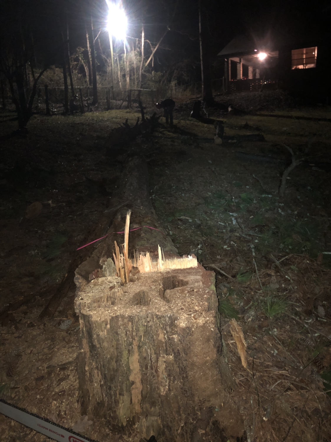

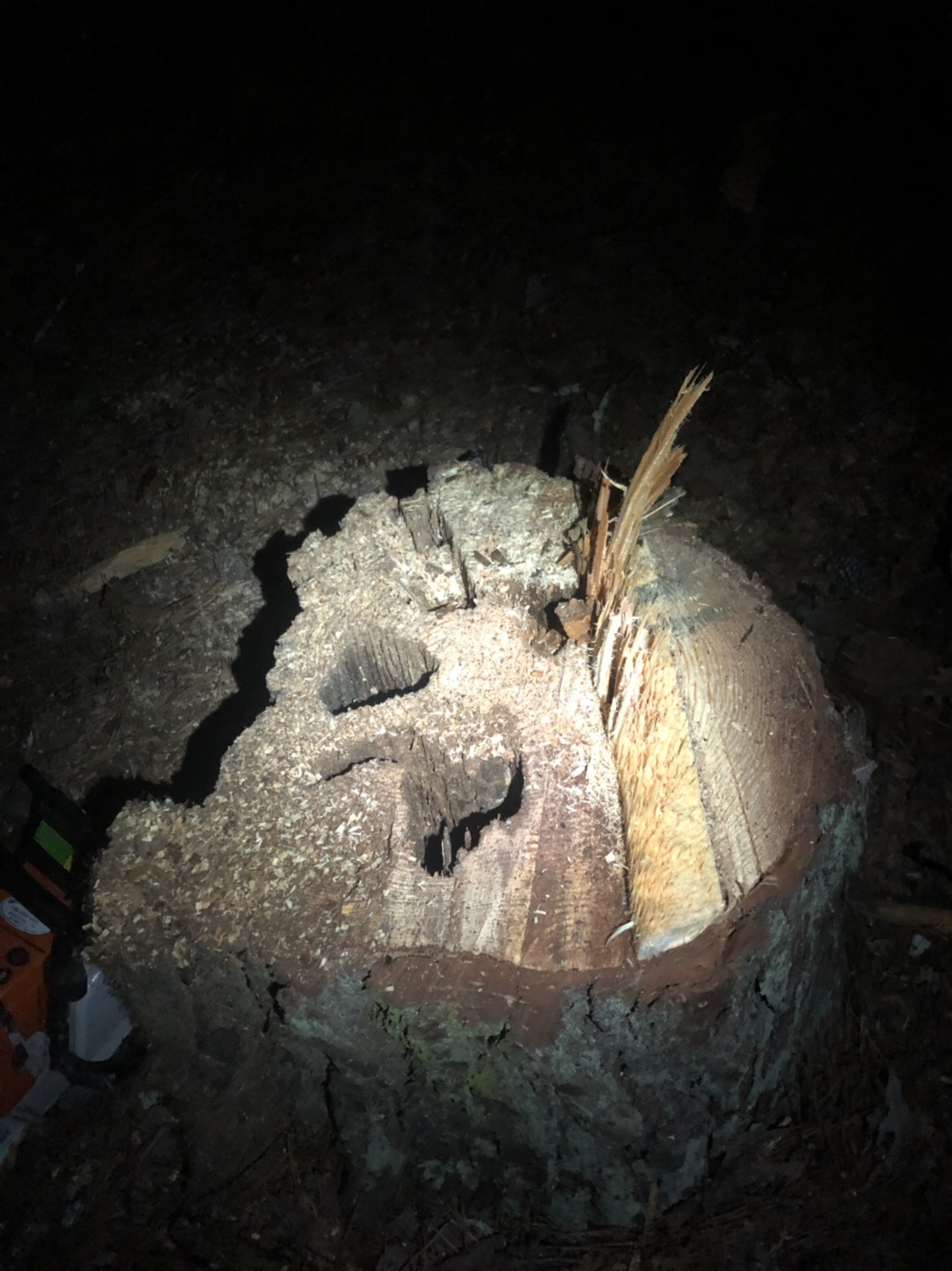

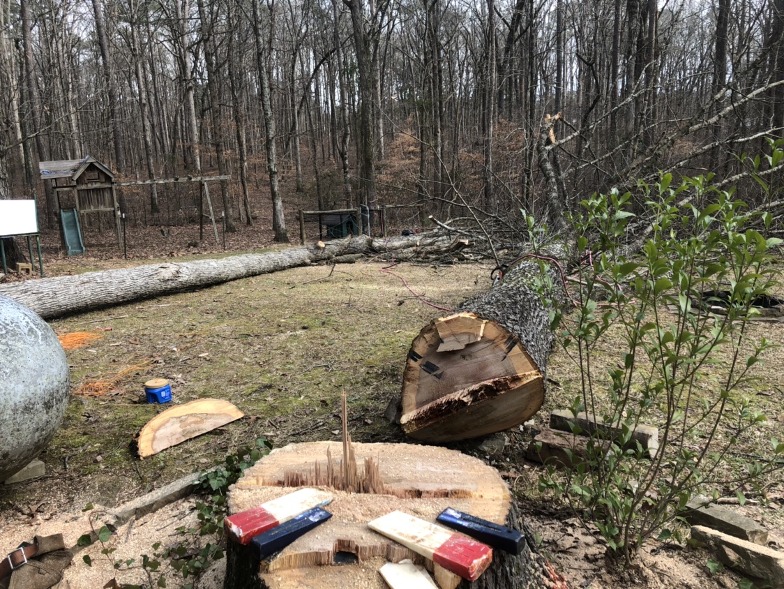

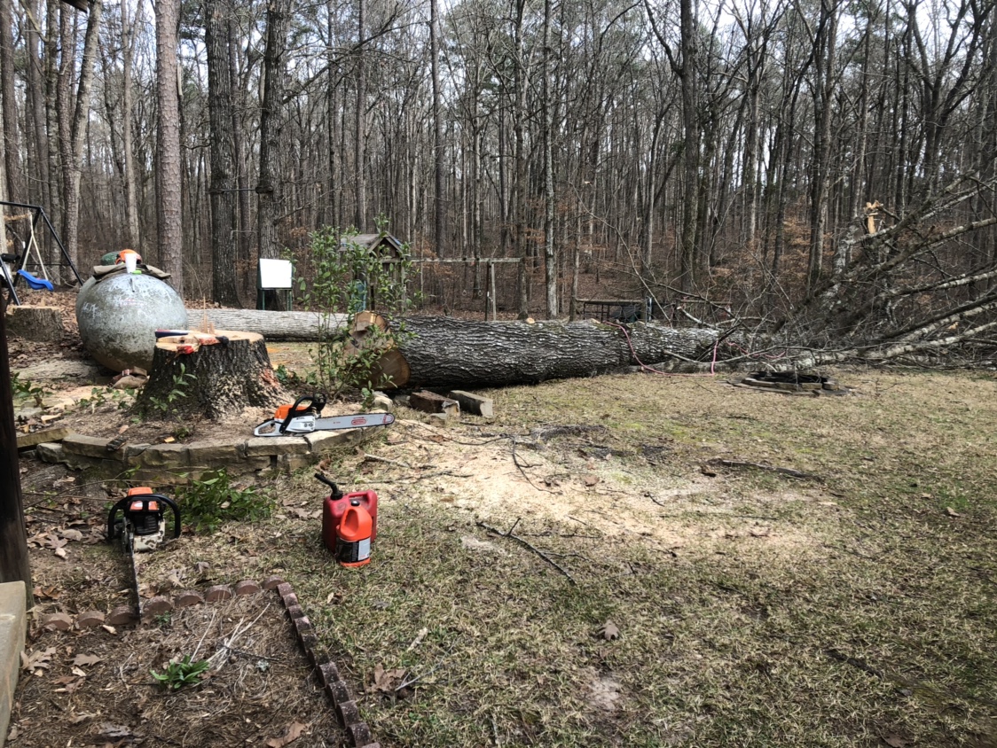

After looking at the top,
I decided to Bore this one rather than use a conventional back cut. In hindsight, I should have just made a conventional back cut as even though there was a lot of top weight leaning towards the lay, there was a few crooks in the stem that negated the top.
I had to bust out the steels on this one.
I left the hinge heavy on the left side for 2 reasons:
1. The house was just outside the lay & in the potential zone.
2. I’ve cut a lot of Red Oak in the past year that seemed healthy but the stump wood was already compromised due to decay.
