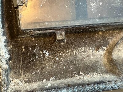

Here's the spot. I've got faith in it. ;)
I haven't been able to find posts anywhere of people with glass slipping, so I'll try some vibratite hotlock on the screws first and see if the 1/4 turn they are backing out is the issue, and try this next.

I think it’s a broken clip as well. I googled your model (although I don’t know what I,m looking at) and came up with this screenshot. There are a few ipl's
I guess as a short term solution could be just a fat wad of fire rope wedged underneath on that that ledge to stop it droping.

I concurr with the broken bolt, missing bracket theory

You might try to get a flapper wheel and smooth the face to flat and shiny. Watch real hard for a telltale witness mark where the boss meets the cast. then you know where to counter sink and drill. most stove hard ware is soft to drill. Good luck

I reached out to Kingdom Wood Stoves, he's something of a stove encyclopedia. He confirmed glass slipping is common on somme F3's, and some later stoves have a spot for an extra clip in that area but mine never did, so I think Jotul prepped the casting to support it in case it became an issue - interesting!
I got in there with a pick and ez-out and there is definitely no hardware in the spot.

So what you gonna do.?
Wedge a fat bit of fire rope under the glass. Or just buy a bigger (taller) bit of glass so it just sits on that little ledge

Most likely in spring after this burn season or towards the end of it I’ll drill and tap. I don’t want to risk cracking the cast without time to procure a new door. I figure if I do it towards the end of the season I can get a few test burns in and confirm if there are any issues with it.
Funny when I talked to Nicholas he mentioned he’s been tempted to do it many times but never did. Glad to have a resource like him not too far away should I need a spare door.
I think if I can run a bolt with a small spacer and an extra clip, or just a block of cast for the glass to rest on I’ll be in good shape.
This is OEM Jøtul glass, and definitely fits the curves very nicely but a tiny slip down and you’re letting air in.

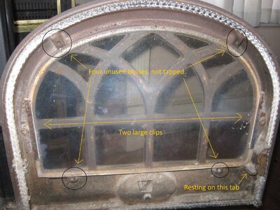

Here's a photo of the inside of the door on my 1995 Jotul F3CB. It confirms the two large glass clips in use but also shows 4 untapped bosses. The glass does not rest on any of these 4 bosses though the photo looks like it might. I guess a minor change through the years. We use a 2004 Jotul F600CB these days and our F3CB sits in front of an unused fireplace for storage/decoration. It's not for sale.
The idea is that the glass 'floats'. If it were hard fastened heat expansion difference may break the glass. This is likely the reason for the design change. I'm thinking now that my glass shouldn't be resting on that tab like it is. It may increase the chance of glass breakage.

Appreciate another picture confirming what I’m seeing!! We had this issue a few times last year and once this year. I’ve considered quite a few things that could work and I think that “resting tab” indicates resting is ok but I don’t think locking it down is, given different expansion and contraction.
Thanks everyone for your input, interesting to see mfg changes and for different reasons.

This may be the same door as was used on the previous model, the Jotul F3, which did not have the secondary air tubes.
The air tubes may be throwing more heat to the top of the glass.
I will probably make sure there is a credit card thickness between the glass and the tab on mine. I believe the tab is there as part of the door latching system. Glass doesn't tolerate sharply focused pressure points very well is my reasoning.
