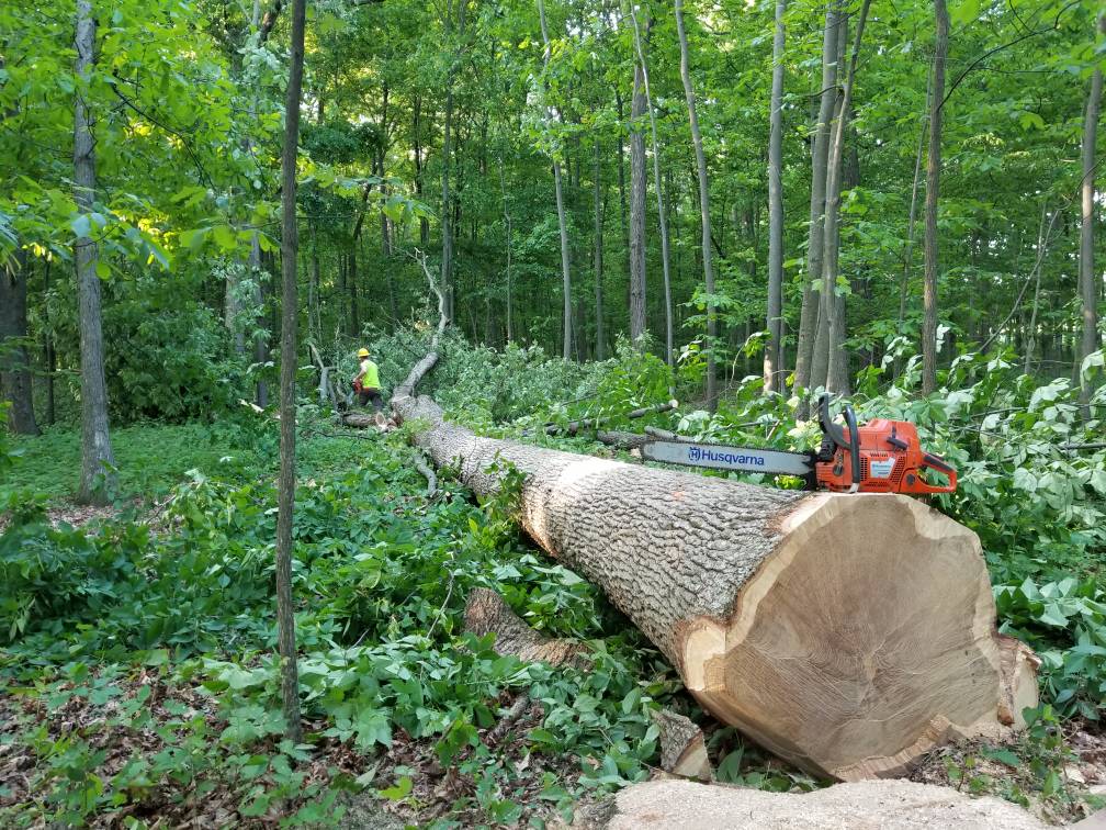

GOL stuff? Very nice job on that behemoth

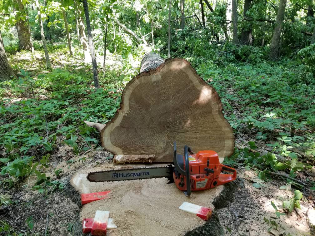

Basically I just borin and try to keep the saw in the safe side of the tree! Those were on a Rocky slope so I guess borin on the low side and cut the tree all off but leave the outside edges holding! Van bore down to my cut on the outside edges but I always leave the last Edge holding opposite of the way the trees going to fall! I will try to post someone I'm on flat ground again on how I leave the points and you just always cut the last Point that's holding up the tree!
