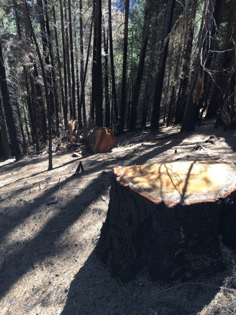

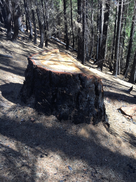

Post fire Hazard reduction and rehab on the Shasta NF in Sept ‘18 following the Interstate 5 fires
Humbolt launched it 20’ downhill (small controlled working crew all above it)
I’d say for fire crews working during a fire, for a majority of the trees, having them stay close to the stump or still attached and on ground is what they’re looking for.

Yes sir, fire fighting is a whole different world I know nothing about. Cool pic illustrating the energy a humbolt can generate to kick the tree away with some down hill assistance.

Nice work! That’s one of my favourite jobs is felling on a fire, as terrible as it is to see the forest burn if that makes sense. And unfourtunately BC has burned a ton over the past couple of years, massive fires. Just something about falling a big tree with flames shooting out the backcut that gets the heart pumping.
