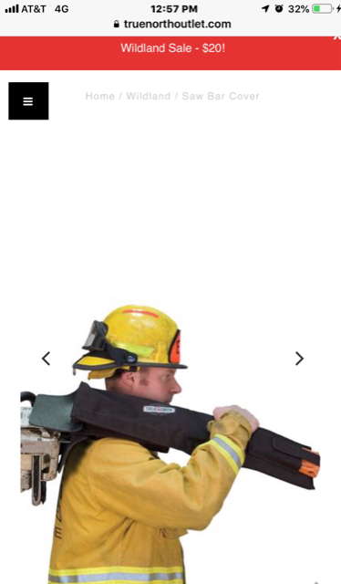

Just an FYI
True North 42” bar cover, pack $20
https://truenorthoutlet.com/collections/wildland/products/saw-bar-cover-1

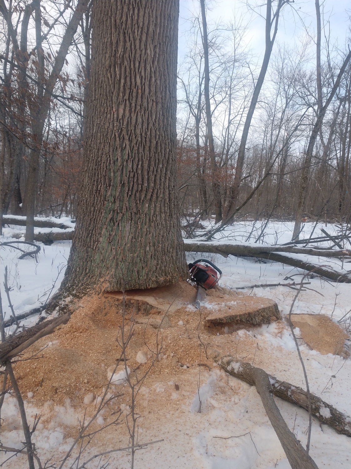

View attachment 168544 I’m not good at stacking wedges. A little piece of wood works well as a new lift point.
Might try some of the rifled wedges, when pounding are you hitting one then the other or both at once? If you hit both at once they’ll spit out also try a little saw dust of dirt in between the wedges.

Question: how much lean can be overcome with wedges as a general rule of thumb. I was eyeballing an ash yesterday, about 17” dbh, 10 to 15* of back lean, 75 feet tall.
Want to send it against its lean to fell into an open area but the relatively small diameter doesn’t leave a ton of room to drive wedges. I know it’s hard to judge the situation by my description but if you have some incite I’m all ears. I think I can push it over but it’s got enough lean that I know I’ll have to lift at the stump A LOT to move the top enough to fell against the lean.

Some trees are to small to wedge.

Sounds like a job for a throw line, bull rope, and a uniforest.

Back cut get the wedges started then put your face in, it’s a lot like jacking it takes times to do and sometimes stuff just doesn’t work.
