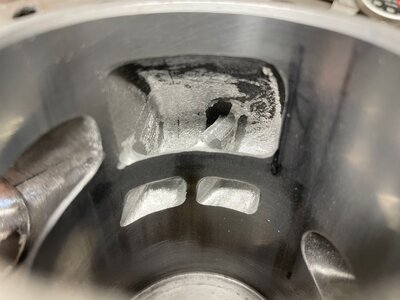

It went from a cut time of 83s down to 50s with a 32" full comp chain buried in dead ash (very hard wood). Stock I had to baby it through the cut, after I wish the owner had put the bucking spikes on it as I had to press very hard to keep it loaded.
I raised the transfer ports 0.095" above the stock port height which brought them up to 119° transfer duration from 103°. Ex duration was 158°, Intake 156.5° with 0.030" taken out of the squish band.

I know the 8000 is a dual port but the 800 is the closest thing I've ported to it. Generally dual port versions of series like even more transfer duration than their quad port cousins.
It takes a lot more power to pull the chain in a full cut than bore cutting. This is why everyone time cuts cookies in a consistent log with minimal rocking around to verify gains.
Generally gains are across the whole power curve until you start chasing really high peak power (peak HP above 11000 rpm). This is because in stock form most saws peak torque is between 6-7k rpm, so anything you can do to raise the peak HP is going to be beneficial to the torque throughout the range where you are operating the saw. See attached graph from a Stihl 064 I ported.
In short... if you haven't altered the transfer timing there is a lot of power to be gained.
