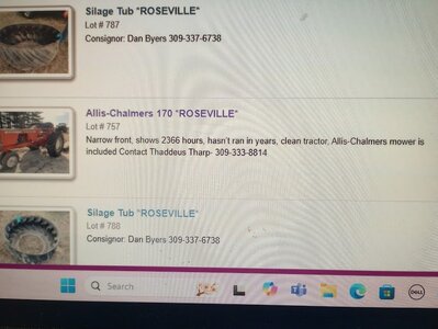

That was typical of many of tractors of that era no matter the flavor or brand. On the Allis Chalmers side . I have a WD, WD-45, D-17, 180, and 190. They all have the same basic 3 rib narrow tire.
On a unrelated note this was a wild one. South of me three weeks ago today this Allis 170 sold for $14,000 plus buyers premium. It had not ran in years either.
