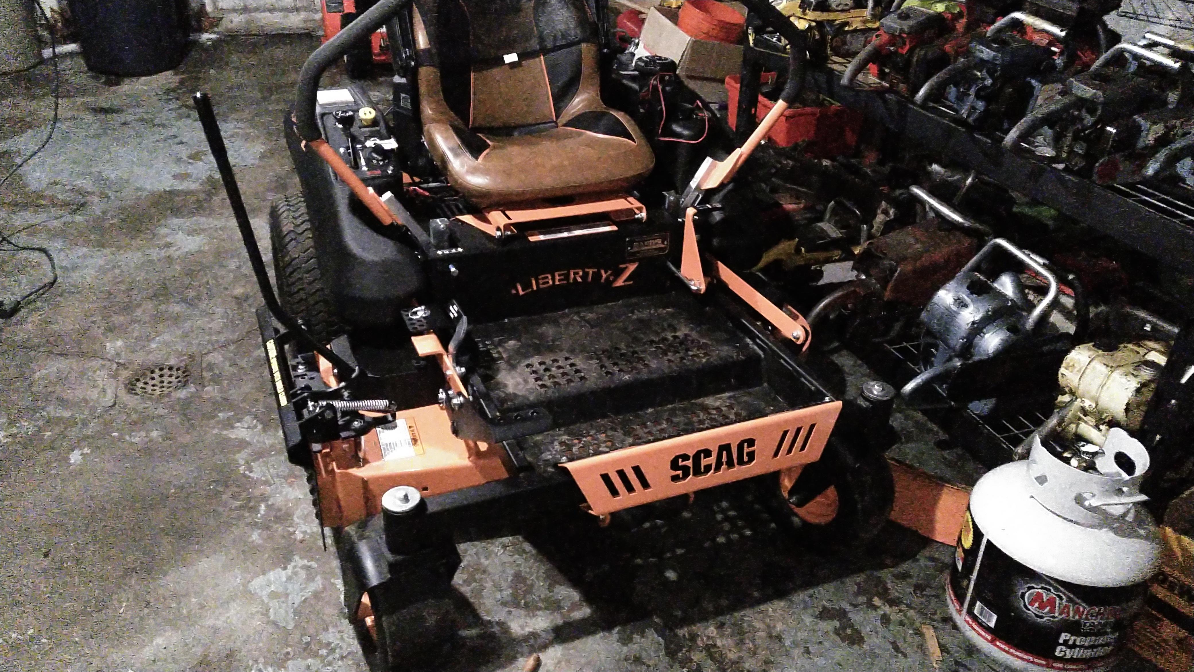

If the liberty z is anything like our turf tiger 2's you'll be happy. Do you have a way to lift mower to change blades? The TT2 is a big ass bolt all the way through the spindle with a nut on top. Sorta a pain with out the mower well off the ground.

I don’t have a auto lift but prior to my 1025 I used a motorcycle Jack to lift my cub for blade changing and deck cleaning. I’ll admit I’ve been spoiled with the drive over deck on the Deere . On and off takes 30 seconds, lift it with the loader and hold it completely horizontal at eye level is a joy for cleaning and blade swaps. Not sure how I’d do it with a zt but I’ll definitely figure it out. That scag paint is really growing on me! Dealer should have both machine I’m interested in soon.

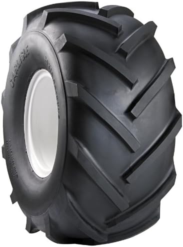

One thing that greatly improved the stability of my zero turn mower was replacing the rear tires with a chevron shaped "tractor" style of tire. The factory tires on my Husqvarna would slip and spin so easily that I had bald spots in my yard near fenceposts where I maneuver around them each time I mow. The chevron tread tires grip the ground much better, slip less, and make the mower feel more stable on side hills.
