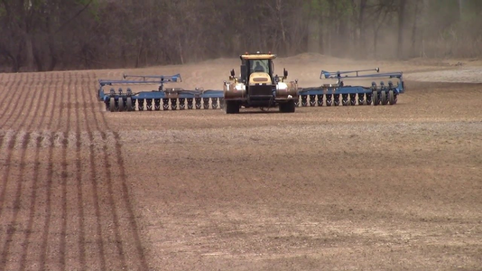

not sure if this still applies with modern tractors because of how much power is being made in such smaller units, but general rule of thumb is not to pull implements wider than the rear tires.
Agreed on the smaller tractors but not at all once they get over that 40hp area. I pull a 60’ digger behind my Deere 9420. It’s weighted to 42,000lbs and set at 550hp. It’s a big green freight train lol.

not sure if this still applies with modern tractors because of how much power is being made in such smaller units, but general rule of thumb is not to pull implaments wider than the rear tires.
Well not quite...............:)
