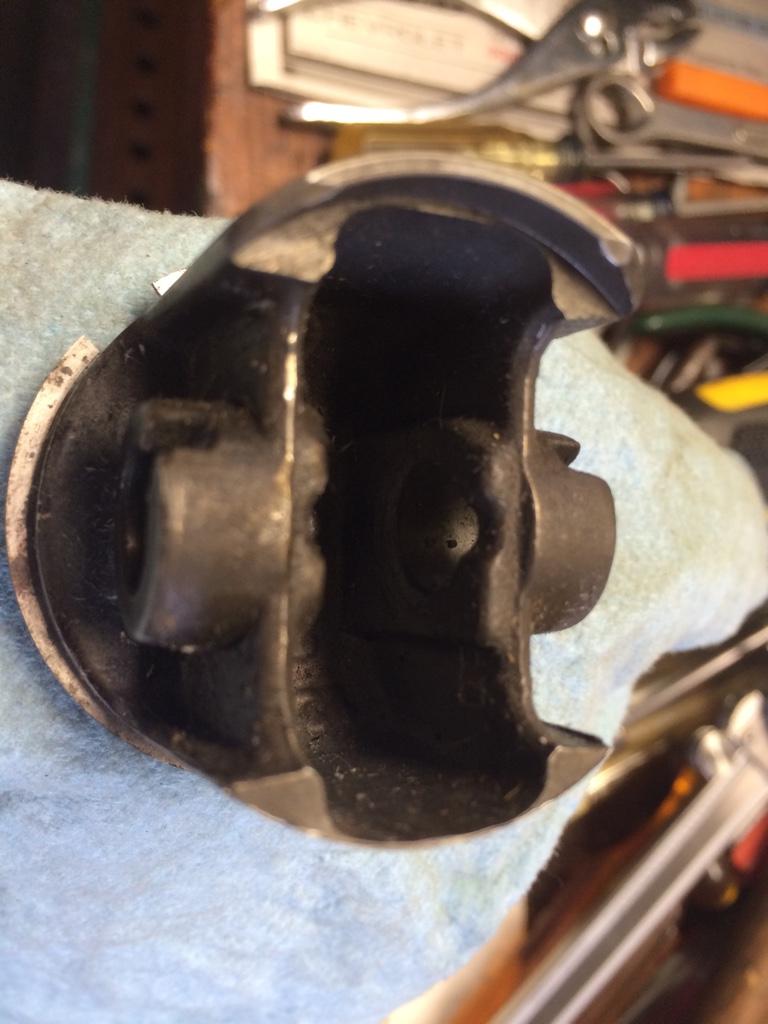

Easy to tell on this one. [emoji2960]
Actual skirt clearance was .070”.

Yep, at skirt its a tad bigger than than the thickness of double-sided razor, which means its around 0.006"-0.007"
But i guess it would be shame now, when im doing a complete rebuild of it, to cheapskate on pretty much most important component.
Ill just put aftermarket one, and as im not a heavy user, and im always using atleast 40:1 it will last me a long time.
