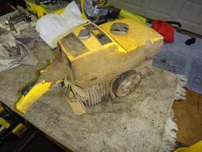

Just finished the Mini Mac 6 ready to rip.

Getting the engine in and out of the case has been challenging for me on the MM6. I know you must pull the starter rope out a foot or so and work the flywheel fins through the starter ratchet, but is still take a lot of tinkering... The saws with a removeable starter are much easier, good thing too since it usually takes 3-4-5 tries before everything works as it should. The most recent MM (110) ended up have an internal leak in the pulse pump (automatic oiler) and filled the crankcase with bar oil after the first go 'round.

Yeah it was a bit tricky going back together but easier than I thought it would be. I rebuilt the auto oiler and today was the first run so we'll see how it is after sitting over the weekend.
I upgraded the center bolt under the throttle trigger to 1/4" -20 bolt because both my saws had the original size bolt broke off or stripped.
