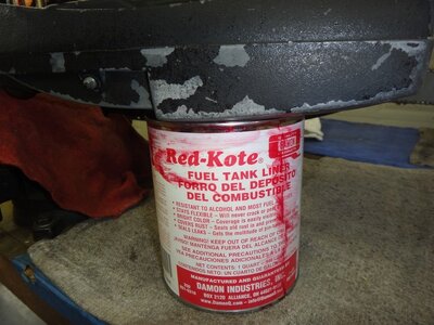

I have found that many will leak where the fuel line passes through the tank. I don't know if there were inconsistencies in the size of the hole in the tank, the molded grommets in the fuel line, or if some fuel line material just shrinks over time...
My go to solution has been to put a few wraps of Teflon thread tape around the grommet before I pull it into the hole in the tank. Some need 3-4 wraps to achieve a good snug fit.
I had one 6-10 model that does not have a full channel in the tank to contain the gasket, and neither the new cork or Viton gaskets would remain in place to positively seal the tank, so I ended up giving it the Red Kote treatment.

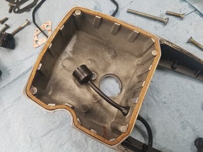

Fuel in the airbox is very common on these, and can be from where the line goes into the tank or from the tank gasket itself. Relatively easy fixes.... I typically use a dab of Seal All on the line where it goes through the tank to help make it a more permanent seal. This will come off if it needs to be removed later but is fuel safe and clear. Tank gaskets were originally cork but are also available in viton which stores better than cork. Both are viable options however.
For leaks at the fuel tank seal, double check the condition of the metal in the groove. I normally don't suggest any sealant there but if it is corroded, I'd use some. The other trick is with rubber they don't compress as much as the cork, so its important to tighten the tank down evenly first with the center screw, then the two corners of the air box. I've found the rubber holds the tank top up a little higher than the cork which typically compresses until the metal parts meet. I've had good luck with both versions I sell. For shelf queeens that stored dry, I'd use the rubber. For regular use, I'd use the cork, as the fuel staying in it helps keep it sealed.

I second this process but check and make sure the bolt spacer is on the bolt inside the tank. It keeps the bolt from over tightening and cracking the tank or warping it. There has been on occasion needed to grind or cut a small amount off of bottom of the spacer to be able to tighten it more but the spacer must be perfectly square to the tank. That was used for some aftermarket gaskets or when filling the valley with something.

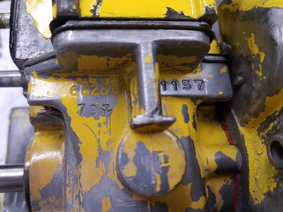

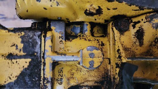

Hi everyone. Can someone tell me what the numbers on the right side of this 797 block mean? Thanks in advance for any help.

@heimannm may know more but I was told by a dealer years ago that they are production series numbers. A lot of my blocks have them.

66251 on the left is the block number for the 797. They don't always have the 797 model number stamped like this one.
On the right is normally a serial number but they are usually 5 or 6 digits. I do not know the story on the 4 digit number, maybe Nate (Big Mac) would know @Bigmac

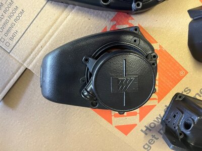

Touched these components up, tried to match the factory spatter type paint. We’ll see. Winter muffler cover turned out pretty spot on
